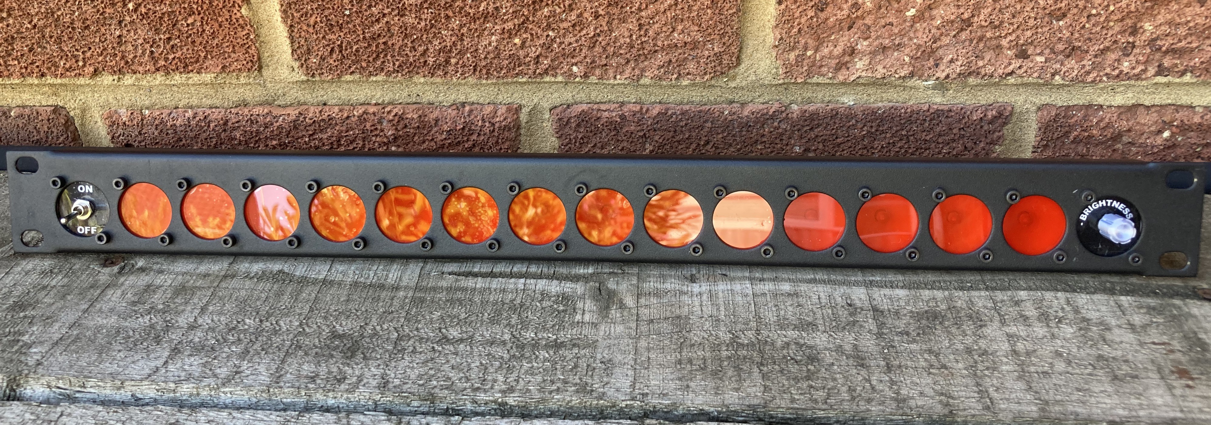

    Knowing that the electronics is all behaving as expected, I wanted to try and make everything a bit more presentable. After all, this device is purely decorative rather than having any important function, so it should at least look decent!

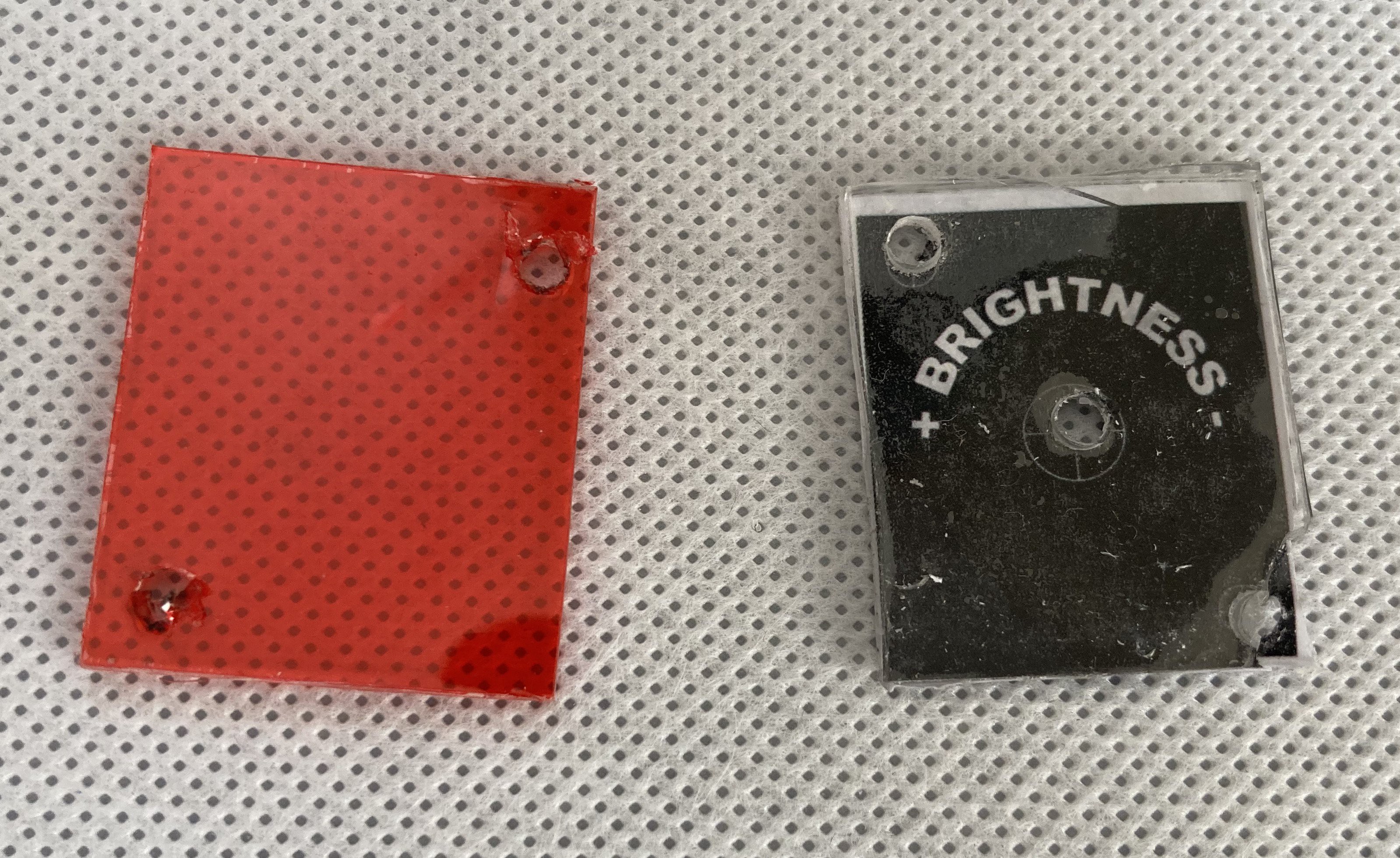

    First, I wanted to add some see-through panes to the front panel, to cover up the LED and 3D prints, and to put some labelling around the controls.
    Translucent LED pane (left) and labelled control module pane (right)
    First attempt at making the decorative front panes, the red LED pane is acceptable, but the control module pane was drilled incorrectly and ended up breaking
    14 of the red panes will be required to cover all of the LED positions, and a couple of customised panes for the power and control modules. As shown in the image, I had some trouble with aligning the drill to the target positions, and even managed to break the corner off the brightness module pane, requiring it to be remade entirely. In future I really should make a quick alignment guide and use a proper drill, rather than a small handle to manually twist the drill bits through.
    The LED panes are made from 2mm clear acrylic sheet with a stick-on red film tint to give the impression of coated glass. The film did make a mess around the screw holes where it was drilled through, though these will be concealed behind the panel anyway.
    The same 2mm acrylic is used for the control module panes, with printed paper labels simply stuck onto the back, and an additional central hole drilled out for the switch and potentiometer handles to protrude.

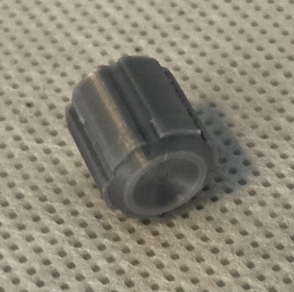

    I had also ordered a small metal potentiometer knob to hide the drill hole around the potentiometer shaft, but it turned out the shaft didn't stick out far enough from the panel to be able to fit it! Thankfully, one of my friends was able to 3D print me a replacement on short notice that I quickly modelled up in FreeCAD, as my own 3D printer is in dire need of calibration, should I actually get round to it...
    Small 3D printed potentiometer knob replacement
    I quickly modelled up this little potentiometer knob in FreeCAD and a friend was able to 3D print it for me the next day. Kudos!
    Due to the alignment error where I'd drilled the acrylic panes, I had to enlarge some of the mounting holes to allow for some play around the bolts. In hindsight, this is something I should have considered in the first place, rather than assuming near-perfect alignment between the panes and the panel cutouts. Still, after enlarging the drill holes and using a bit of force I was eventually able to get everything assembled:

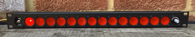

    Fully assembled scanner bar
    Fully assembled with decorative front panes and potentiometer knob!
    Depending on the angle of the light, you can see where air bubbles have been trapped under the tint, and some specks of dust which got glued into the control panes, as I hadn't taken enough care to smooth out the film and keep the panes spotless. But overall, It looks reasonable and just needs a bit more time (and patience!) to do properly. I may end up redoing the panes if it bothers me, but it's good enough for now.

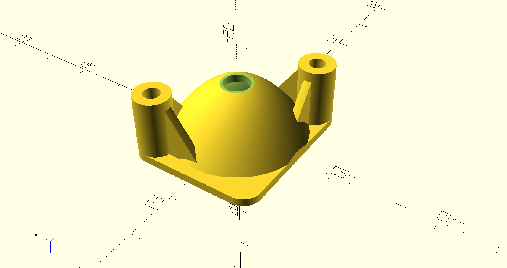

  • 3D printer spacers and LED enclosures
    Eontronics08/08/2025 at 14:31 0 comments
    At the same time as ordering the PCBs, I also used the opportunity to try out the 3D printing services that the fab offered. They seemed cheap enough and I needed the parts, so why not? Besides, their resin printers should give much nicer prints than my home FDM machine could!
    The first set of parts I modelled up were mechanical spacers for the power and control PCBs, to ensure the switch and potentiometer would be the correct distance from the panel when mounted to their PCBs.
    Control module spacer
    Spacer for the control module modelled in OpenSCAD
    Power module spacer
    Spacer for the power module modelled in OpenSCAD
    The spacers are both very similar in design, varying only in the central hole size and standoff height. They are quite simple in geometry, so lent themselves well to modelling in OpenSCAD. This was fortunate since I've stopped using Fusion 360, when Autodesk started to pay wall features behind their cloud-based "services" (In my case I had been using their linear finite element solver in a prior project and suddenly found I could no longer run models locally ):< ).
    LED enclosure/spacer with parabolic "reflector" design
    Like the previous two spacers, the LED enclosure was also modelled in OpenSCAD, which was made a bit more interesting trying to generate the paraboloids to house the LED!
    The LED enclosure is a similar design but features a parabolic shaped "reflector" to surround the LED and hopefully provide a more even dispersion of light. As this is 3D printed, the light will of course be scattered rather than reflected, but it felt cooler to try and model a proper parabolic design in OpenSCAD rather than making it spherical.
    I had all 16 of the parts 3D printed in white SLA resin, which thankfully turned out pretty cheap thanks to how small they are, though I did have to pay for shipping twice since they were packaged separately from the PCBs at the time.

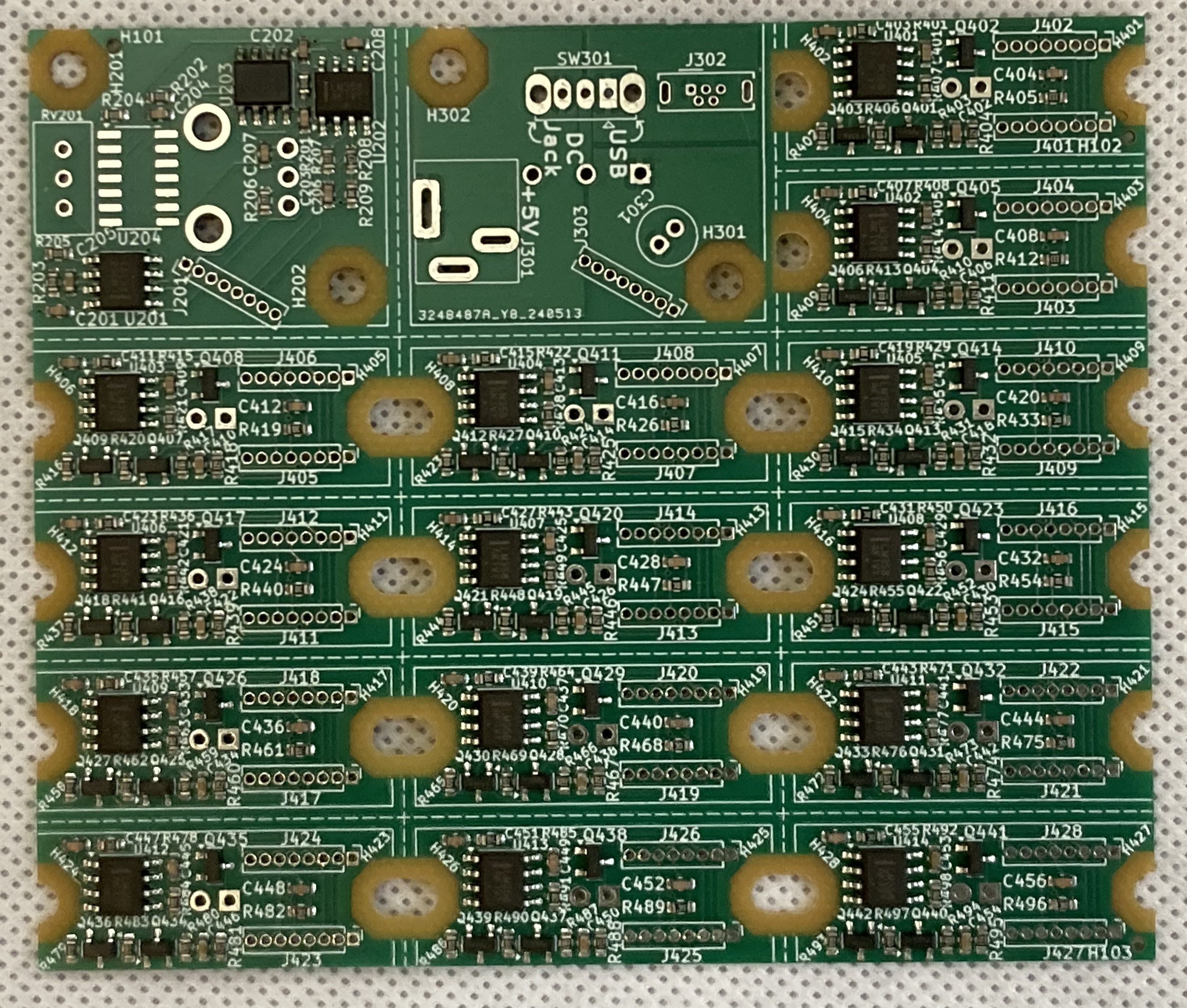

  • Circuit boards!
    Eontronics08/07/2025 at 22:49 0 comments
    The module PCBs were ordered from the usual low-cost PCB supplier. To keep things as cheap as possible, The 14 LED, power, and control modules have all been amalgamated onto a single PCB which needs to be cut out and separated manually:
    Tiled PCB containing control, power, and 14x LED modules
    The modules were tiled as a single PCB for manufacture, with most surface-mount components assembled, leaving just one SOIC-14 chip and the through hole components to be soldered by hand.
    This is a 2 layer board with overall dimensions of 97x82mm, in order to qualify for the <=100x100mm discounts that several fabs offer.

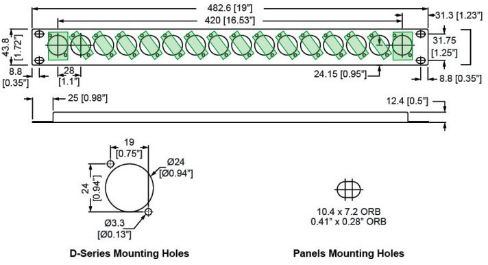

    The power and control modules are designed to match the dimensions of XLR D-Series panel mount connectors used on the panel, while the LED modules are designed to fit across their diagonals:
    Mounting configuration of PCB modules on a 16x XLR 1U panel
    The power and control modules fit directly to cutouts at either end of the panel, while the 14 LED modules are installed across
    the diagonal of the cutouts. Background Image sourced from penn-elcom.com.

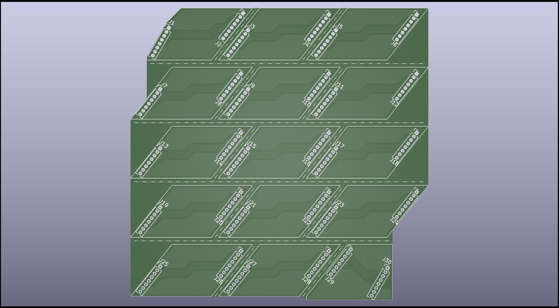

    The 8 way, 0.05" pitch through hole pads present on each module are to be used for inter-module wiring. Though only 7 signals are needed, I'd like to use ribbon cable to join the modules together more neatly, so the ground signal has been paralleled to an extra wire, as 8 way ribbon cable is far easier to find, making the extra wire available.
    However, trying to assemble these proved to be extremely tedious, even after getting help from my dad to do all the soldering! Using ribbon cable was apparently a terrible idea as it was awkward to line up with the through-holes, and the PVC jacket would keep curling back under the heat from soldering. Using individual PTFE coated wires was somewhat of an improvement, but the fine pitch meant bridging between connections occurred far too often, and was tedious to desolder and repair.
    In the end, I had to design another tiled set of PCBs to bridge between the modules, soldered directly to 0.05" pitch pin headers. This was more manageable, as the extra structure of the headers helped keep everything aligned and in-place during soldering, however this did double the number of solder joints required to 480 (!!!). Manual assembly labour required is definitely something I should put more thought into in future projects, because all that work is ridiculous.
    All 15 interconnect board tiled into 1 PCB
    I threw these interconnect boards together in a bit of a rush, so forgot to leave room for the bolts. Whoops!
    Even after all this, the interconnect PCBs still turned out to be somewhat of a hassle. The awkward shape made them difficult to cut out, and most of them had to be trimmed to some extent as I had forgotten to allow clearance for fixings on the LED modules. To top it all off, the cost of ordering and shipping the extra boards and pin headers likely entirely negated any savings from tiling the modules into a single PCB in the first place!
    Clearly not one of my brightest ideas...

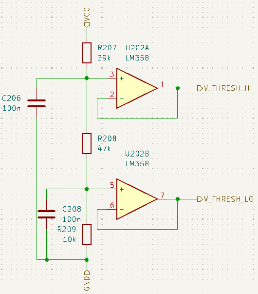

    Threshold level setting schematic
    Threshold voltages set by the resistor network are buffered with opamps so they can also be used to drive the LED modules resistor ladder
    The upper and lower threshold levels are buffered from a simple resistor divider, giving upper and lower levels of 2.97V and 0.52V, respectively, from a nominal 5V supply. These have been buffered because the signals are also used to provide virtual power and ground levels for the LED modules resistor ladder, thus ensuring the triangle wave oscillates within the same voltage range as is across the ladder. The voltage levels are more or less arbitrary, and were chosen to provide as large a swing as possible, to minimise the influence of noise, while staying within the common-mode range of the LM358s (~2V below supply to ground) used in the control and LED modules.

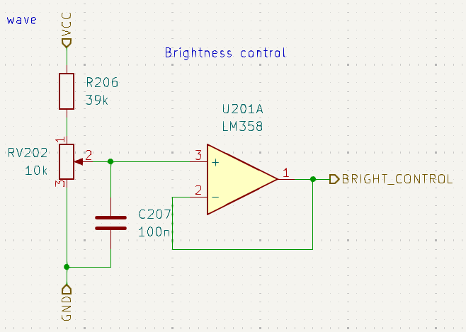

    Brightness setting schematic
    Not much to see here - the potentiometers brightness signal is buffered by an opamp to provide a voltage signal that the LED modules can source current from
    The brightness control input to the LED modules is simply buffered from a potential divider network using a potentiometer to adjust the level. This can be adjusted between ~0V-1V, allowing the LED current to be set up to a maximum of 10mA (I normally find LEDs to be too bright so this is plenty more than enough for me), while staying wall withing the common mode range of the LM358, and the 2V limit from the LED modules design.
    As with the LED module, additional capacitance has been added to various signals to form RC networks for noise attenuation. These are probably not necessary, but they're a cheap addition for some peace of mind.

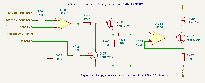

    The LED modules which form the scanner bar have two key responsibilities: Fading their LED on/off at a reasonable speed to approximate the look of incandescent bulbs; and to use the value of a shared control signal to determine when the scanning sequence reaches that module.
    LED Module analogue control circuit
    Two operational amplifiers and a few transistors form the analogue logic needed to control the LED
    The LED is driven with a constant current feedback loop, controlled by U401B and Q402, which ensures the LED current is insensitive to its forward voltage. The instantaneous LED current is set by the voltage across C402, which is buffered across R407, corresponding to 10mA/V (minus the small base current to drive Q402). At 20mA, there is a 2V drop across C402 and hence R407. Adding a further 0.7Vbe requires U401B to source ~2.7V from its supply. As this is USB powered (say 4.75V minimum), this leaves 2.05V of headroom for the op-amp, which is about what jellybean LM358s can achieve.
    The network of C402, R403 and R404 are responsible for the fade control. When LED is increasing in brightness, and Q401 is conducting, C402 is charged from the level presented on the BRIGHT_CONTROL signal through an 18k resistor, and discharges much slower once Q401 is blocking, through a combined 138k resistance. This forms a low-pass filter with rising/falling time constants of 8.4ms and 65ms respectively. Used to control the LED current, this gives a very fast fade-in and a much slower fade-out, somewhat similar incandescent bulbs.
    U401A is used as a comparator, monitoring the position control signal to determine when to start fading the LED in. Another comparator would be needed to determine when the LED should start fading out, however as this corresponds with the next connected module fading-in, we can simply take that modules fade-in signal (labelled "position compare"), and feed it into a "strobe" signal, to disable Q401 by pulling its base to ground.

    Additional fast RC network are formed on the resistor ladder and "position_control" inputs to help attenuate noise that may be picked up in these signals, which span the full length of the scanner bar.
    Due to the limited output voltage of the LM358 and drop across Q401, the brightness control signal should be limited to ~2V, as there is a risk of clipping occuring beyond this. As this corresponds to an LED current of 20mA, there should be no reason to go any higher to avoid burning out the LED.
    In total, this means there are 7 signals that must be passed between each module:
    1. Power
    2. Ground
    3. Brightness control signal
    4. Position control signal
    5. Resistor ladder serial connection
    6. Resistor ladder return (this is a virtual ground reference for the end of the resistor ladder)
    7. Position compare/strobe signals
    Meaning each serially connected module would need 7 separate wires to connect it to the previous module, which should be manageable for the short module-module connections.

    I want to try make the appearance of the scanner bar as faithful to the actual design used on the car, and a key component of this would be to try and mimic the slow fade out effect of incandescent bulbs as the filament cools. In comparison, LEDs respond almost instantaneously, switching from light to dark as soon as the flow of electrons is stopped, so I would need to devise an analogue circuit to gradually reduce the LED current (and hence brightness) to recreate the same effect.
    I ended up finding a rack mount panel with stations for 16 XLR connectors, which I thought could be used as nice windows for the LEDs to shine through. With a power switch on one side and some kind of control on the other (speed or brightness), which leaves the middle 14 spaces for the scanner bar itself, demonstrated in the image below:
    Mock-up of scanner bar using 14 LEDs and control modules at each end
    Quick design mock-up of the planned scanner bar and controls. Background Image sourced from penn-elcom.com.
    Rather than trying to run wires from a control board to each LED individually, which could get messy quickly, I decided on making a "smart" (in an analogue sense) LED module which would be wired in series with other modules to create the bar. By designing the fade effect into each module, the number of wires between each module could be reduced to just power, ground and a "position" signal. The value of this position signal would determine which module should turn on, and the scanning effect could be created with a repeating signal that sweeps through each LED module. Such a signal would be generated through a separate control module in one of the end positions.
    While scheming the LED modules, It took some time to find red LEDs with a clear lens to use, as I thought that without the red tint they would look a bit closer to incandescent bulbs, though in practice I'm not sure if this would matter since they were going to be installed behind red plastic windows anyway. I also wanted to design some kind of reflector to house each LED and give a more uniform glow through each window, as opposed to a glaringly bright point source.
