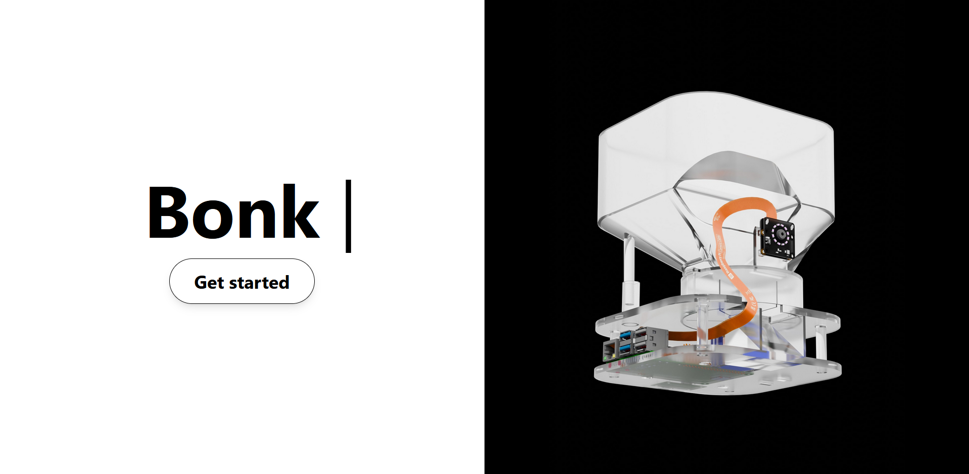

Now in my second attempt i wanted to make something proper however i had no good ideas, i designed a sliding door, circle sector door and a square rotating door. Later on while scrolling on AliExpress i found a xray view style image of a cat feeder. It uses a rotating impeller to move food from the hopper to the outlet and into the bowl. This felt like the best solution so its the one i went with.
Impeller concept
For the early concept renders, I started with a rough sketch of the design. Since gpt 4o image generation had just launched, I used it to bring the sketch to life, then refined the result in Photoshop. While the render looked good, it didnt account for internal components, so I used Blender to experiment with the layout. Blender isn't ideal for precise measurements, but its great for figuring out where i can place things.
Once I had a rough idea of where each component could go, I opened up Autodesk Inventor and started designing. The goal was to have a full assembly file so I could see how everything fit together before printing the parts. I went with a level based system, stacking 3d printed pieces to create different layers for the components, feeding system, and food storage. Things got complicated quickly, as some parts started interfering with each other. In the end, it wasn't as simple as just lifting off each modular section to take it apart.

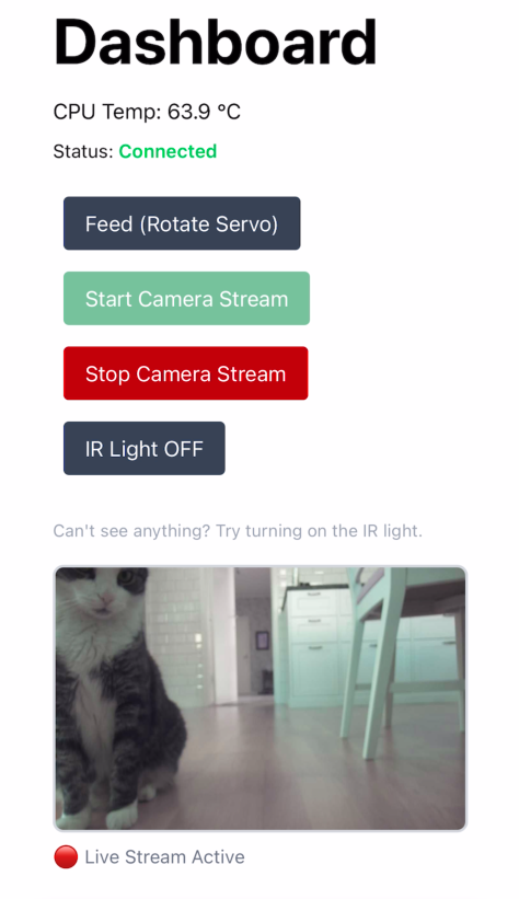

Software and website
Website mockup Dashboard thumbnail
The entire website backend and frontend are hosted on a Raspberry Pi 5. The only hosting related cost is renting a DNS. The backend is written in python using the Flask library. It handles incoming network requests that control the hardware of the device like dispensing food or turning the ir light off. For the camera stream,...
