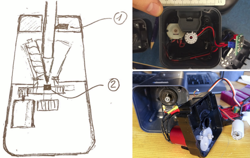

The amazon device is well designed. There is a switch to start the motor (1) when the pencil is inserted, and also an end switch (2) to stop it when the pencil tip reaches the bottom. A kind of logic makes you have to remove the pencil to reset.

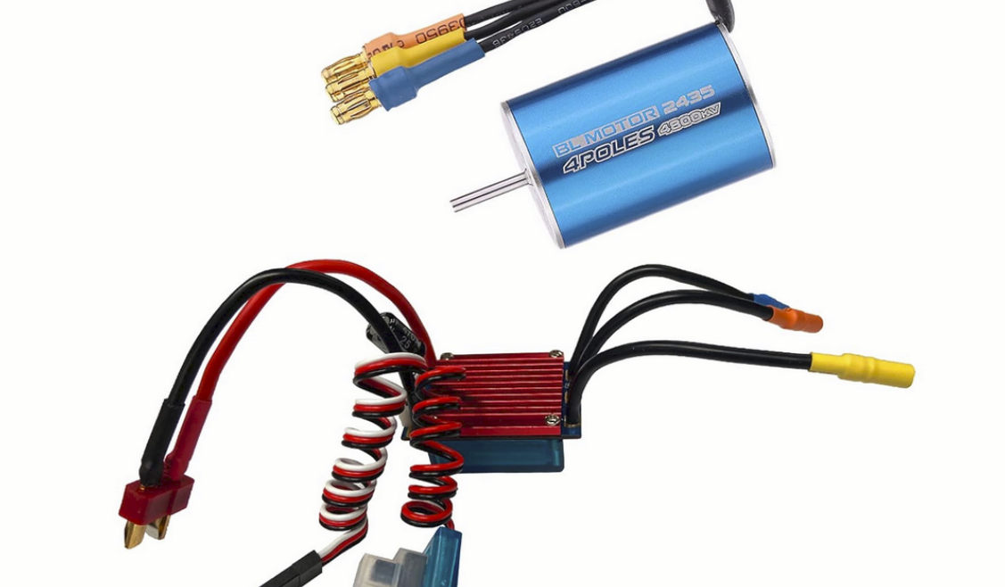

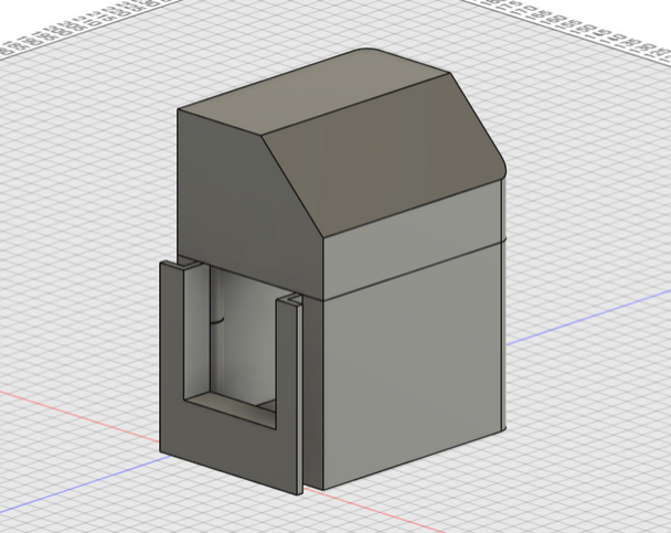

The ridiculously powerful replacement motor is a brushless inrunner (2435 4800KV). It fits almost exactly in the space of the original motor. Of course an additional case has to be printed to hold the ESC and the battery. The batteries are 2x 18650 Li-ion rated for high current discharge. I didn’t properly measured the output current, however even at half of their claimed 20A, we should have a decent amount of power to sharp a pencil.
