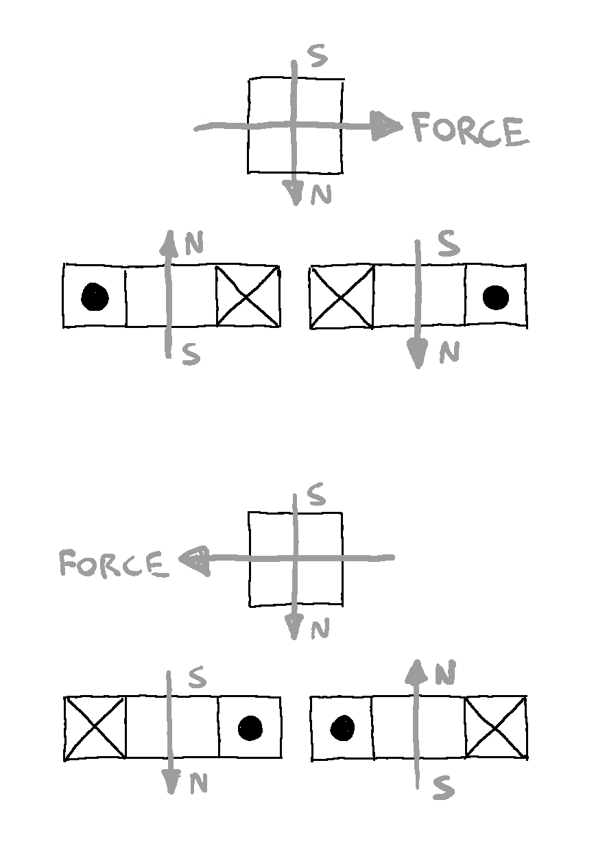

To generate force on the pendulum, a magnet is put on the pendulum, and coils are used below the magnet to push the magnet. The picture below shows a cross section of the two coils that are used in the device, and how current should be passed through them in order to generate a magnetic force to the right or to the left, depending on the direction of the current through the coils.

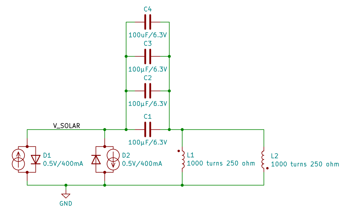

A much better solution turned out to be using two solar cells, and wiring them in anti-parallel, as can be seen in the following schematic of the device.
Each solar cell can be modeled as a light-dependent current source, with an intrinsic diode in parallel. If the pendulum is in the center, then both cells will be 50% shaded. The left solar cell pushes 200mA from GND to V_SOLAR, and the right solar cell pulls 200mA from V_SOLAR to GND. Both currents balance each other out, and no current flows through the intrinsic diodes of the cells, V_SOLAR is thereby 0V.
If the pendulum swings to the left, then the left solar cell will be (for instance) 75% shaded and the right solar cell 25% shaded. The left solar cell will now push 100mA from GND to V_SOLAR, the right solar cell will pull 300mA from V_SOLAR to GND. As Kirchoff's laws must be obeyed, 200mA will flow through the intrinsic diode of the right solar cell, resulting in V_SOLAR become a few hunderd millivolts negative. Similarly, if the pendulum swings to the right, V_SOLAR becomes a few hundred millivolts positive.

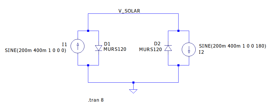

A sinusoidal movement of the pendulum results in a sinusoidal current of the solar cells, but due to the nonlinear I-V characteristic of the intrinsic diodes, the waveform of V_SOLAR starts to look more like a quare wave than a sine, which will turn out to be beneficial later on.
The pictures below show a simulation of the solar generator and the resulting V_SOLAR voltage. (The exact model of the diodes doesn't really matter, we just want to show the general behavior here.)
The dv/dt slope of the voltage is the highest at the zero crossings of the V_SOLAR, and this occurs when the pendulum passes through the mechanical center, shading both solar cells equally. Looking back at the magnetics picture earlier, this exactly when force should be generated on the magnet. In order to provide the right force at the right time, some capacitors in parallel are connected between V_SOLAR and the coils. Due to the I=C*dv/dt behavior of the capacitor, it will pass the most current through the coils at the zero crossings of the waveform, and that's exactly when we need it.
