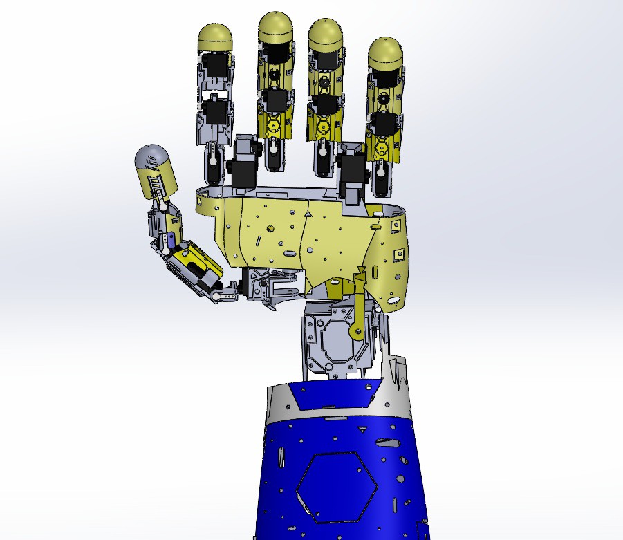

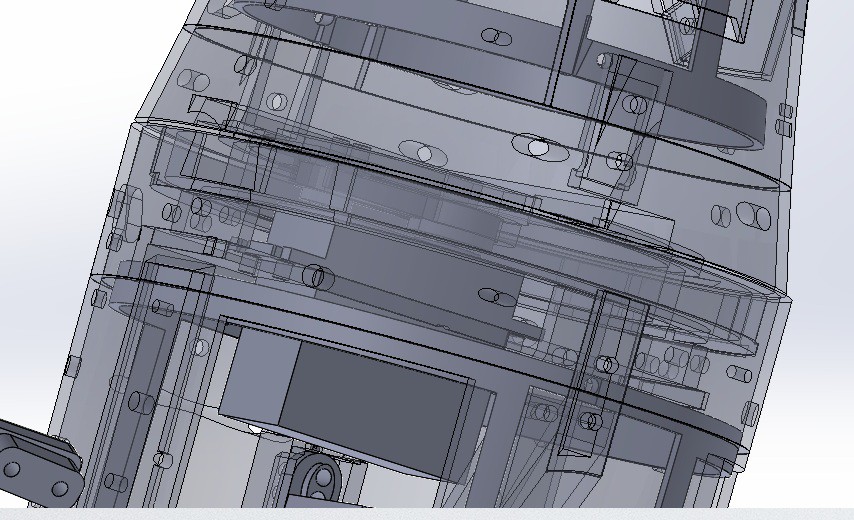

3D CAD design done in SolidWorks. The design was designed to allow a wide range of motion for the fingers and hand.

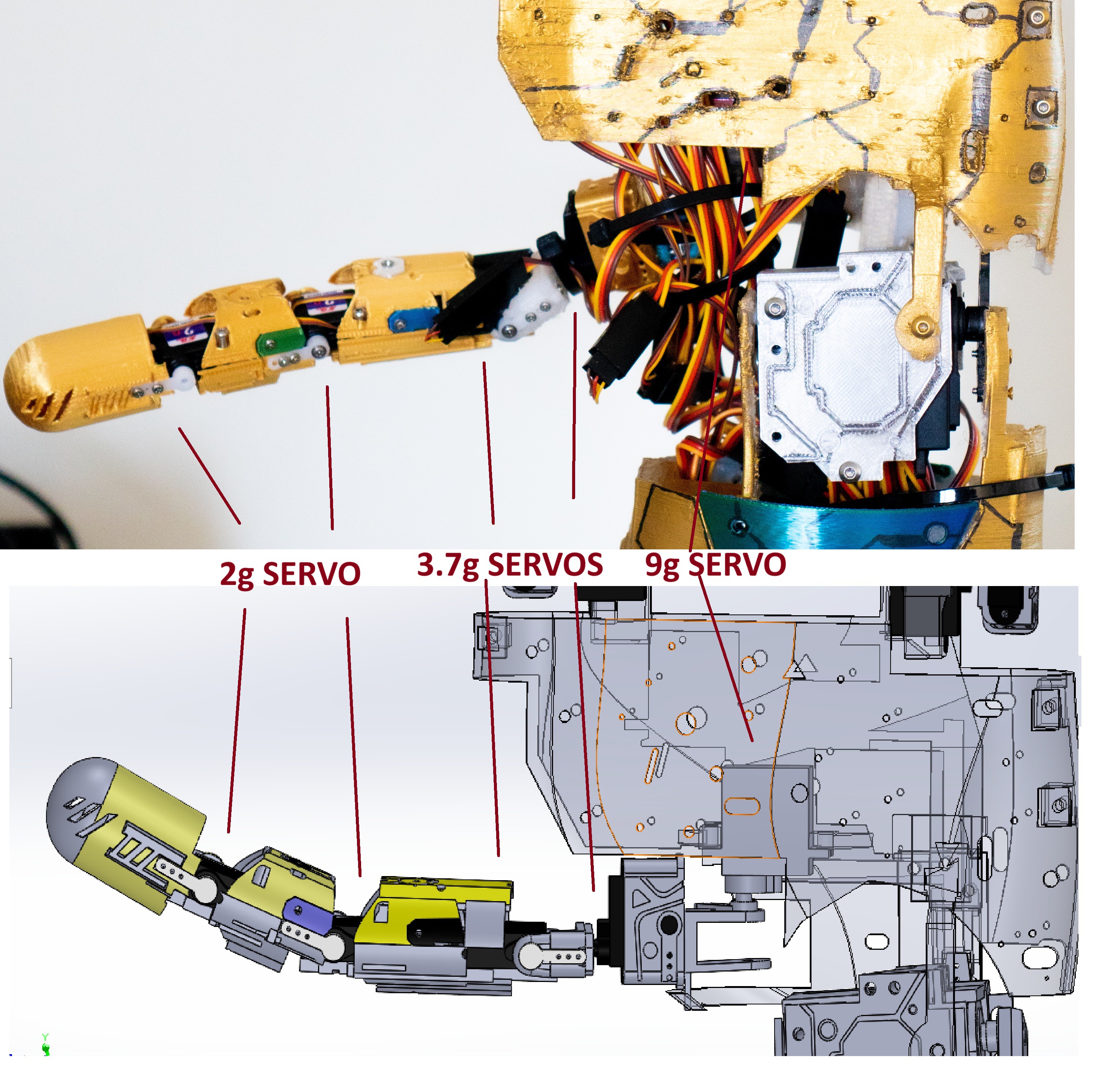

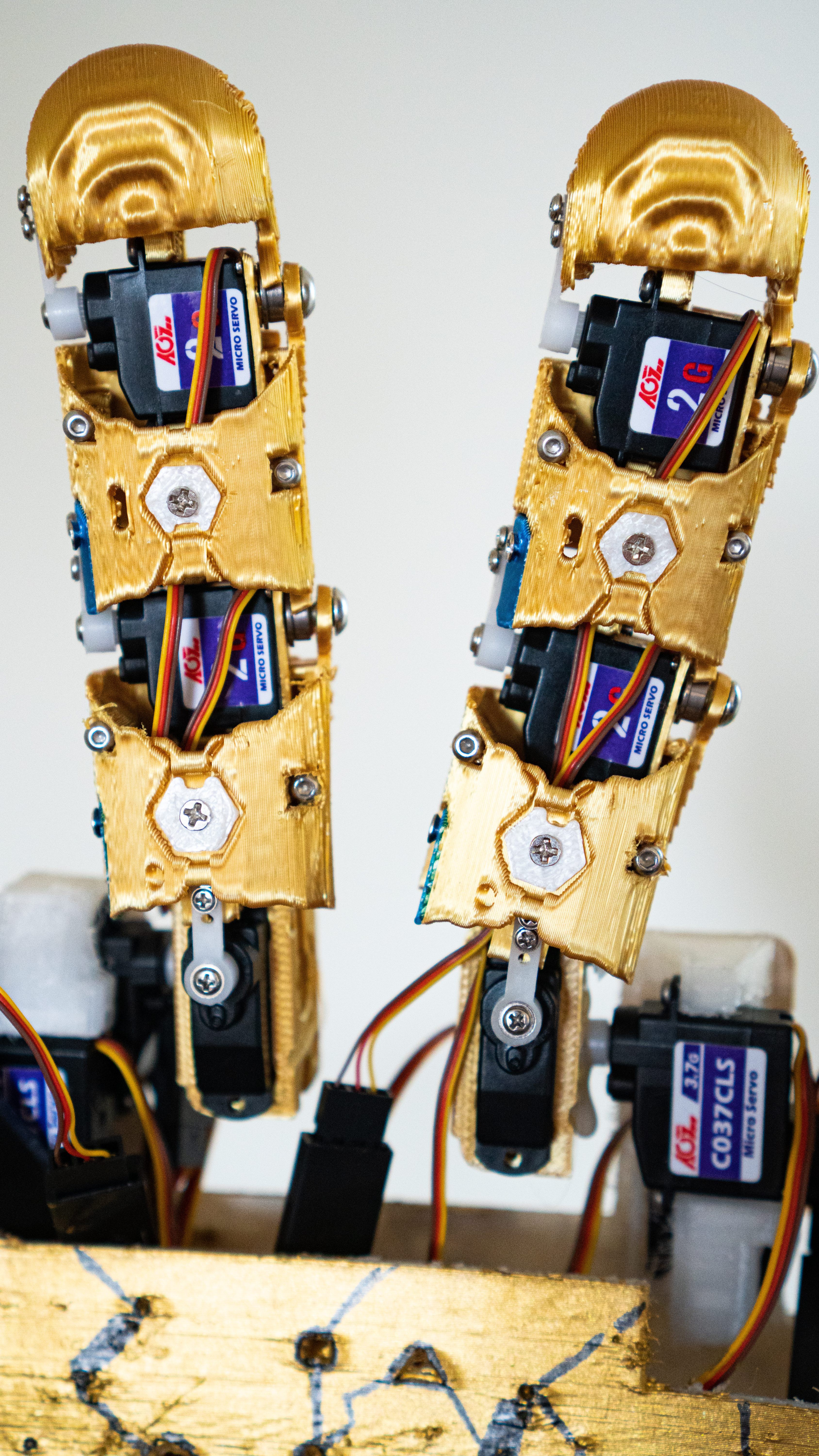

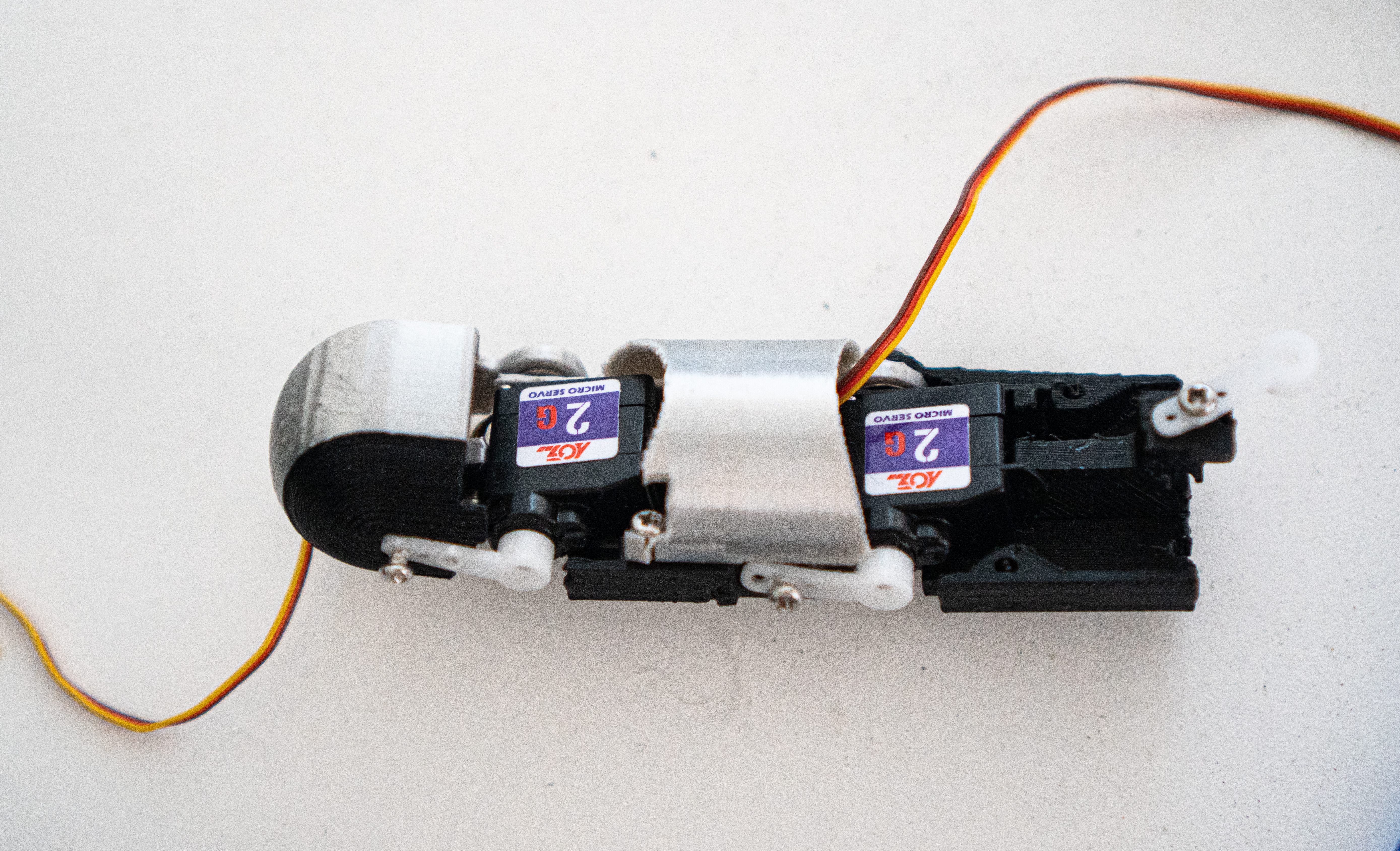

First tests performed: the top and middle of each finger have two 2g servos.
The base of each finger has 2 servos of 3.7g, (excluding the thumb which has 3 servos)
The thumb has 5 DOF - allowing high dexterity
The wrist has two degrees of freedom. I used two MG996R servos, whose structure I modified to take up less space, in what we could call a two-axis servo.

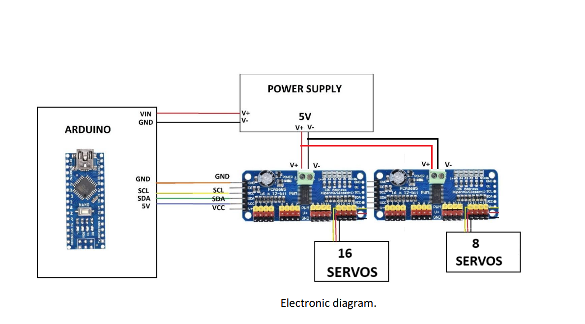

Electronic control diagram
The forearm has a 45kg servo that moves 270 degrees

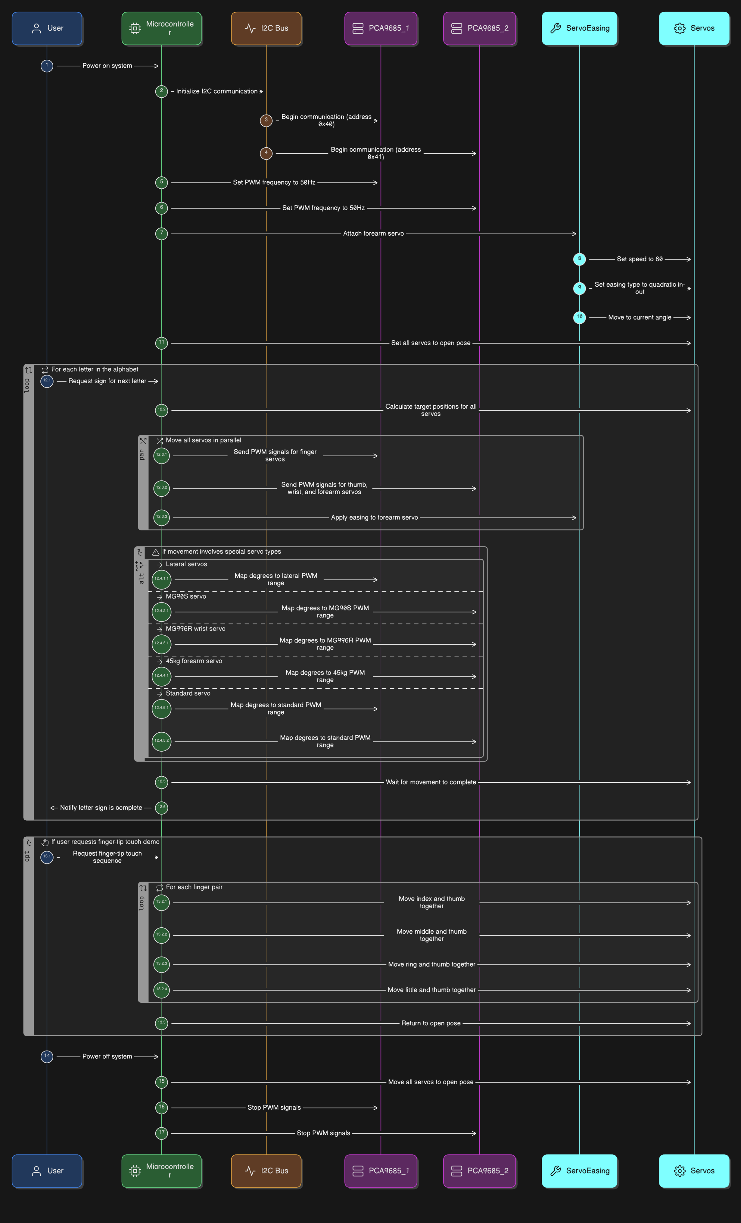

Finally, to test the robotic arm's dexterity, I programmed random movements. The programming isn't complicated; it consists of mapping the position in which you want each servo to move.
here is a coding flow chart:
