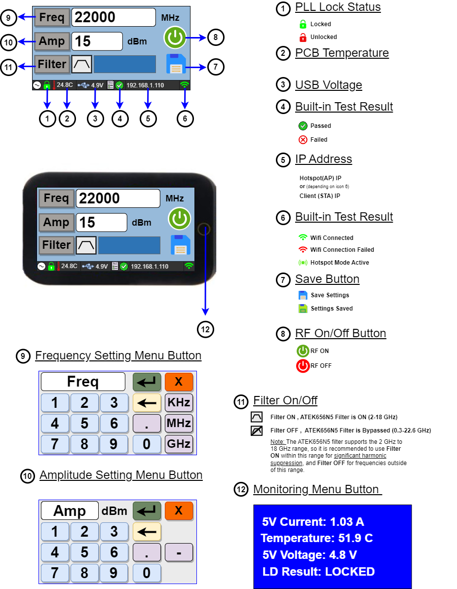

  • Control Interfaces
    DSG-22.6GHZ can be contolled with 3 opitons
    • USB
    • WIFI
    • Touchscreen Display
    • Web interface over Wifi
    • Python Interface Over Wifi or USB (Using SCPII commands)

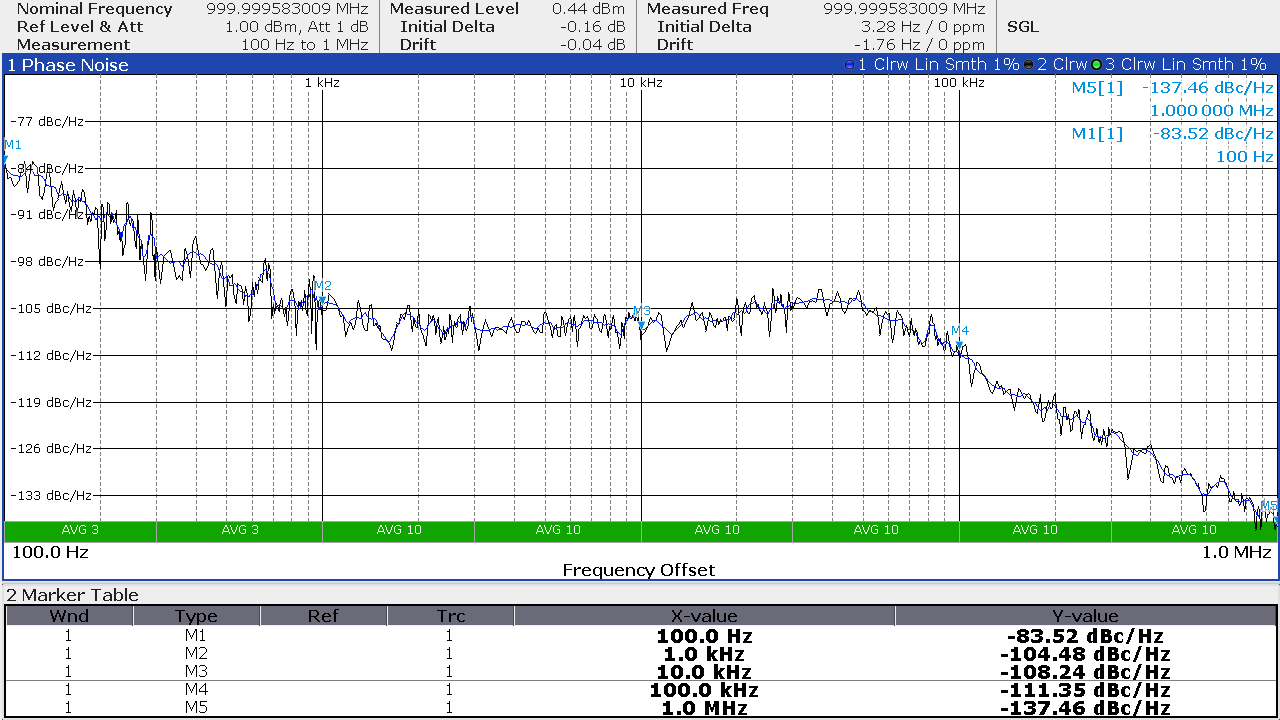

                                                                 Phase Noise Measurement @ 1GHz

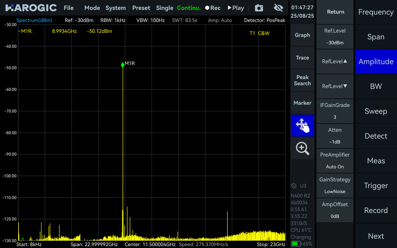

                                                                              Example Spectral view

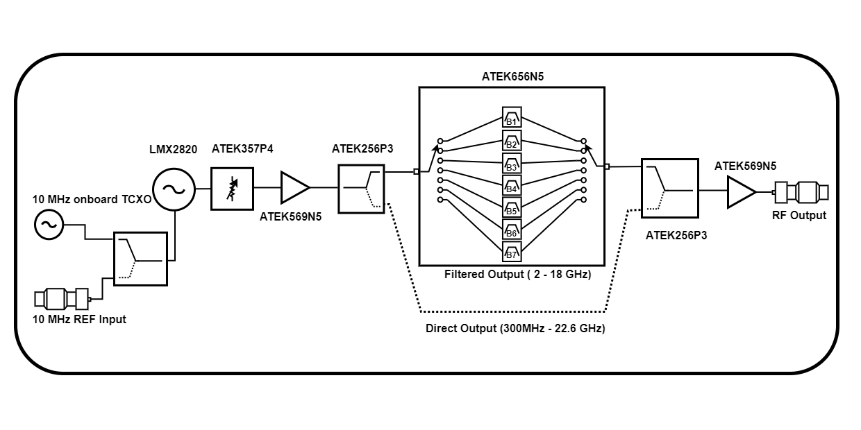

                                                                               Block Diagram
                                                                              Menu Descriptions

  • 1 × ATEK656N5 ATEK656N5 is a sub-octave switchable filter bank covering 2 – 18 GHz frequency band. Filterbank consists of an SP6T switch followed by 6 fixed frequency band pass filters which are followed by another SP6T switch.
  • 2 × ATEK256P3 ATEK256P3 is a wideband absorptive SPDT switch with low loss and high isolation. Frequency of operation starts from low frequencies close to DC, goes up to 18 GHz. Usable bandwidth covers 20 GHz.
  • 2 × ATEK357P4 ATEK357P4 is a wideband 5-bit Digital Step Attenuator with 30 dB attenuation range. Attenuator frequency of operation goes down to Low Frequency close to DC and goes up to 20 GHz. Bias and control voltages of the attenuator are positive, which eliminates the need for negative voltage rails.
  • 1 × LMX2820RTCR Phase Lock Loops - PLL
  • 2 × ATEK569N5 ATEK569N5 is a wideband driver amplifier covering 0.2 to 26 GHz frequency range. ATEK569N5 provides flat gain with single supply voltage. This allows users to easily realize wideband receiver frontends.
