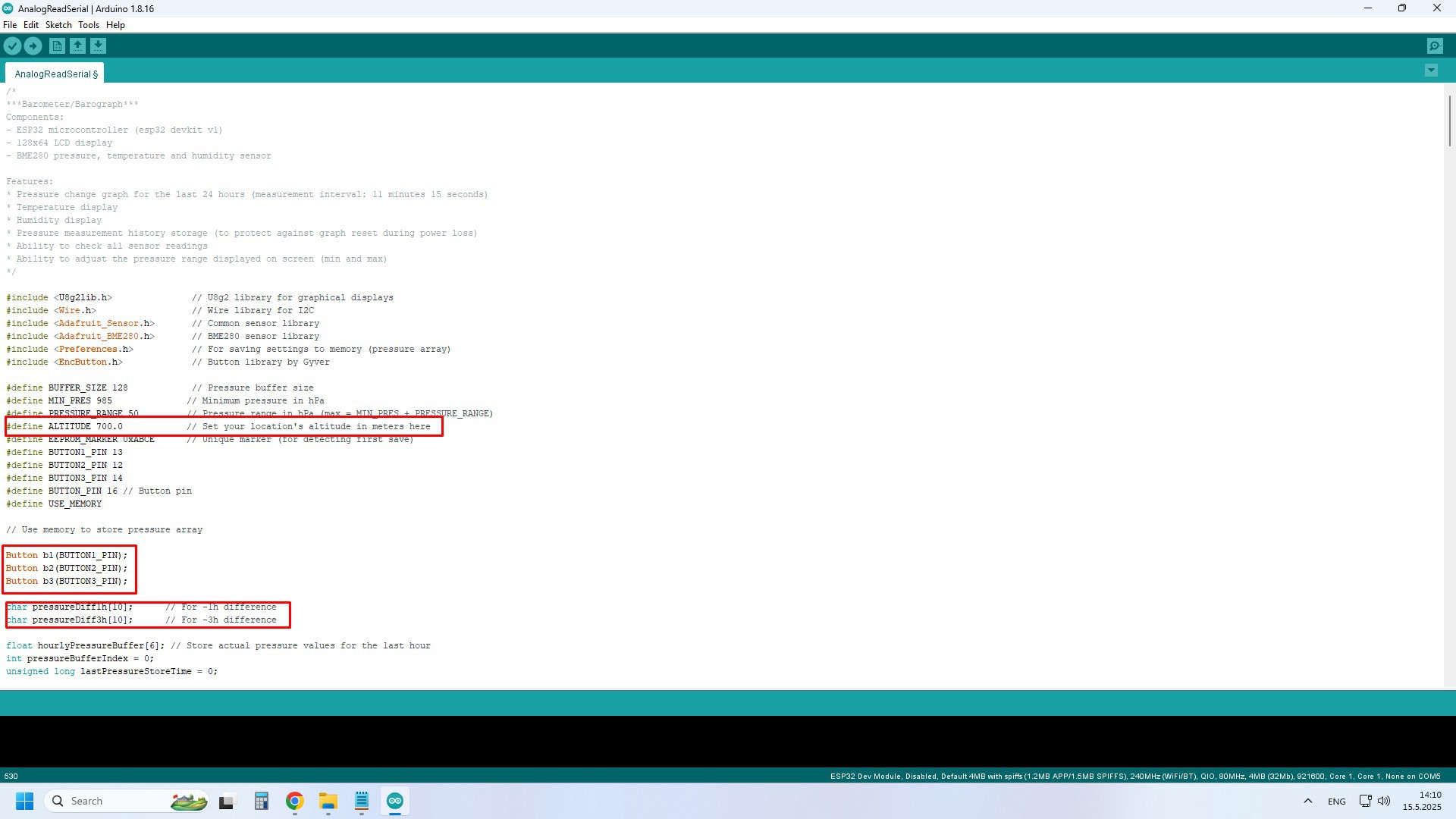

 As for the code, as I mentioned earlier, I made several changes and improvements. First, instead of mmHg (millimeters of mercury), the value of atmospheric pressure is expressed in hPa which is the official unit of measurement for atmospheric pressure.
Next, instead of absolute atmospheric pressure, the relative atmospheric pressure is now calculated, based on the altitude at which the device is located, and which we need to enter in the code. Three more screens have also been added to display the necessary parameters. Also, in case of accidental power failure, the graph is remembered and the next time the barograph is turned on, we do not need to wait 24 hours for fill up.

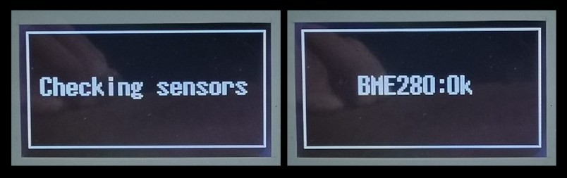

  Let's take a look at how the barograph works. Immediately after turning on the device, a message appears on the screen to check the BME280 sensor.
