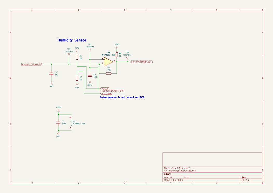

  • Sensing soil humidity using a cheap capacitance sensor

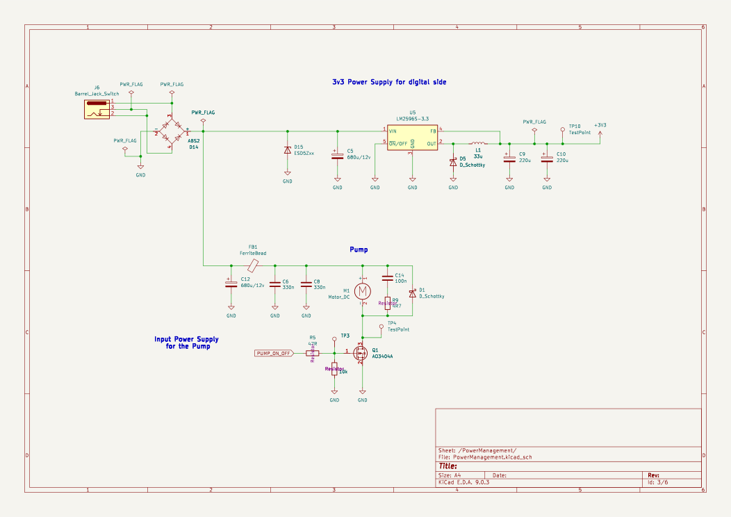

  • A water pump driven by a MOSFET
  • A soil moisture capacitance sensor (from AliExpress). Using a capacitance-based sensor over a resistance one has the advantage of avoiding probe corrosion due to electrolysis.

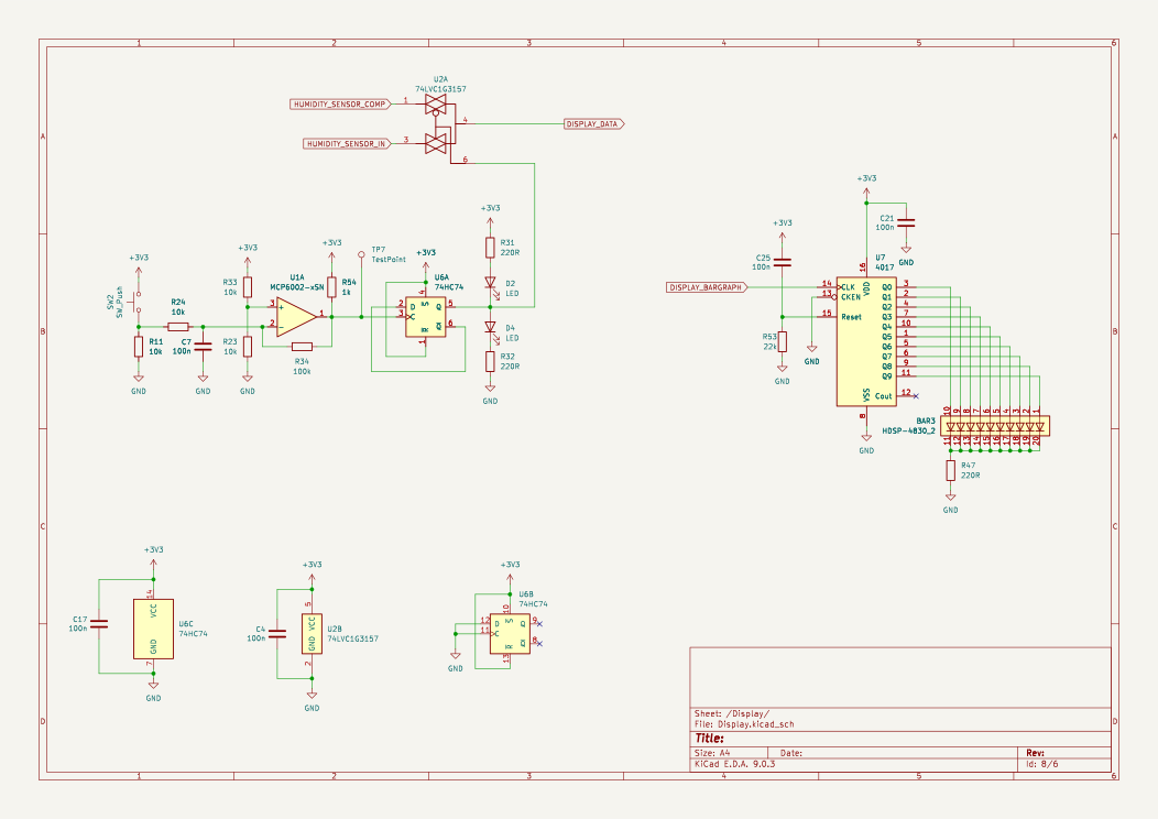

  • An LCD display showing the current humidity level and the humidity threshold to start watering, and a button to change what is displayed.
  • A bargraph showing how long the watering should take, and a button to change this value. Also, a potentiometer to select the level when soil is considered too dry.

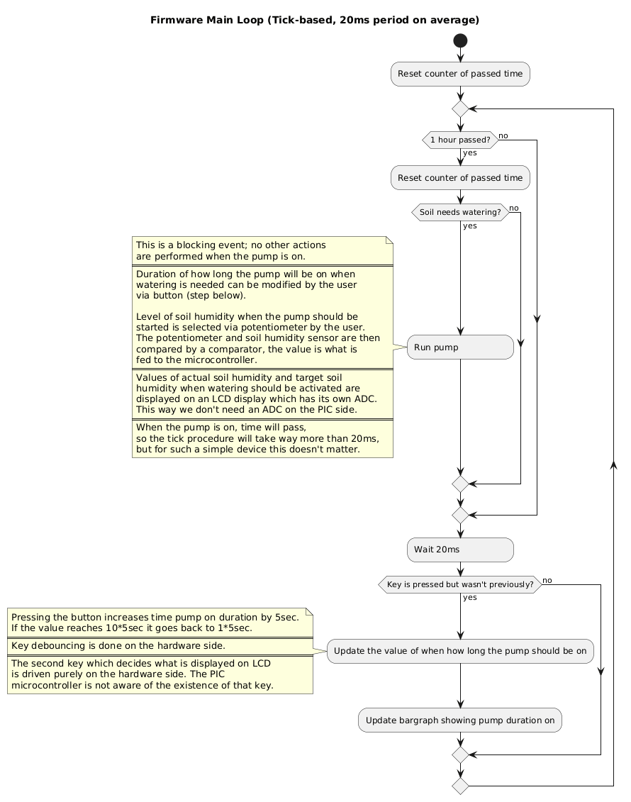

I was thinking that water won't disperse immediately into the entire soil volume when the pump starts, so the sensor might still report that it's dry if checks are too frequent. This could cause the device to water the plant multiple times in a short period.
To fix this, I think the firmware will check every hour if the soil is dry and only then start watering. One hour should be enough for the water to dissipate.

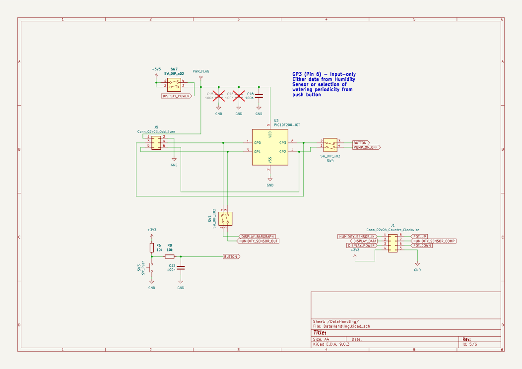

Other problem is that the PIC10F200 by itself doesn’t have enough pins to make something usable with it.
In the first version (never built) to fix that I've used the 74HC595, which is a serial-to-parallel output chip, and the 74HC4052, which is a multiplexer (many inputs to one output). The PIC10F200 would drive the 74HC595, and the 74HC595 would set the needed output pins and also configure the 74HC4052. I found this idea really cool, but after thinking about it, it might be too much work for such a small chip. I don't know.
Second version (built and presented here) is much simpler. Selecting what is shown on the LCD display is done using a button connected to a 74HC74D (D-type flip-flop) and then to a 74LVC1G3157DW (analog switch) - all done outside of the microcontroller, no code needed.
The bargraph is driven by a CD74HC4017 (decade counter), which is much easier to control (need only one pin from PIC microcontroller). There is only one button connected to the PIC10F200 for selecting how long the pump runs when the soil is dry. When the user pushes it, the duration increases; when it reaches the maximum, it rolls over to the minimum value.

Flow diagram is shown below.

  • The pump is broken
    Robert Gawron05/25/2026 at 08:30 0 comments
    It's been two months and the pump is already broken. It doesn't pump the water even though the motor is spinning. I still plan to use the same pump (because it's cheap) as before and just change the firmware.
    The pump wears out due to being turned on and off, but it isn't really important how long it stays on. That's why some boilers and water tower are build to overcome it (the pump works long but rarely, extra energy to operate the device later is stored as kinetic pressure or potential energy).
    Instead of checking the soil every hour, I will check it every 12 hours or maybe 16, and the pump's on-duration will be longer to compensate for this longer periodicity.
    Another thing is that maybe calcium residues from the water could mess up the inside of the pump. I could use demineralized water, but it's going to be problematic in the long run since the plant (a basil) drinks a surprisingly large amount of water.
    With this change in firmware I hope the pump will last 10-12 months with is good enough to me I think.
    Anyway, it's kind of disappointing that the whole device worked for such a short time.
