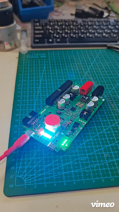

  • It's alive!
    Ioan Larionov12/23/2025 at 18:05 0 comments
    Finally, the very first Powerblock is assembled and works! What a miracle!

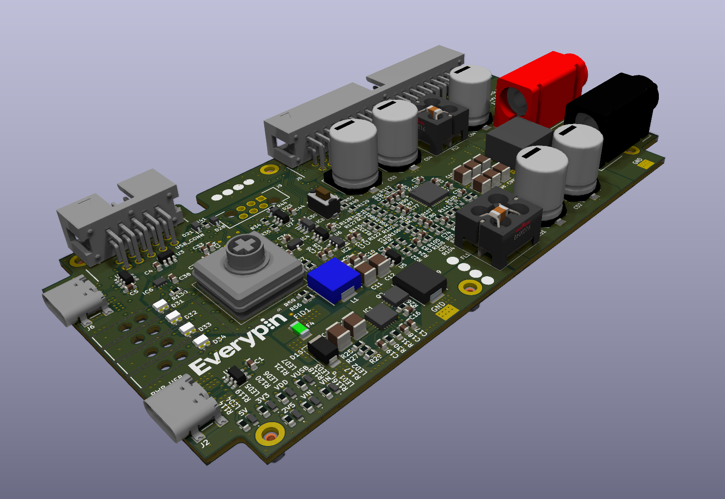

  • Design Update: PowerBlock-323 Housing
    Andrew10/03/2025 at 01:57 0 comments
    Our team at Encadra has joined the development of PowerBlock-323.
    We are contributing our experience in product design and enclosure engineering to help move the project forward.
    As part of this work, we are now evaluating two enclosure directions: one made from bent sheet metal and another from solid aluminum. Both versions share the same functional layout, but they differ in manufacturing methods and trade-offs.
    We will continue to share design updates as the project evolves. Next topics may include thermal aspects, assembly approach, and finishing options. Feedback from the community is very welcome.
