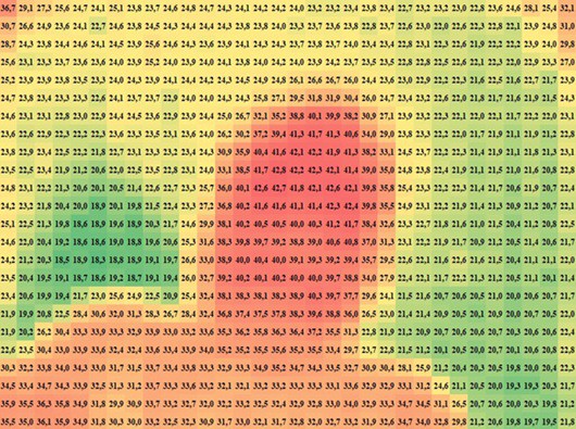

3. InfraRed (IR) array details
The MLX90642 IR array consists of (32 columns x 24 rows =) 768 FIR pixels/sensors, each individual IR pixel delivering 2 Byte of thermal data to be acquired via I2C commands i. e. registers. Simple math formulas have to be applied on the data to get object temperatures.
Temperatures in the range -40°C to 85°C can be measured, values can be acquired continuously or step-wise. I2C clock speed has to be high enough to be able to deal with the array refresh rate to avoid glitches.
Emissivity of the object could be modified too, but that's not necessary in the project context: human skin has an emissivity of approximately 1 what is the default value anyway.

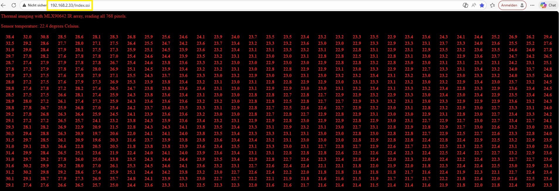

Implementation where all 768 pixels are read and temperatures are just shown in a web browser. You see that it's just a simple http connection with no certificates implemented, so I do not recommend making such a device available to the wider world (security is a whole different subject-matter).
The thermal data can automatically be imported via MS Excel web interface, or crawled and visualized via Python scripts.
This "webcrawling" is rather cumbersome, there exist faster and more elegant solutions such as MQTT I will not dive into here.

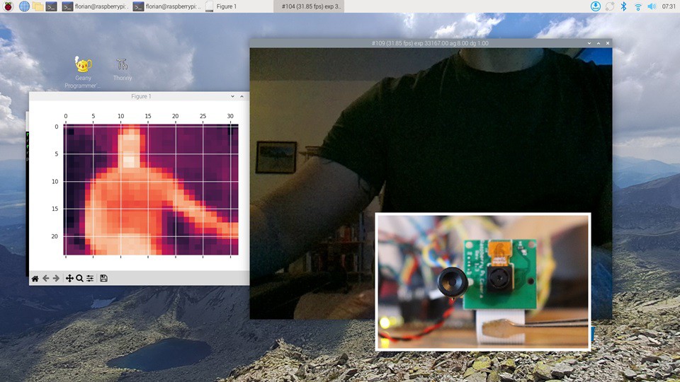

  • Sensor fusion with Pi camera
    Florian Wilhelm Dirnberger01/05/2026 at 08:17 0 comments
    Combining the IR array / thermal image with a Raspberry Pi camera module would be only a small step with the most recent prototypes.
    It's not really necessary for the UseCase home intrusion detection, and it would not make much sense to use the prototype in the discussed IoT context anyway, for I could actually connect the IR array to the Raspberry Pi via I2C. It is an entirely new sort of application.
    On a separate project page I might delve deeper into this topic (has been done before though, e.g. Raspberry Pi Thermal Imaging | Hackaday.io, let alone can easily be done with a Smartphone application these days).
    Edit: created the project page: Raspberry Pi Thermal Imaging (sensor fusion) | Hackaday.io
