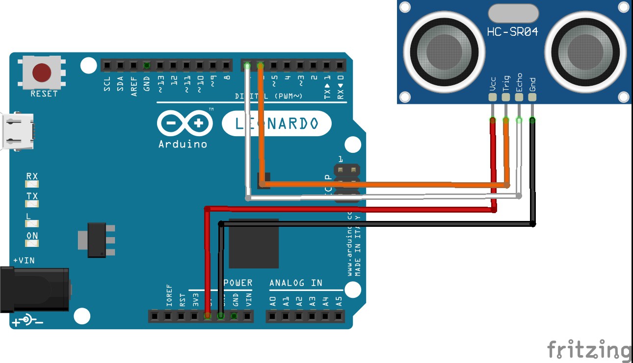

Circuit Wiring
- HC-SR04 VCC - Arduino 5v
- HC-SR04 GND - Arduino GND
- HC-SR04 TRIG - Arduino Pin 6
- HC-SR04 ECHO - Arduino Pin 7
That's all. Two pins for power, two pins for sensing.

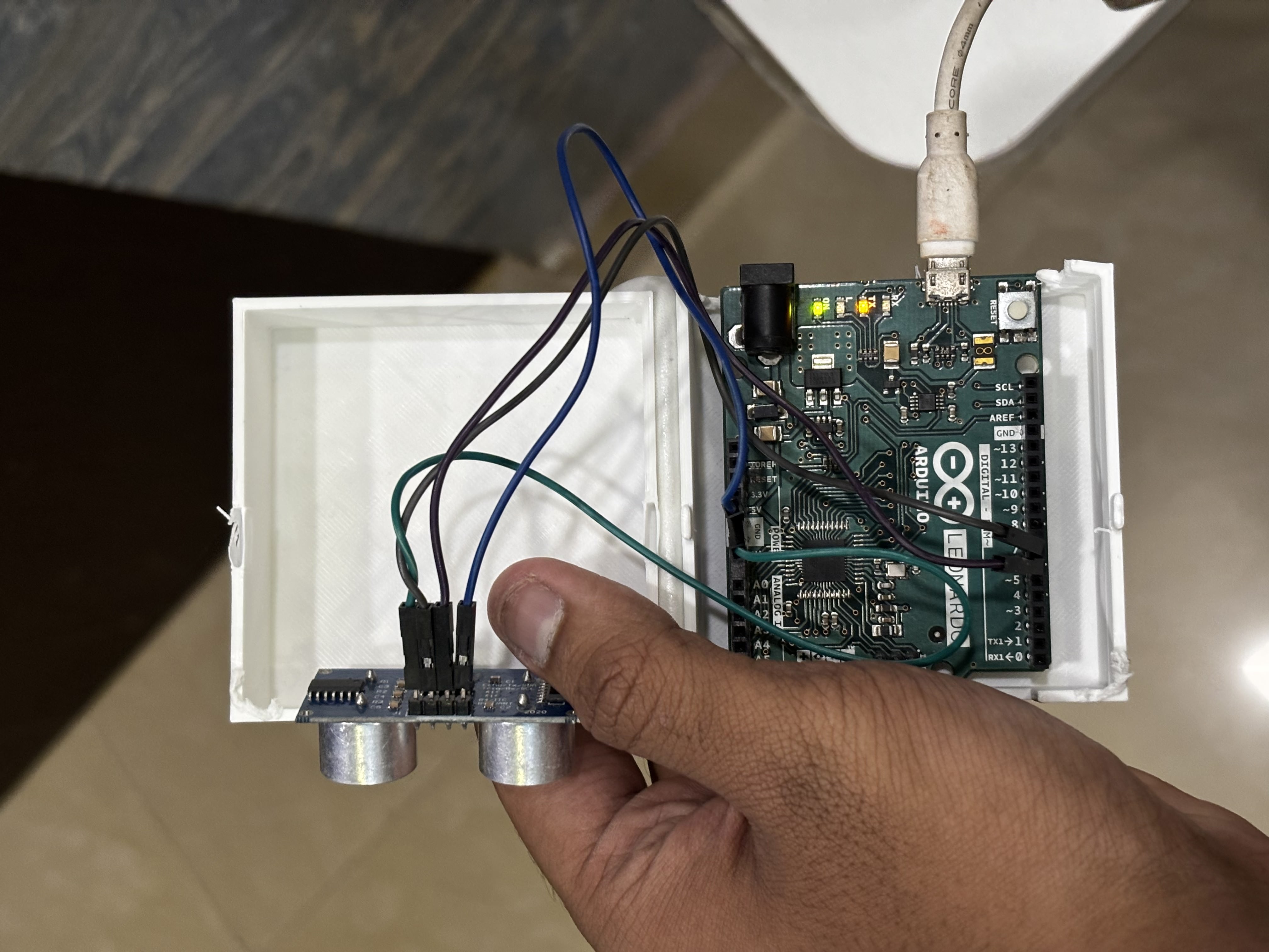

How It Works
- The HC-SR04 measures distance in front of it.
- If an object (like a parent, sibling, or curious pet) comes within 30cm, it sends the signal to the Arduino.
- The Arduino Leonardo pretends to be a keyboard and presses Ctrl+Tab.
- Your computer instantly switches to the next tab - usually something "innocent" like homework or WIkipedia.
