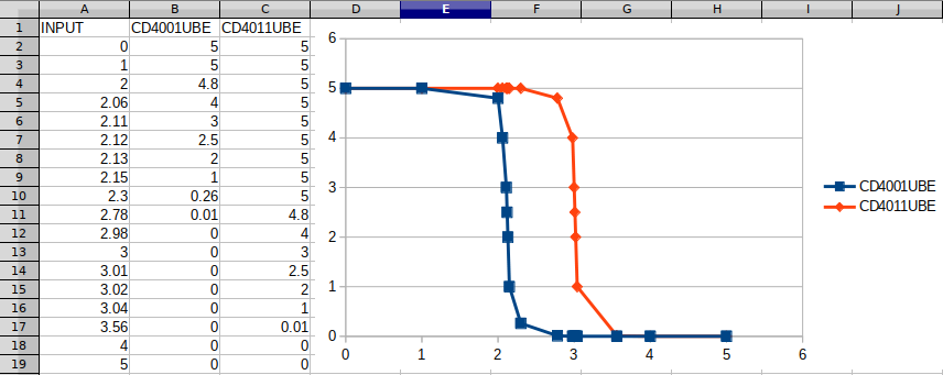

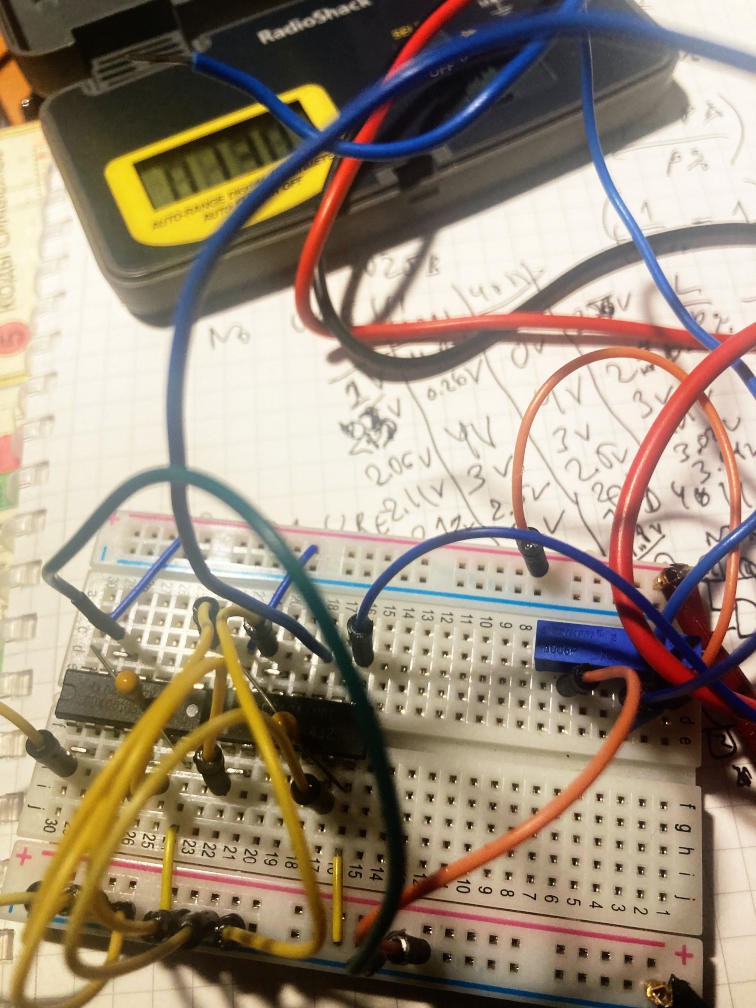

Those measurements were taken from actual CD4001UBE and CD4011UBE chips connected to +5V:
So we have this truth table (let's call intermediate value O):
| Input | NOR gate (CD4001UBE) | NAND gate (CD4011UBE) |
| 0V (N) | P | P |
| +2.5V (O) | N | P |
| +5V (P) | N | N |

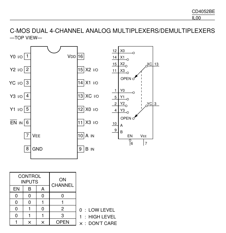

After that we may use CMOS 4:1 selector CD4052BE to choose from 3 pre-defined ternary values (1 value will never appear so we can simply repeat intermediate value twice to get all 4) to implement some specific ternary functions (like NOOP will implement ternary inverter and POON will implement ternary buffer):

https://www.digikey.com/en/products/detail/texas-instruments/CD4052BE/67307

It's tricky to do this discrete, because you don't know the input threshold voltage of just any chip (or, you have to characterize each one you use..). Fortunately, the average chip tends to be, well, pretty average, so although there's no guarantees here, the observed results are fairly likely.
