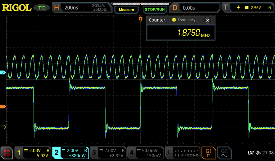

Implementation: I did some basic spice simulations based on that logic style but did not test it is practice until I integrated into into PCBFlow, a project to synthesize high level hardware description language into discrete logic circuits PCB layouts.
A first attempt to implement AML resulted in a nonfunctional design.
Finally, the second attempt succeeded, resulting in very robust logic that worked up to 15MHz, the limit of my function generator. I also tested a logic variant that uses G175 single gate D-Flipflops to increase density further.
While there is also appeal to use discrete transistors logic style, AML is a nice alternative for discrete logic projects. Especially if you want something that is a bit faster than bipolar switching transistors...
