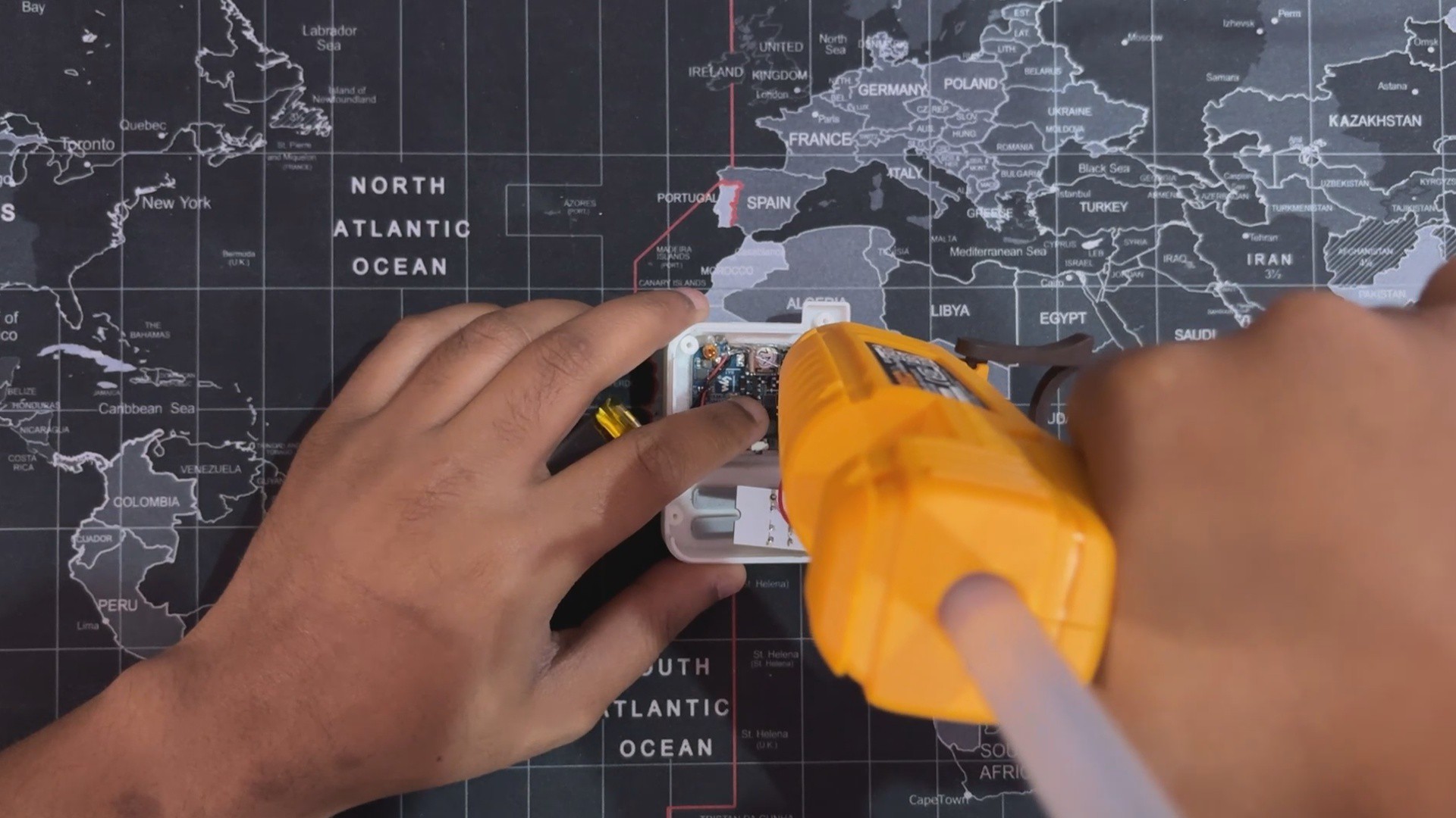

The switch PCB assembly begins by placing all the tactile push buttons in their position.
We turn the board over and use a soldering iron to solder each pad.

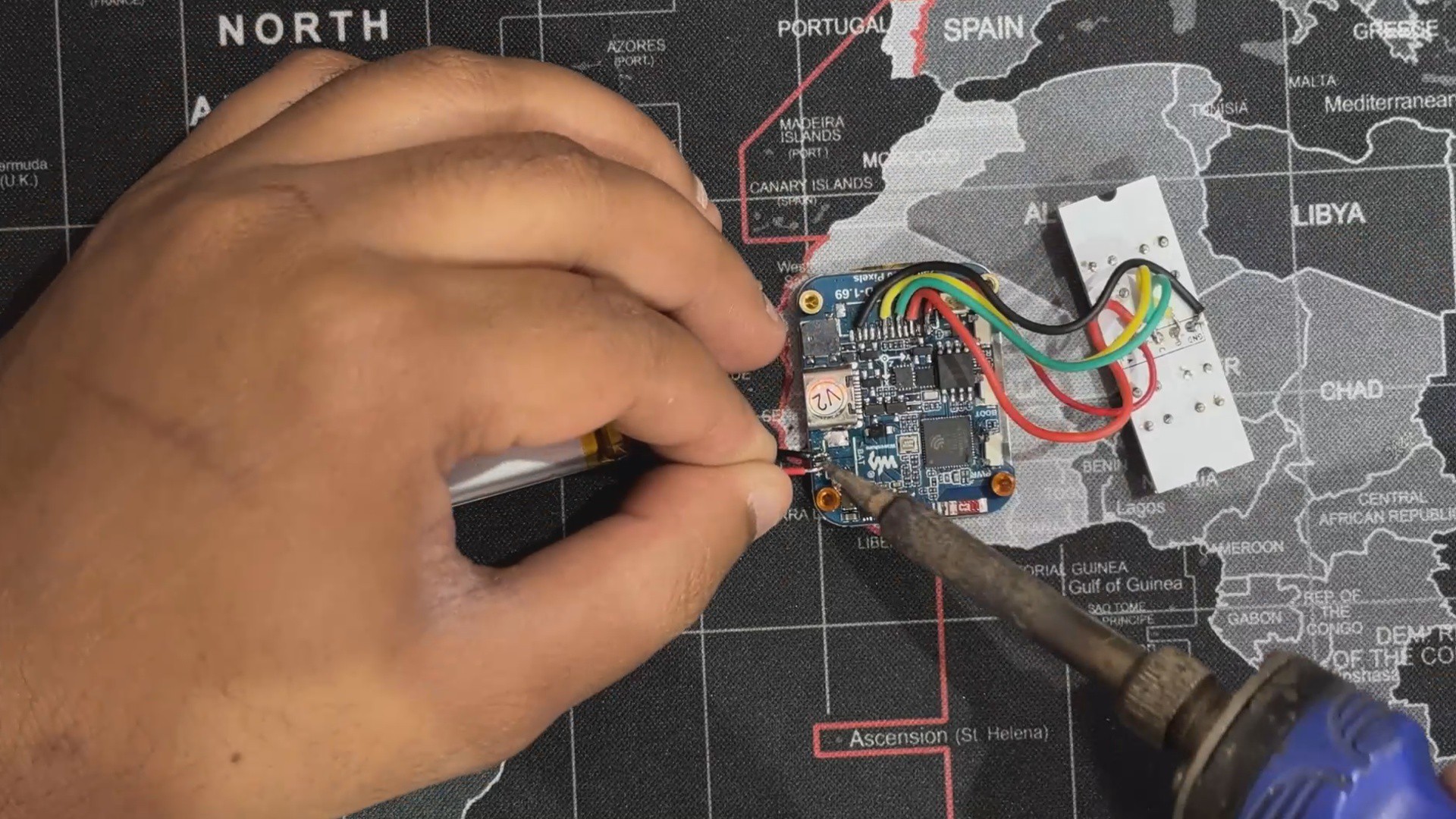

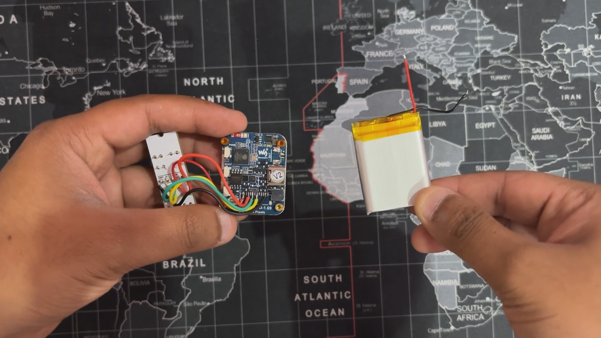

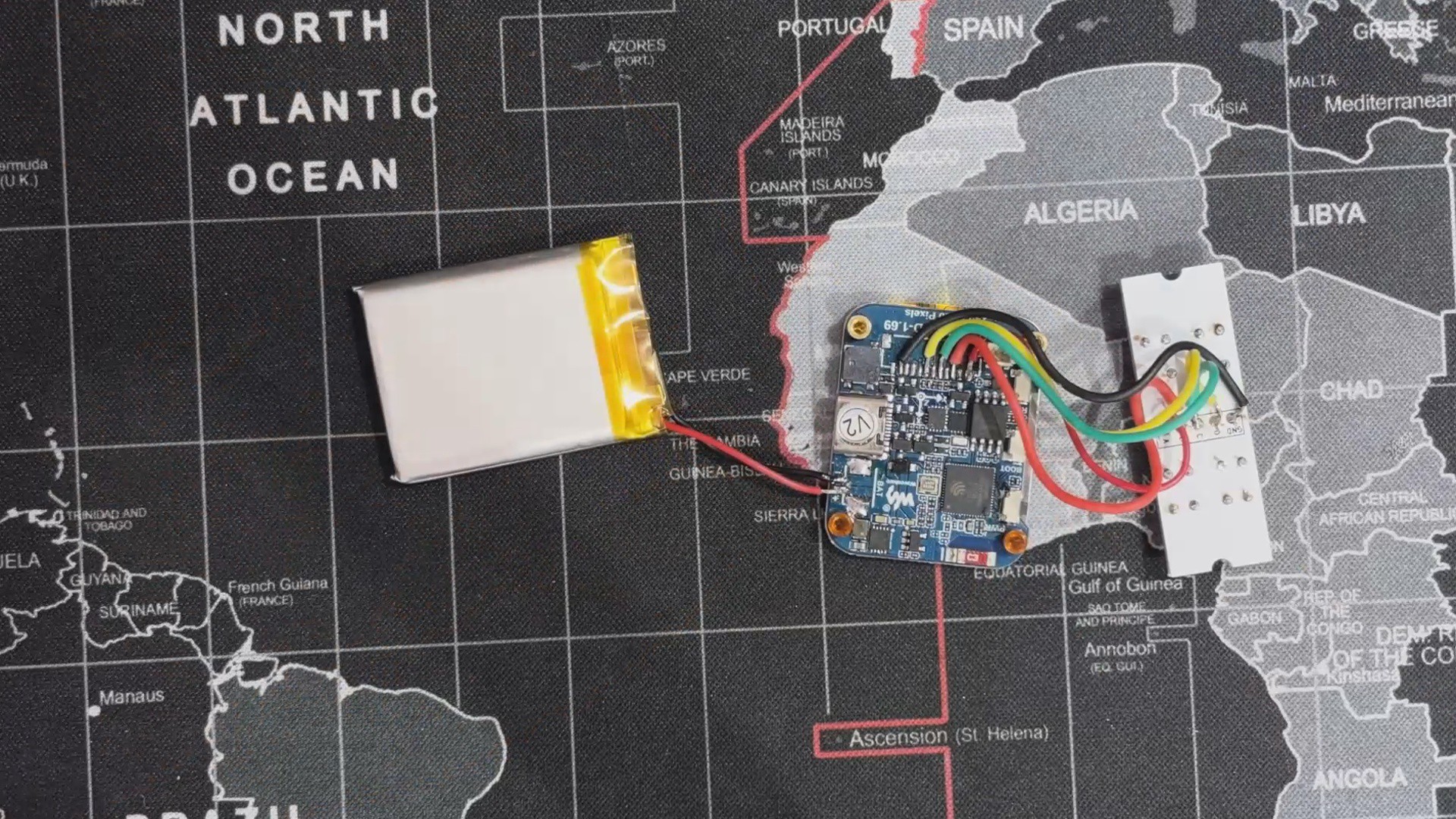

We start the switchboard and display assembly process by soldering jumper wires to ESP32's GPIO18, GPIO16, GPIO2, GPIO10, and GND.
Next, we paired the switchboard with the ESP32 display board using the jumper wires; we simply followed the attached wiring diagram for connection.

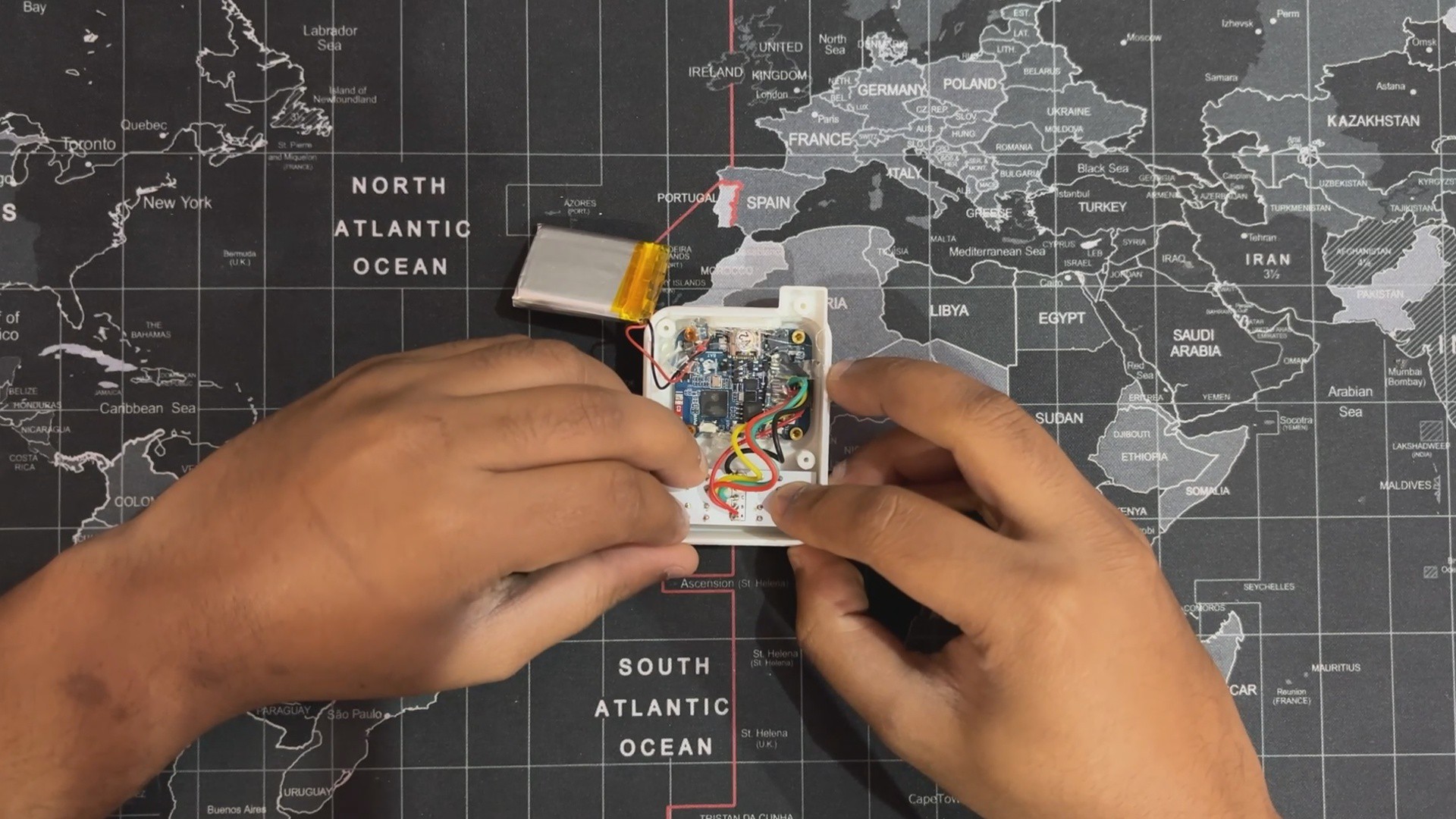

Power Source Assembly
Next comes the power source assembly process; here we are using a 600 mAh 3.7 V LiPo cell whose positive and negative terminals we connect with the ESP32 Display's battery terminals using a soldering iron.
The ESP32 1.68-inch display we are using features a built-in lithium/LiPo charging IC that charges and discharges the cell properly, eliminating the need for a power circuit.

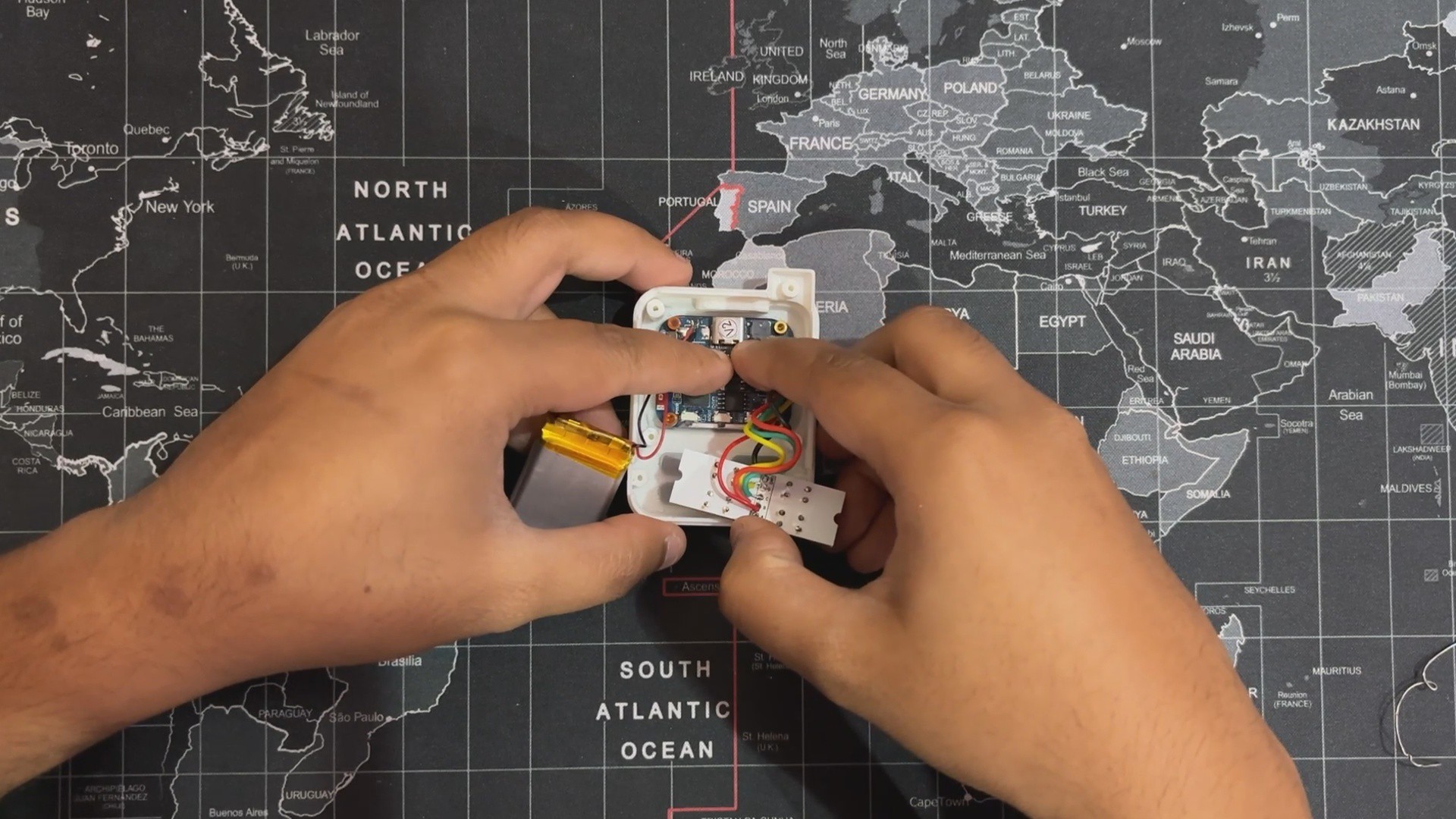

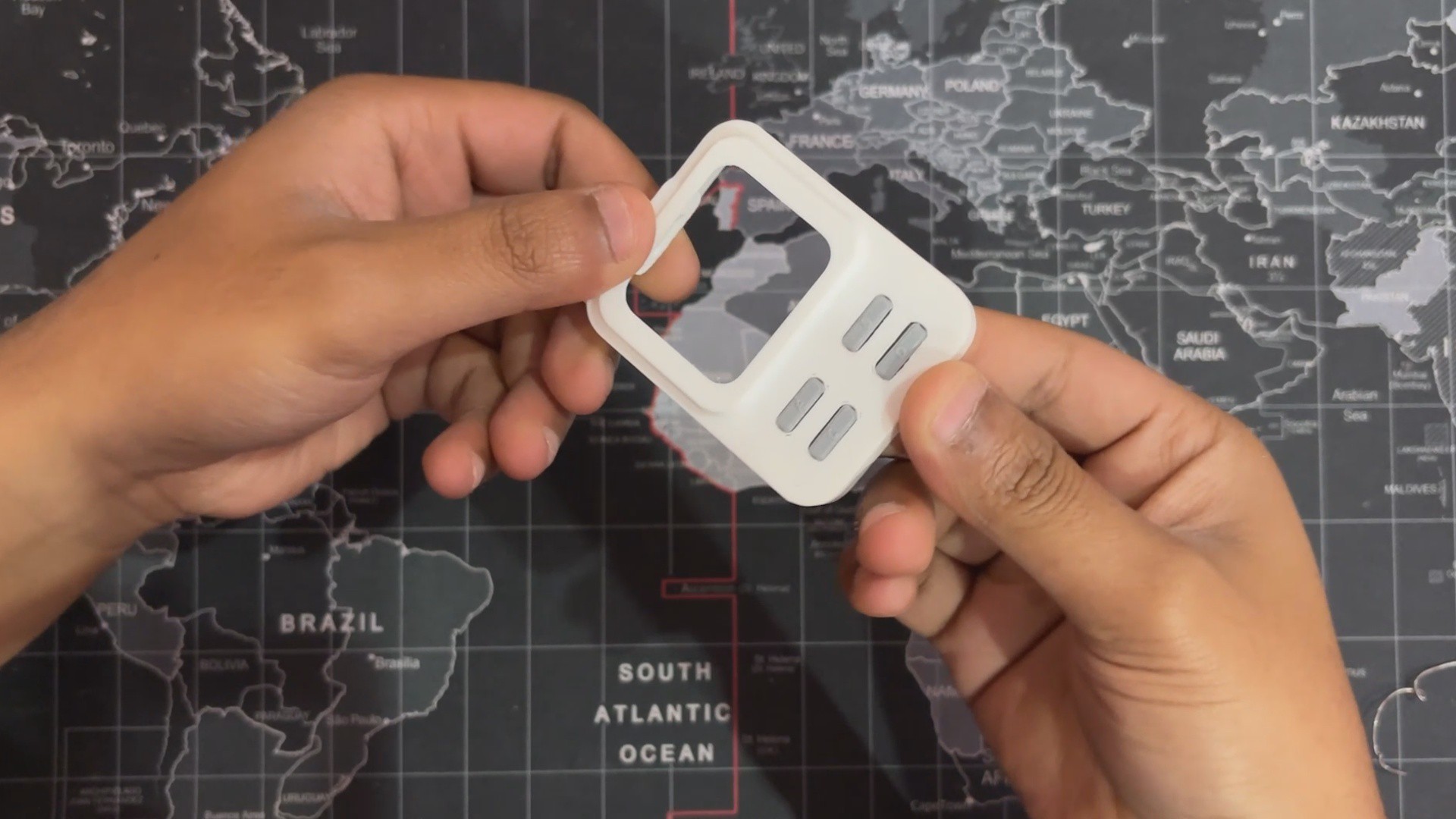

Body Assembly

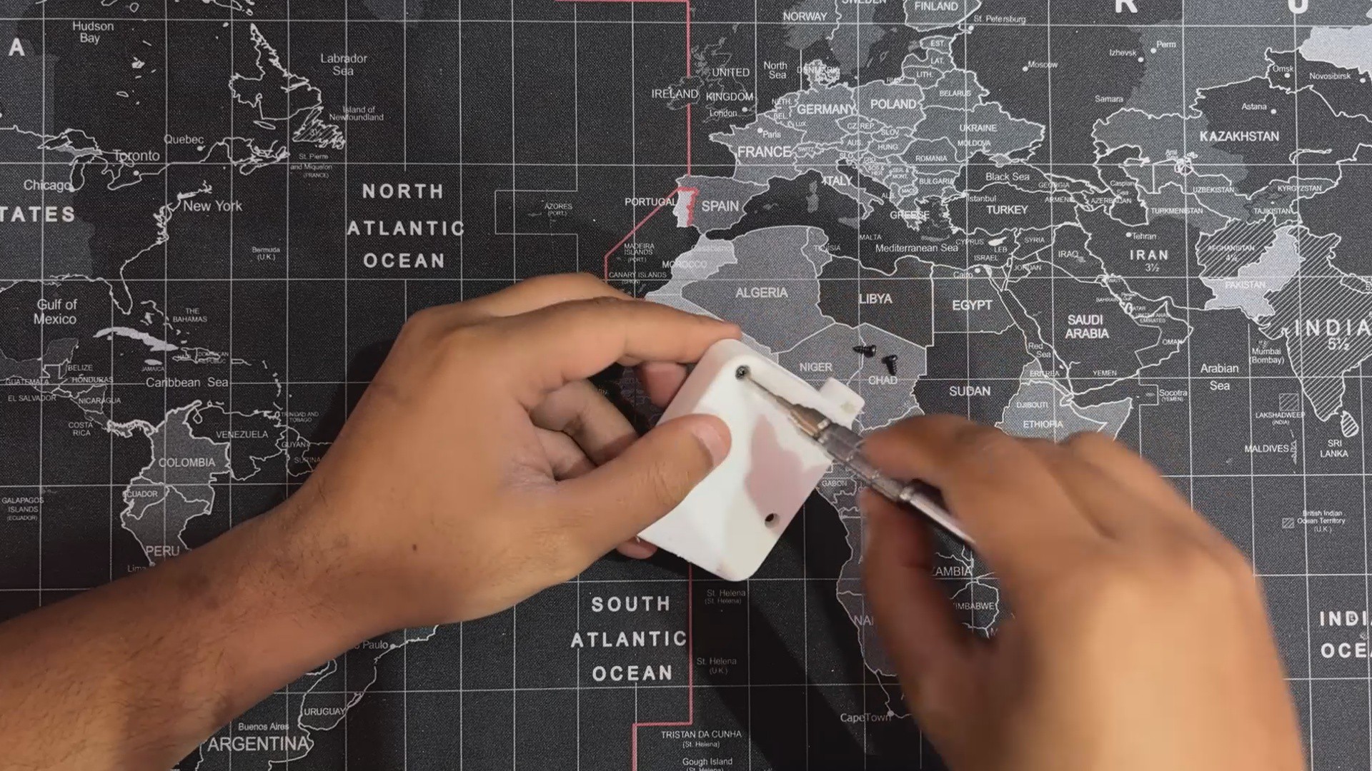

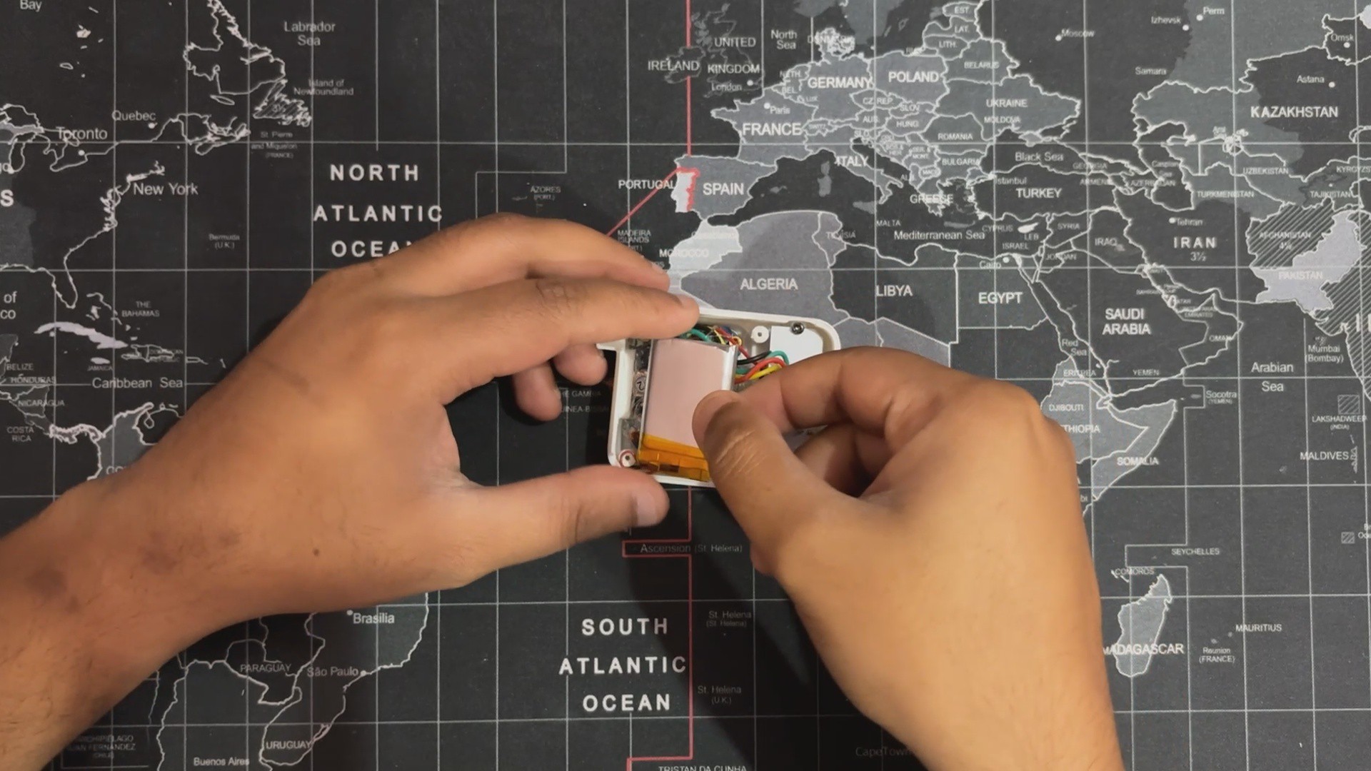

We begin assembling the body by placing the 3D-printed button actuators into their designated slots. Each button is labeled A, B, C, or D to ensure correct placement and orientation.
Next, the ESP32 display is positioned and secured using a bit of hot glue.
The switchboard is then mounted onto two screw bosses and fastened with two M2 screws.

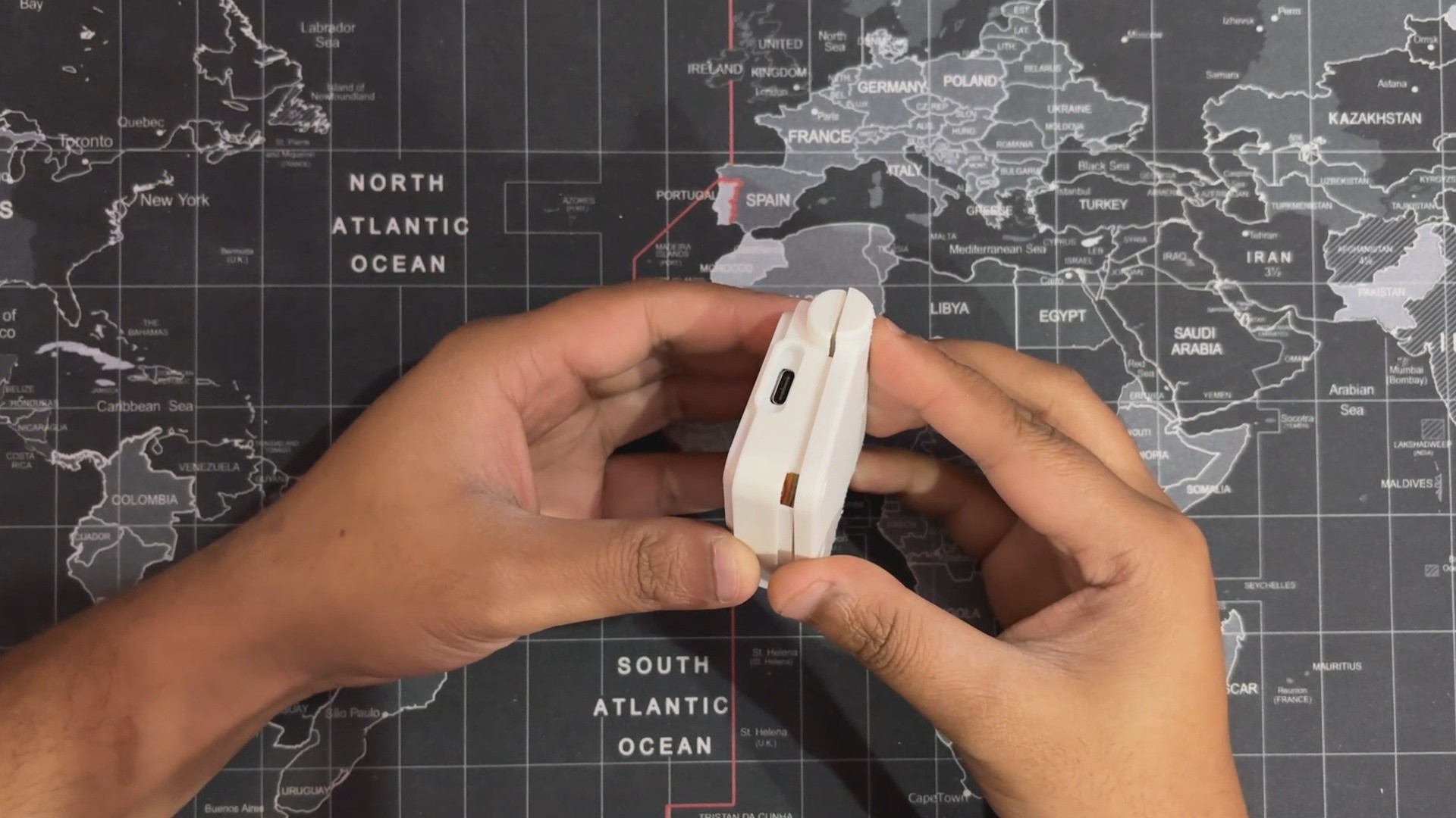

After that, we insert the LiPo cell into the enclosure and close the device from the back using the lid. The lid is held in place with four M2 screws.
With that, the device assembly is complete.

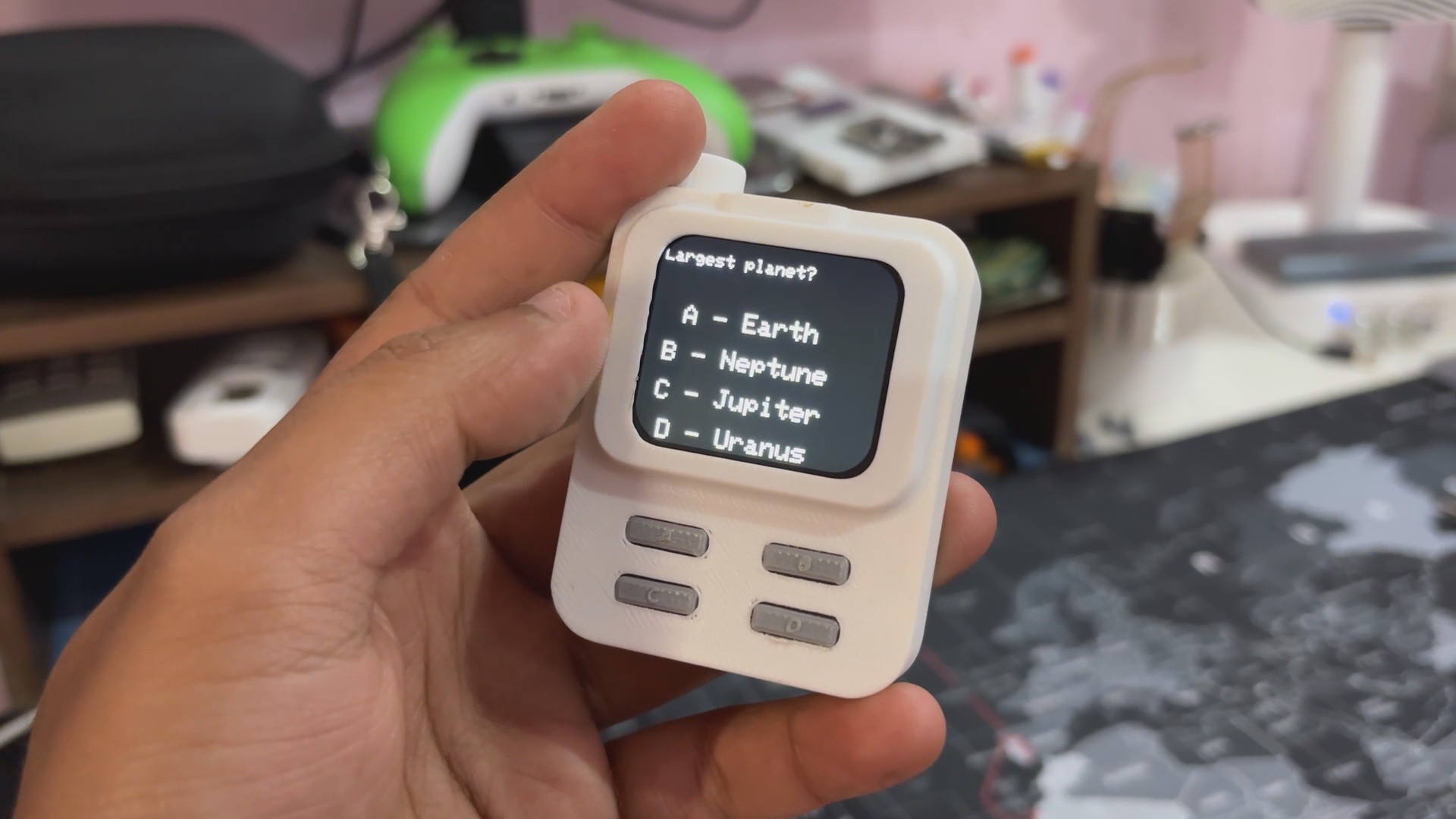

CODE
Now comes the most important bit of this project, which is the code. here's a small breakdown of the code we used and it's a simple one.

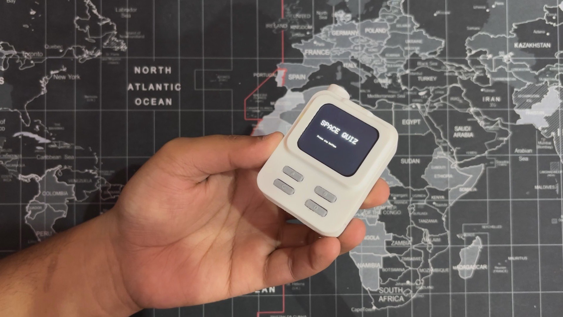

voidshowSplash(){
gfx->fillScreen(BLACK);
gfx->setTextSize(3);
gfx->setTextColor(WHITE);
gfx->setCursor(40, 80);
gfx->println("SPACE QUIZ");
gfx->setTextSize(1);
gfx->setCursor(60, 150);
gfx->println("Press any button");

We start by including the graphics library and defining basic colors for use throughout the UI.
#include <Arduino_GFX_Library.h>#define BLACK 0x0000#define WHITE 0xFFFF#define RED 0xF800#define GREEN 0x07E0
Next comes the Display Initialiazation, we use the below section that Sets up SPI communication and initializes the ST7789 display with 240×280 resolution and portrait layout.
Arduino_DataBus *bus = new Arduino_ESP32SPI(...);Arduino_GFX *gfx = new Arduino_ST7789(...);
This Section Defines the backlight pin and four input buttons mapped to answer choices A–D.
In Loop first there is the Sleep Mode Handling part.
if (isSleeping) { ... }
If the device is in sleep mode (backlight off), it waits for Button A to wake it. We also added a short delay (SLEEP_LOCK_DELAY) to avoid accidental wake from the same long press.
Then there is the Quiz Start Trigger.
if (!quizActive) { ... }if (!quizActive) { ... }
If the quiz hasn’t started yet, any button press will begin the quiz.
In the end, we have added the answer checking and progression function.
checkAnswer(...);nextQuestion();
After an answer is selected, the device shows feedback and moves to the next question. If all 20 questions are done, it shows the final score and resets after 10 seconds.

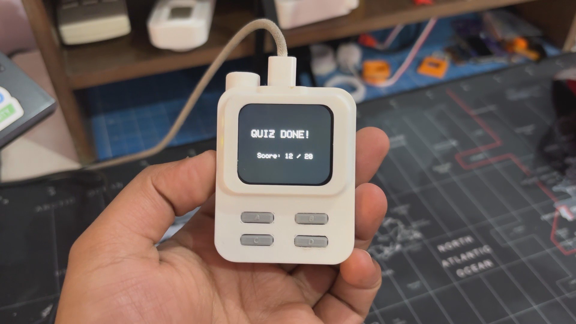

RESULT
Here's the end result of this small build—QuasarQ, a space quiz device designed to spark curiosity and make learning fun. It’s compact, responsive, and built with care, from the custom 3D-printed enclosure to the tactile button layout and crisp display interface.
Right now, we’ve only added a set of 20 questions just for testing purposes. The actual plan is to build a full database of 200+ space-related questions. The idea is that the device will randomly pick 20 questions from that larger pool every time it runs, so each quiz session feels fresh and different.
That’ll make it way more engaging, a bit more challenging, and definitely more educational—especially for kids who keep coming back to play and learn.
For now, the build is complete, and all the related files are included in the attachments.
