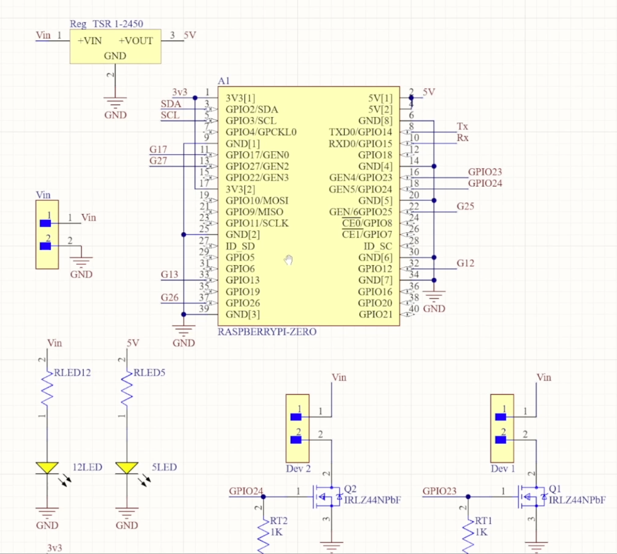

Circuit
Circuit – Full Explanation
The circuit is simple and reliable. We use two low-side N-MOSFET switches controlled by the Pi’s GPIO pins.
  • Each device connects from +12 V → Device → MOSFET Drain.
  • The MOSFET Source goes to Ground.
  • The MOSFET Gate is driven by a Pi GPIO pin through a 100–330 Ω resistor.
  • A 100 kΩ pulldown from Gate to Ground keeps the MOSFET OFF at boot.
  • For inductive loads (relay/solenoid/motor), add a flyback diode across the device: cathode to +12 V, anode to the device/MOSFET side.
  • Common ground is mandatory: connect Pi GND to the 12 V supply negative so the gate signal has the right reference.
Behavior: When the Pi drives the gate HIGH, the MOSFET turns ON and completes the path to ground → the device receives power from 12 V and turns ON.
When the gate goes LOW, the device turns OFF.

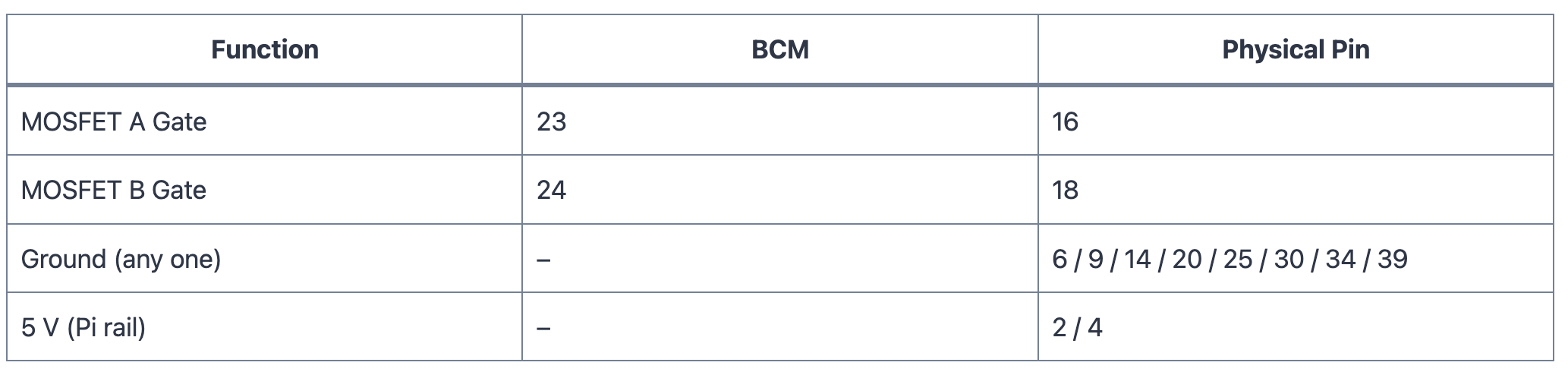

Pin Map (BCM → Physical Header Pin)
We use BCM numbering in the code. The physical positions help if you wire from a loose Pi.

We have two rails:
  • 12 V for the devices
  • 5 V for the Raspberry Pi
Power the Pi in one of two ways:
  1. A good 5 V USB supply into the Pi, or
  2. A switching regulator like TSR 1-2450 stepping 12 V down to 5 V.
Avoid a linear 7805 from 12 V; it overheats at Pi currents.
If you might use USB and the 5 V regulator at the same time, isolate them—add a series Schottky diode from the regulator to the Pi 5 V rail (or use an ideal-diode/power-mux IC) to prevent back-feeding.
Voltage Regulator
The TSR 1-2450 is a drop-in switching replacement for 7805. It delivers a cool, efficient 5 V up to 1 A from 9–12 V input.
Place a 10–22 µF capacitor near VIN and a 22–47 µF capacitor near the 5 V output for stability during Wi-Fi spikes.
If you plan heavy 5 V USB devices, consider a 1.5–2 A regulator.
GPIO Voltage
Pi GPIO is 3.3 V logic. Pick MOSFETs that turn fully ON at Vgs ≈ 3.3 V with low Rds(on) (e.g., AO3400A, IRLZ44N, FQP30N06L).
Always include the gate series resistor and the 100 kΩ pulldown for clean, predictable switching.

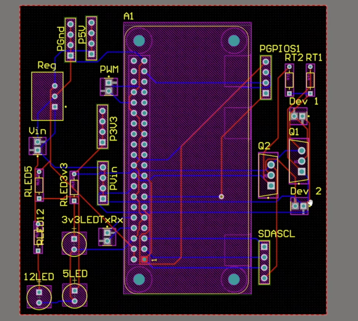

Advantage of Using a PCB
A PCB gives you:
  • Neat screw terminals and proper footprints
  • Clean labeling and consistent wiring
  • Space for fuses/TVS/protection
  • A robust build that fits in an enclosure
Prototype on a breadboard first, then move the same netlist to PCB for reliability.
