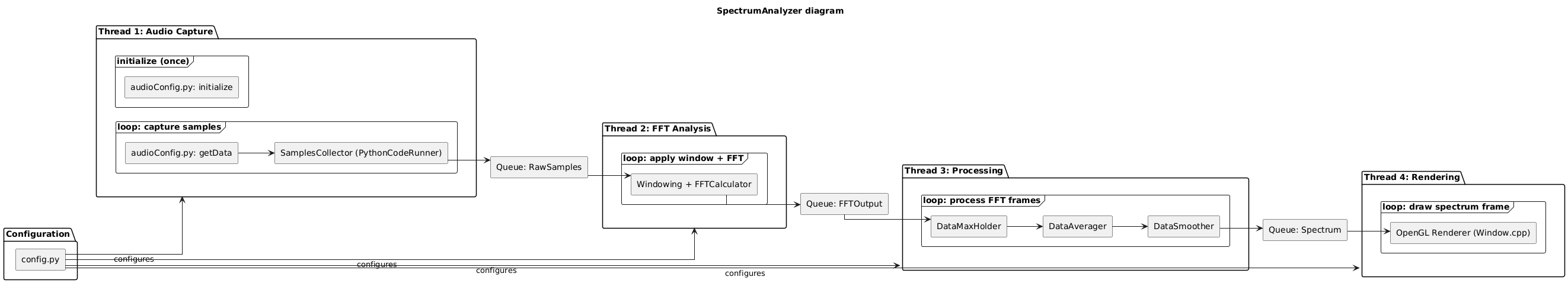

The core of this project is the AudioSpectrumAnalyzer class, which manages the entire process using several parallel threads for real-time performance:
samplesUpdater – collects audio data using PortAudio (or a custom signal from audioConfig.py) and places it into a queue.
fftCalculator – applies a window function and computes the FFT using the FFTW library. It uses Welch’s method with overlapping to increase the number of frames per second (FPS), which is crucial for smooth animation.
processing – processes FFT data, applies gain correction, peak hold, averaging and smoothing.
drafter – converts dBFS levels into vertex offsets sent to the GPU to render the bars.
flowController – monitors the current FPS and dynamically adjusts the amount of overlapping used in Welch’s method. This adaptive algorithm automatically increases or decreases overlap depending on hardware performance and the desired FPS set in config.py.
