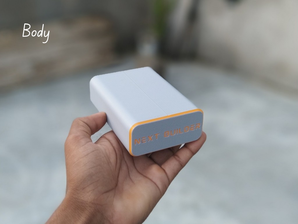

Frequent power cuts are a daily challenge in many areas, especially in villages. One of the first things to stop working during an outage is the WiFi router, disconnecting everything — from online classes and meetings to entertainment and communication.
To solve this, I built a Mini UPS (Uninterruptible Power Supply) for WiFi Routers — a compact, affordable, and reliable tool that ensures uninterrupted internet even when the electricity goes out. It’s simple, efficient, and designed to be accessible for students, makers, and professionals alike.
This project is a perfect fit for anyone who values continuous connectivity—whether you live in a rural area with frequent power cuts or just want a handy tool in your tech setup.
In villages and towns where electricity cut-offs are a daily challenge, one of the first things to go down is the Wi-Fi router. This means no internet for online classes, no work calls, no streaming, and no communication with the outside world. For students like me, it was more than an inconvenience—it was a barrier.
That’s why I designed a Mini UPS as a tool for routers. It’s not just another electronic build—it’s a problem-solving tool, compact and efficient, that ensures your router keeps running during power failures. While big inverters power everything in a home, this tool is built with one focused purpose: keeping the internet alive.
Using Autodesk Fusion 360, I created a professional-grade enclosure that neatly fits all the electronics while keeping the build compact and durable. The design is practical, easy to assemble, and affordable—making it accessible to students, makers, and anyone who depends on uninterrupted connectivity.
It solves a real-world problem with simplicity and reliability. It proves that sometimes the best tools are not the biggest or most complex—they’re the ones that quietly save the day when you need them most.

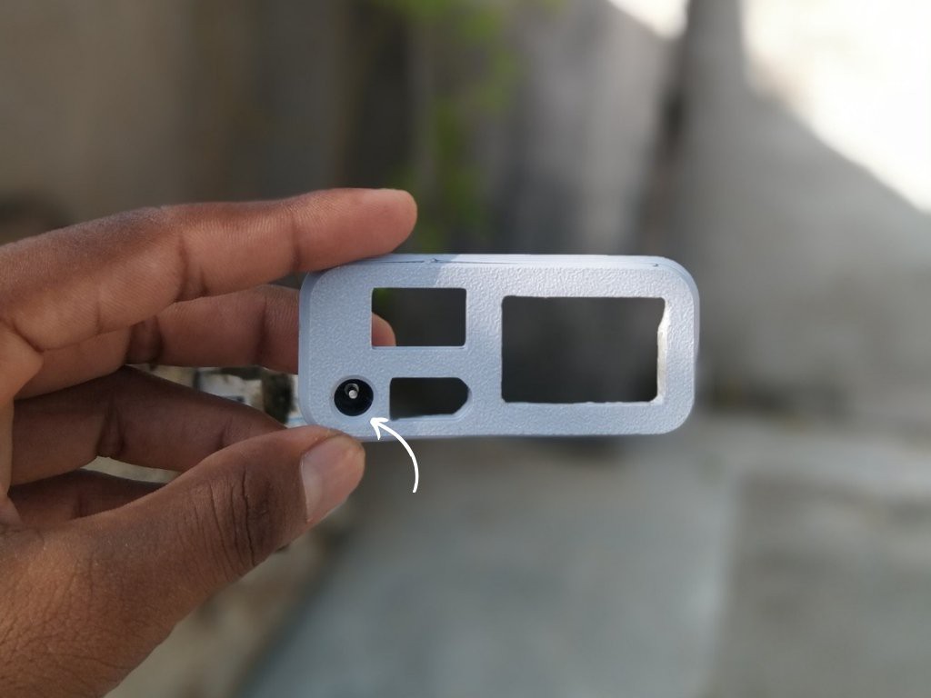

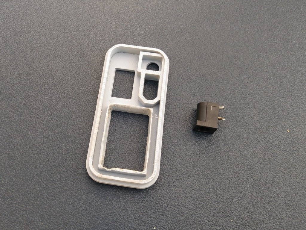

    DC Jack Assembly
    Insert the DC 5525 female jack into its dedicated slot on the cover and secure it with a small amount of super glue, making sure the orientation is correct

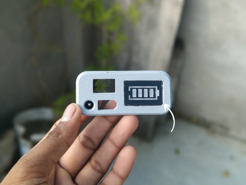

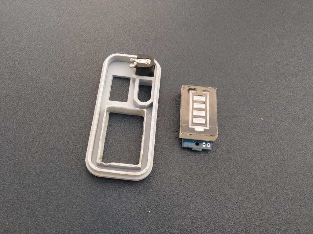

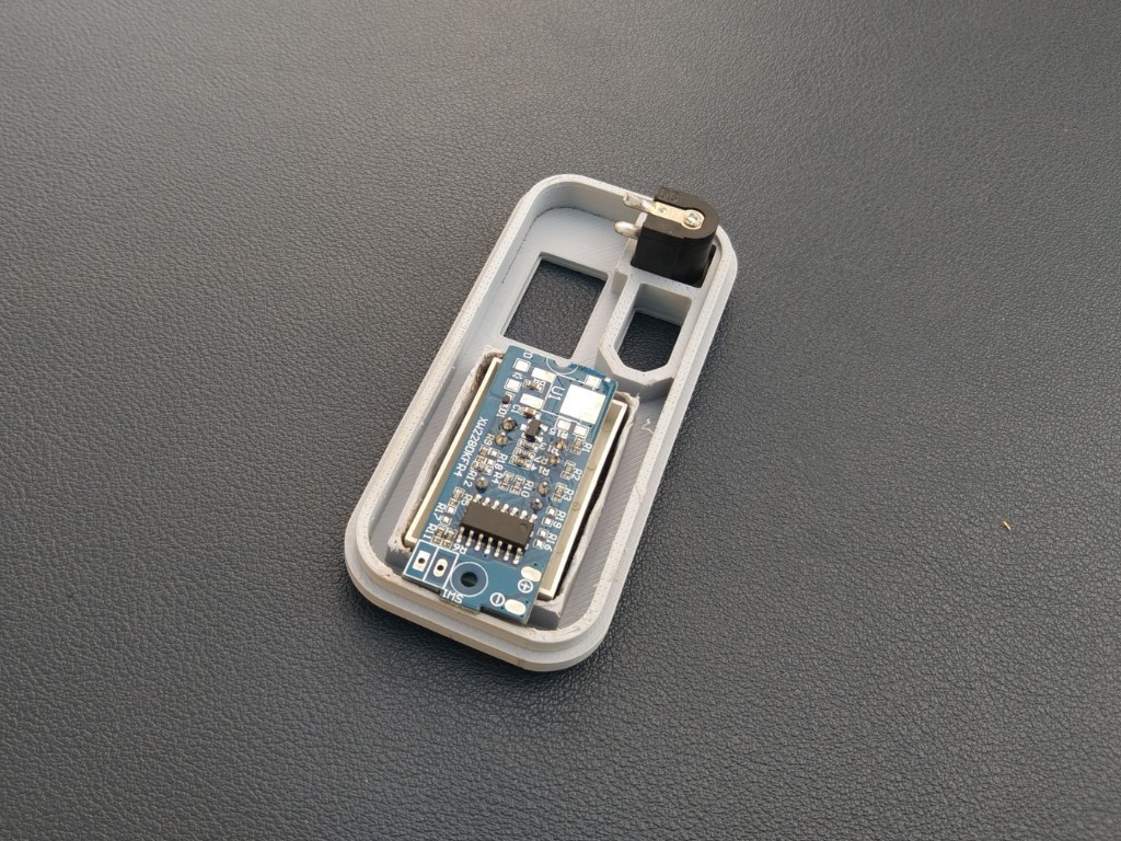

    Capacity Indicator Assembly
    Place the battery capacity indicator module into its slot on the cover and fix it with a small amount of super glue, ensuring it sits flush and aligned.
