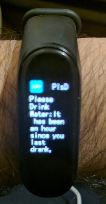

Over the years I have thought of many solutions. Custom android app to drop a notification, a small ATTiny13A based device to beep every 20 minutes etc. The Android app was set to forward the notifications to my fitness band, which would give me haptic notification. Never missed them, only ignored them. Just sometimes.
The app worked fine and kept me reasonably hydrated until Android phone OEMs started killing user apps to save battery power. IMO it's completely unreasonable that an app that I wrote is unable to reliably run on a phone I own and paid for. Anyway, the only solution to this is to make the app a foreground service, which essentially makes it a massive energy hog even. A sad state for 2025 honestly.

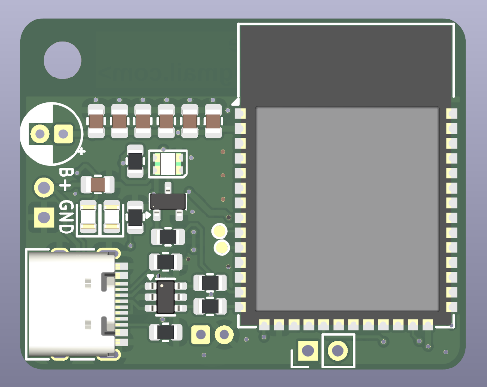

I chose ESP32-S3 WROOM modules as the MCU of choice, mainly because I had them at hand. I design with nRF52 MCUs at work, and I love their low power performance greatly, able to achieve sub 2uA sleep current yet I simply did not wish to use one this time. I also wanted WiFi for whatever reason (I fail to recall). ESP32 SoC have a rather poor sleep mode current but I intend this device to be battery powered and rechargeable. If I have to recharge it every 15 days or so, it is absolutely acceptable. With the aim of making it as small as possible, I could not have a large battery to power the device either way.

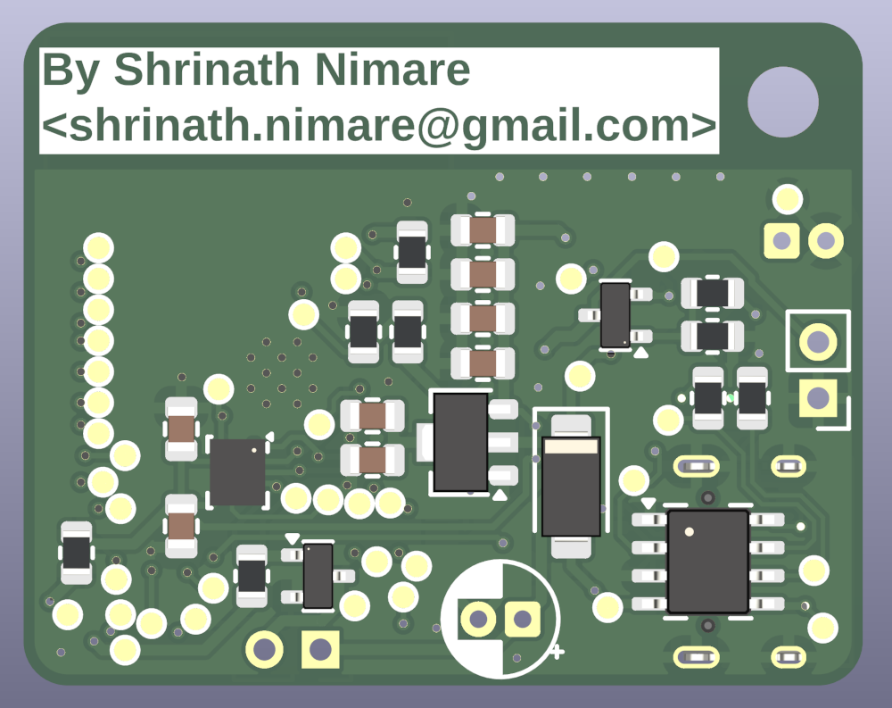

The schematics are simple, the ESP32-S3 module itself, the USB port, Li-ion charging and automatic USB power switchover system, a low quiescent current LDO for power supply, a 2mm x 2mm WS2812B LED, an accelerometer and an optional buzzer for auditory notification. I chose a 350mAh Li-ion cell for this device (35mm x 10mm x 4mm). I designed a small board to have everything on it.

I also had to attach an additional 16V 220uF electrolytic cap to make sure the device worked when WiFi is enabled. It was browning out otherwise. To make matters worse, the only available space was on the trace antenna, surely affecting the RF performance negatively.
