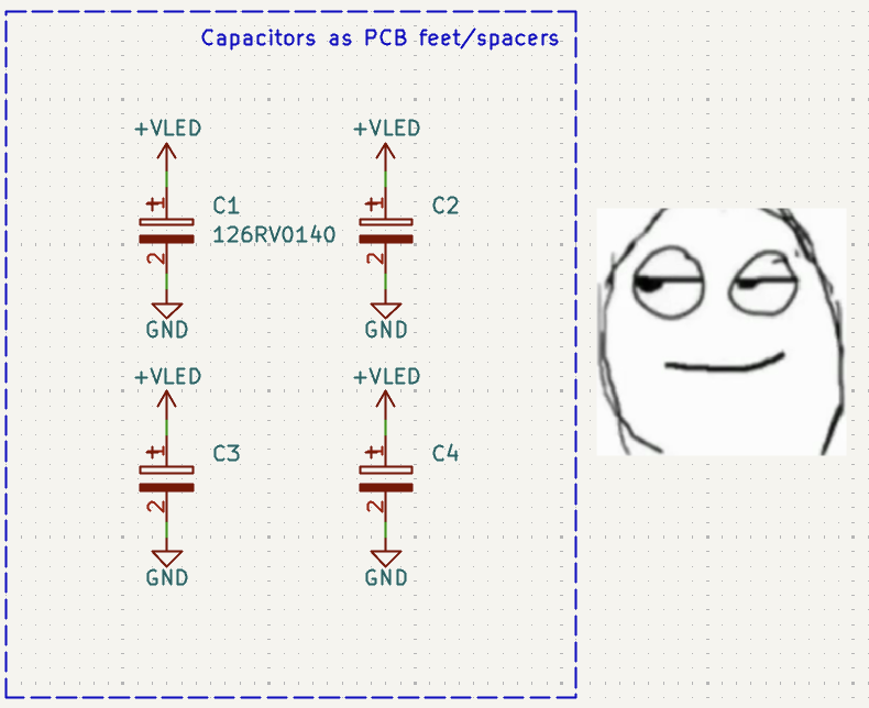

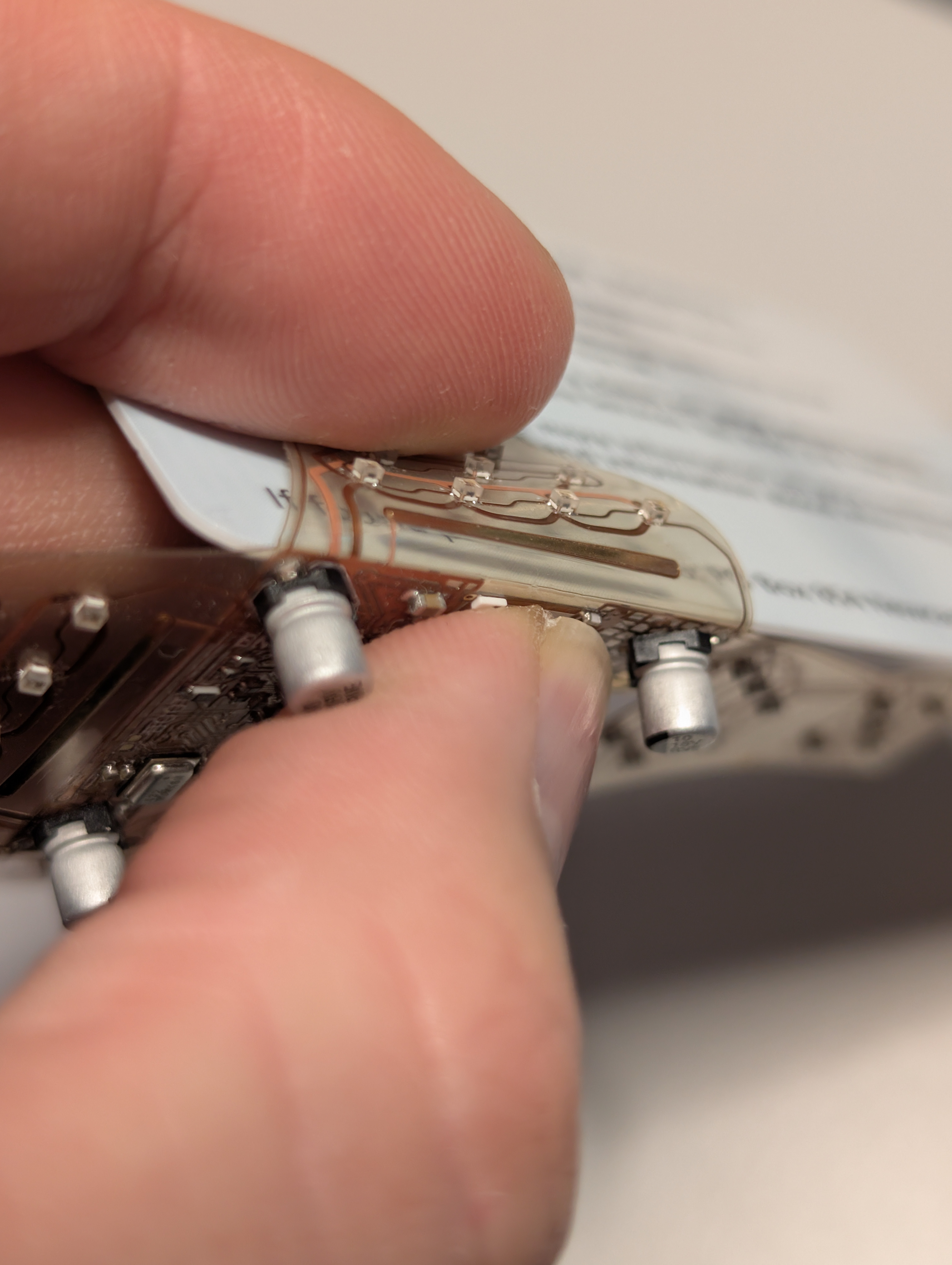

  • Capacitors used as feet, while still decoupling the LEDs

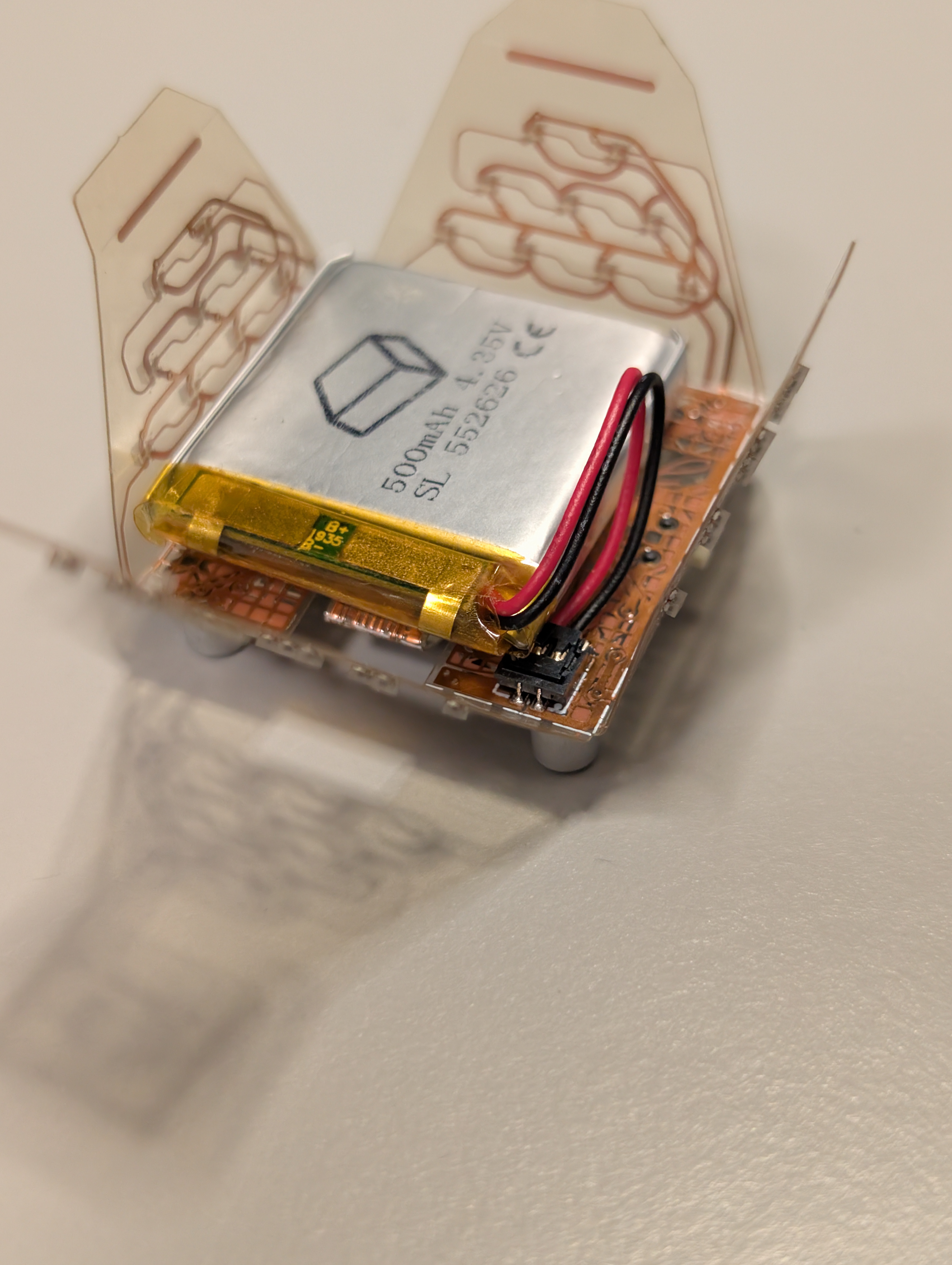

  • An ESP32-C3 chip, the cheapest and smallest ESP with embedded flash.
  • The TDK ICS-43432 i2s digital microphone, as it was the only one available for assembly at the time, works great!
  • A 4.35V li-ion battery charger.
  • A custom made 4.35V, 500mAh battery with a Molex MXL connector, extremely energy dense 5.5(thick)x26x26mm shape.
  • 4 hours of battery life with SoundReactive effects.

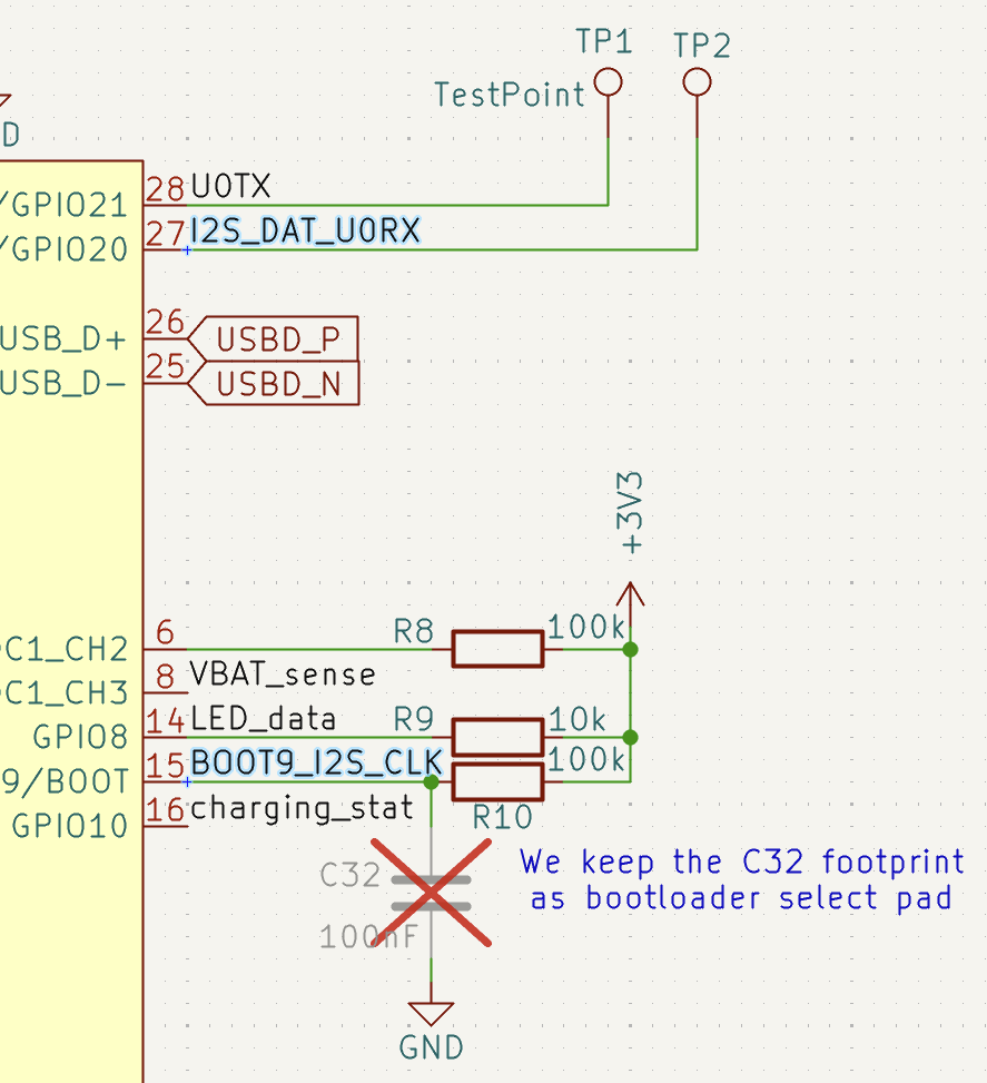

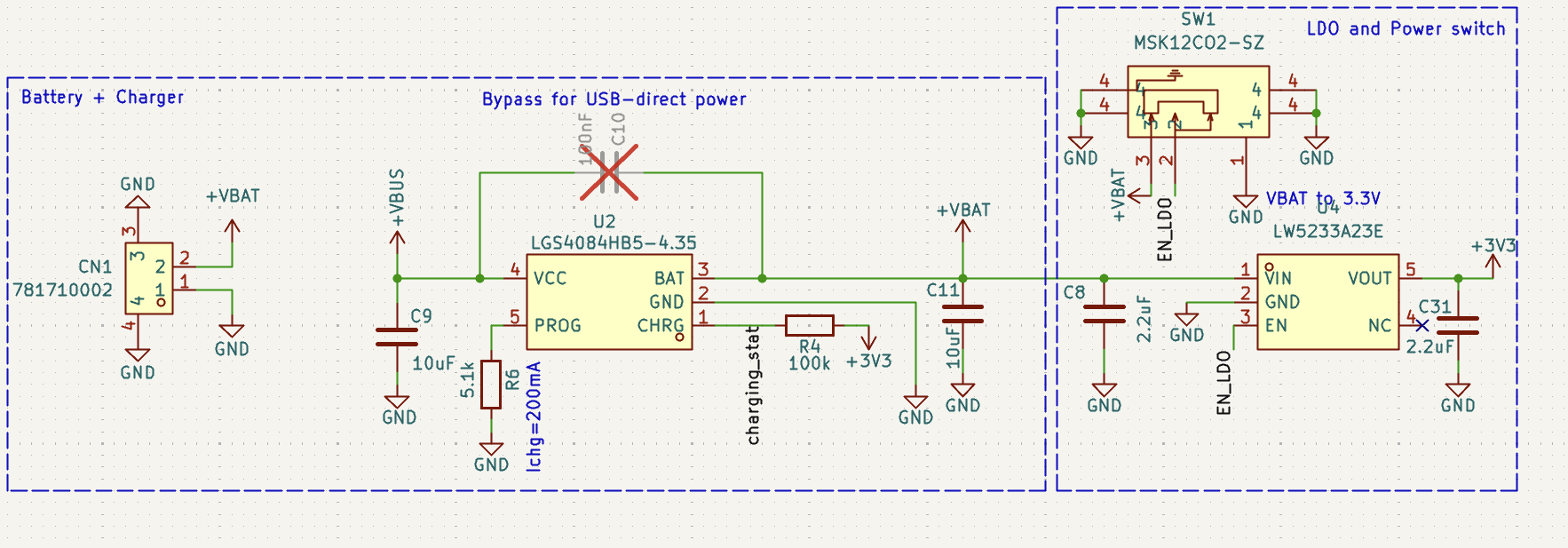

I've done some, somewhat clever trickery since I was out of gpios. As you can see, the strapping GPIO9 and the UART out GPIO20 are both connected to the i2s microphone. We were fairly sure this would work after looking at how i2s starts transactions. And in fact it did.
Can you tell I've had some fun designing the power path? You can see by yourself what it generally does, but essentially:
  • I didn't want the battery to wear down while charging, so it's limited to 200mA (0.4C).
  • I wanted the battery to be as isolated as possible once the power switch is flicked.
  • I wanted to be able to bypass the battery in case someone was looking to power it over USB only as desktop lamp. Why the hell would you have a desk lamp with an embedded battery?
I was trying to have dinner when something flashed in my brain. Capacitors. Are. Feet.

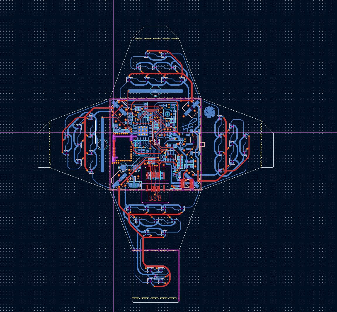

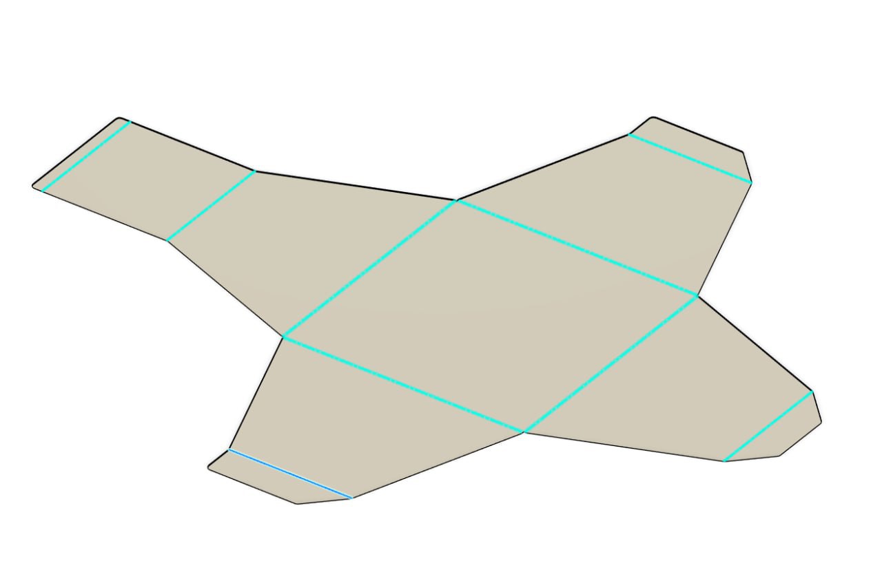

    I started by designing the 3D shape of the iconinc "esc" keycap - from which the End Summer Camp borrows its logo.
    Then I went onto the metal sheets plugin on Fusion 360, allowing almost to "overmold" the initial shape.
    Finally, by "unwrapping" the sheet design you get the 2D dxf.
    Once imported into Kicad, it looked liked this. I had to clean it here and there for some minor vectors, but had no major troubles with Kicad.

    Folding Instructions for the BadgESC{21} Badge
    These are the instructions for folding the BadgESC{21} Badge into its final cube shape. Use a plastic card or another thin, flat object to achieve tight bends on the PET plastic substrate. It may also be possible to mold the shape by gently warming the material, although this method has not been tested.
    To secure the folded parts, use UV glue, superglue, or another strong adhesive.
    Step 1: Initial Positioning
    1. Place the badge on a flat surface with the components facing up.
    2. Bend the USB connector flap by aligning its edge with the solid white line located near the set of small resistors, not the large ones.
    3. The large resistors are not connected to any circuit. They are present only to provide structural thickness for engaging the USB Type-C connector’s locking mechanism.
