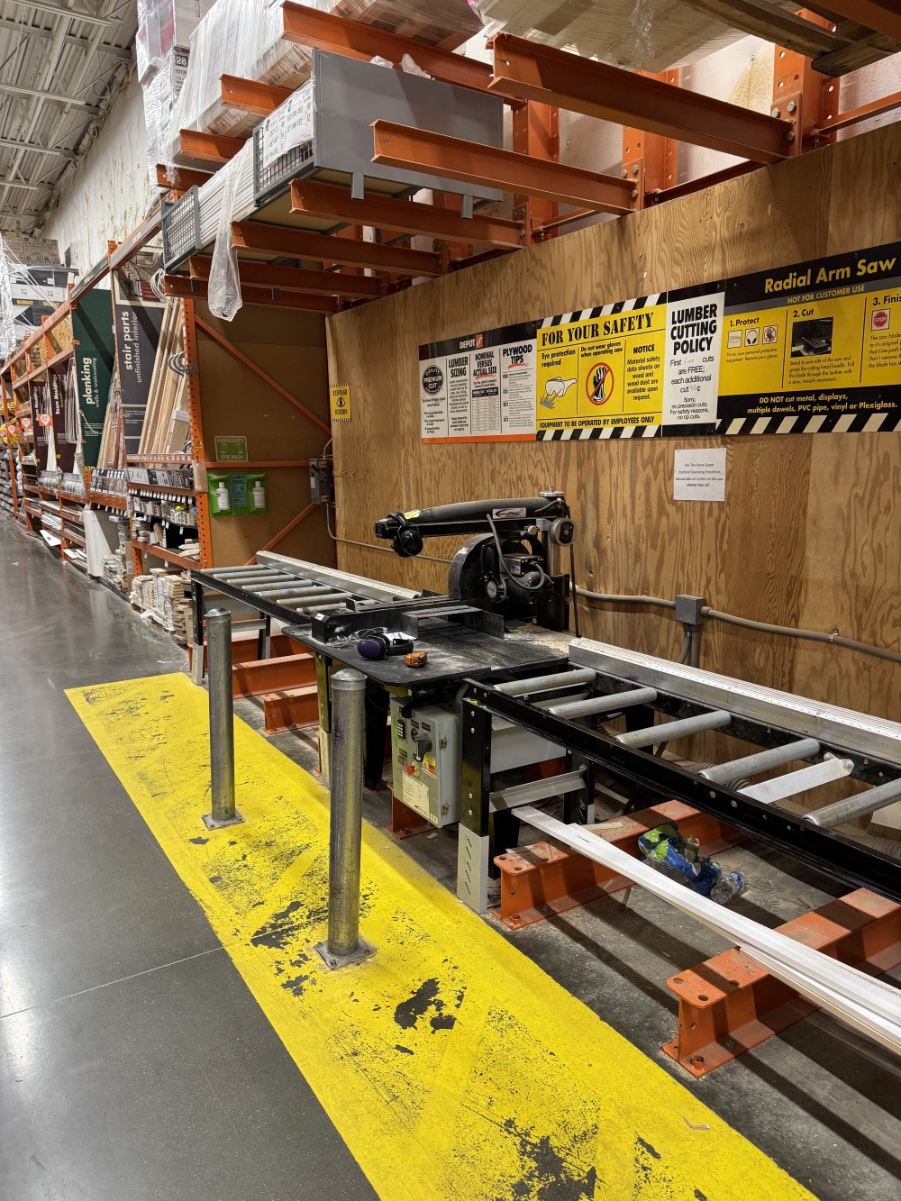

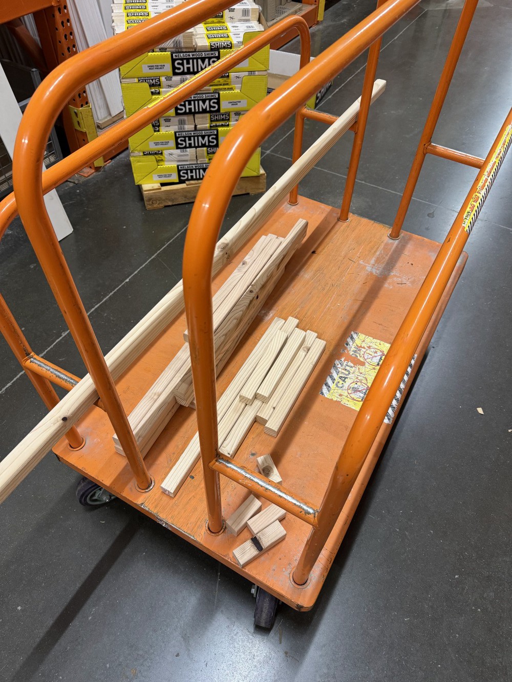

    Unlike nearly all of my other projects, this one was surprisingly straightforward to finish. Picking up after the last log entry, I knew what lengths of wood I needed to cut to build the enclosure. Since I didn't have a chop saw in my apartment (dang I can't wait until I get a garage) I had to find some other way to cut it. Thankfully, Home Depot came to the rescue, as they will cut wood for you. This saved me A LOT of time and elbow grease considering my only other option was a hand saw. The Home Depot staff were incredibly helpful, and per the advice of some people on Reddit, I selected my boards, marked them, and then let the employees take it from there.
    Picture of the cutting setup, if anyone is curious.
    Complete boards!

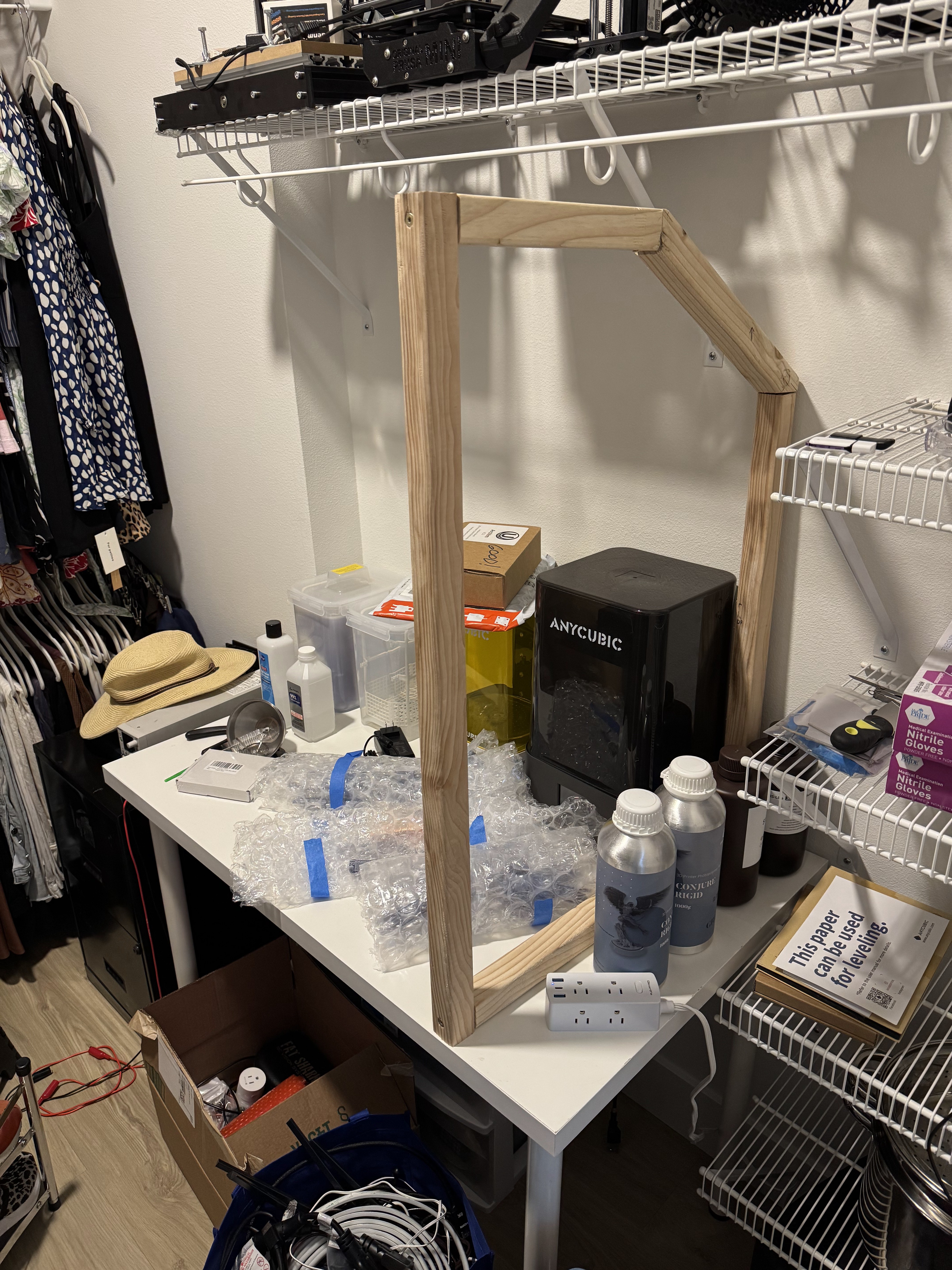

    I took them home, and got to laying them all out. One thing to note about Home Depot's cutting services, though, is that they will only make square cuts. This left me with 8 cuts I needed to make by hand for the angled part of the enclosure. I measured and marked with my calipers to try to get as close to possible to the desired angles.

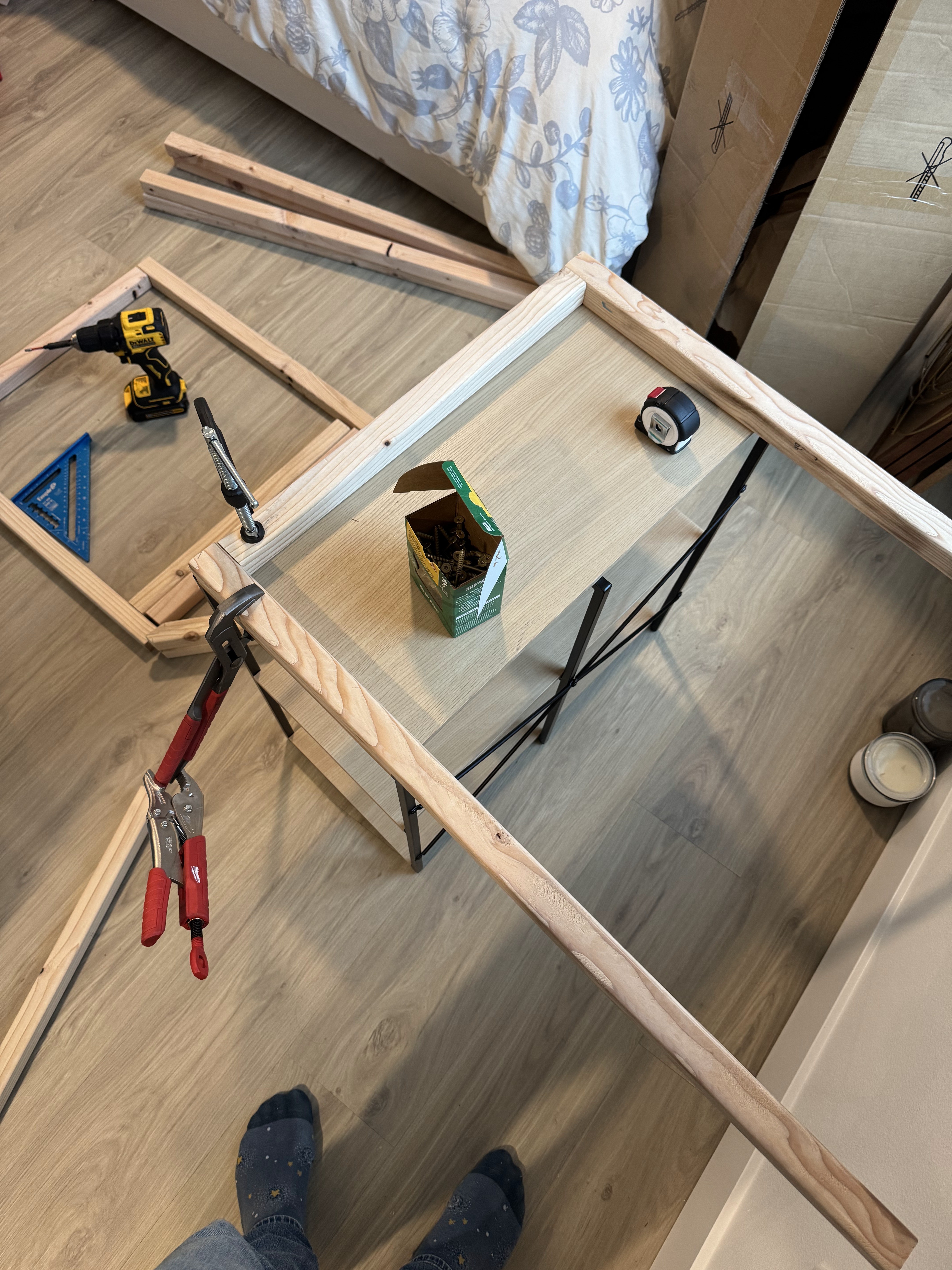

    I then used my hand saw to hack away at the corners of the requisite boards. My accuracy was... not great. With no workholding, it was incredibly difficult to get a good cut. This is made worse the the rounded corners of my stock. Eventually though, I was able to get things cut well enough and started screwing them together. For this, I knew I needed a better solution with at least some restraint. My solution: a cheap bookshelf, and 3 clamps.
    I had to get scrappy with this solution, but it worked nonetheless. Here is one of the sides completed:

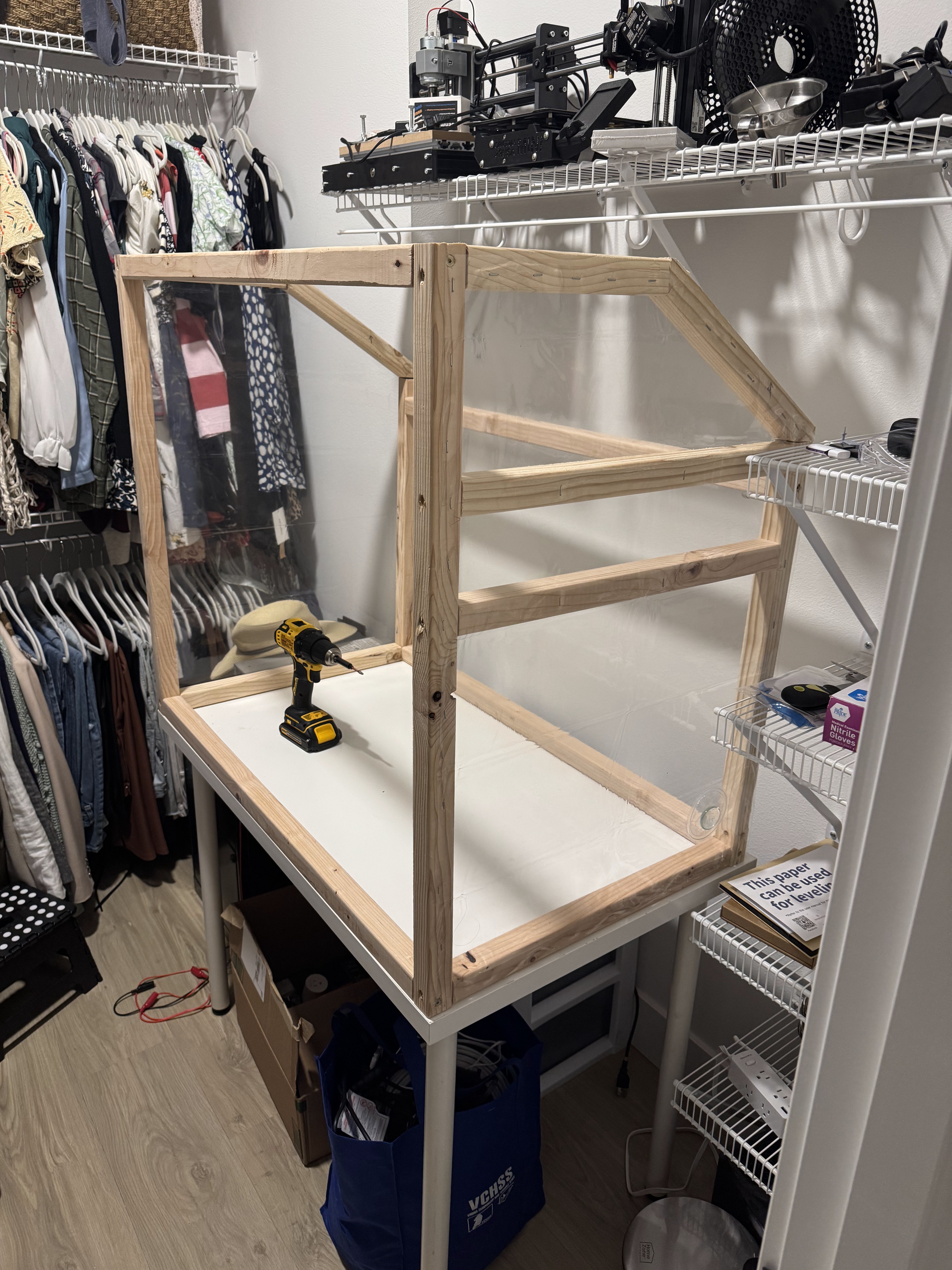

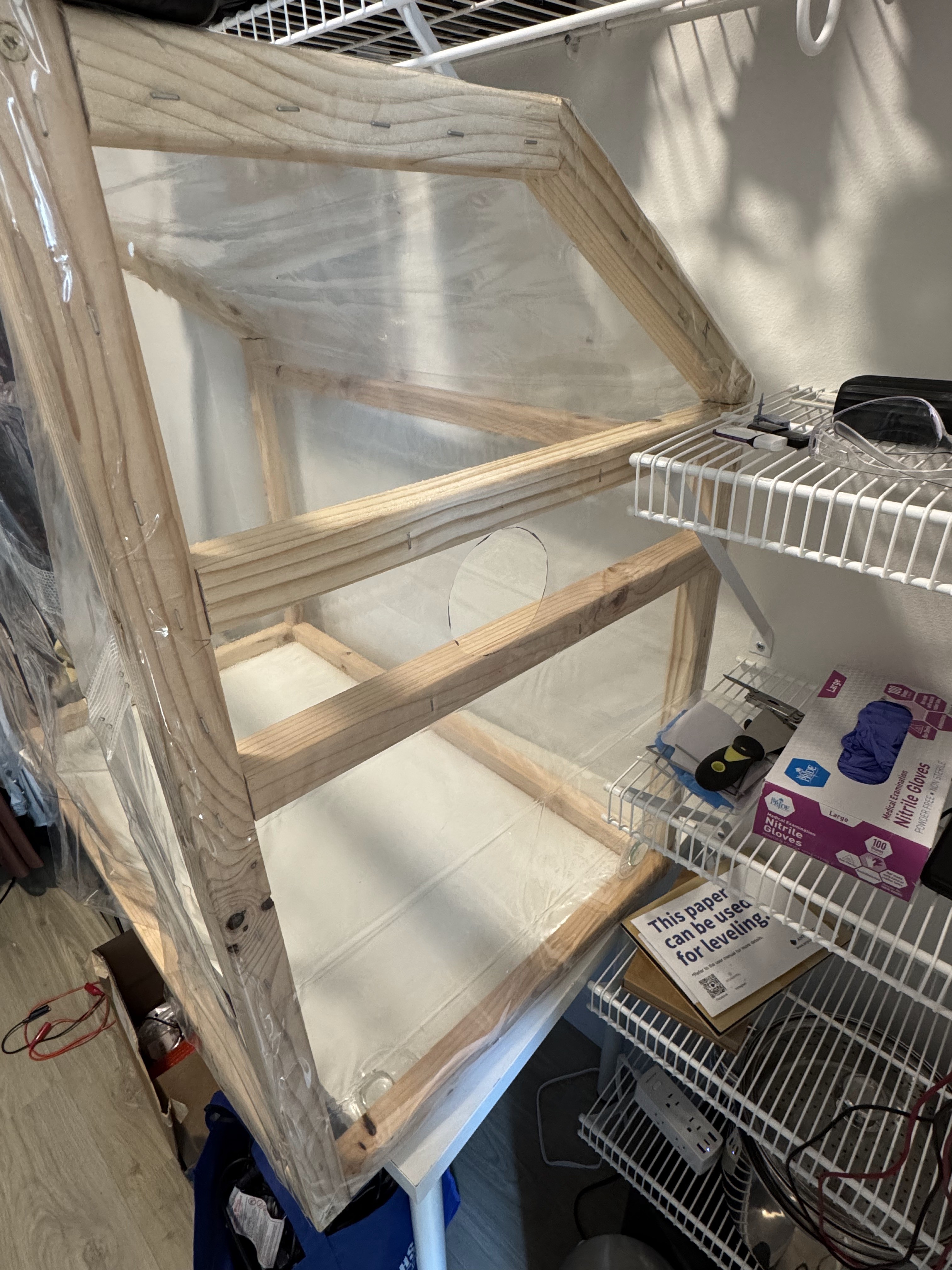

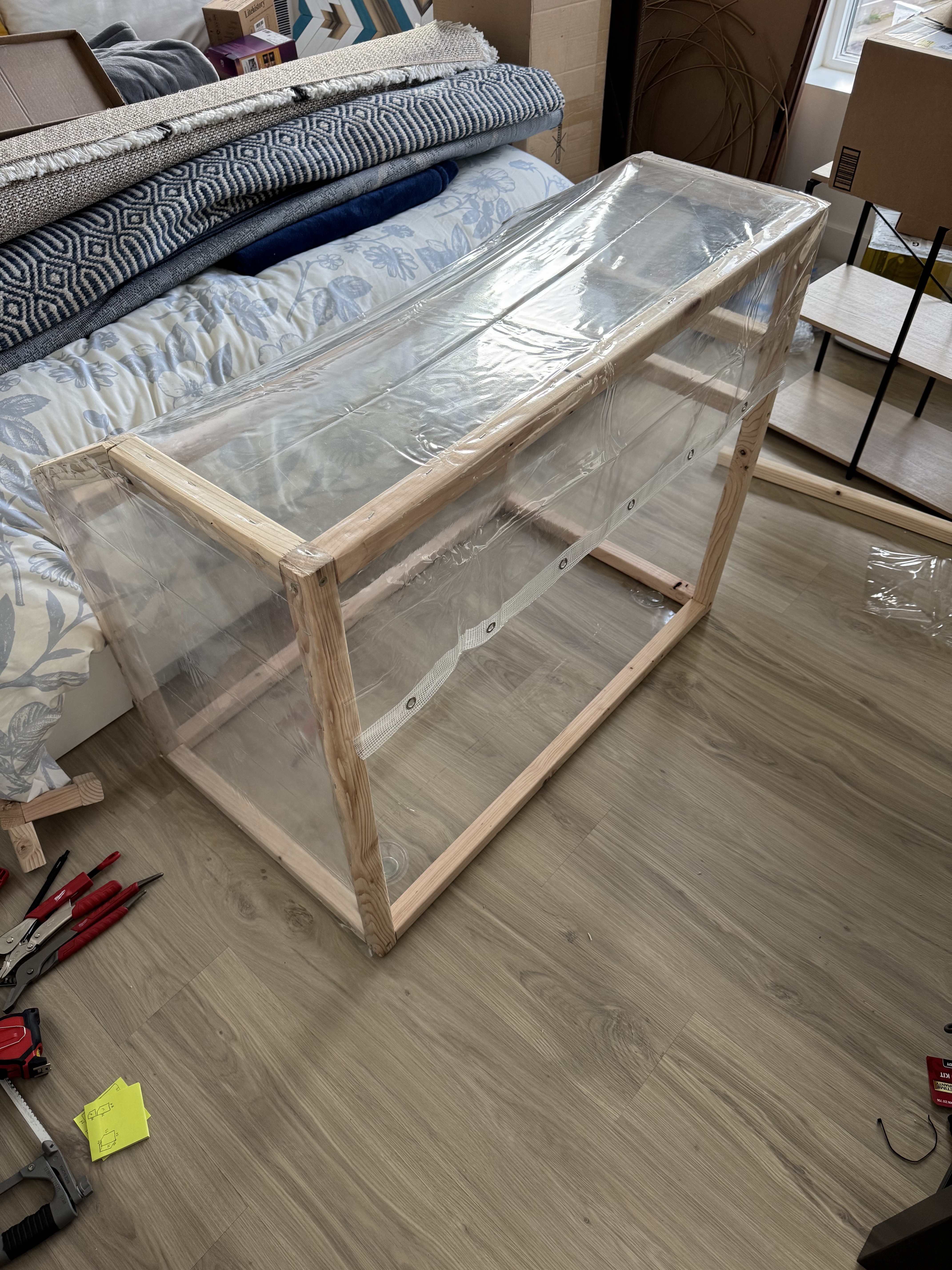

    From there, I screwed together the rest of the frame and moved to my next challenge - enclosing the enclosure. I knew I needed something impermeable, but would prefer it to be clear. I also wanted it to be light and easy to cut. This left me with only a couple options: clear plastic film and plexiglass. Lastly, it must be cheap, which meant that plexiglass was off the table. Unfortunately, however, they don't really sell small-ish quantities of clear plastic film that isn't super thin (thickest from Home Depot is 6mil)... or do they? I found the thickest clear plastic shower curtain on amazon and bought the largest option. This thing was SOLID, I measured it at 10mil. It was exactly what I was looking for. Thick enough to have some rigidity and provide some structure, but thin and flexible enough to be easy to cut. I got to work chopping and stapling it to the outside.
    You can see in this image, things were coming together nicely! After some more slicing and dicing, here it is almost complete.

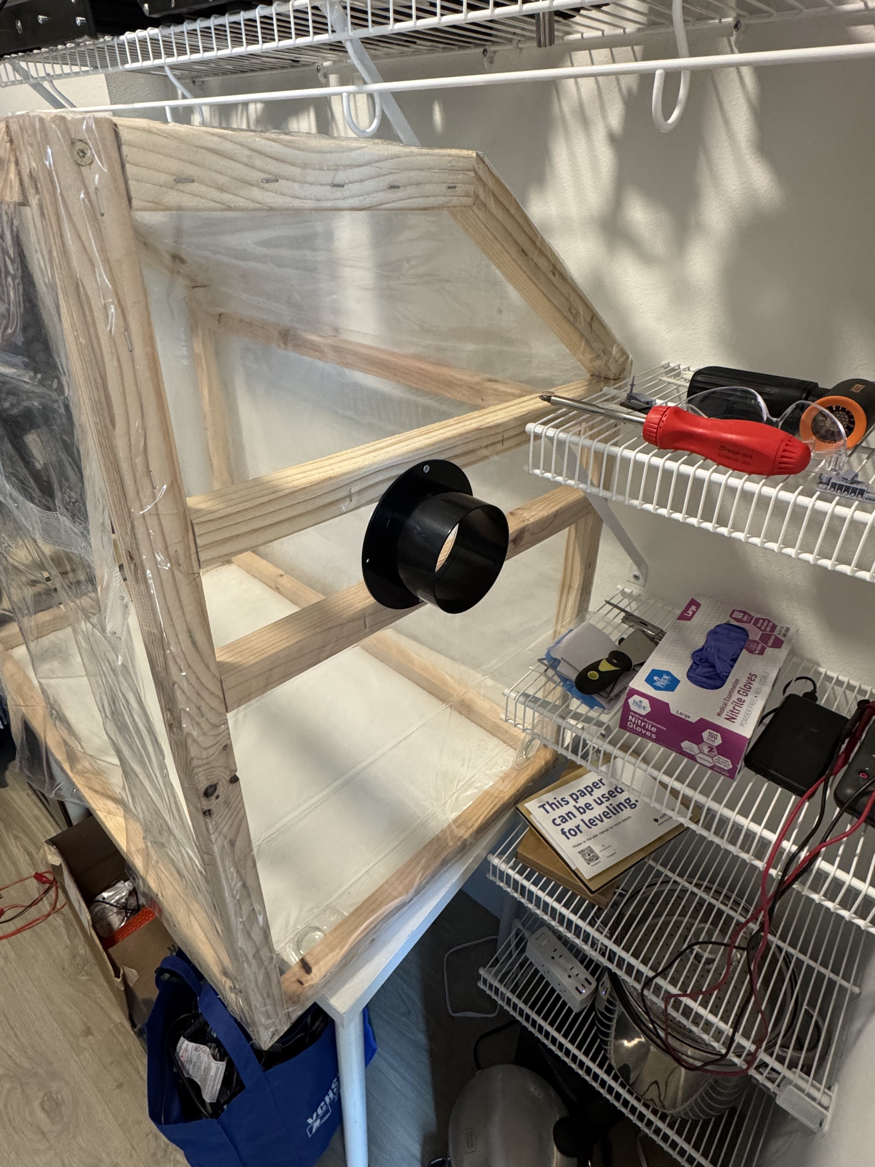

    It's hard to see, but I left the flap on the front not stapled, so if I need to open up wide, I can. With some of the last scraps of the shower curtain, I made mini-flaps on the front, each covering about 1/4 of the width of the enclosure, so I can only open up the parts of the enclosure I need to access, and maximizing input airflow through that section. The finishing touch was to add the air outlet.
    Planning:
    Cutout:
    And once that was done, I taped around the edges to seal it up as best as possible, then the enclosure was complete! I added some ducting, a fan, and one of those portable air conditioner outlets to the window (with gasket to prevent backflow). Here's a video of the completed project:

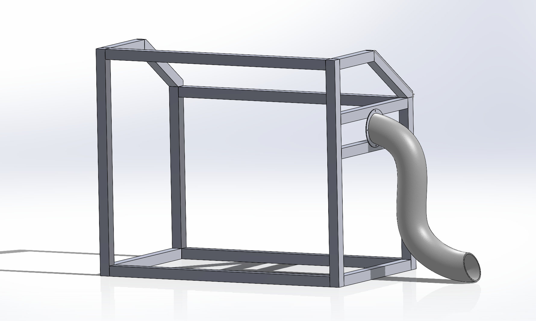

    With that in my head, I got to designing in Solidworks, using dimensions I measured of the desk this enclosure would sit on. Here is how it turned out!
