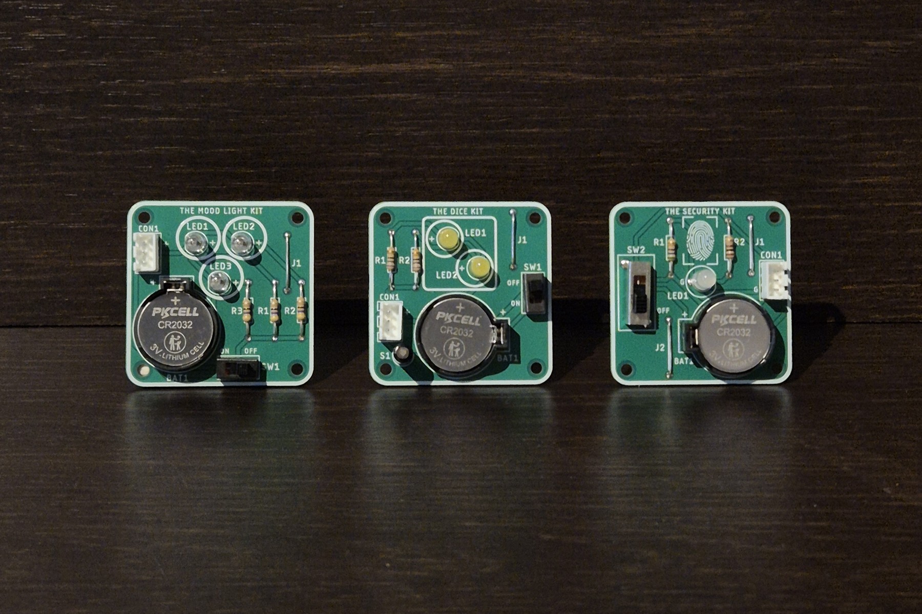

Years later, I realized that struggling the way I did wasn't right, and I didn't want others to have the same discouraging experience. That's why I designed modern, beginner-friendly soldering kits that help you explore electronics in a way you can understand exactly how each part and the circuit works.
The Mini Series have been designed with 3 goals in mind:
1. They should speak the language of the 21st century;
2. Teach you about electronic components, soldering, circuits and programming;
3. Interact with you as you learn.

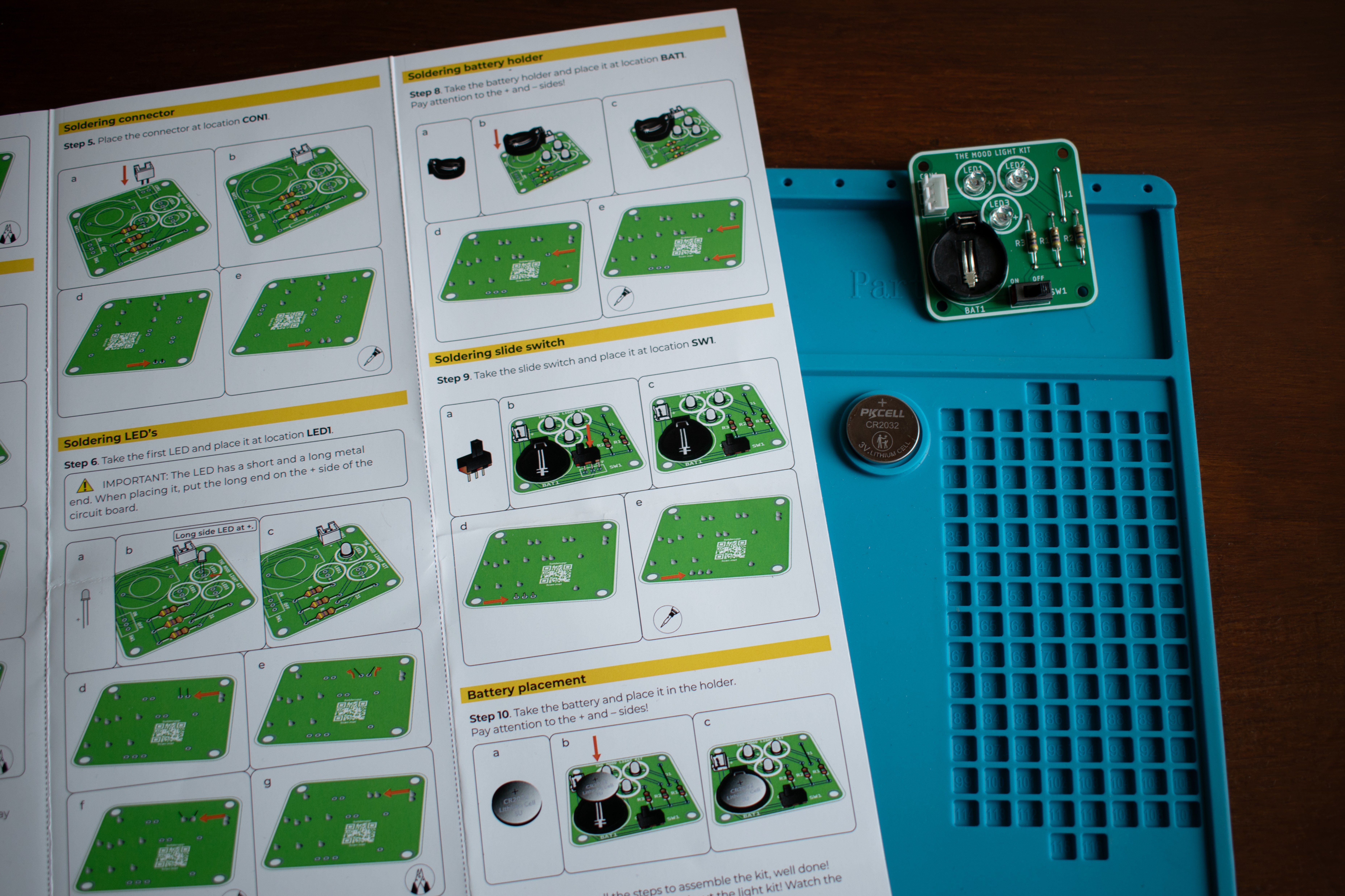

Each kit contains a manual filled with illustrations of components, and teaches you about the parts in the kit. On the first side, it also has a QR code, that leads to a video with an explanation about soldering. On the back side of the manual, you will find a LEGO-style step-by-step build guide, showing you exactly how to assemble the kit. After you are finished with assembly, you can scan the last QR code, which will show you a video that explains how the parts from the kit work, show you a couple of components from the inside and explain how your circuit works.

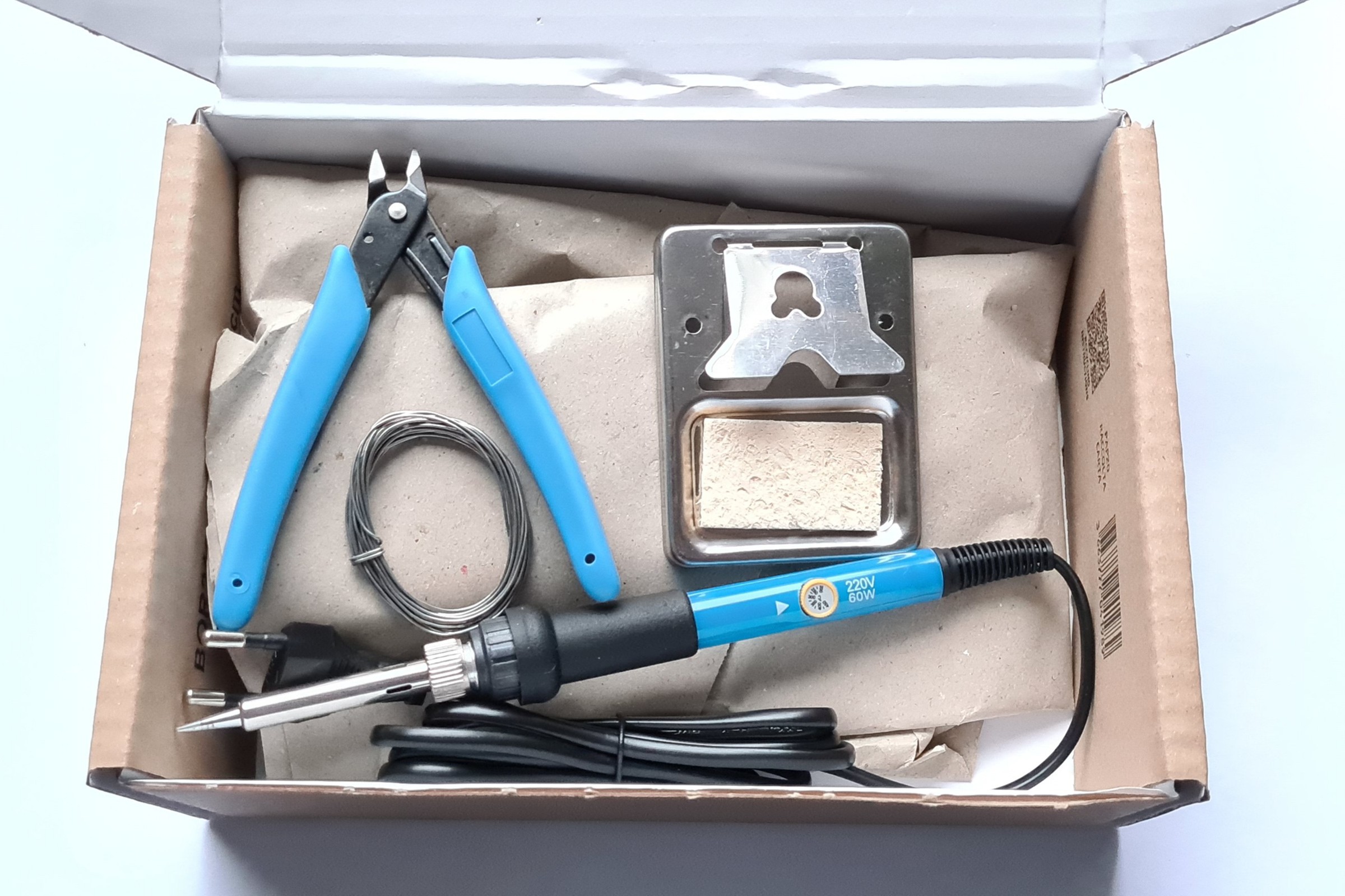

For assembling, you only need a few basic tools:
- Soldering iron
- Soldering iron holder and sponge
- Solder wire
- Side cutters
Optional tools (for fixing small mistakes):
- Desoldering pump
- Needle nose pliers

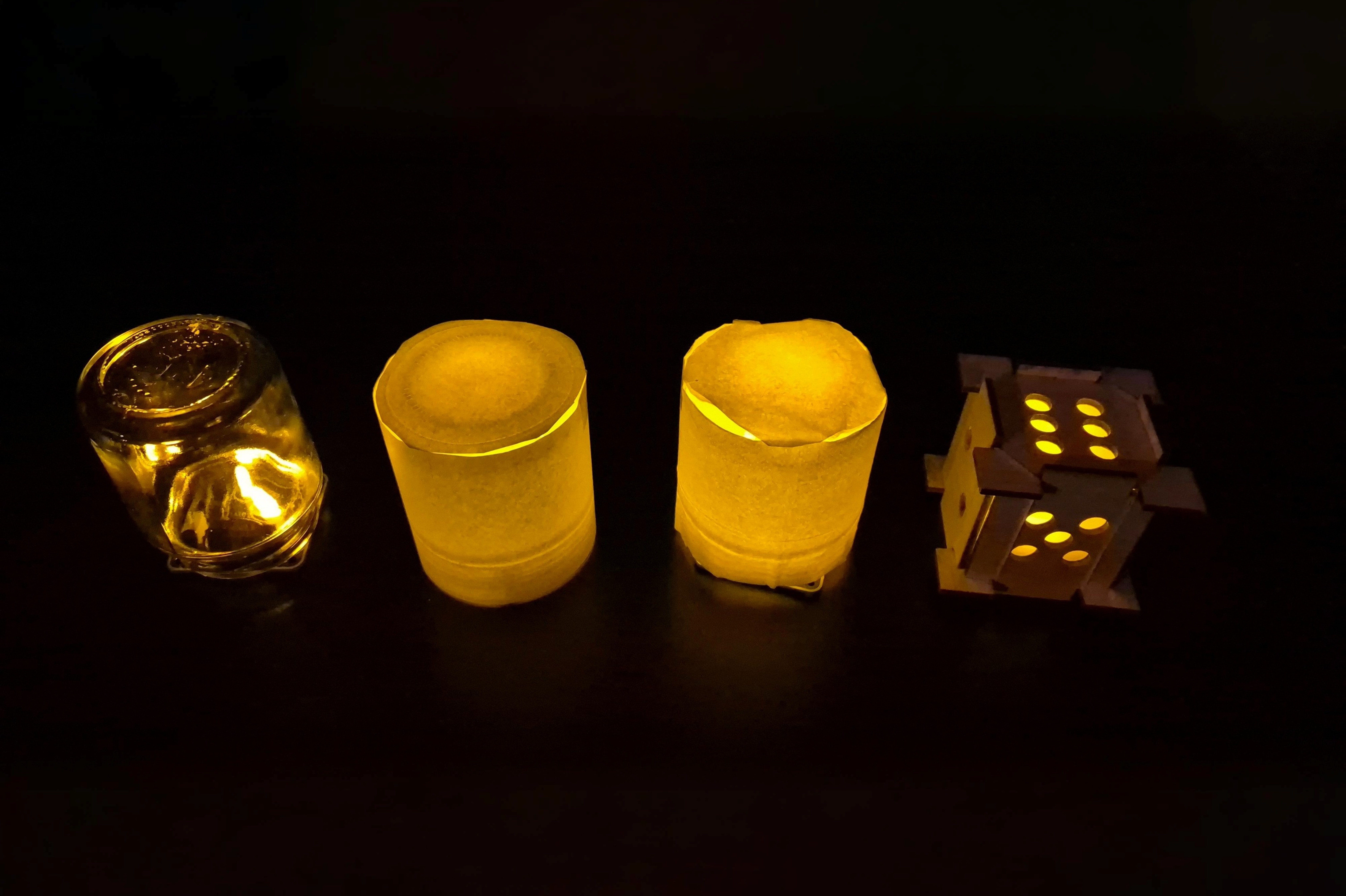

Iterative design of ambience light enclosures
Let me explain the design process of The Mini Series enclosures. It all started with the assembled Dice Kit placed inside a small glass jar for the first iteration. The goal was to spread the light evenly and create an ambient glow that instantly grabs your attention. Unfortunately, this did not work well, since glass does doesn't spread light evenly.
In iteration 2, a piece of standard paper was wrapped around the glass jar. This drastically improved the effect, as the light no longer travelled only upwards, but was diffused through the paper's structure. The downside was that some light was still blocked due to paper’s thickness.
For iteration 3, a paper tissue was used instead. This allowed more light to pass through while still keeping it evenly spread. The trade-off was fragility: the paper is delicate, and the glass can break relatively easy.
In iteration 4, a stronger foil paper is used. It lets sufficient light through, while maintaining an even spread. Combined with a wooden structure, this proved to be the ideal solution. Below you can see iteration 1 (on the left side) and iteration 4 (on the right side).
