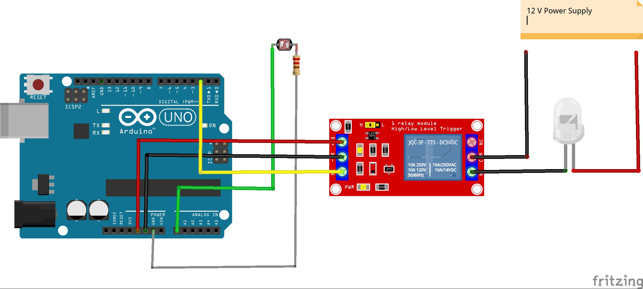

Wiring the Relay Module
Relay VCC - 5v
Relay GND - GND
Relay IN - Digital Pin 2
LEDStripPower
For a 12v LED Strip:
LED strip + directly to 12V supply
LED strip - to COM on relay
Relay NO to the 12v supply ground
The relay will switch the strip ON/OFF by controlling the ground connection.

Testing
Cover the LDR with your hands - LED strip should turn ON
Shine a light - LED strip should turn OFF
