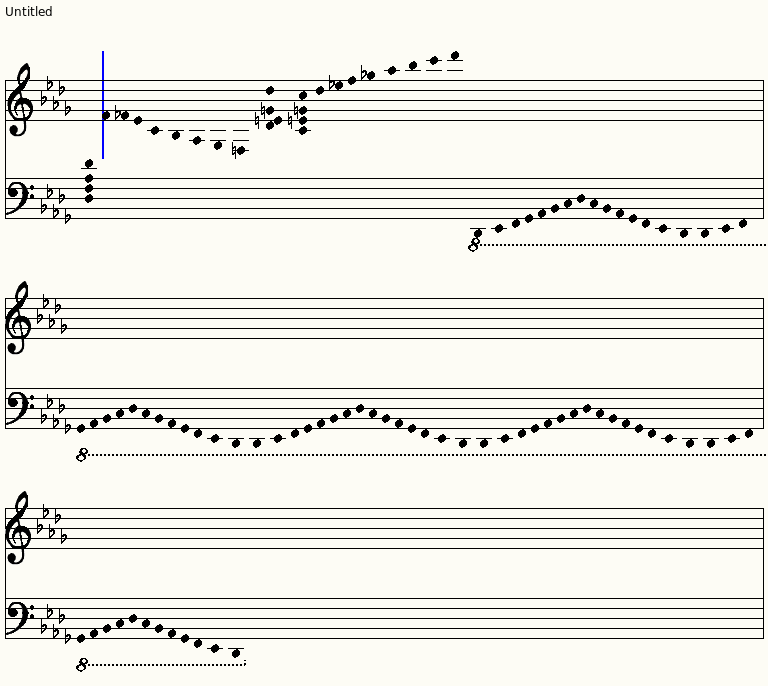

    Managed to get minimal line wrapping to work.  That requires a lot of non manetainable, janky, spaghetti.  Cleffs, key signatures, 8va's have to be extended to each line.  There are glitches.  The mouse pointing is really bad.  The replicated cleffs on each line are off by a few pixels, but its far enough along to start letting more glitches slide in order to get somewhere functional.
    There's definite contention on the issue of letting bugs slide in order to get to minimal functionality.  On the 1 paw, we're supposed to be doing test driven development.  On the other paw, we're supposed to be making minimum viable products.  Lions have traditionally favored letting bugs slide to get to the finish line.  It was always about the requirements constantly changing, the low odds of it being finished, the low odds of anyone ever using it.  When working with other animals or making a high profile program with frequent uploads, you always have to keep up with the bugs, can't be finish line focused because in that case your quality of work is being judged.
    8va line wrapping was the next big one.  Professionally engraved music has the 8va's extend off the end of each line & restart on the next line without any special ending on the previous line.  Take every win you can get.
    Undo & redo would be the last step before finally moving into user defined notation.

    Got it to show arbitrary numbers of staves.  The mane trick is aligning the beats in both staves.  Currently, it's hard coded to create 2.  Then came 8va symbols, which were a brute force coding job.
    Exercised it drawing lowest A & highest C.  It's going to need adaptive staff spacing, but it's going to be rarely used.
    All the drawing used X primatives & pixmaps instead of the more modern method of drawing on a bitmap & blitting or using a modern library.

    The finale videos all showed a solid, unblinking cursor without XOR.  Some of the big operations were deleting single beats, cursor key navigation, mouse navigation, changing staffs & beats, wrapping around the end & beginning of the score, reducing the length of an 8va when deleting a beat.
    Music notation with line wrapping is such a difficult problem, there's no other way to do it but grinding away at diabolical software constructs or in today's lingo, diabolical prompt constructs.  When in doubt, creating more data structures tends to unblock the process.  It's most often necessary to reread different sections of arrays & search in both directions.
    To keep things moving, usage would focus on just inserting & deleting single notes at a time instead of full clipboard operations.  Music construction set avoided the problem by drawing a single infinitely wide line.  To be lion readable, it needs line wrapping & paginating.  Noted MCS had all the 8vas extend to the next bar. The notes were only drawn for X < 255 & the play head was indicated by a carrot.
    Important to note that the resolution imposed by the ancient laptop monitors is comparable to 80's VGA.
    For clipboard operations, the finale examples showed blue highlighted regions without XOR.  The mane problem with clipboard operations is selecting regions with variable numbers of staves, multiple lines, & pages.   It's not known if the score is going to advance by pages or lines.  The music reader did fine with no clipboard operations or region selections for its annotations.
