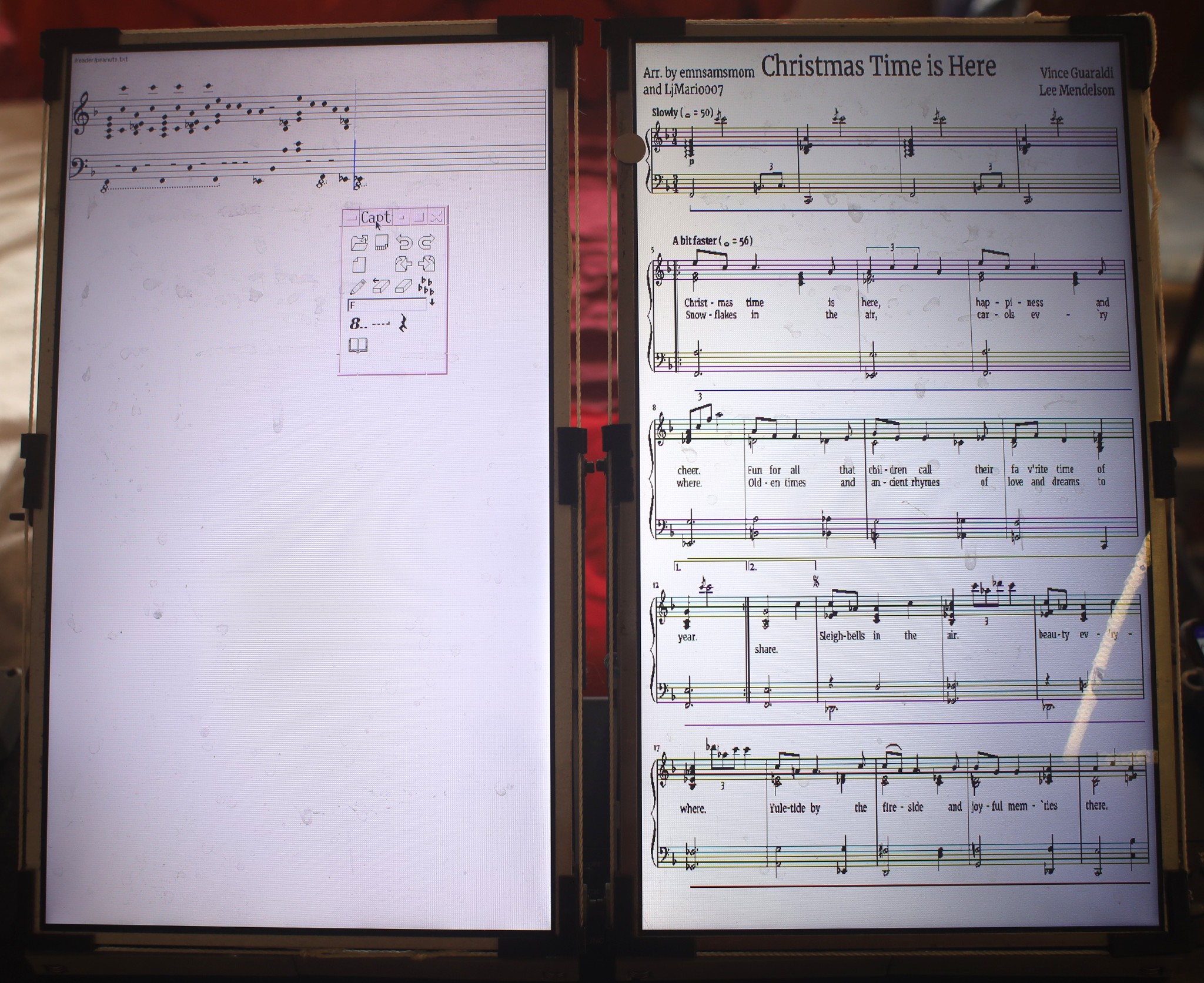

Then to do cross development on raspberry pi, it became clear it needed to switch between single monitor, dual monitor, & 3 page single monitor mode at runtime.  3 page single monitor remanes a notional mode if lions can ever afford enough space.
Managed to get some peanuts transcribed by capturing MIDI keypresses.  A lot of behaviors have yet to be fixed, manely more 8va corner cases, undo stack corner cases, accidental corner cases.

Finally, there is a debouncing problem in the custom trackpad.  The source code has a 10ms debounce value.
Simultaneous use of the reader mode & manipulating of the pdftoreader2 program can show a reference score on 1 monitor while capturing MIDI on the other monitor.
