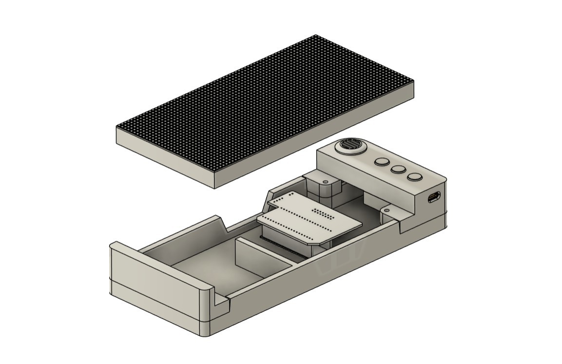

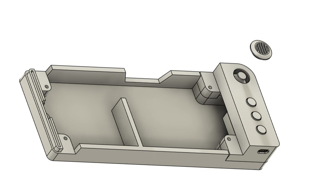

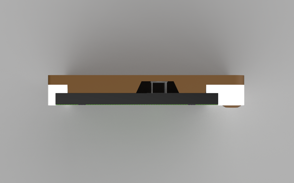

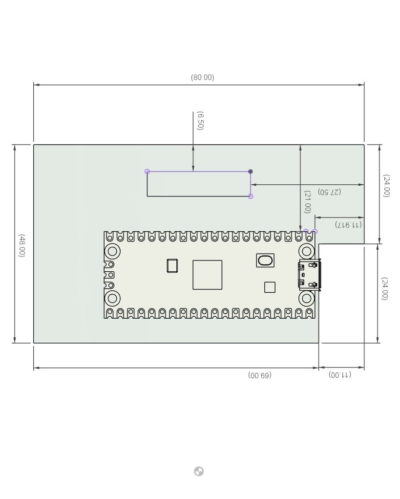

3D DESIGN

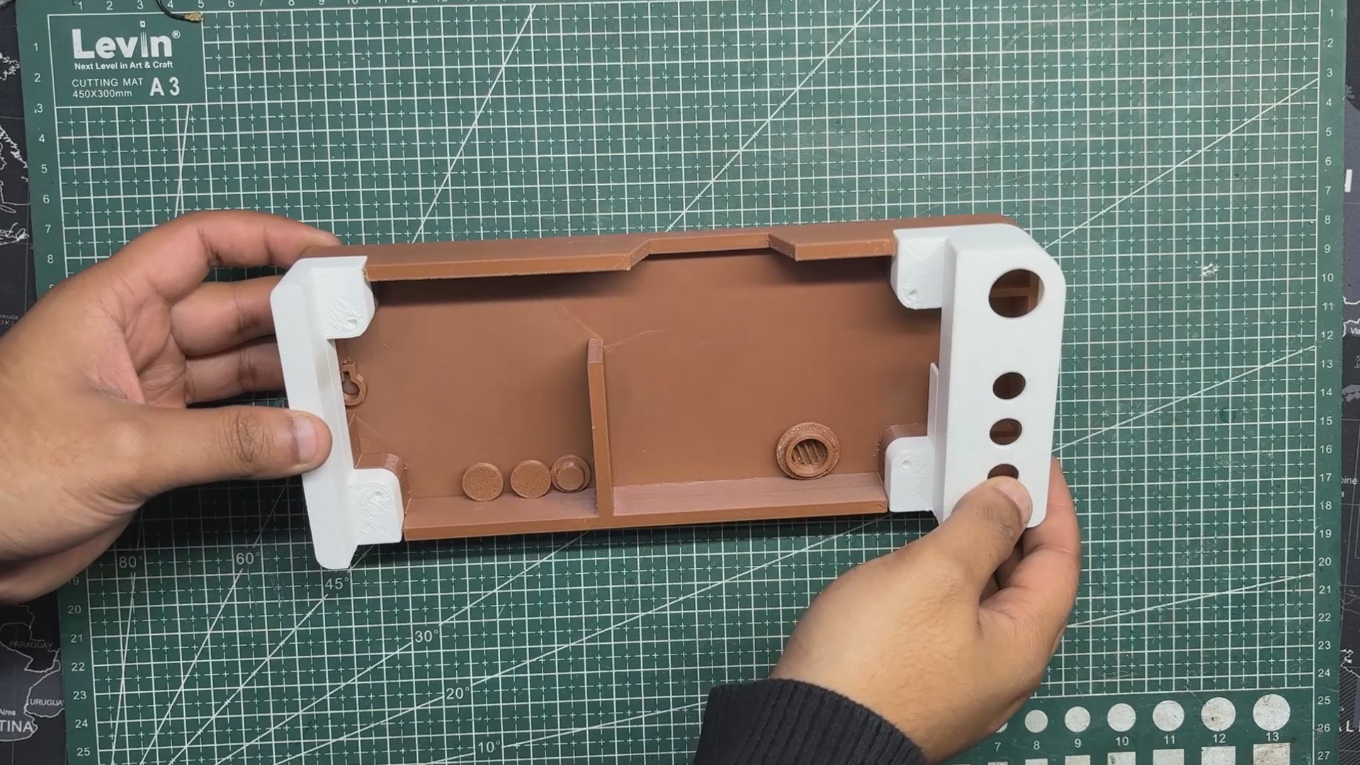

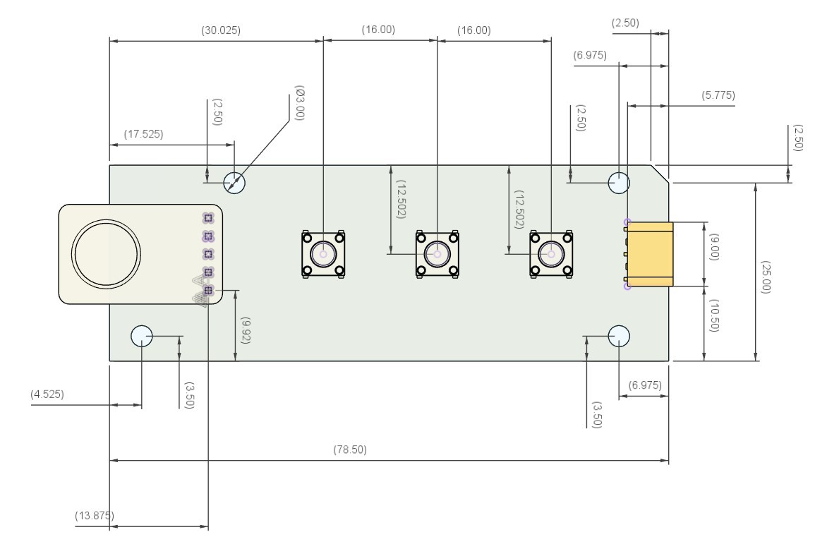

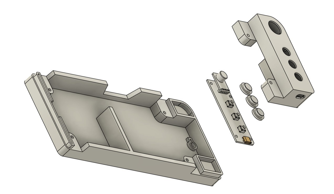

Before diving into the PCB design process, we first prepared a complete 3D design of the device. This began by importing models of the LED matrix, the Pico 2, the MAX9814 microphone module, and the push buttons. We then rearranged them to form an enclosure layout: the matrix display sits in the center, and on the right side we created a custom compartment that holds three push buttons aligned in a row. Above the buttons, we placed the microphone module.
The idea was to keep all interactive elements—buttons, microphone, switch, and USB port—on one side. Because the internal space was quite limited, we positioned the Pico 2 driver board and the battery on the backside of the display.
The enclosure was split into two main parts: a left and a right side. The right side houses the switch, microphone, and power-management board. The left...

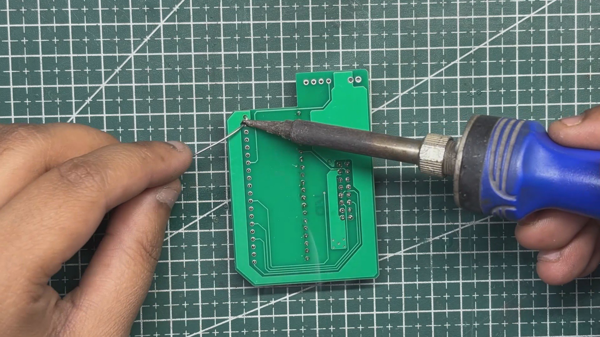

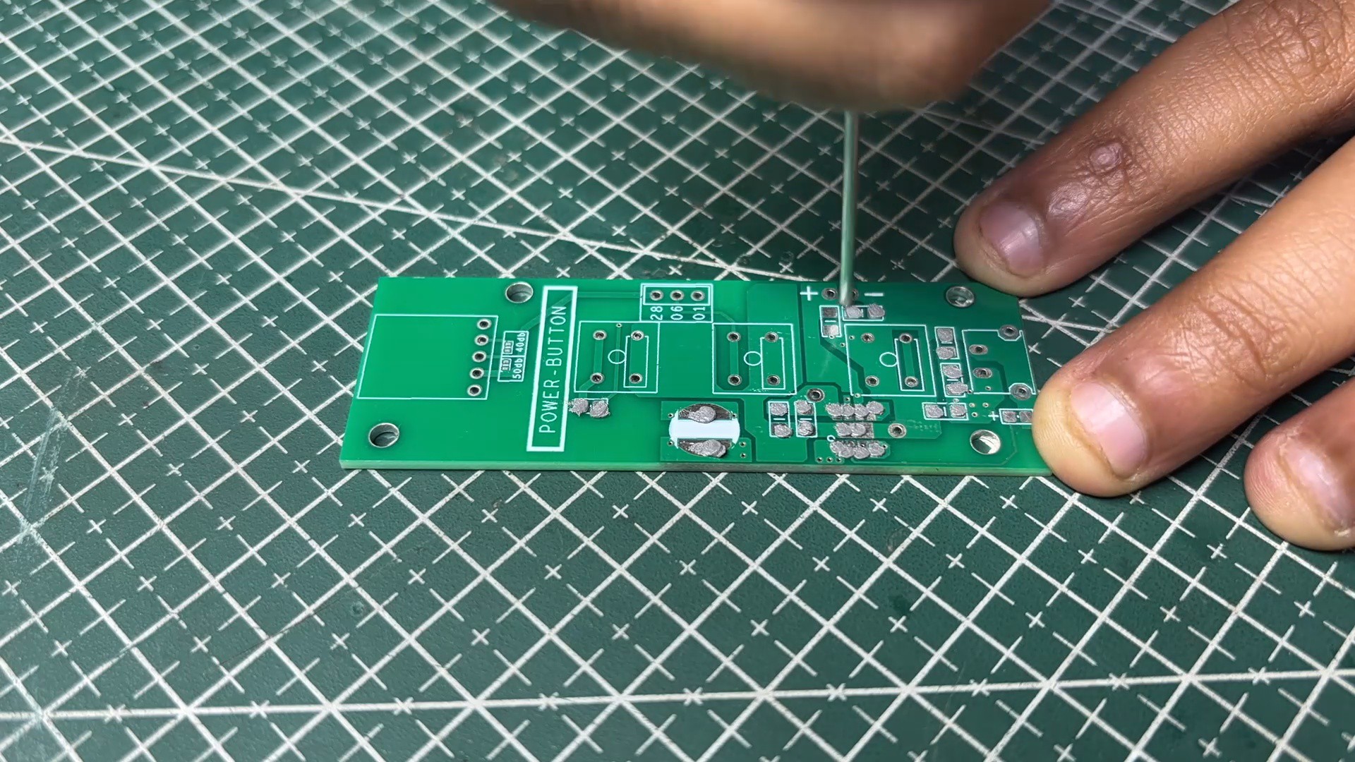

    PCB ASSEMBLY

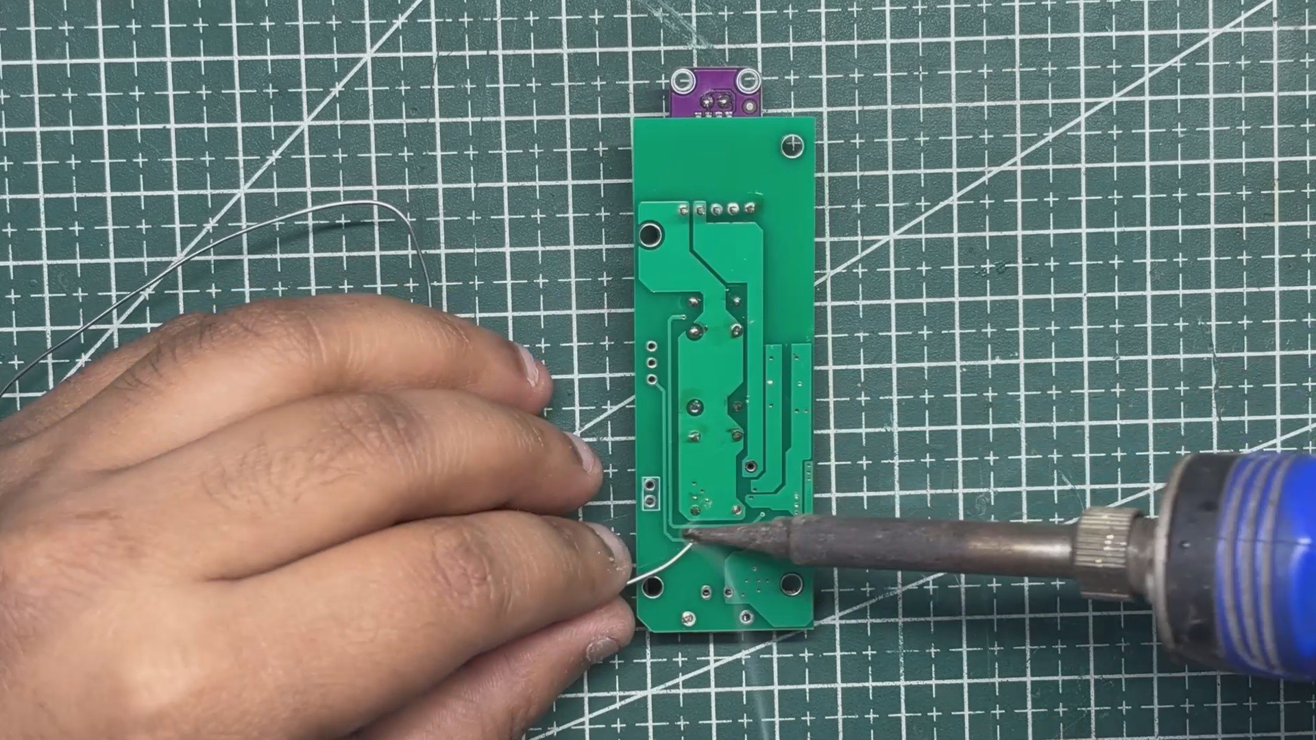

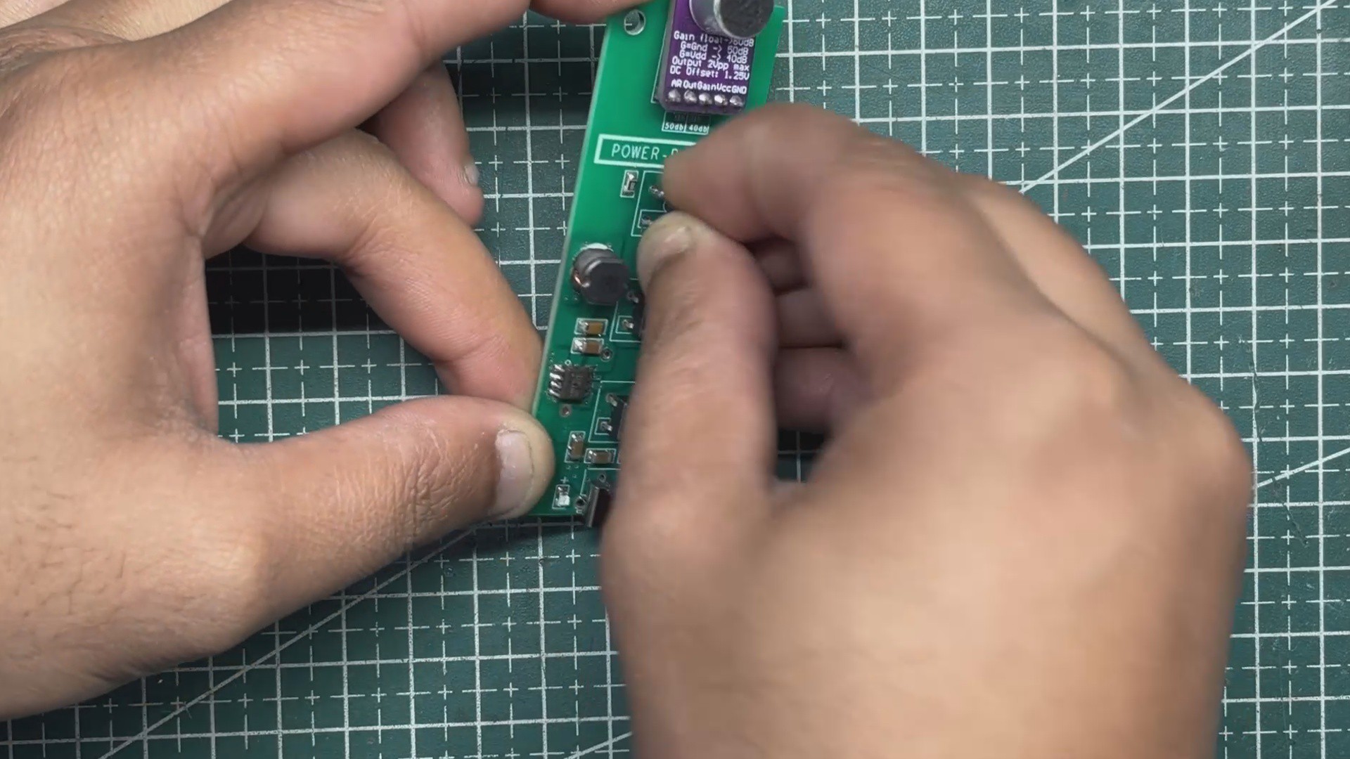

    • The PCB assembly process begins by applying solder paste to each SMD component pad one at a time with a solder paste dispensing needle; we are using 63/37 Sn/Pb solder paste here.
    • Next, we use an ESD tweezer to pick and arrange all SMD components on the top side of the board.
    • We pick the circuit and place it on the reflow hotplate, which heats the PCB to the solder paste melting temperature, causing all SMD components to permanently solder to their pads.
    • Now come the through-hole components; we begin by installing the push switch, followed by the type C port. The board is then flipped over, and we solder both through-hole component pads using a soldering iron.

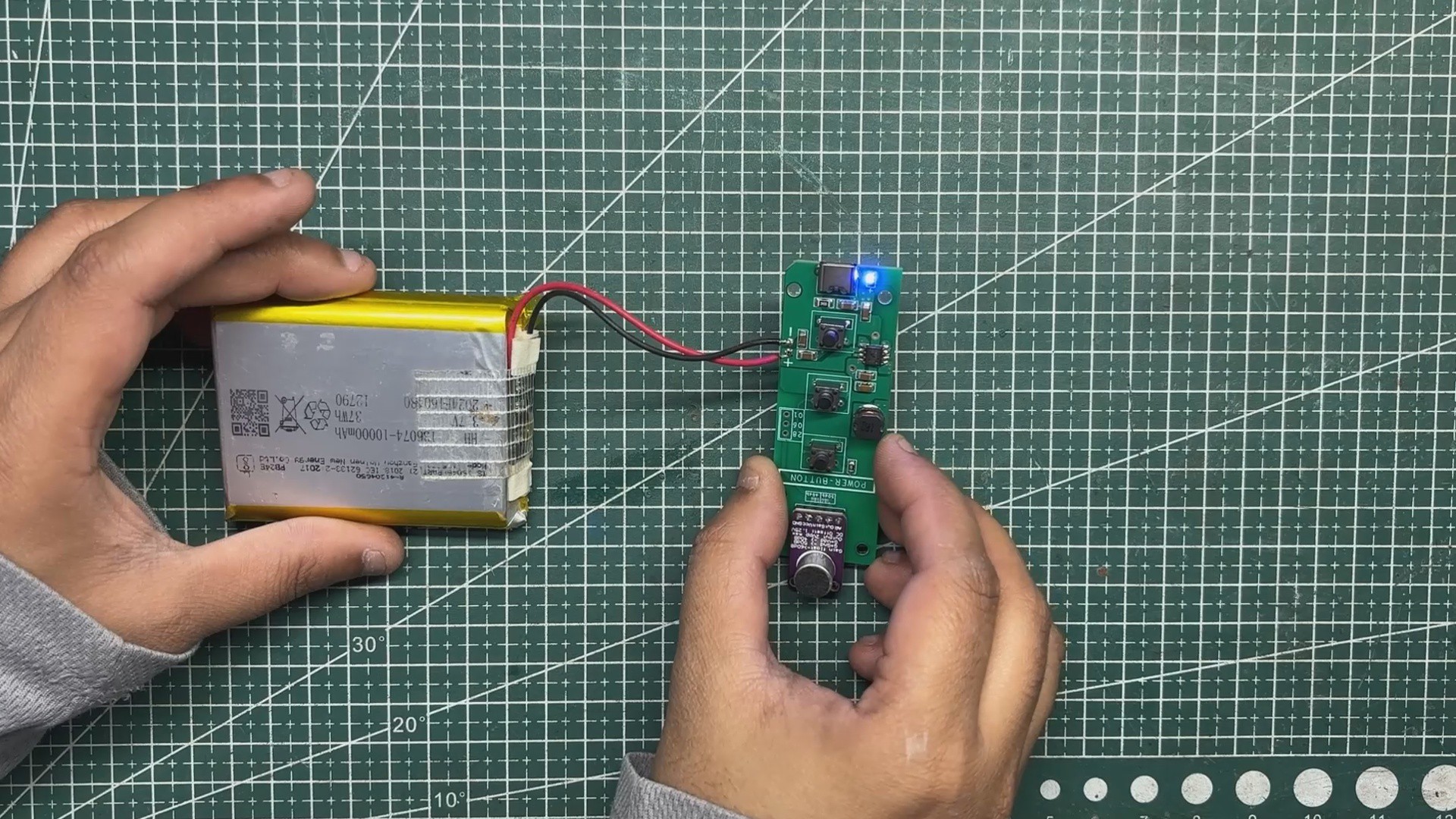

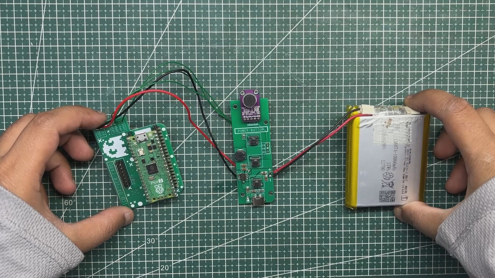

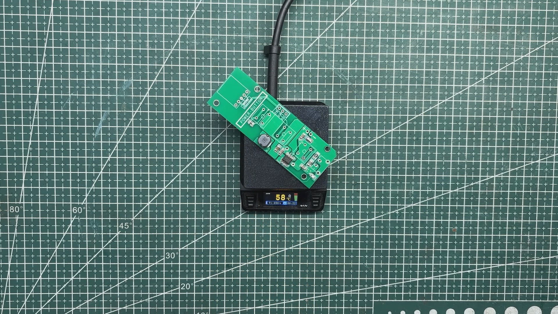

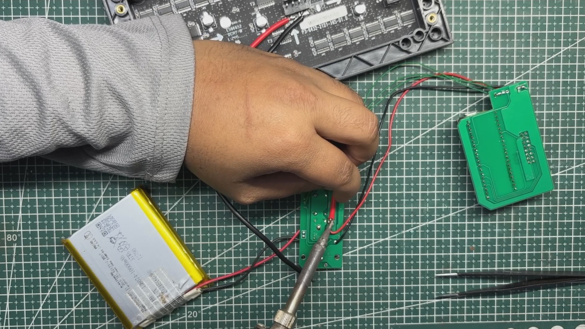

    POWER SOURCE
    For the power source, we are using a 3.7V LiPo cell with a capacity of 10,000 mAh. Since this device will be mounted on a wall and the RGB matrix draws a significant amount of current, we chose a high-capacity pack to ensure long, stable operation. The battery terminals were soldered directly to the Battery + and Battery – pads on the Switch–MIC–Power board.
    Pressing the power button once turns the device ON, and double-tapping it turns the device OFF.
    To confirm that the power setup functions properly, we used a multimeter in voltage-measurement mode. After switching on the power board, we measured the voltage across the output pin and GND.
    The reading showed a stable 5V, indicating that the entire power system is working correctly.

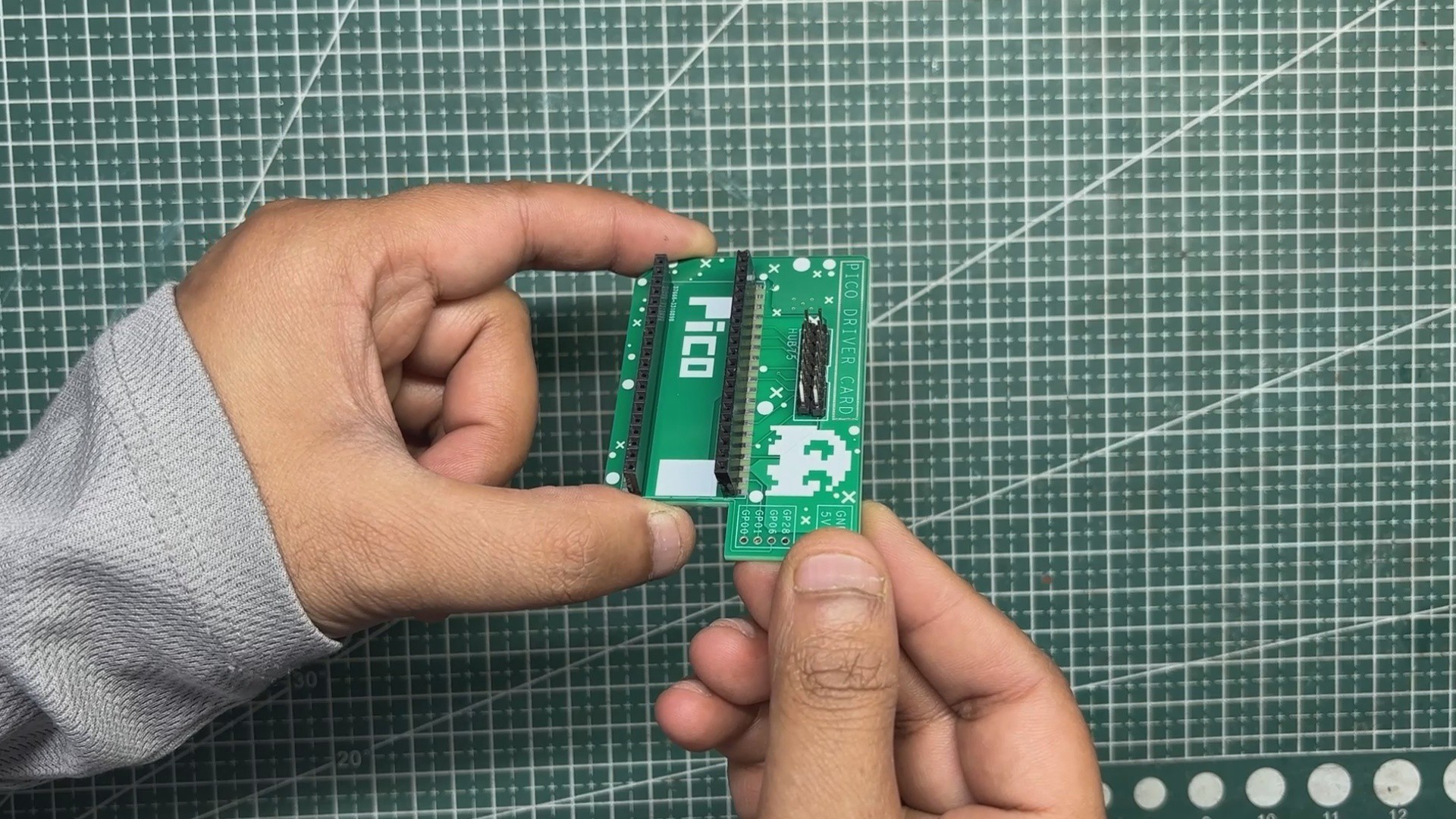

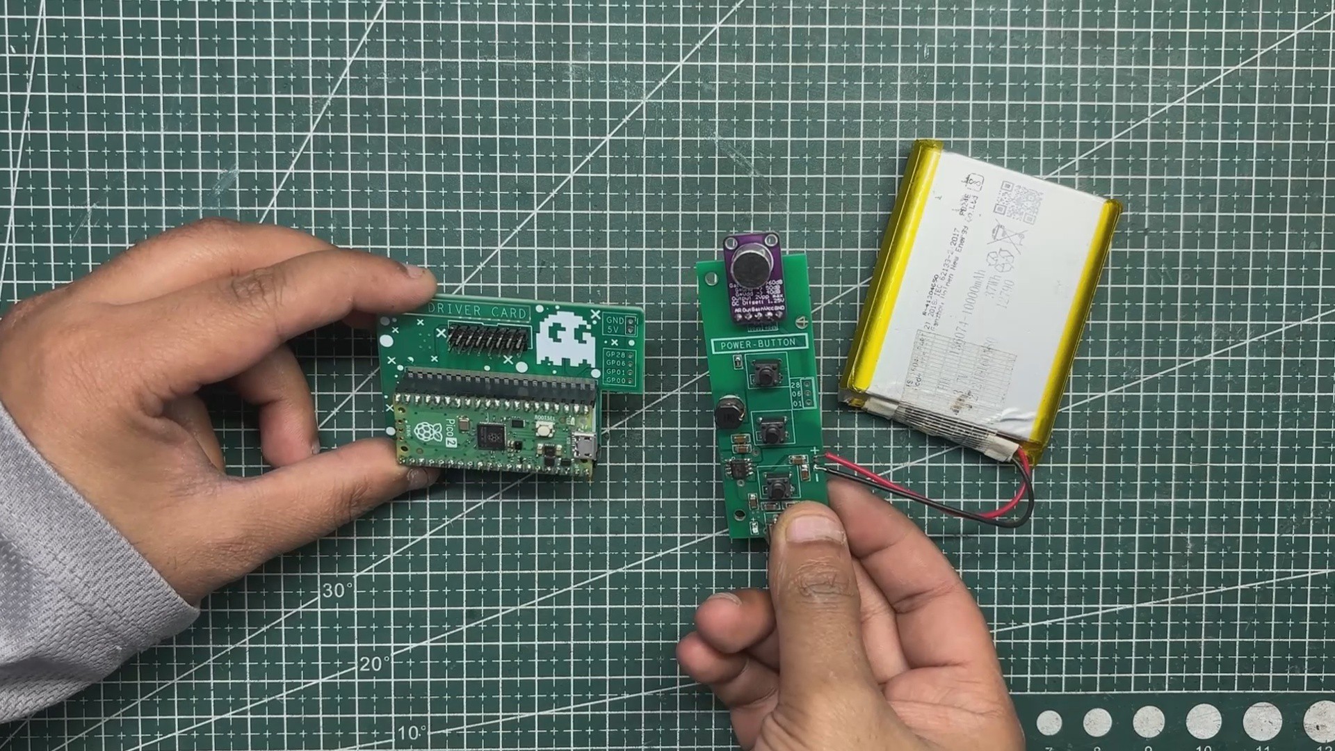

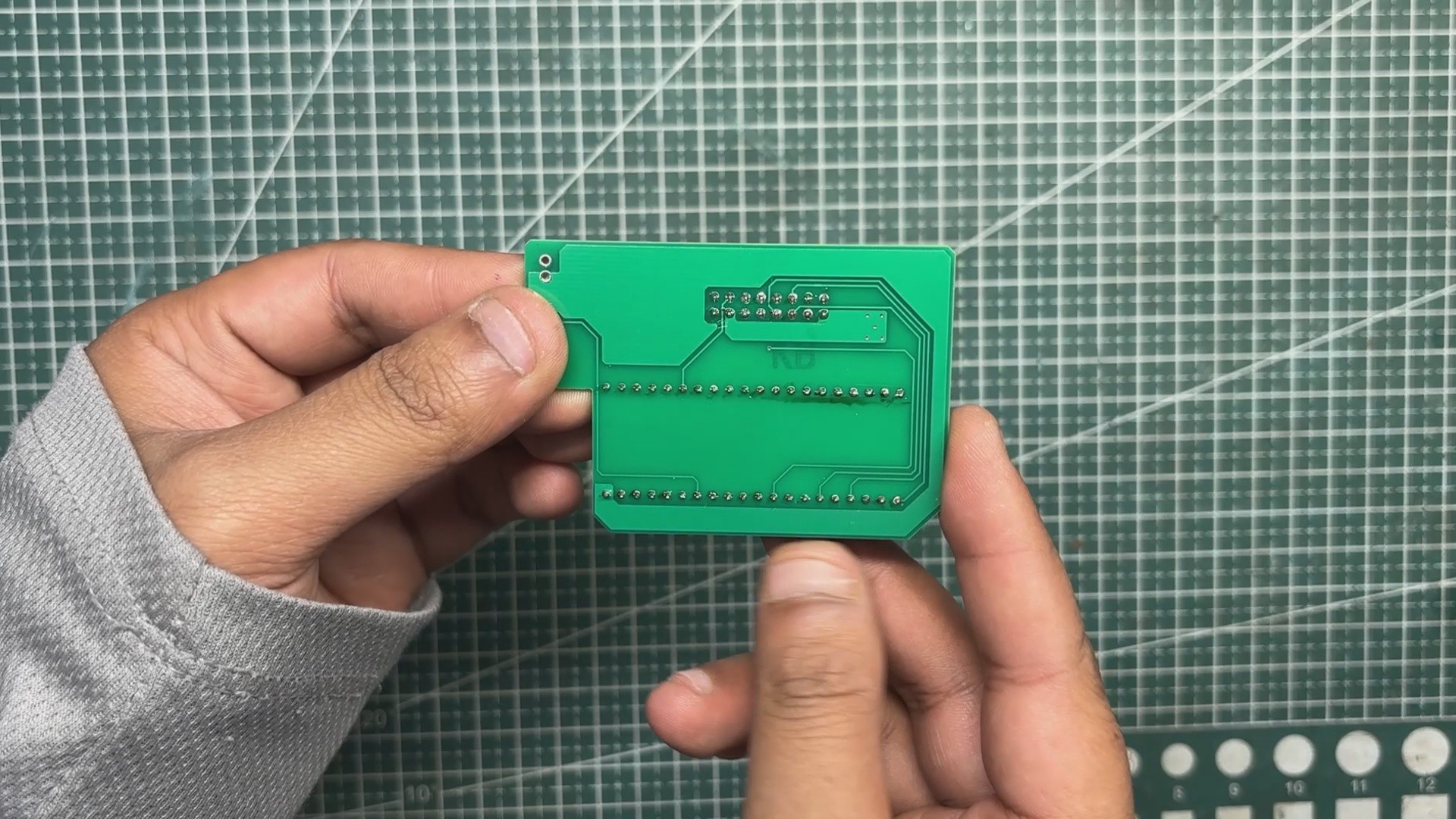

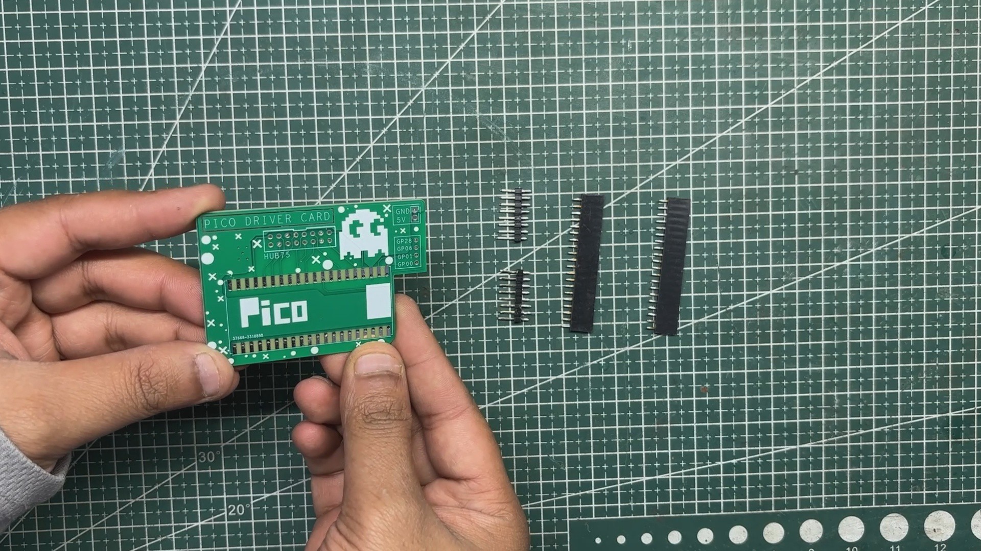

    PICO DRIVER - MATRIX SETUP
    • We start by placing the Pico onto the header pins on the Pico Driver Board, ensuring that it is oriented correctly.
    • Next, we connect the Switch–MIC–Power board to the Pico Driver by linking 5V to 5V, GND to GND, the MIC output to GPIO28, Button 1 to GPIO0, and Button 2 to GPIO1.
    • After that, we connect the LED matrix power lines: the matrix VCC goes to the 5V output of the Switch–MIC–Power board, and the matrix GND goes to the common ground.
    • Finally, we use the HUB75 wire harness to link the matrix to the Pico Driver GPIO pins. The cable is plugged into the matrix connector first, and then the other end is connected to the HUB75 socket on the Pico Driver board.
