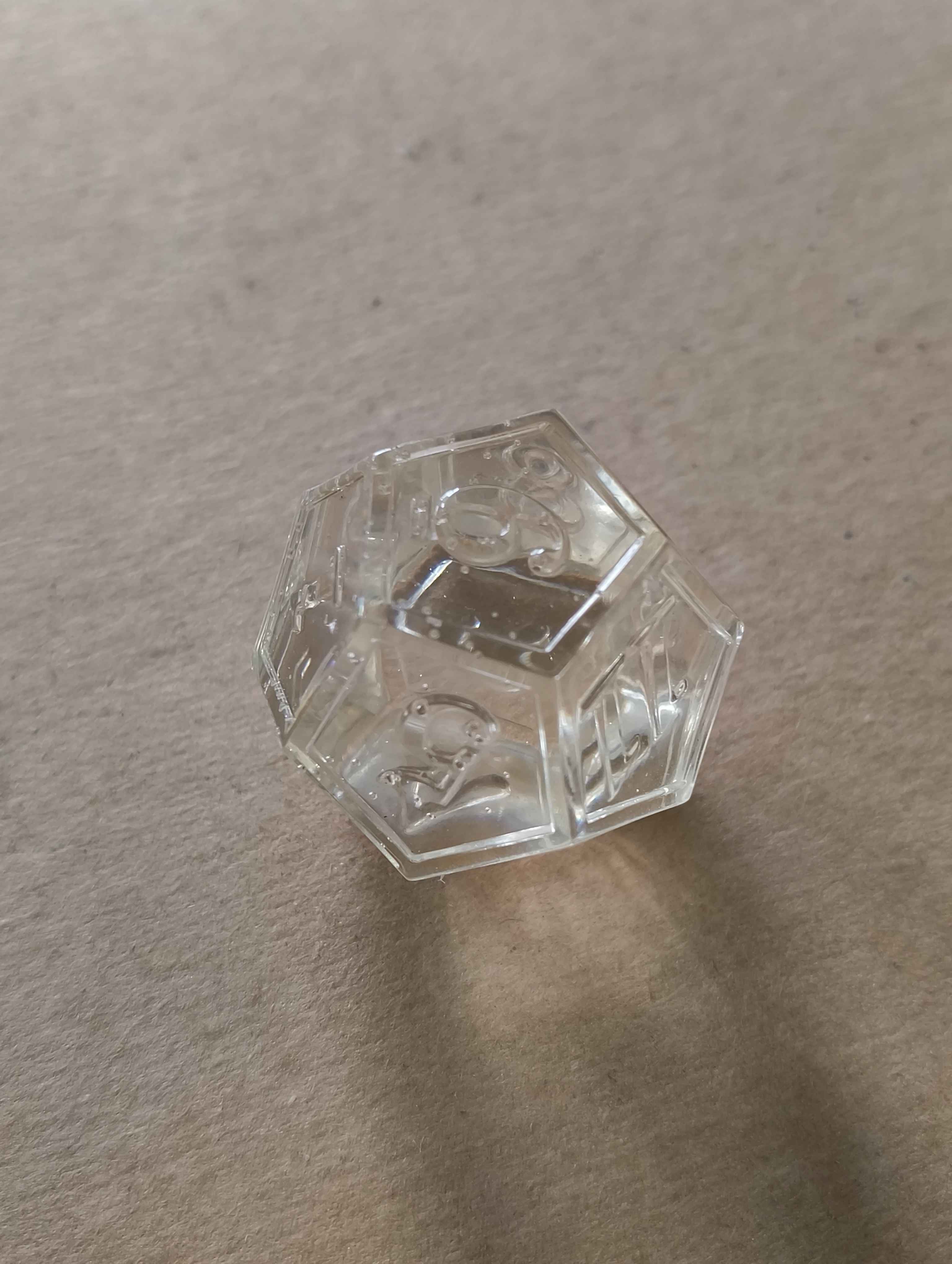

Clear D12
A nearly bubble free D12 I casted

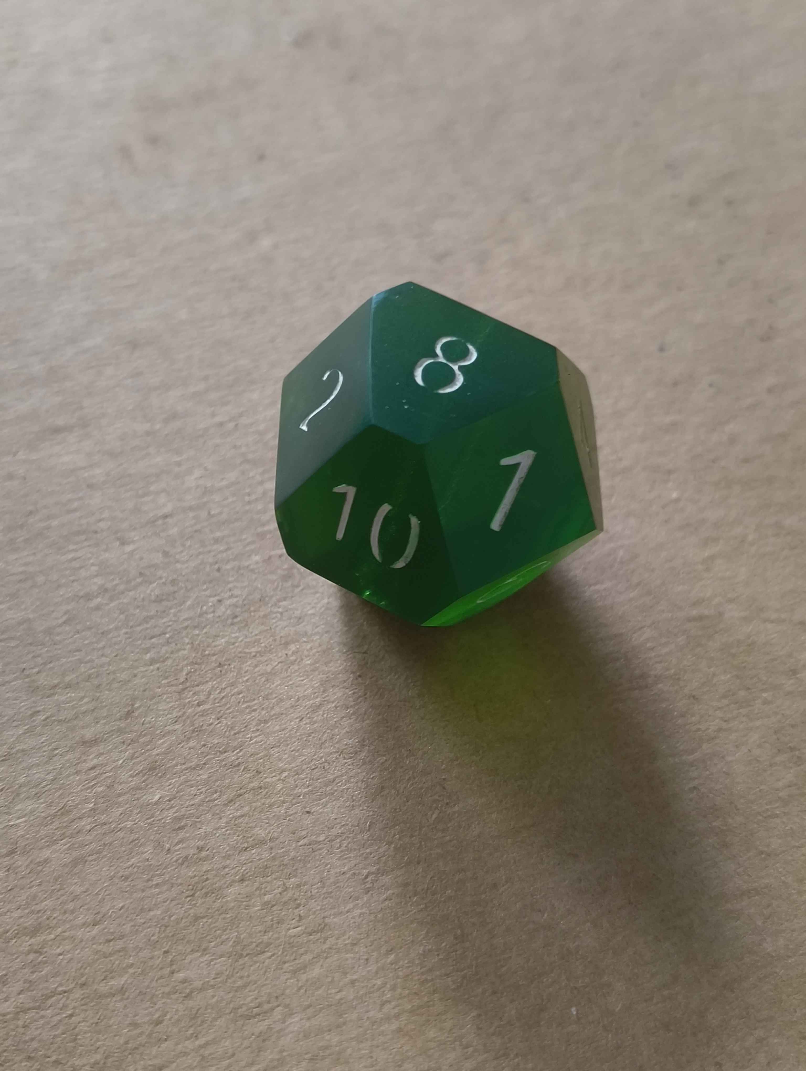

Green D14
The most useful die for DND: the D14

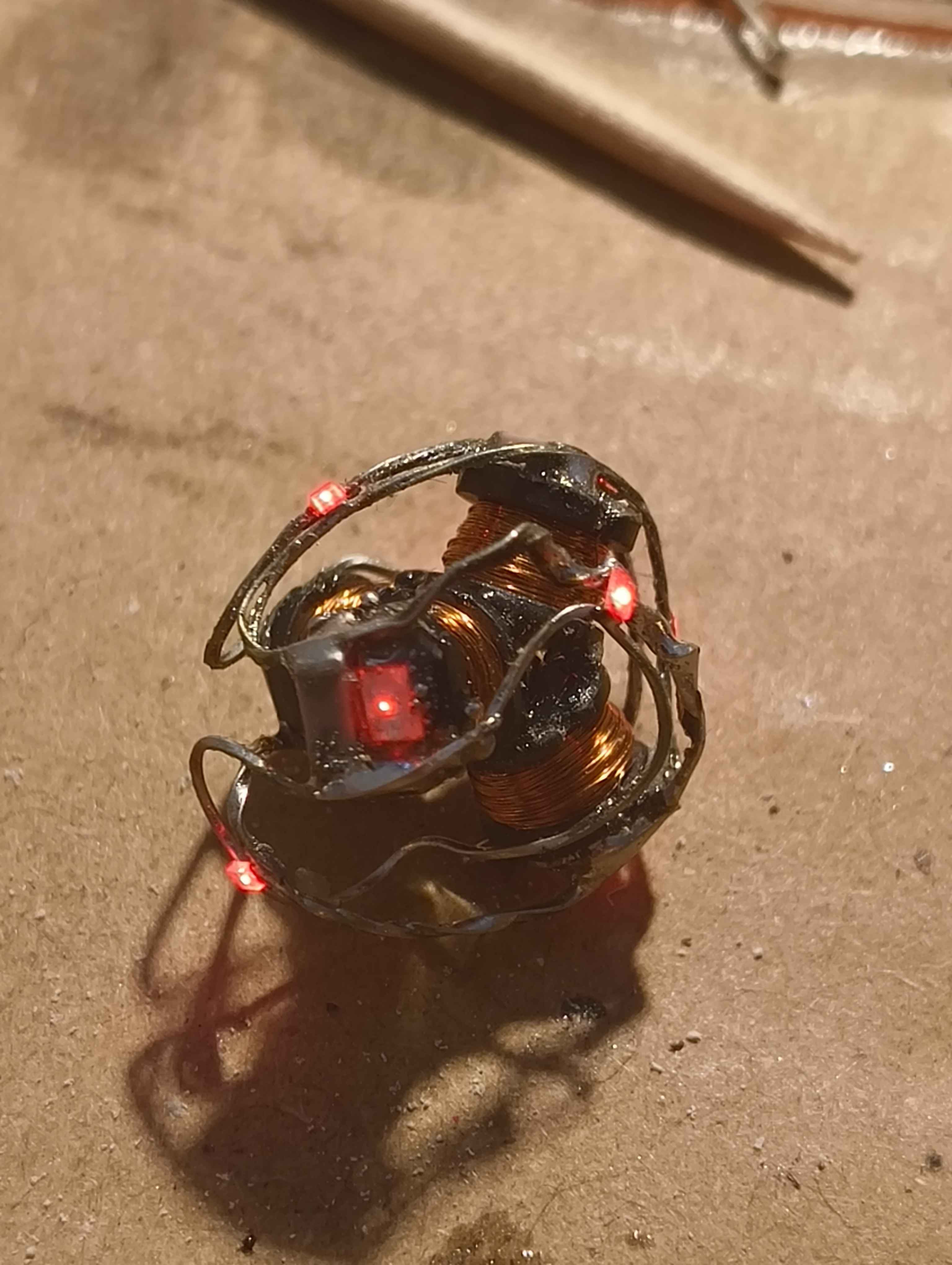

One of the "fascinating" and "100%" fair inlays I built for a dice
I wanted to technologize the dice. First, I put wireless LEDs into them, but the light of those wasn't spreading enough. Because of that I added some LEDs to them, which led to some interesting structures. I am not sure if they are still completely fair, but it looks pretty so I won't change that.
