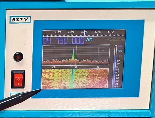

- Secondary TFT display that is used to display a spectrum scope and waterfall. There have been some visible enhancements to the user interface, including a retro-style tuning dial and signal strength indicator. Behind the scenes, the TFT driver has been extensively reworked to improve reliability and performance.
- The latest software release includes the ability to stream raw IQ data from the receiver to the PC. The data is taken after the FFT filter, but before the demodulator. In this mode, the receiver appears as a stereo audio source with the left channel carrying I samples and the right channel carrying Q samples. The audio hasn't been demodulated, so you can't listen to it directly, but it does allow compatibility with a range of SDR softw
- Now the receiver has an Integrated SSTV Decoder and it directly decodes SSTV signals on TFT display.
- The receiver uses a PIO-based oscillator to drive the Quadrature Sampling Detector. Probably the most common method for generating a quadrature oscillator is to use an SI5351 clock generator. The receiver now has support for an external SI5351 oscillator, which is not the case in this particular device.
Now let's turn on the receiver to see the difference in some segments compared to the previous project.
The large TFT display with improved waterfall dynamics and a characteristic retro scale is immediately noticeable.
