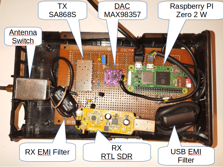

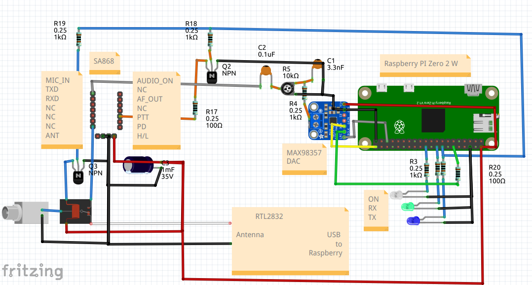

- Raspberry Pi Zero 2 W sends out the AFSK modulated tones (Bell-202 1200 & 2200 Hz) to its I2S interface, connected to the DAC MAX98357.
- The audio out of the DAC is low passed, regulated by a variable resistor and sent to the SA868S modulation input.
- SA868S outputs a power of around 2W, narrow band FM modulated.
RX
- It uses an RTL-SDR USB dongle, with EMI filters on both RX and USB paths to reduce noise and improve RF performance.
- The received packets are decoded and shown on the web interface.

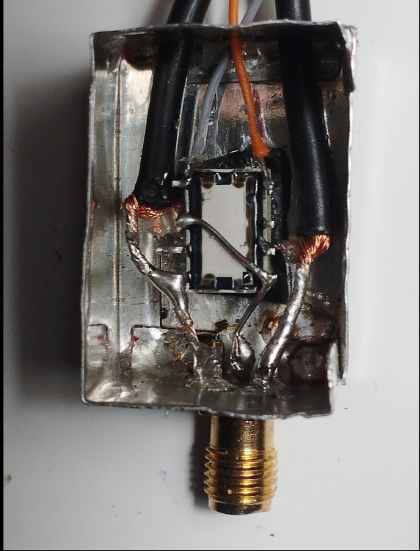

RX-TX switch
- It is built using a micro relay shielded inside a tin plated box.
- It is driven by the PTT (Push to Talk) output.
