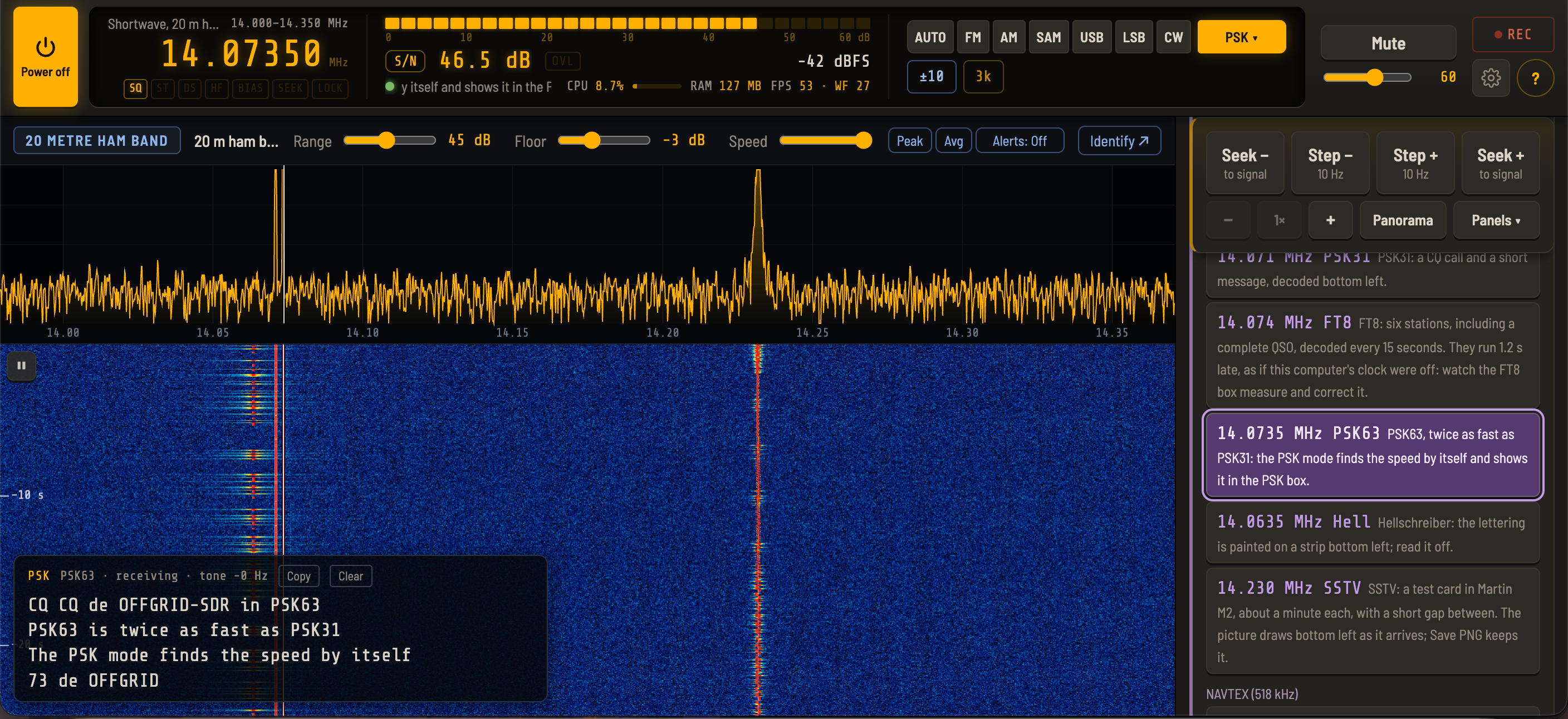

Decoders: DRM · RDS · CW · RTTY · PSK31/63/125 · FT8 and FT4 (with countries, distances and deep decoding) · WSPR · time signals · NAVTEX · DSC · ACARS · APRS · AIS ships · SSTV · Hellschreiber · weather fax

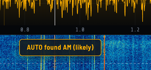

AUTO: listens for a couple of seconds, works out what the signal is, and switches to the right mode, tuned exactly onto it.
Waterfall replay: heard something a moment too late? Pause the waterfall, box any signal from the last minute, and replay it, decode it, or save it as MP3 plus a raw IQ file for SDR# and SDR++.

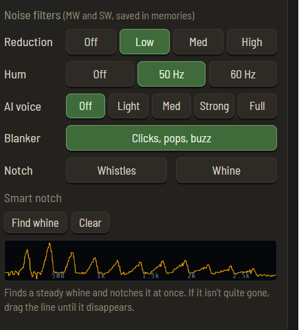

Listening tools: synchronous AM with selectable sidebands, noise reduction, a noise blanker, hum filter, auto notch, an AI voice cleaner (RNNoise), smart notch, squelch, seek, scan, 50 memories, frequency labels, a logbook, recording and Panorama (up to 10 MHz at once).

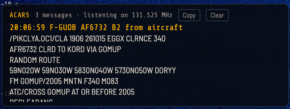

    VDL2 decoding. VDL Mode 2 is the digital successor to ACARS: aircraft and ground stations exchanging short D8PSK bursts at 10,500 symbols a second, around 136.6 to 137 MHz. OFFgrid-SDR now decodes every VDL2 channel in the stick’s view at once, picking the channel set from your locator (six channels in Europe, four in North America, or the worldwide common channel at 136.975 MHz). ACARS messages carried over VDL2 are shown in full, with registration, flight, label and text. The network traffic (CPDLC and friends) and the acknowledgements are summarised, and there’s a “Messages only” switch to hide the chatter. Each aircraft’s country is looked up from its 24-bit ICAO address using a built-in table, so it works with no internet connection at all.
    The decoder was written from the standard rather than ported. To keep myself honest, I built dumpvdl2 locally and used it as an oracle: first to prove a VDL2 transmitter I wrote for the demo was correct, then to check the receiver against a real recording made near a local airport. On that recording, OFFgrid-SDR decodes the same four frames dumpvdl2 does, including a Ryanair position report. Along the way, the testing caught a Reed-Solomon bug, an HDLC framing bug, and a missing filter that was costing a few dB on weak bursts. The decoder runs in a Web Worker, and a shared channeliser plus some hot-loop tuning took six channels from 80% of a core down to around 11%.

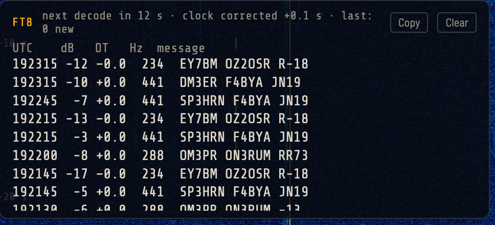

    FT8, FT4 and WSPR need an accurate clock, which is hard with no internet. 1.9 tackles that properly:
    • A first-time setup (only when you first pick FT8, FT4, WSPR or Time signal): it sets your location, then finds a shortwave time station. That station's carrier calibrates your stick, and its time code sets the clock. Skip it any time.
    • Clock details: how far out your computer's clock is, how fast it drifts, and how to set it.
    • OFFgrid-SDR learns how fast your computer's clock drifts, and follows it between checks.
    • WSPR now decodes even with the clock a minute or so out, then corrects it to a tenth of a second. A laptop that's been off-grid for weeks comes right just by listening to WSPR.

    Deeper FT8 and FT4
    On a busy band, strong FT8 stations hide weaker ones underneath. 1.8 does what WSJT-X does: once a message is decoded, its exact signal is known, so OFFgrid-SDR rebuilds it, including the smoothed frequency changes real transmitters use, fine-tunes its timing and frequency against the audio, and subtracts it. Then it decodes again, up to three times.
    On a busy simulated band that finds about one extra station in five, and weak stations hidden under strong ones went from 1 in 18 to 10 in 18, with no false decodes. Stations found that way are marked with a ◆, and the number of passes adapts to the computer so a decode always finishes inside its slot.

    It also now recognises FT8, FT4, ACARS, PSK63 and PSK125. It no longer mistakes fading AM for Morse, an off-tune voice for PSK, or fast Morse for Hellschreiber. Each of those fixes came from a diagnostics log of a real signal it got wrong.
    FT8 and FT4, still completely offline
    There’s a new FT4 decoder alongside FT8, and the decode list now shows each station’s country and its distance and bearing from you. None of that needs the internet:
    • Countries come from a table of callsign prefixes built into the file, covering 269 countries and areas.
    • Your location comes from 620 built-in cities, a locator you type in, or the computer’s GPS if it has one.
    • The clock, which FT8 needs within about a second, is corrected from the timing of the stations it hears.
    The list can be sorted by distance with one click, which is a nice way to see how far your antenna is reaching.

    **FT8:** decodes everyone in the passband every 15 seconds. It also corrects the computer's clock from the stations it hears, so it works offline. The demo has FT8 stations on 14.074 MHz
    **ACARS:** aircraft text messages on the airband, decoded and listed. The demo has an ACARS station on 131.550 MHz
    **PSK** (was PSK31): now decodes PSK31, PSK63 and PSK125, and finds the speed by itself. The demo has a PSK63 station on 14.0735 MHz

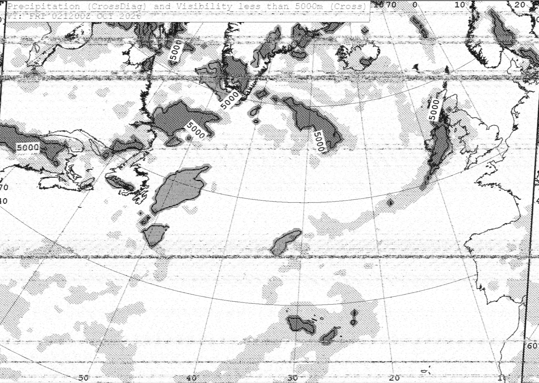

    Weather fax also works from any band now: choosing FAX away from shortwave tunes to the first fax station in the list.

    The headline feature. OFFgrid-SDR now includes RNNoise, a small neural network trained to separate speech from noise. It clears hiss, roar and noise-type jamming from voices in AM, SAM, SSB and FM voice, and in testing it took pure noise down by over 30 dB while leaving speech untouched.
    • Four strengths: Light, Med, Strong and Full, in Audio & gain next to the other noise filters
    • Built for speech: the stronger settings quieten music, and Full silences it. Light and Med blend in some of the original audio, so music stays audible
    • It runs entirely inside the page, offline: the compiled network (about 112 KB) is embedded in index.html as WebAssembly, and only loads when you switch it on
    On weak, hissy SSB it's genuinely impressive. Credit to Jean-Marc Valin and the Xiph.Org Foundation for RNNoise, and to Jitsi for the WebAssembly build.
    ==== SMART NOTCH ====
    That steady whine from a heterodyne on a broadcast station? Press Whine. OFFgrid-SDR listens to the last 3 seconds of audio, finds a tone that stays at exactly the same pitch the whole time (speech and music move about; a whine doesn't), and notches it at once.
    • On the demo whistle it cut the whine by over 50 dB
    • It skips mains hum and points you to the Hum button instead
    • A strip shows the audio you're hearing: click to drop a notch where you like (with a hover preview), drag a notch until the whine disappears, scroll to nudge it, right-click to remove it
    • Up to three notches, cleared when you change station

    AUTO is a switch. Turn it on, and every time you tune somewhere new, OFFgrid-SDR listens for a couple of seconds, works out what the signal is, switches mode and tunes precisely onto it. A banner says what it found and how sure it is.
    • Shortwave: CW, RTTY, PSK31, NAVTEX, DSC, weather fax, SSTV, Hellschreiber, AM and SSB
    • VHF/UHF: narrowband FM and airband AM
    • The FM broadcast band: wideband FM
    • It even recognises DRM digital broadcasts (which a browser can't decode) and tells you what that block of hiss is
    • If nothing is clear, it picks the band's usual mode: the right sideband on the ham bands, AM on broadcast bands, narrowband FM on VHF
