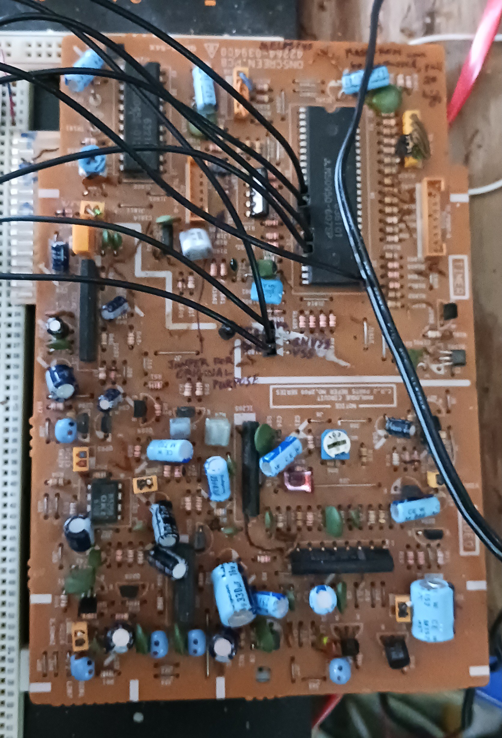

The rabbithole project. Briefly:
"logicInstrument" is a logic-probe 2.0 suited for determining the *cause* of the logic-values it detects... It tries to inject a different logic-value in various ways to see whether the original signal is e.g. driven from a uC/TTL output, tied to a power-rail, or pulled via a resistor. It can help determine if a signal is e.g. open-collector, etc.
Why'd I build this?
Well, in order to inject signals, later... e.g. via my own microcontroller.
Can it be done without causing contention?
E.G. the unit we're reverse-engineering has two microcontrollers which intercommunicate via an 8bit port along with four other signals. It seems plausible that one might be the unit's "brain" (the user-interface), while the other might e.g. control the peripherals.
So, let's say we want to disable one of their uC's and use our own in its place... Say we want a new UI, from our own uC, but still want to use the peripherals via the original peripheral-uC.
Can it be done *without* cutting the traces from the original "brain" by putting it in reset? This brings up several more questions such as: Can the original "brain"-uC be put in reset without cutting traces to its reset circuitry?
Well, once I started tallying up the number of such questions--and considered that traces go under the chips and vias and that the other side of the board is relatively-inaccessible (because it has to be covered with the keyboard-membrane if I want to try anything), and considering I wanted to try out these ideas on a *different* system, first, before risking "my baby"--I started to realize I didn't really want to try to figure out where *every* pin goes; what kind of circuitry is attached, where *every* resistor is tied, etc... Maybe you'll see why in the following picture.
This is the *other* system... the system I'm willing to risk damaging, in order to plan/practice on before performing surgery on "my baby". They're both based on the MELPS-740. This comes from an old VCR, which is long-gone. It will never get reassembled. Most of the other boards are missing, too. So I have no idea where most of these signals go. But one thing I do know is that's a LOT of resistors, of various values. And there's a LOT of analog circuitry, as well, and I'm not so great at analog. And, from looking at datasheets, I see it's *also* capable of high-voltage logic-I/O. But, I'm not messing with that, I'm only connecting the *known* 5V (from the uC's pinout). So, then, e.g. are higher-voltage circuits, unpowered,...

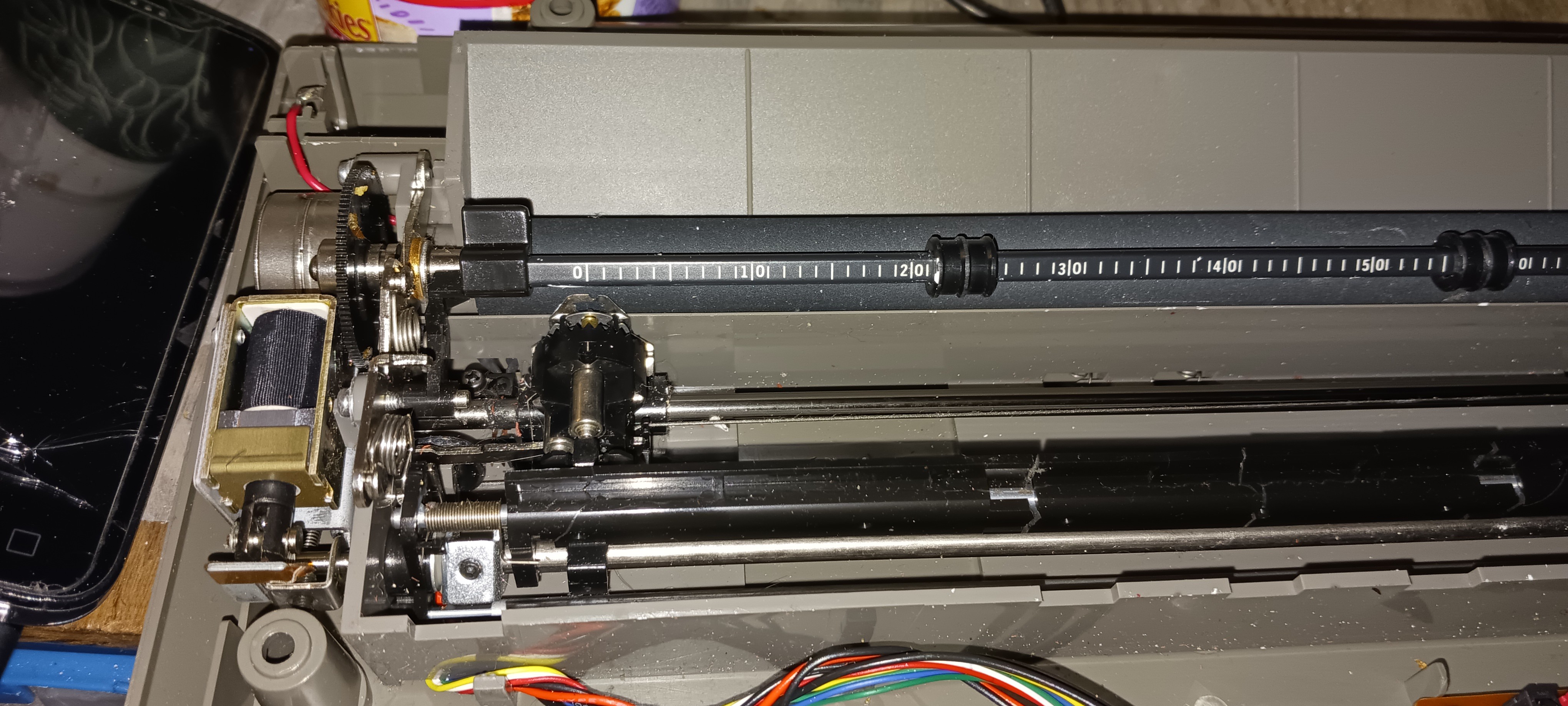

Could it really be so simple?

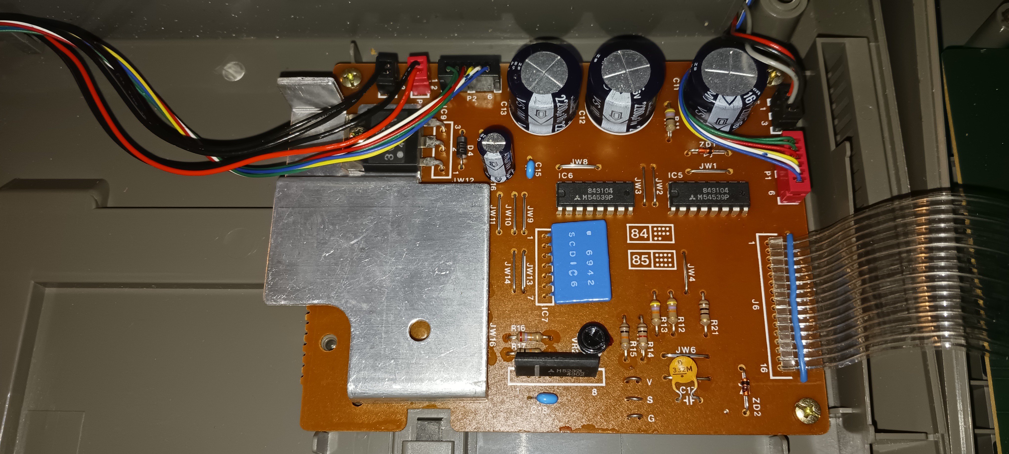

This is the motor-winding-phases as sent to the driver-board when "arrowing-right".
When the button is first pressed, it seems to go exactly one character-width, then if it's held for longer than half a second, or so, it starts moving continuously.
My logic-analyzer isn't set up to capture the continuous motion, but looking at this, it looks rather clear to me that there is no acceleration/deceleration used.
Seems crazy, considering all the massively-varying loads.
It also looks like it times-out after several miliseconds of non-motion, cutting power to the windings.
This, I think, explains why the initial step *almost* looks like it's accelerating. But, really, it's because the first step turns on only one winding. If you look at the hex-value represented by the four wires at the start it goes 000000111333222
that same 1-3-2 pattern repeats, later, at sample 26.
But, it doesn't start with 0, instead it continues from 9. The "last" winding (D3) is still on when the pattern begins again.

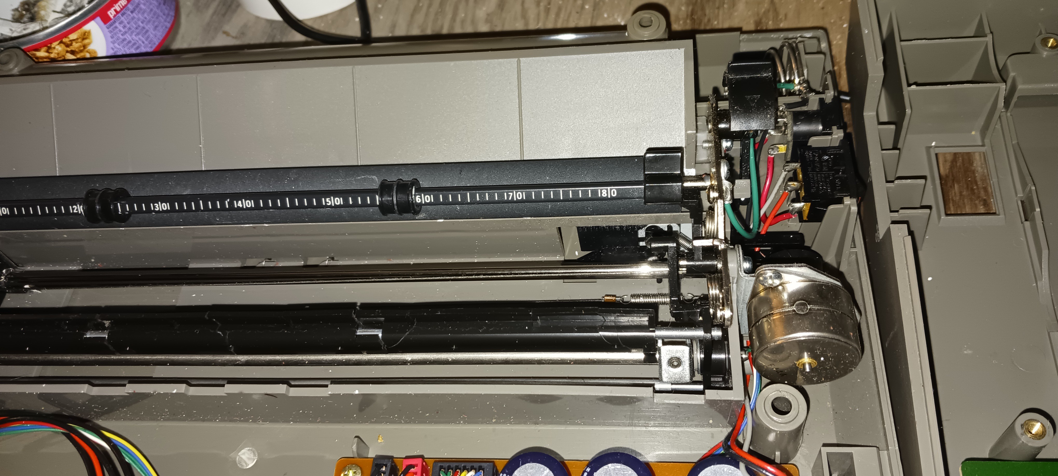

This is [all] intriguing to me because I've done quite a bit of stepper-control over the years, and, frankly, I still don't really "get" it.
Most the steppers I've worked with are of the "NEMA" sort, whereas these are "pancake". I don't really think that, specifically, should make a difference in how they're driven except that, in a case like this, the motors are geared-down quite a bit. The pancake motors usually have a much lower resolution, e.g. 32 steps per revolution vs 200... Which, frankly, I'd've expected would make them *weaker*, since the electromagnets have to rotate the rotor that much further, across a greater air-gap.
But, maybe I'm mistaken... because this system has "wowed" me from the start at its speed and its ability to switch-direction so often without, apparently, losing steps.
So, then, we have another weird-to-me observation with these phases' powering-down when unused... In my experience doing similar, the motors often snap into a new position.
So, then, it comes down to "full-stepping" vs. "half-stepping", which I've gathered are actually not-well-defined. (whereas, maybe, "half-stepS" and "full-stepS" might be, confusingly, well-ish defined).

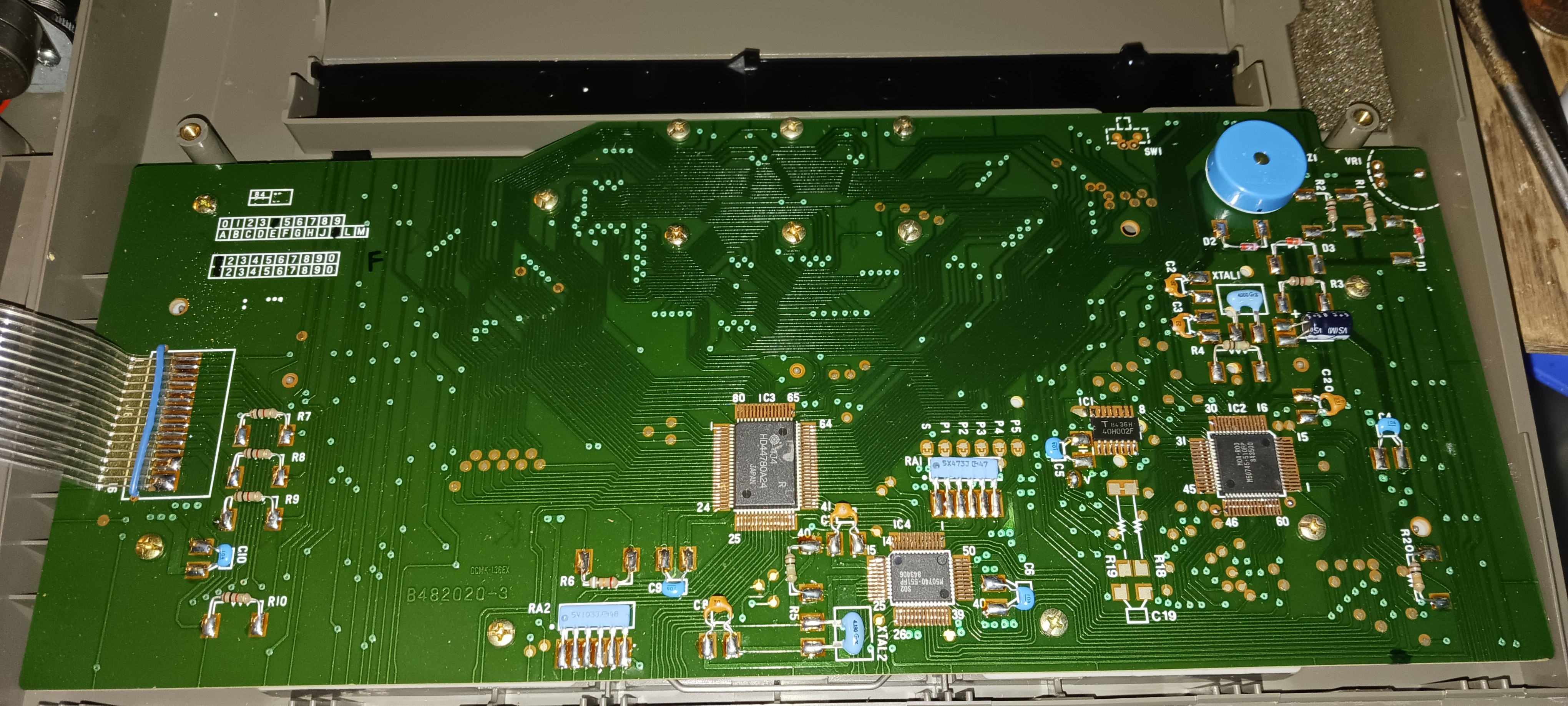

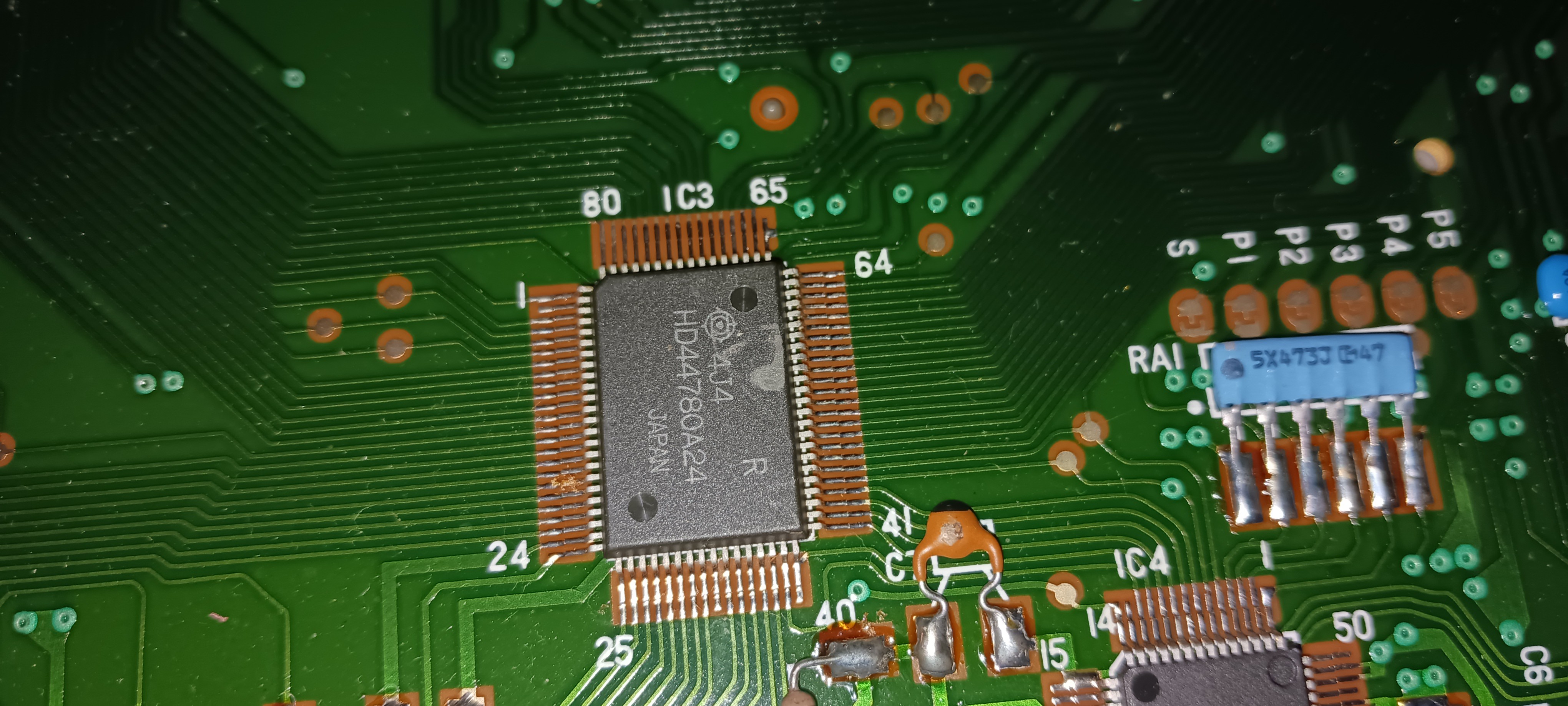

After a couple days of tracing (and correcting booboos), I finally mapped out the keyboard. As mentioned before, there are 18 gpio lines, and in this case they map to IC1 Ports 5 (all), 1 (two bits), and 0 (all).
Now I need to collate these results into an actual keyboard matrix. I'm planning to transcribe this net data into Excel and do a little data massaging there to get the rows/columns worked out. I hypothesized that there are 8 bit columns which are read at once, and 10 row lines that are sequentially activated during scanning. There's no basis for this hypothesis other than it would be sane and likely simplify code in this constrained device. I semi-arbitrarily named P0 as the column port, but this could be wrong. (At least I know it's not port 1, haha.) The shape of the resulting matrix should make things apparent.
My mapping was fraught by 3 nets that are hidden under IC2. I have a guess that I feel is pretty good because of 2-D topology of the component side of the PCB (if there were more vias then this would be more ambiguous). So Eric will need to buzz it out to verify. This should be a quicky because two of those nets have easily accessibly test points, so it would just be testing continuity between a testpoint and a chip pin. I'll request that separately with an indication of the test points involved and my guess where they go.
There's 36 trace layers for the keyboard (18 lines, two sides), so I'm not going to post those. Instead I'll just post this one that is a merging of all of keyboard-side nets against a solid background (it's too noisy against the board shot). I also made a keyboard legend to help identify what button is what.
Oh, and there's a 'secret' key I labelled "???!" that exists on the board but does not exist on the physical unit case. What's even more trippy is that the elastomeric sheet does have a key for that button. And it has keys for buttons that are not on the board! This board has 5 buttons on each side, but the elastomeric sheet has 7! Another curiousity is that the board has two buttons for 'Return' (which are wired in parallel, so not really two buttons), but the elastomeric sheet only has a key for one of those buttons. Hmm! Mysteries of manufacturing.
So, now a lot of net transcribing into the warm fuzzy world of machine readable text and on to Excel collation....
LOL, OK, so it would seem that simply cropping the photos on my phone causes them to be saved in a higher compression, as well... Sorry... No longer cropping.
Oh the irony that of the 13 photos I uploaded, this, the blurriest, was the only one that appeared. "for clarity".

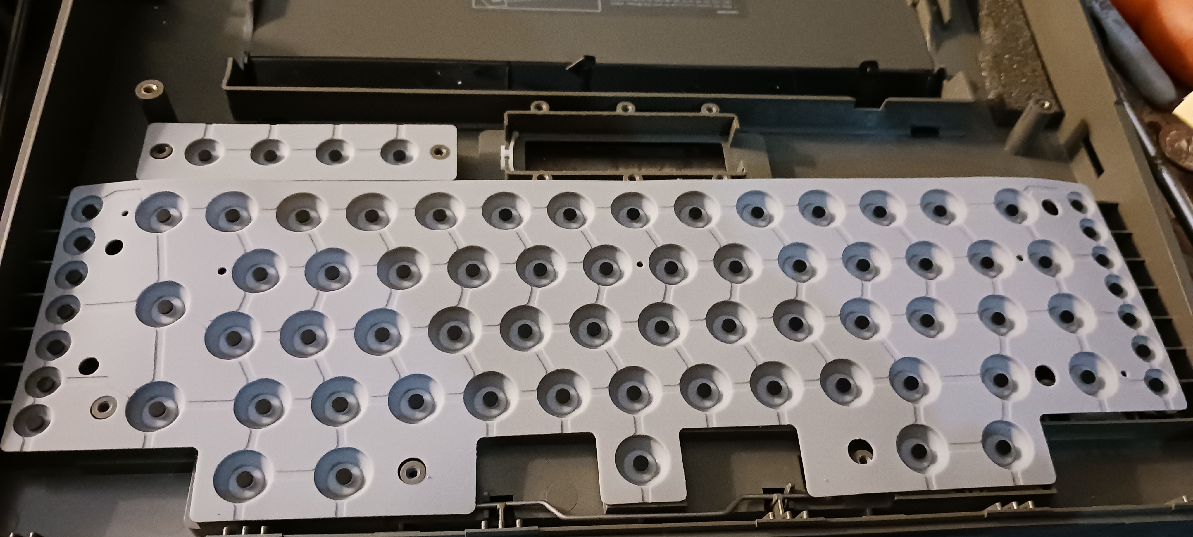

The coup de grace will be mapping out the keyboard matrix. So boring! And 76 buttons! That implies a
⌈76/⌊√76⌋⌉ + ⌊√76⌋ = 18
lines for a minimal rectangular array.
It's going to be a lot of wires, and I don't know what are rows and what are columns, and I probably need to formulate a game plan before rushing into it. So to procrastinate creatively, I decided to map out the wires connecting the two MCUs. As mentioned before, the LCD data lines go to a smaller M50740 (3 Kib ROM, 96 by RAM), but the control lines are on the larger M50745 (6 Kib ROM, 192 by RAM -- how did we get anything done in those days?) So there's wiring between the two devices to coordinate.

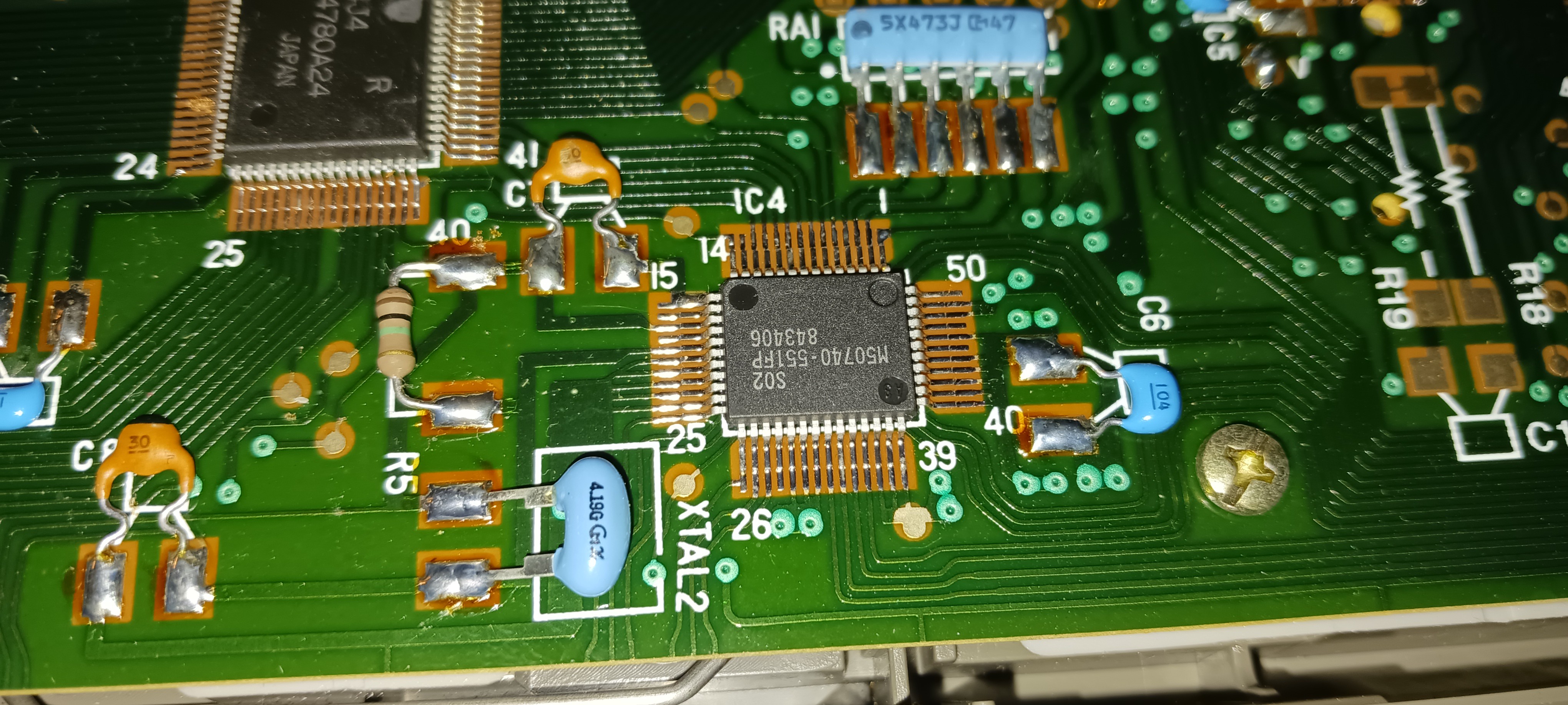

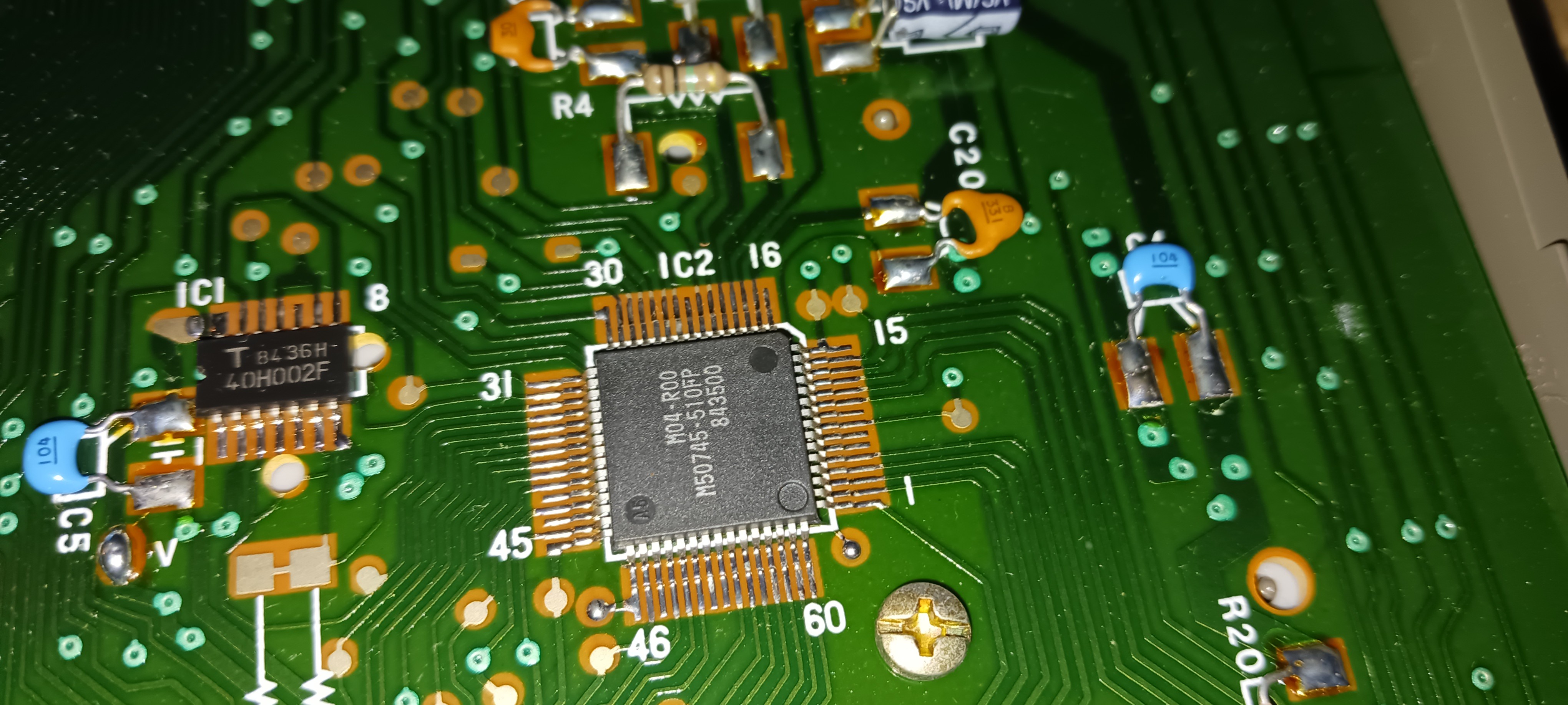

So there's 5 lines between the two. The thing that is striking about the M50740 is that pretty much everything except for the 8 LCD data lines and these 5 'coordination' lines is tied high or low. So surely it must be doing something more that providing another 8 bit port because we used more than 8 bits to get that! EDIT: Eric clarified via buzzing out that all the LCD lines are brought to IC1, so 6 of these 11 are those.
Oh, there is a little more -- there are 5 'option' solder bridge pads that tie directly to the M50740. I have no idea what they are. None are bridged in this unit.
OK, having done that, I couldn't resist doing at least one wire of keyboard just to see what it looks like. So I picked an arbitrary one to kick the tires with the process:
The thing that is striking to me is that this has 8 buttons in it. Coincidence? And it runs to a gpio on IC1. So I think IC1 does the keyboard scanning, too.
As said before, I think the keyboard is going to be some work, so I'll try to get a game plan. I might wind up doing one layer for each line, row and column, but that's going to be 18 * 2 layers, hahahaha! I wonder if my ancient Photoshop can handle it? Yeah, I probably should have done this tracing in a vector graphics tool. Hindsight!
Anyway, one bit of reasoning is that since I have traced out a row (or is it a column?), then all the other lines on those buttons must then be columns (or rows -- I guess it just depends on the orientation of the matrix). So I'll next proceed doing columns of those buttons.
Because it is likely a 8x10 matrix, it seems sane that the side with 8 lines would go to the same port. That would simplify code, and this things only got 6 KiB rom and 192 bytes ram. So that can be an intuition that might help in puzzling things out at some point.

Here's the total pinout of IC4... Dave was spot-on about everything he could see in the photos, and even the guesses he had made where it couldn't be seen.
I turns out the LCD's data lines are actually all connected to both chips. My guess is that IC2 actually drives the LCD, and that IC2 is also using that same data-bus to communicate with IC4... But there's still some weirdness about it all... because what, then, does IC4 do?!
Its INT pin does seem to go all over the place, and I was able (I think) to track it down to a keyboard key in the board photos (I'd really rather *not* take that board off its mounts, since I feel I was lucky getting that LCD back into the case without having to remove it from the zebra strips and risk total misalignment).

Interestingly, I wiggled the solenoid's shaft by-hand, and I think Dave's theory of its latching is correct, it seems to hold in either position. It turns out the solenoid shaft is also magnetic! So, then, one polarity would suck it in, and the reverse polarity would spit it out! Never seen the likes. I've seen similar where *two* windings were used, but this solenoid has only two pins! Cool! And, kinda surprising that its holding-force is enough to overcome the spring in the pen, and movement along the pen-pusher thinggy.
So, I think Dave's right, the weird blue chip is an H-Bridge, and the NOR logic assures that it doesn't try to go both forward and backward at the same time...? Maybe converting a "pulse/direction" uC output to actual polarities for the H-Bridge... or vice-versa.

The "jumpers" (S, P1-P5, all unpopulated) all go through a pull-up resistor-network... (poorly-drawn).

Yep, *most* of IC4's GPIO pins are either grounded or tied high. Crazy. What's that thing *do*?
