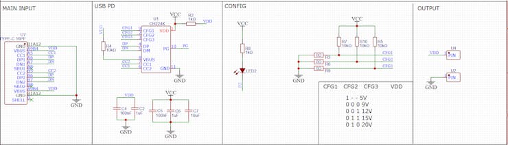

Circuit Diagram:
The CH224K allows voltage selection using configuration pins (CFG1/CFG2/CFG3) or resistors. For a minimal design, Voltage is fixed at PCB level. So no frequent switching is required between the voltage hence I made a circuit according to that. The configuration resistors are put on the bottom layer in the PCB so they are easily accessible and we can change the voltage. According to the datasheet, CH224K supports requesting up to 20 V using simple pin configurations, without requiring I²C or dynamic control.
  • USB-C CC pins connected directly to CH224K
  • Configuration pins strapped for desired voltage
  • Local decoupling and output decoupling capacitors are mandatory
There are no high-frequency components, making the design electrically quiet and easy to debug.

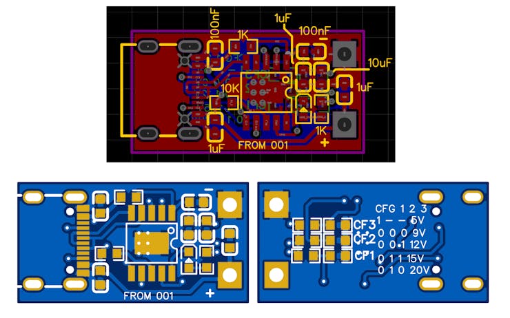

PCB Design:

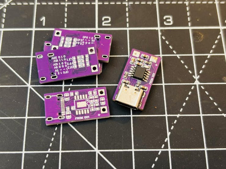

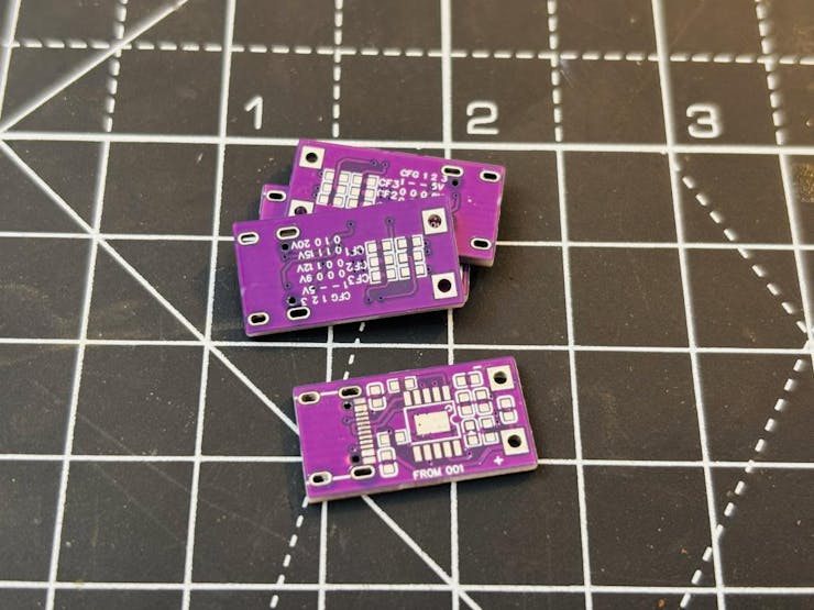

It is not easy to design the PCB for 100W of power in such a low form factor and I am not focusing on that right now. Because I made this board to power small projects and referencing the voltage hence no certain standard is followed but the traces are maximized to carry the highest power. Since the chip negotiates voltages up to 20 V. I have routed the main traces first and then less priority ones. The final PCB is extremely small, making it suitable for embedded use inside enclosures where traditional adapters simply don’t fit.

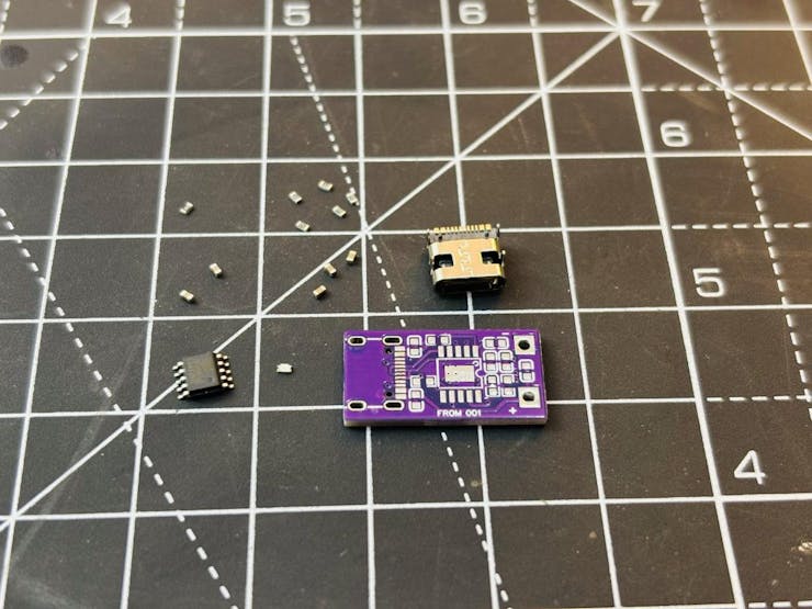

At the time of assembly, as I have followed the hand soldering method, it is not easy to put the components like USB type C hence soldered first. It is better to solder smaller pitch components on the first go. Download the Gerber, BOM and...
