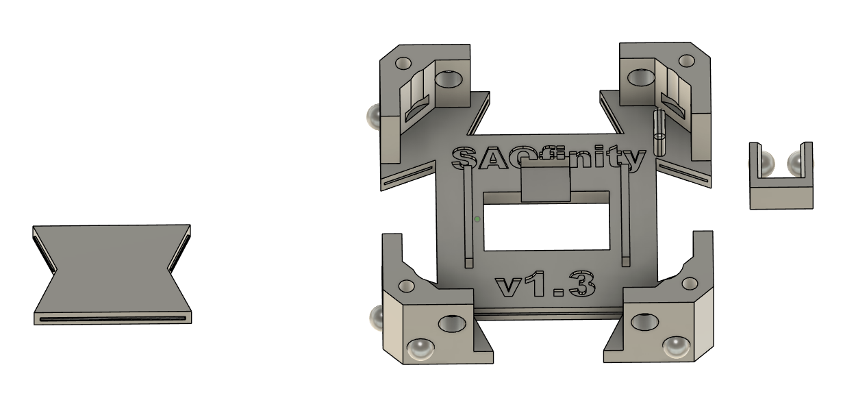

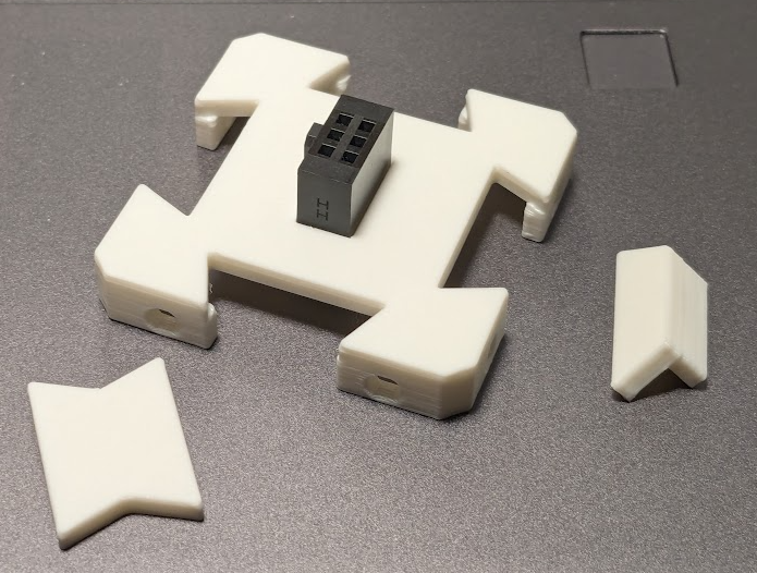

There are 3 primary parts:
1, The basic "grid". (with SAO female connector)
2. The "bow tie" for connecting grids.
3. The "edge plug" for terminating the edges of whatever shape
Assembly:
1. Print the number of grids, bow ties and edge plugs you need and snap them together. There are "stops" to prevent over inserting the bow ties and edge plugs. You could add glue to the joints to make it more permanent and rugged.
2, If you don't plan to use protoboard on the back, use CA glue to secure the connector into the recess.
3. If you DO use a chunk of protoboard, then the glue is unnecessary and soldering the pins to the board will "sandwich" the connector in place. The recess in the grid makes sure it stays centered. The pins will be below the surface of the board but once you fill the holes with solder it will be solid.

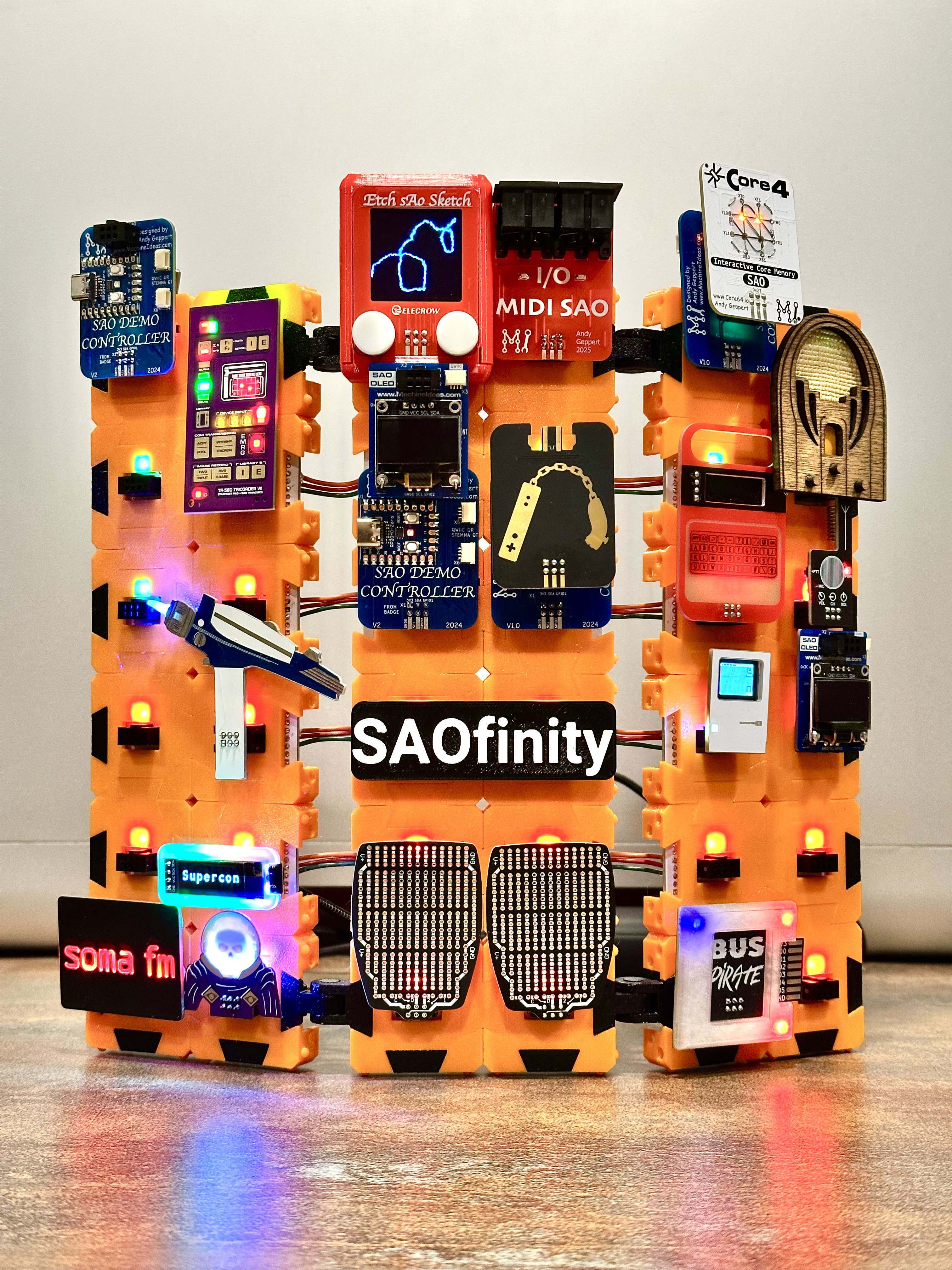

  • Ready For Supercon!
    jeremy.geppert • 10/31/2025 at 01:38 • 0 comments
    Preview of the demo configuration...
    and a smaller version in clear...

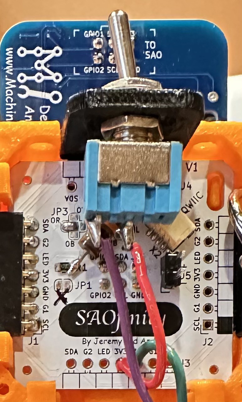

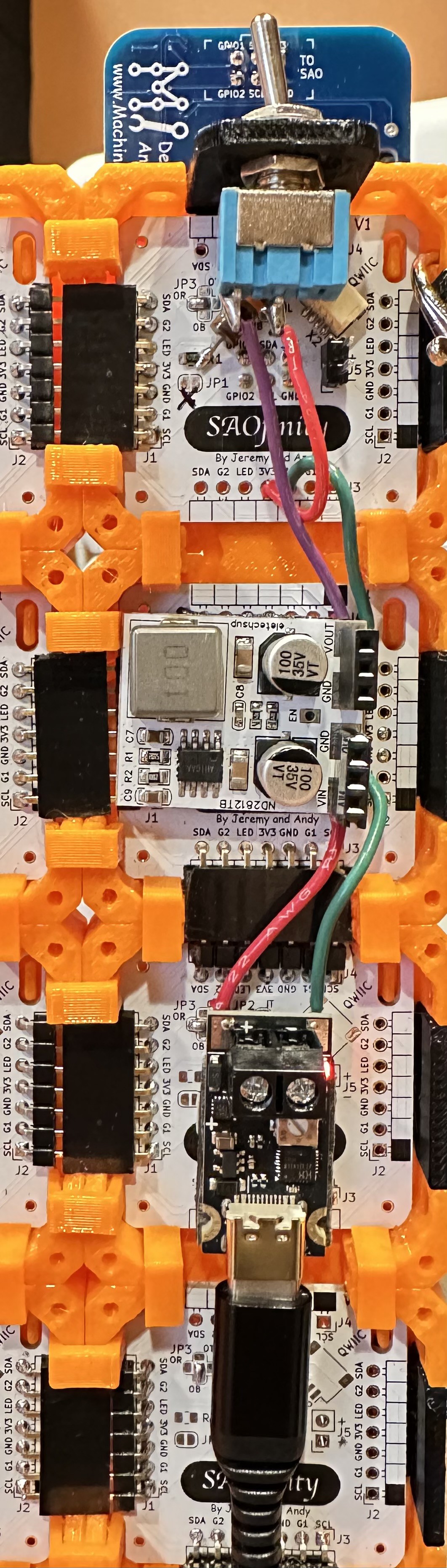

  • ASSEMBLE: Power Supply for SAOfinity V1
    Andy Geppert • 10/30/2025 at 22:34 • 0 comments

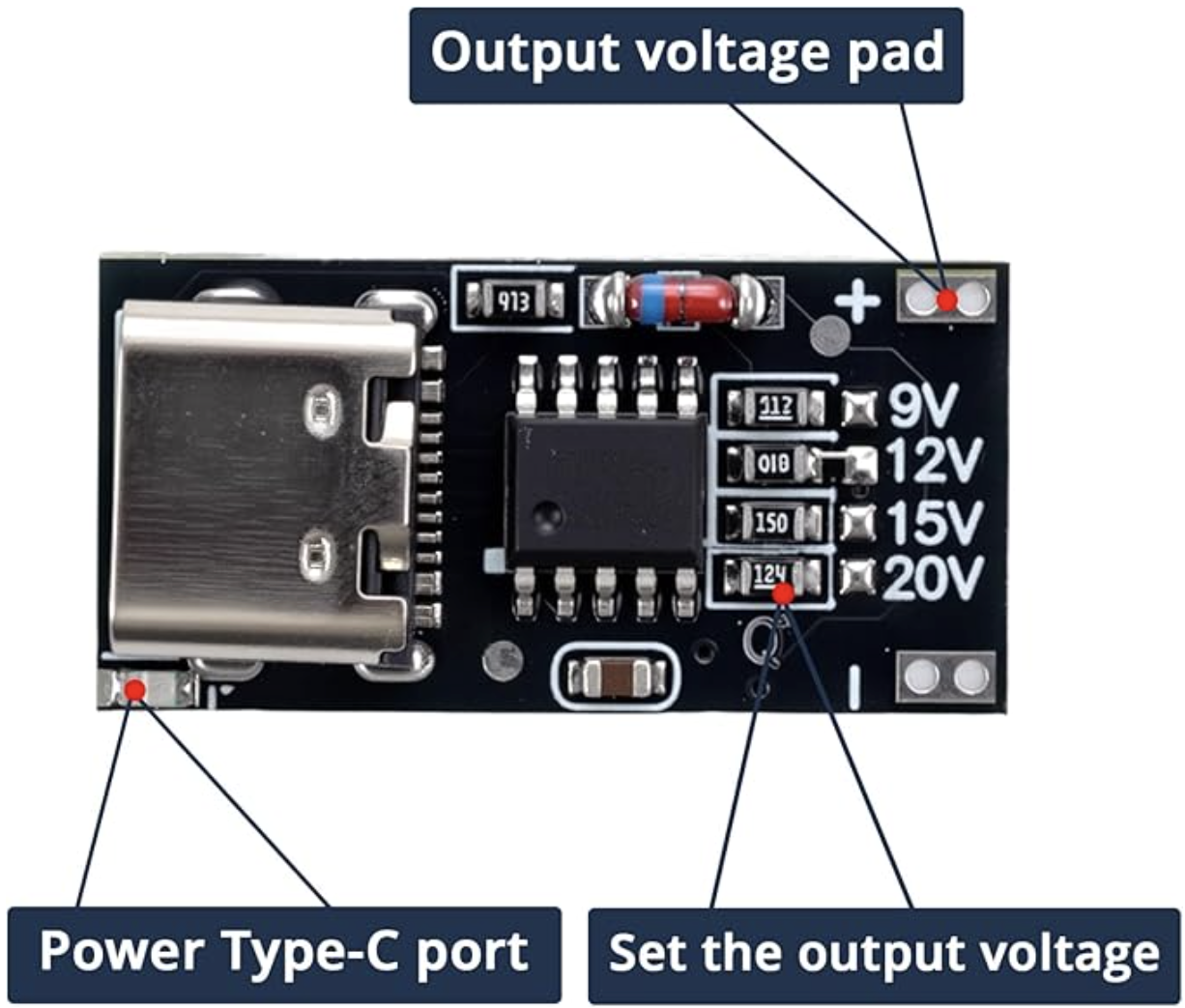

    Here is what I settled on for power into the SAOfinity system, composed of three parts (bring-your-own-USB C-power pack):
    From the bottom, to the top:
    (A) Input starts with a USB C PD board.
    If you get a kit from us at Supercon, it'll be a slightly different that shown above.
    https://www.amazon.com/dp/B0F8VTTXXT
    The ones I purchased have the output preset at 12V, but any of the output ranges should work fine with the voltage regulator below.

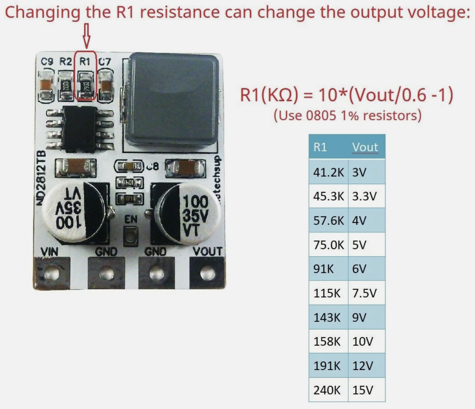

    (B) Then to a voltage regulator board.
    https://www.ebay.com/itm/285420629162
    This claims to deliver 4 Amps from a 4.5 to 28VDC input, and with a resistor, you can order/change the output voltage to be in 3 to 12V. One of the pictures in the listing shows the resistor calculations. I ordered the 3.3V output version, and changed/included R1 to 51K Ohms, to get 3.66V for a little more headroom on the long power bus. It works well. Maybe ordering these preset to 4V is a better solution in the long-run, assuming all your SAOs can handle 4V.
    (C) Finally through a power switch.
    https://www.amazon.com/dp/B0799LBFNY
    I had to add the power switch at the last minute because I discovered that the voltage regulator output ramps up [relatively] slowly and that causes some problems with the SAO Demo Controller and LEDs on the tiles. Without the switch, several of the RGB LEDs on the tiles would trip out and fail to operate correctly. I also attempted to mitigate that issue by putting a 10K Ohm resistor on the signal line on the back of the first SAOfinity PCB tile:
    And the final final step is routing the switched 3V3 into one of the open 3V3 pins on the first tile. And ground to GND of course. On the PCB, all GND and 3V3 pads are connected together.
    The power switch and SAO Demo Controller (not included - but available) are intended to operate from the first SAOfinitiy tile in the series, which is arbitrarily suggested as upper left, when viewed from the front. This has to do with the suggested signal routing for the built-in RGB LEDs.
    The V1 kits include all of these components, wires, double-sided tape, switch, switch mounting bracket, resistors. And a USB C to C cable!
    If all you need is power to the tiles, then you only need to connect the 3V3 and GND from tile to tile. The other connections are all optional. But each board does have a built-in RGB LED, so you'll probably want to connect the LED signal from board to board (in series only!). More on that in the next ASSEMBLE: LED Signal Chain blog entry.

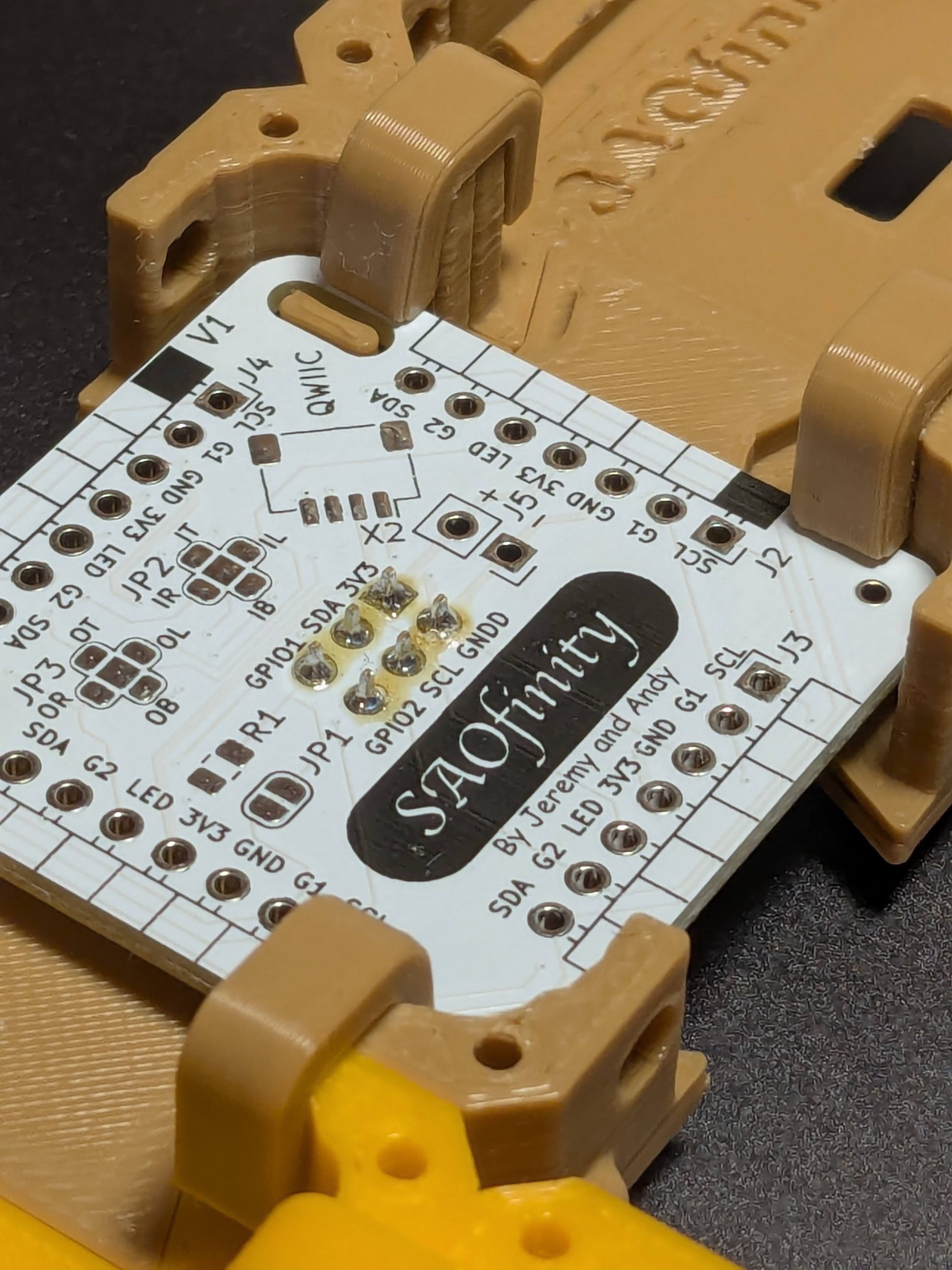

    With the PCBs in hand revisions have been made after much collaboration and iterations.
    -Standoffs to make sure any pins don't touch the plastic for static concerns.
    -"Click-in" corner reliefs to hold the board precisely in place.
    -Opened up the SAO connector hole so full contact can be made. (due to the standoffs)
    -2 layers of plastic in front of the LED so it can shine through.
    -Protrusions in the "bow-ties" and slots in the body for  a "click-in" fit.
    -Clips to hold the bodies together for wearable or larger portable displays.
    I think we have a "final" version ready for mass production.

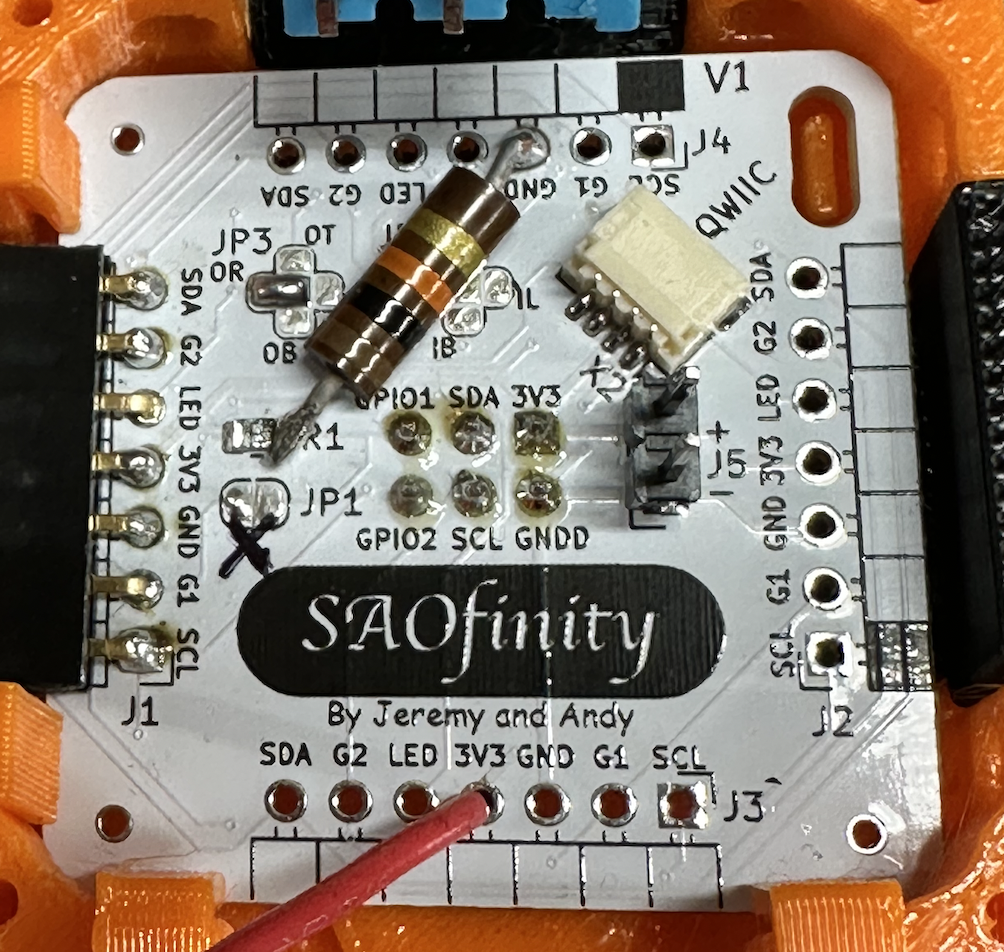

    Andy Geppert • 09/26/2025 at 13:34 • 0 comments
    In collaboration with Jeremy, I just finished the PCB design and ordered some samples for Supercon!
    This effort to add some bling and make the system more "snap together" unintentionally turns SAOfinity into a badge! By designating one tile as the primary control tile, and plugging in an MCU to that board, you''ll be able to control the built-in chain of LEDs, and communicate with the I2C and GPIO on other tiles. I will use the SAO Demo Controller I designed as an example in the next log entry.
    FEATURES
    • RGB LED: Built-in, daisy-chainable to be controlled from a primary SAOfinity tile board. Allows control of RGB LED as a backlight to the SAO on display on a given tile. Solder jumpers make it flexible!
    • CONNECTORS: PCB is ready for right angle 0.1 inch pitch 7-pin edge connectors to eliminate wires. All 7 pins are not required to use the board - just 2 pins for power are sufficient. A third pin enables access to the RGB LED. The other four pins enable I2C and GPIO1&2 connections between tiles
    • QWIIC: A spot for you to add a QWIIC connector because that should be a great part of the SAO ecosystem too!
    • POWER: Designed to operate at 3.3V for now. Dedicated pads (or a connector if choose) to power your SAOfinity creativity. See below for more details. Bring-your-own-power-source.
    V1 IMPORTANT NOTES ABOUT POWER OPTIONS:
    This first version (V1) has two pins for 3.3V power (J5) to be supplied by any 3.3V source. The 3.3V supply is the common voltage rail shared between all SAOfinity tiles when the interconnecting right-angle headers are used. Because most readily available 3.3V sources are lower current, it may be necessary to sub-divide your SAOfinity tile grid into multiple power zones and supply 3.3V power into each zone from a separate 3.3V source. This requires NOT interconnecting the 3.3V power line between those zones through the right-angle headers between select tiles.
    NEWEST PLAN 3.3V at 4A from USB C... maybe?

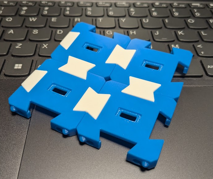

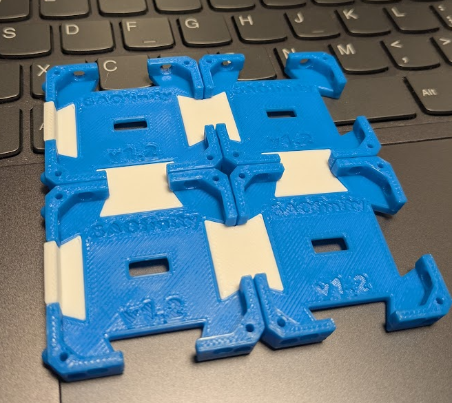

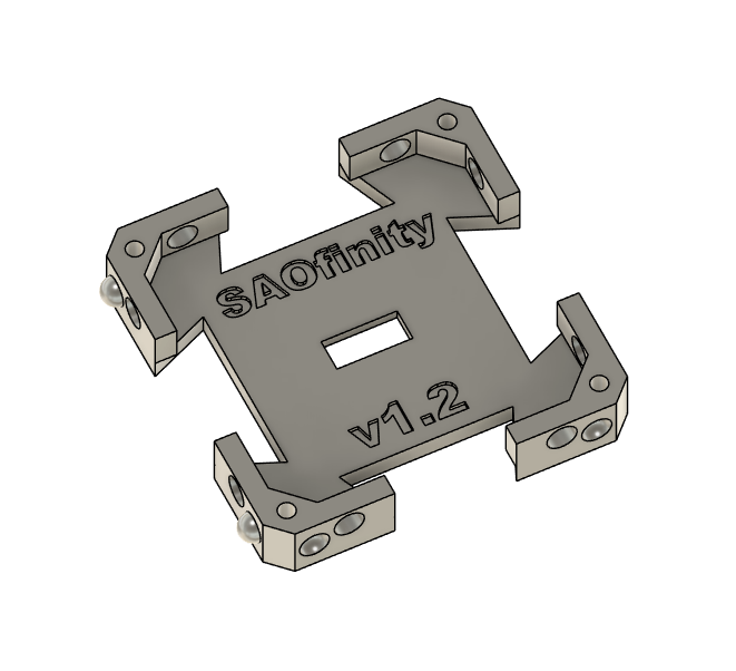

  • V1.2 Balls and Bosses
    jeremy.geppert • 09/22/2025 at 03:06 • 0 comments
    After some brainstorming with my brother on improvements based on some field testing here is the current iteration:
    Note the addition of alignment "balls". Convex and Concave spheres to keep things in the same plane.
    Also, M2.0x5.00 bosses for attaching a backplate or other things with screws.

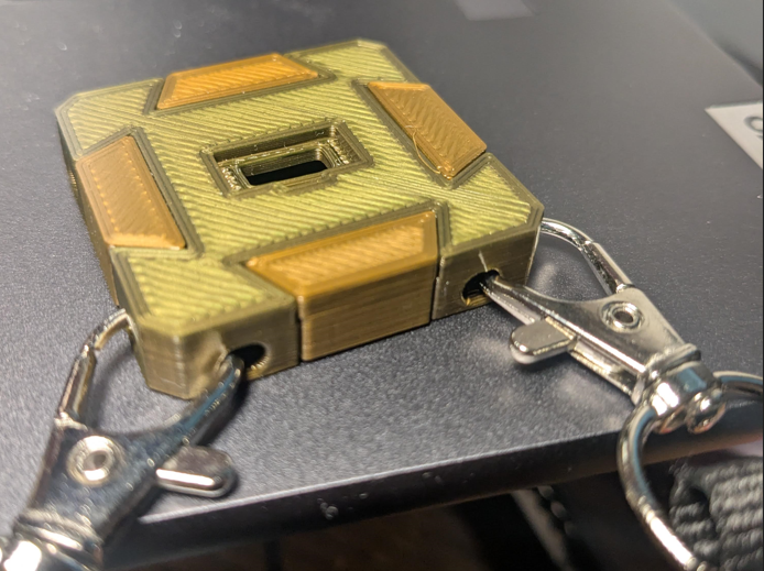

  • Unintentionally Wearable
    jeremy.geppert • 08/10/2025 at 11:57 • 0 comments
    There are holes on the edges for routing wires which happen to work with lanyards.
