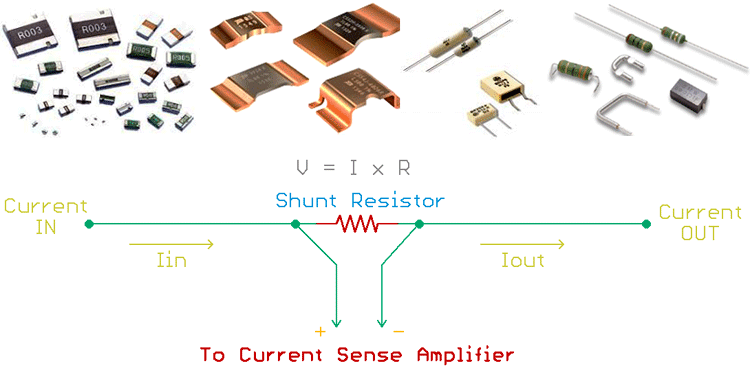

Using Current Sense Resistors:
Current itself is not measured directly. Instead, we convert it into a voltage using a current-sense resistor (shunt).
V_sense = I * R_sense
So if we are using a shunt resistor of 10 mΩ, then:
- At 1 A, sense voltage = 10 mV
- At 100 mA, sense voltage = 1 mV
These voltages are too small to measure directly with a multimeter or MCU ADC. That’s where the CSA220 comes in.

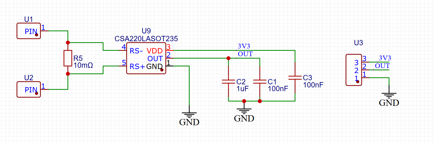

Using Current Sense Amplifiers - CSA220
The CSA220 is a dedicated high-side current-sense amplifier, designed specifically for this task. And because of special internal architecture they have:
- Input common-mode range: 0 V to 76 V
- Low input offset voltage: typically 5 µV
- High CMRR: up to 157 dB
- Fixed, precision gain (10 V/V in my case)
These specs allow accurate measurement of millivolt-level signals even when the shunt is sitting at high voltage. We will discuss the basics of high side and low side current sensing in the end, but here is my minimal design of CSA 220.

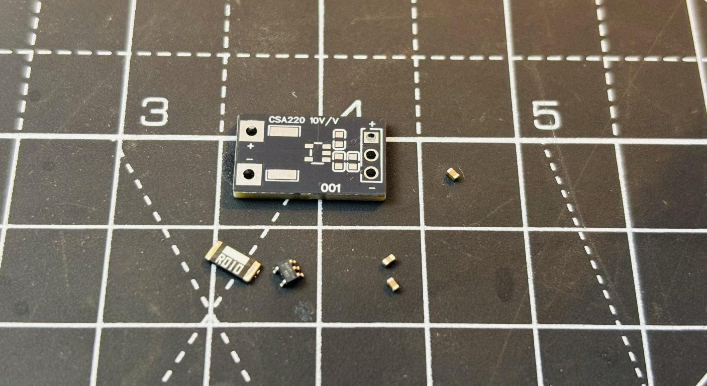

Components Required:
- CSA220
- 10 mΩ precision shunt resistor
- 100nF ceramic capacitor
- Pin headers
- 3V Power source
- Multimeter (basic)
Circuit Diagram and Schematics:
The circuit is very simple and uses minimal external components. I am using a 10 mΩ precision shunt resistor. The resistor chosen should be precise enough to 1% tolerance. CSA220-10, 10 V/V gain version is used in the schematics, to keep my multimeter calculations straight forward. Current is just a decimal forward form the output voltage. The output headers are placed on the other side, so we can plug it into any board and do the measurements. I have placed some decaps, I do want to follow the...
