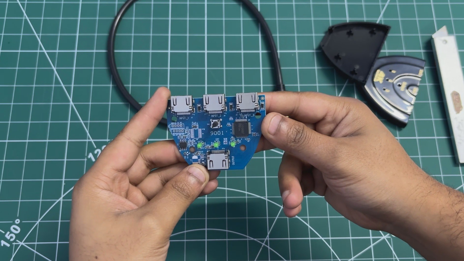

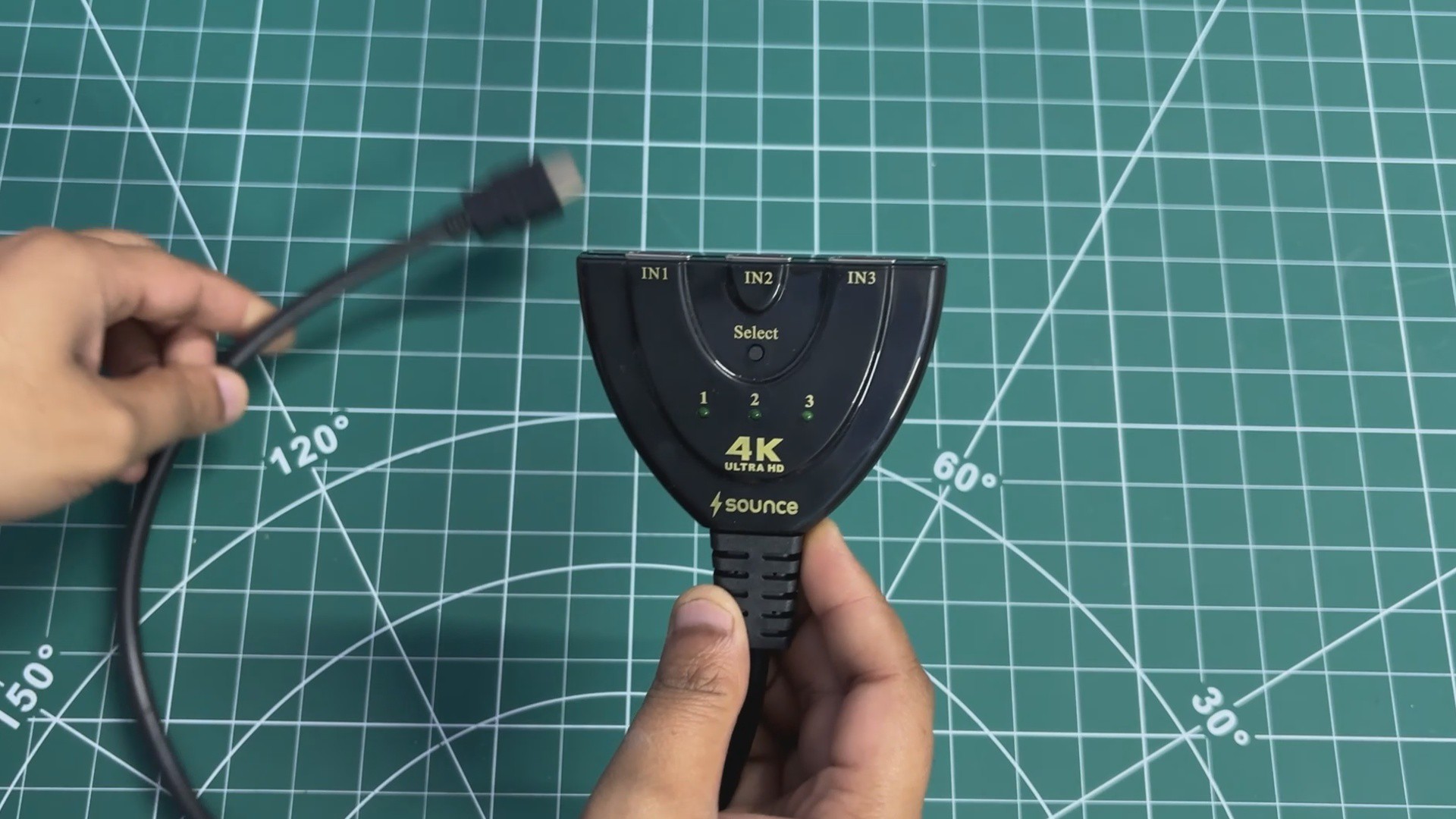

HDMI SPLITTER
Our goal was to use a single LED display panel as the main display while running two SMPS units. Since only one SBC can drive the display at a time, an HDMI splitter became the obvious solution. We used a three-input, one-output HDMI splitter from Sounce. Opening it up was straightforward—the enclosure doesn’t use screws and is instead held together with snap locks. Using a prying tool, we were able to open the casing and access the circuit inside.
The board features proper HDMI connectors: one output port and three input ports. Each HDMI input has an associated LED indicator that lights up to show which input is currently selected. The main control element on the board is a push button, which allows us to switch the active input connected to the output.
DUAL SBC SAME DISPLAY SETUP
To test the HDMI splitter, we set up a minimal configuration using two SBCs. The HDMI output of the LattePanda was connected to the first HDMI input of the splitter, while the Raspberry Pi Compute Module was connected to the second HDMI input.
A monitor was connected to the HDMI output of the splitter. By default, the display shows the output from the first HDMI input. When the push button is pressed, the display output switches from the first SBC to the second.

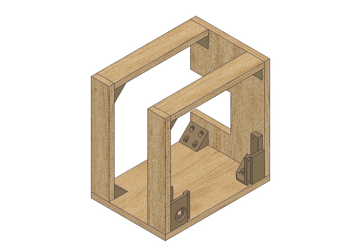

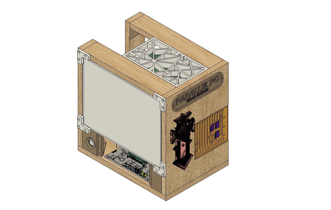

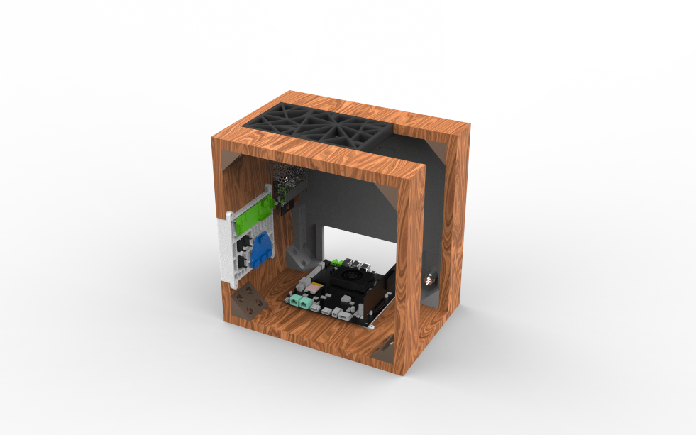

UPDATED 3D DESIGN
The 3D model for this project was created by reusing and modifying the model from our previous WoodWorks Fusion PC build. Reusing parts from the older project was one of the main goals, as we wanted to evolve the original design rather than start from scratch.
In the updated model, the old display was removed and replaced with a new LED panel. The new screen is slightly smaller and significantly thinner than the previous LCD monitor, which required changes to the overall size of the wooden frame and panels. Along with this, the display holder and the front screen mount were also redesigned.
The original motherboard, power supply, and internal hardware were completely removed, leaving the model empty before adding the new components. We then integrated the 3D model of the LattePanda MU expansion board into the frame. The SMPS power supply was also modeled and positioned on the side wooden panel, slightly above the grill area.
The grill section itself was redesigned and now serves as a mounting point for both the HDMI splitter and the display driver board. On the top side, a mesh-style component was modeled, which also functions as the holder for the Raspberry Pi Compute Module.
Finally, a panel-mounted push button was added to the front of the model, which will be used to control the HDMI splitter output.

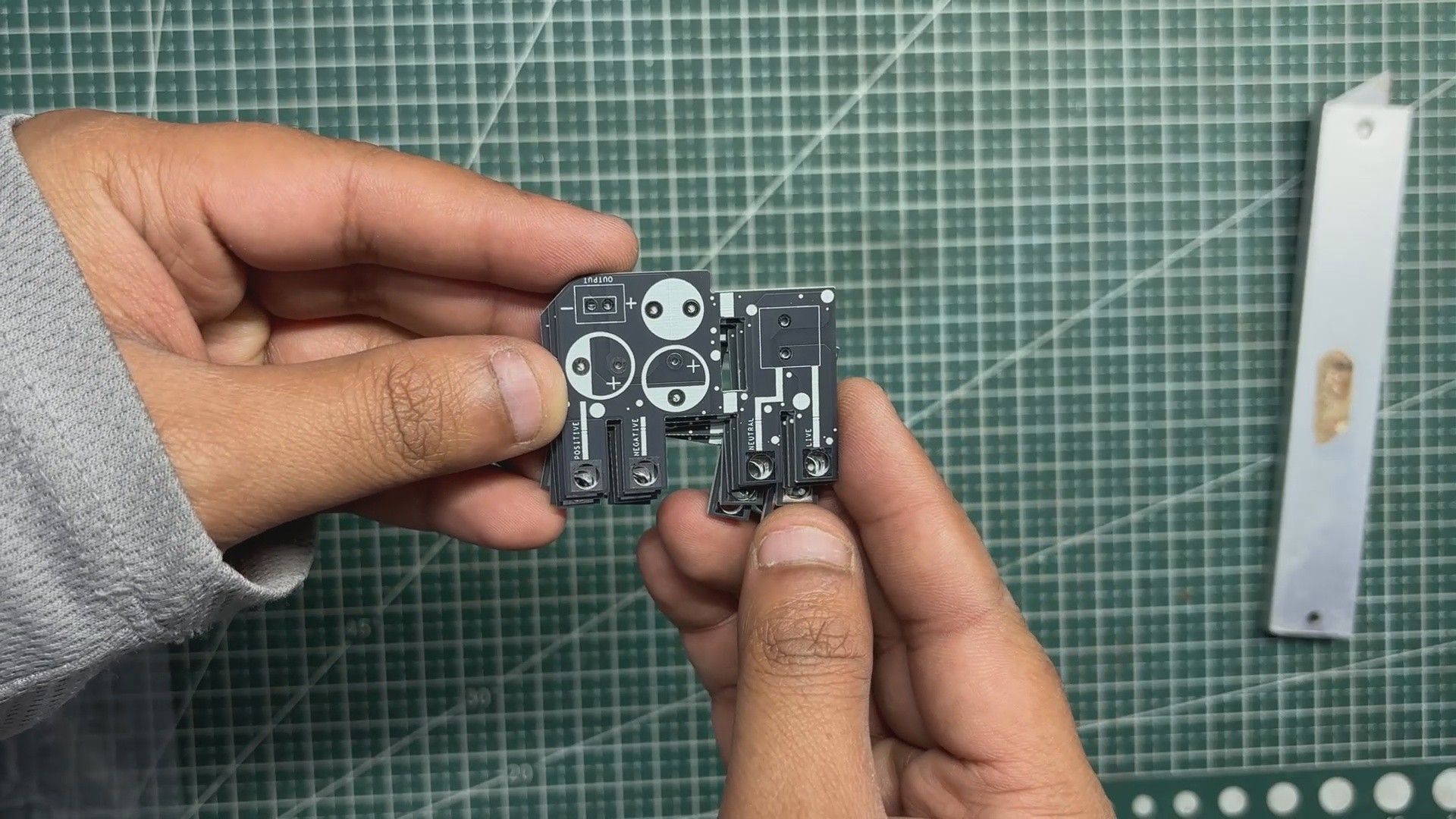

PCB DESIGN- LC FILTER
In our project, we wanted to use a 12 V, 5 A SMPS, which may or may not have voltage ripple at its output. These SMPS units are generally fine for driving MCUs, relay boards, motors, and other crude electronics, but something more sensitive—like an SBC or a display—can get affected by the ripple and noise generated by these supplies.
One option would be to use a well-branded SMPS, such as ones made by Mean Well or Honeywell, but those supplies are expensive. Also, in the local market, it is common to find power supplies that claim to be from these brands but may actually be knockoffs. Because of this, our approach was to improve the output quality of the SMPS by adding an LC filter circuit on the output side.
The LC filter is implemented by connecting a 10 µH inductor in series with the positive output line. On both sides of the inductor, decoupling capacitors are connected between the supply rail and ground, forming a C–L–C (π-filter) configuration. The capacitor placed before the inductor helps absorb high-frequency switching noise coming directly from the SMPS, while the capacitor placed after the inductor smooths the remaining ripple and provides a more stable voltage to the load.
At the input side of the filter, we used a 47 µF, 100 V capacitor, and at the output side, we used a 100 µF, 63 V capacitor. This simple LC filter significantly improves the DC output quality of the SMPS, making it suitable for powering sensitive loads like SBCs and displays.
After preparing the schematic, we started the PCB design process. The board outline was taken directly from the CAD model prepared earlier and used as the main PCB outline. The AC terminal was placed close to the AC input side, and the C–L–C filter configuration was placed near the DC output side to keep the power path short and clean.
The mounting holes on the PCB are plated, so when the PCB is mounted onto the SMPS using bolts, the PCB makes a secure electrical and mechanical connection with the SMPS terminals. This ensures a reliable connection between the SMPS and the filter PCB.
