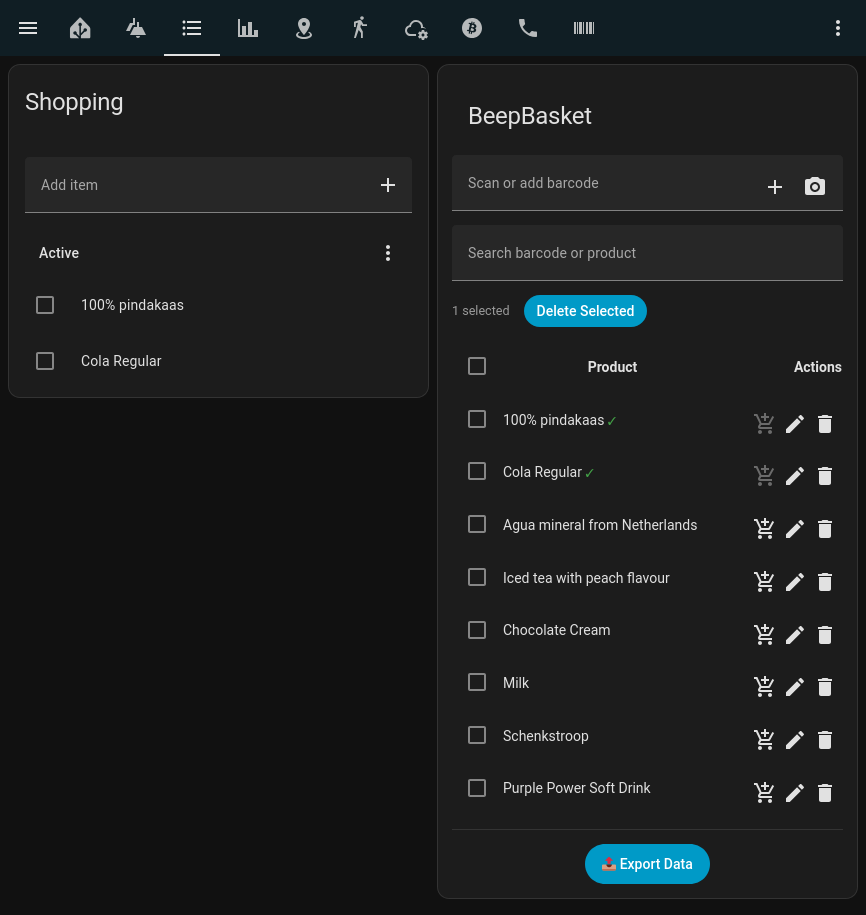

  • You can scan directly from Home Assistant in the web or via the Home Assistant Companion app and use your device camera to add an item to your BeepBasket list. ( You do need HTTPS for your camera to work )
  • From the list you can add it by the click of a button to your Shopping list in Home Assistant.
  • Product lookups are done using the Open Food Facts API.
  • If the Item is unknown, It will display the barcode in your shopping list.
  • When you update a barcode inside your BeepBasket card, it will remember the change for the next time you scan that barcode again.

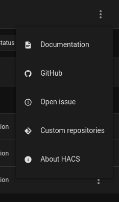

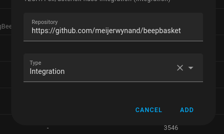

Go to your HACS installation and select custom repositories
Add the custom repository to https://github.com/meijerwynand/beepbasket and set the type to Integration
You will see it listed in the window
In HACS then download the repo

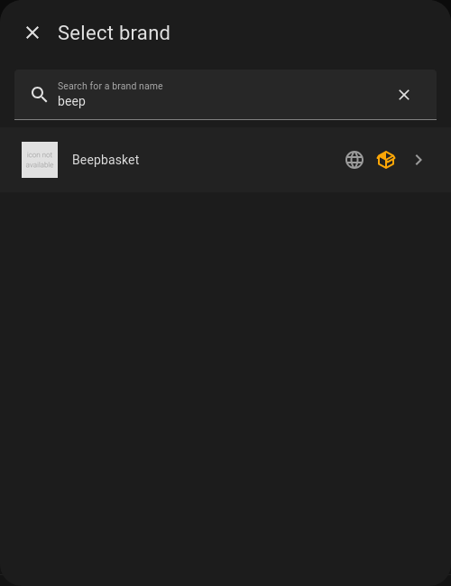

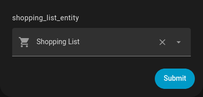

Go to you Settings -> Devices and integration -> Add integration and search for BeepBasket
I will then ask you to associate your shopping list
And you are done

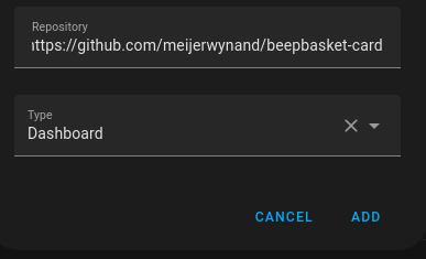

Follow the same step again in hacks, this time select the https://github.com/meijerwynand/beepbasket-card with type of Dashboard.
Follow the same download steps as before/

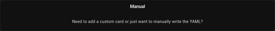

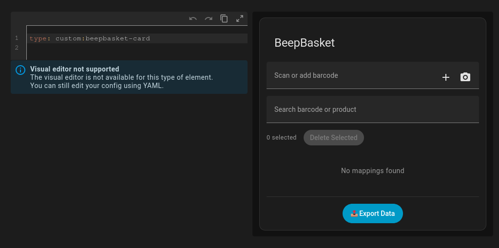

Now you can add the BeepBasket as a manual card
Use the
type: "custom:beepbasket-card"

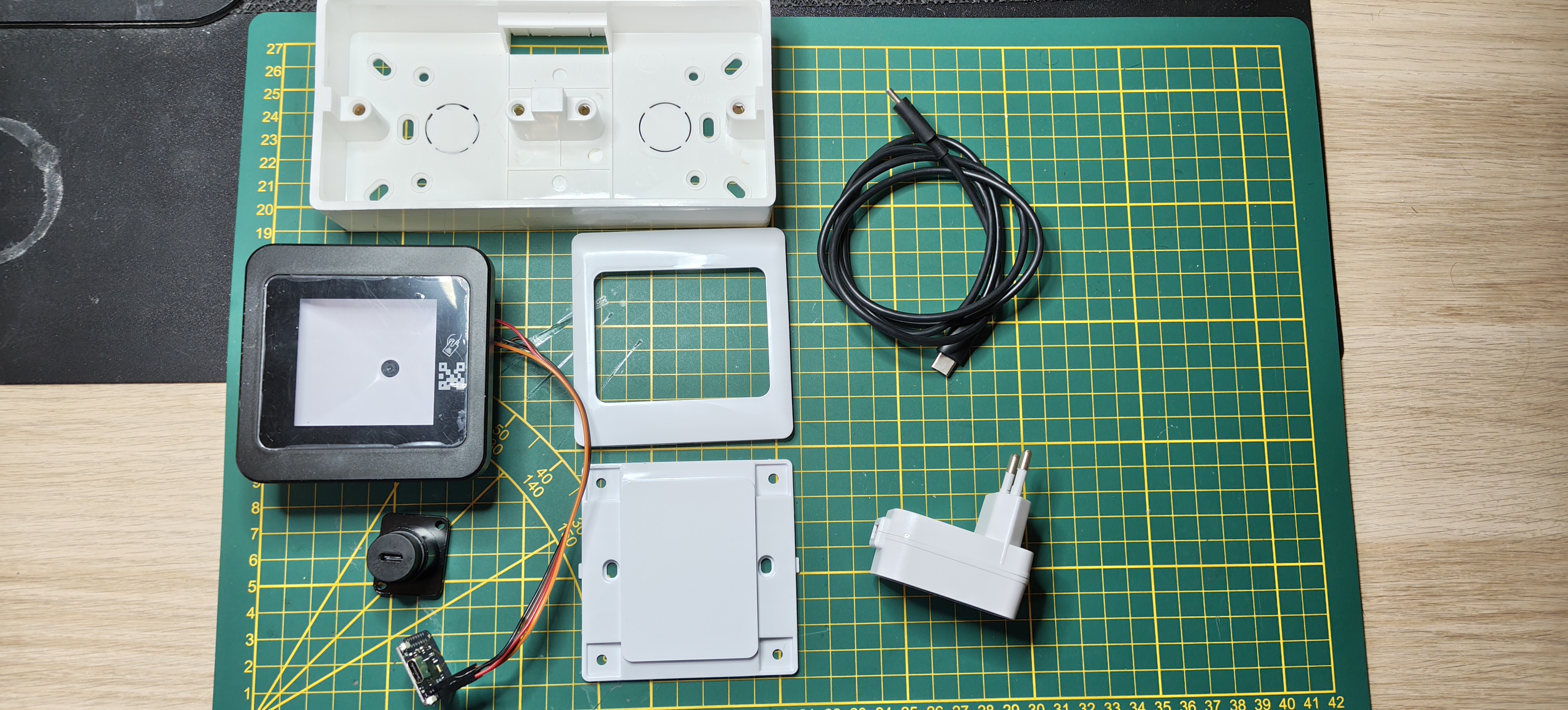

  • 1 × R35C-B barcode scanner Scanning of barcodes
View all 6 components
  • 1
    Getting the parts

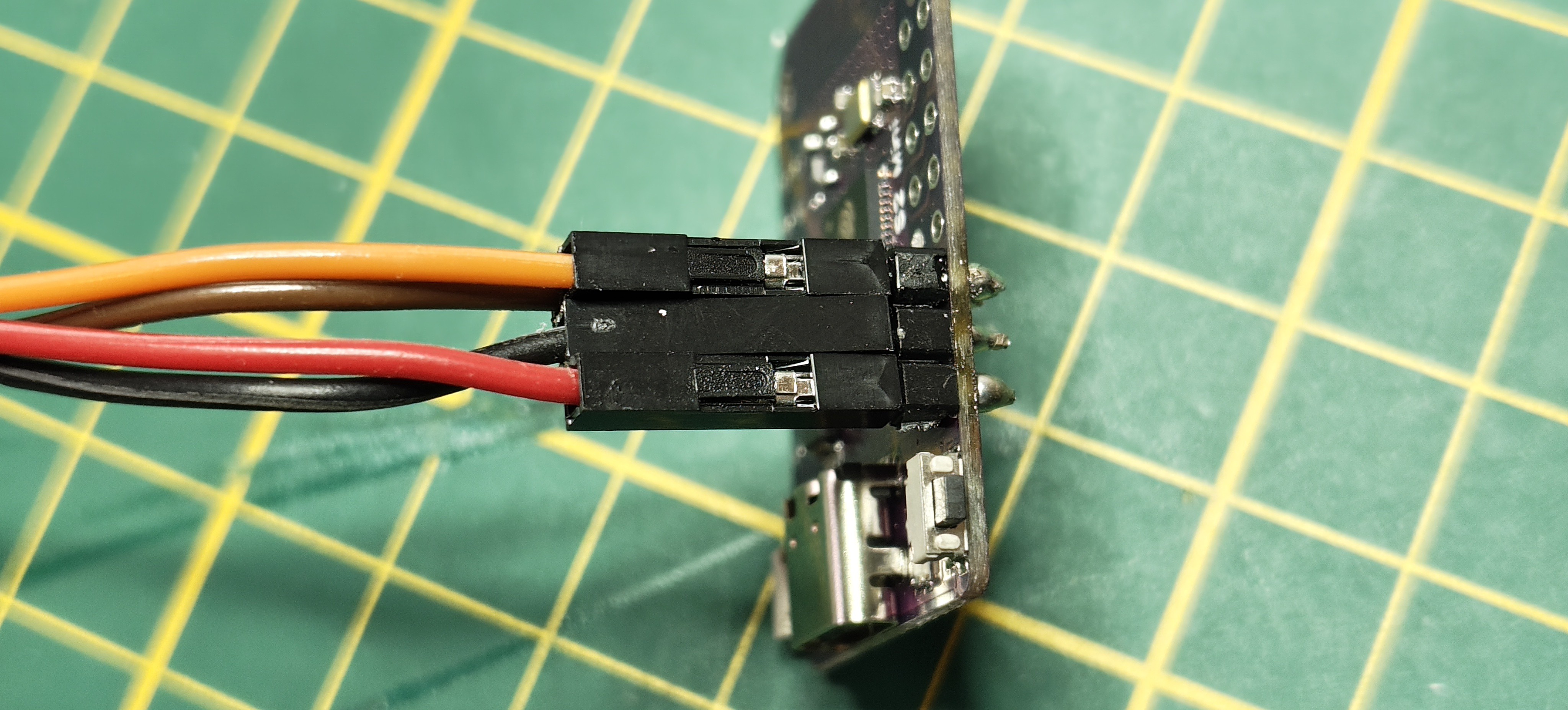

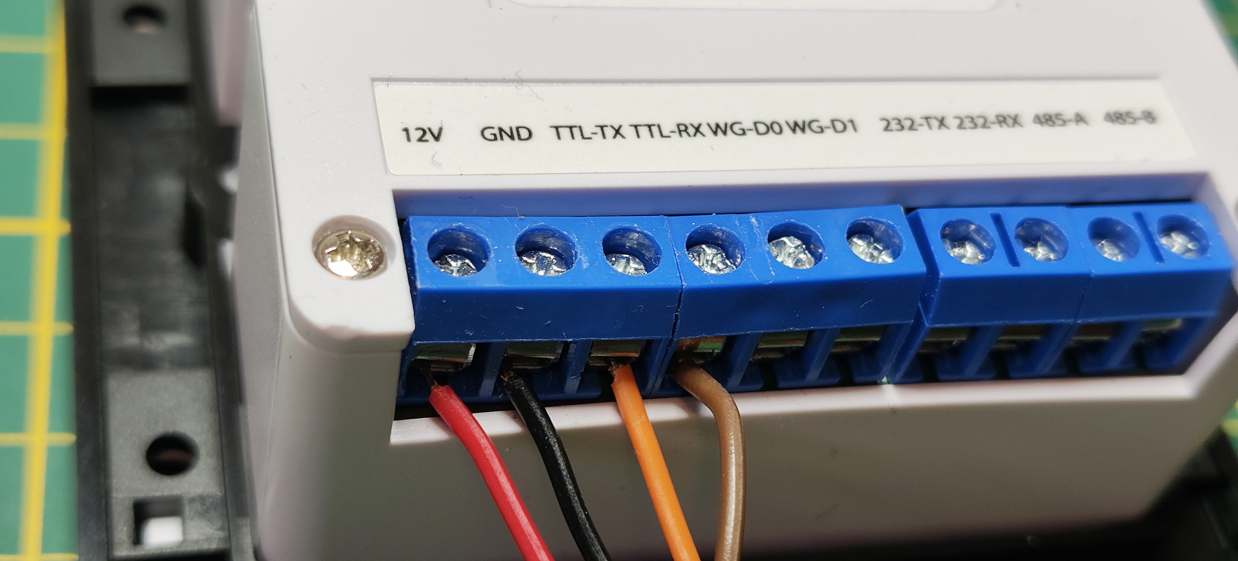

    Wiring the scanner
    VCC -> 12v (since this scanner is USB power, you can supply it VCC from the ESP32)
    GND -> GND
    TTL-TX -> GPIO16
    TTL-RX -> GPIO17
