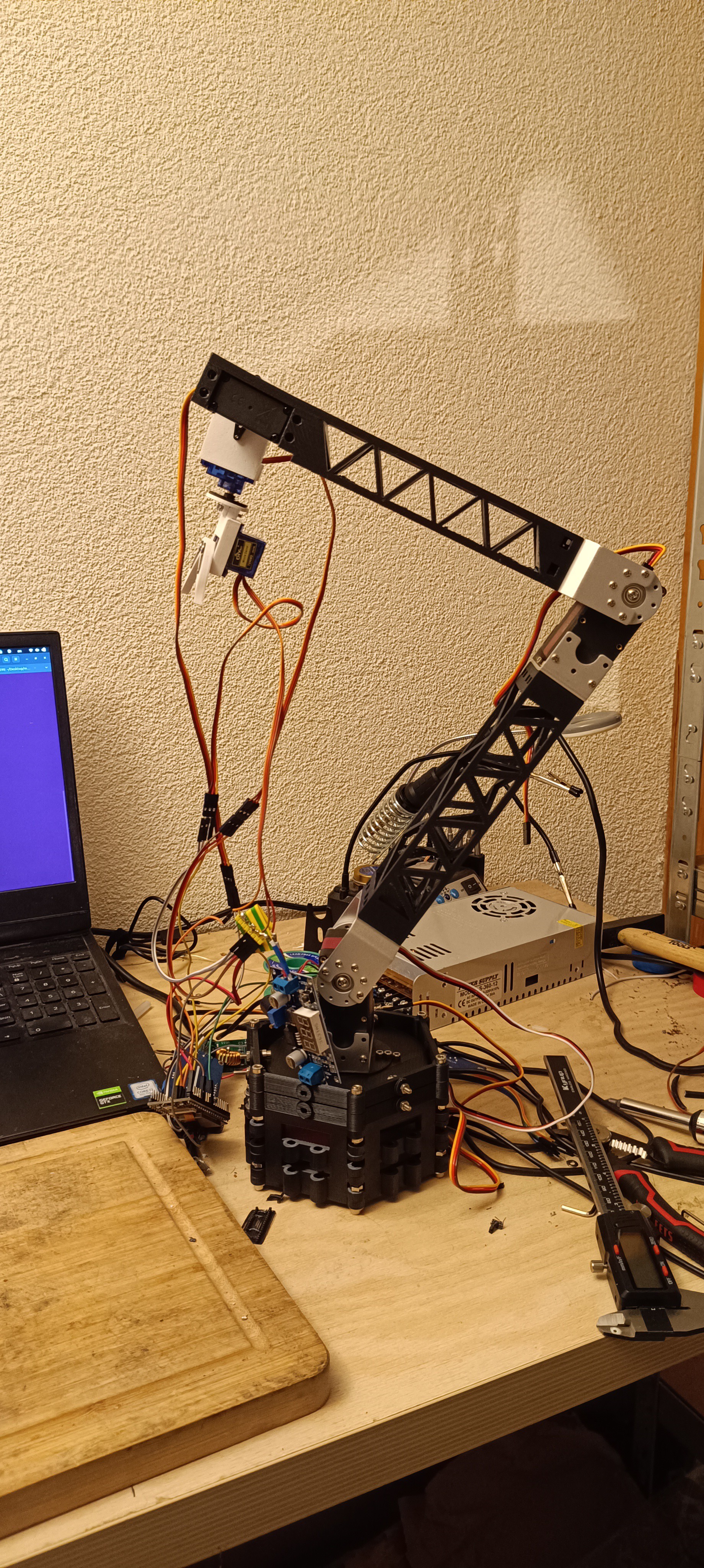

Here is the latest version I have

    Since the last couple of logs quite a lot changed on the “brains” side of RoboArm, so here’s a quick recap up to today (27.01.2026).
    A bit over two weeks ago I printed and assembled a much more solid base for the arm. I definitely overused plastic, but at least now it doesn’t feel like it will fold in half when the shoulder moves. Around the same time I set up a PyBullet simulation of the arm, so I could test motion control without abusing the real servos on every experiment. Not all joints behaved exactly as expected in simulation at first, but it was good enough to start playing with kinematics.
    About a week ago I implemented the first operational inverse kinematics controller. The control flow looks like this:
    • a small web server runs on my laptop
    • my phone connects to a page with a couple of joysticks
    • the laptop sends joystick data via UDP to the ESP32 on the arm
    • the joysticks control the desired position of the gripper in space, and the IK tries to move the arm there
    In simulation this worked more or less fine. There were some constant offsets, but the motion itself looked sane. On the real arm, though, it was a different story:
    • when I moved the gripper further away from the base, it would drop down
    • when I brought it closer, it would go way too high
    At first that looked like a classic “servos are weak / gravity wins” situation, but the behavior was wrong even without heavy load, so something else was off.
    Today I finally found one major culprit: the bottom joint servo actually has 270° of travel, and I was treating it as a “normal” 180° servo in my angle mapping. That meant the controller and the hardware completely disagreed on what any given angle meant, which showed up as those weird position offsets when moving the hand forwards/backwards.
    After fixing the mapping for that servo, the situation improved a lot. The big crazy offset when reaching forward is gone, and the arm now follows the commanded positions in a way that at least looks physically reasonable. It’s still not perfect – there is some distance between desired coordinates and where the gripper actually ends up – but now it’s in a range where tuning, better offsets and maybe some calibration should be enough.
    I also changed the elbow joint limits so it can bend up to about 135° in one direction and only 45° in the other. This technically reduces the total reachable volume, but it makes the useful working area on one side of the arm much bigger, which fits the setups I have in mind for real tasks later.
    The video below shows the current state as of today: RoboArm moving under IK control, driven from the joystick interface, with the base angle finally behaving as expected instead of fighting the math.

    Since the last log quite a lot happened: I burned a power supply, ordered more parts, and mostly finished the arm mechanics.
    For the upper and lower arm segments I borrowed the look from crane booms. The lattice structure with triangular cutouts turned out to be surprisingly light and stiff, and was very easy to model in FreeCAD – just a few sketches and patterned triangles. The photo shows the first full “skeleton” of the arm assembled and moving.
    Cabling is still a disaster. I’m still using random jumper wires and too many soldered joints, which leads to frequent short circuits. That’s how I killed the previous power supply. The new one seems to survive better (probably has slightly less terrible protection), but these cheap units have plenty of Amazon reviews with pictures of actual flames, so I don’t fully trust it. I’ve ordered proper cables and connectors; they should arrive at the end of this week or the beginning of next.
    For the rotating base I decided to use a 60 kg servo, same model as in the elbow. It’s weaker than the 150 kg servo in the shoulder, but it’s also much cheaper. To reduce the load on the base servo I designed a circular platform the arm mounts to, and that ring is held between bearings attached to the base body. The servo just has to drive rotation; the bearings carry most of the weight. It’s working, but the whole base is still too unstable, so next step is a bottom part that clamps to the table with some printable clamp design I’ll probably steal from the internet.
    Overall, the results so far are better than I expected. I was mentally prepared for a lot more setbacks at this stage. There is still a long way to go, but seeing the full-length arm move on the bench is very motivating.
