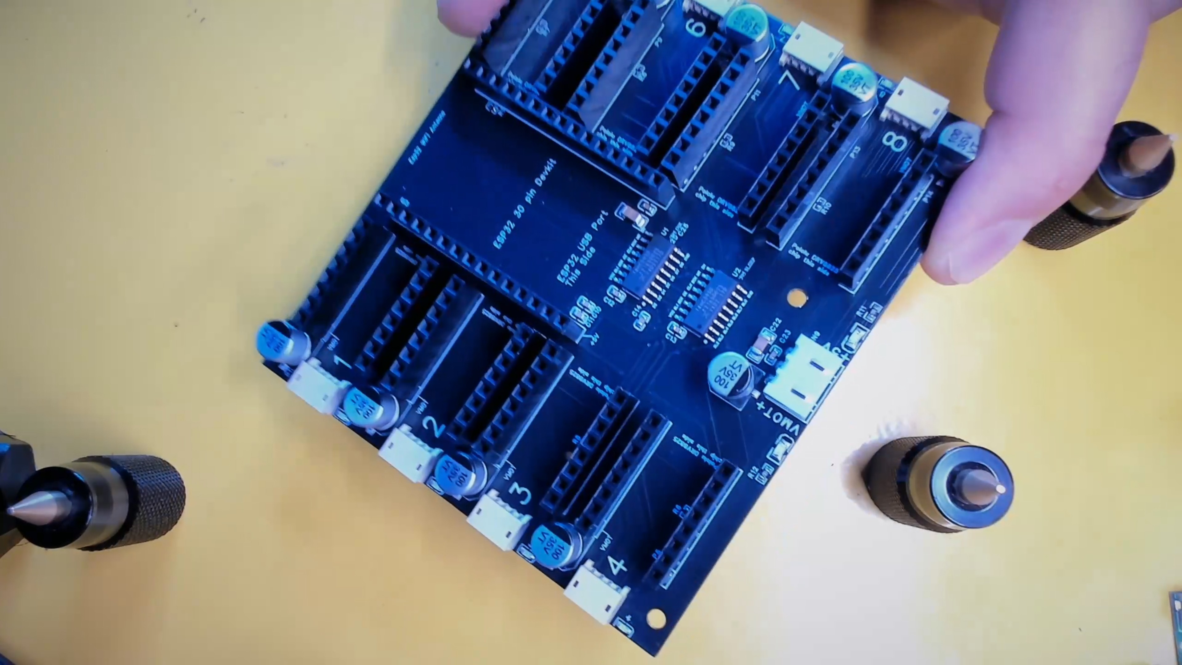

- Mirrors: Small 50mm x 50mm square glass mirrors tiles on custom 2-axis actuator assemblies , 3D-printed joints and ball-socket mechanisms
- Actuators: Cheap, 5mm diameter bipolar steppers, 8-10mm travel, 2300 steps, 3000–4000 steps/s
The non-standard motor connector required a custom connector PCB :
- Structure: 3D printed grid to hold the tiles , attached to 2020 aluminum extrusion frame
- Electronics: Custom PCBs per mirror island (2x2 tiles, 8 motors), DRV8825 stepper drivers, shift-register multiplexing for direction and wake/sleep control.
- Controller: ESP32 (motor step generation, Wi-Fi, MQTT) with FreeRTOS
