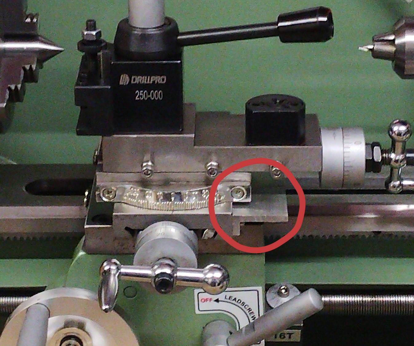

I love my Warco Super Mini Lathe but kept finding annoyances to do with the position of the X-axis DRO sensor and magnetic strip:
- the supplied bracket sticks out quite far, limiting how close the tailstock can get
- the supplied bracket obscures the gib strip adjusting screws
- the supplied bracket obscures the oiling ports
- and the supplied bracket covers the very place I might one day want to add a carriage lock.
So this project was all about moving the sensor and strip to the chuck side.
Some photos of the stock machine, showing the bracket mounted on the right:
View from above - bracket circled in redView from front - bracket circled in red

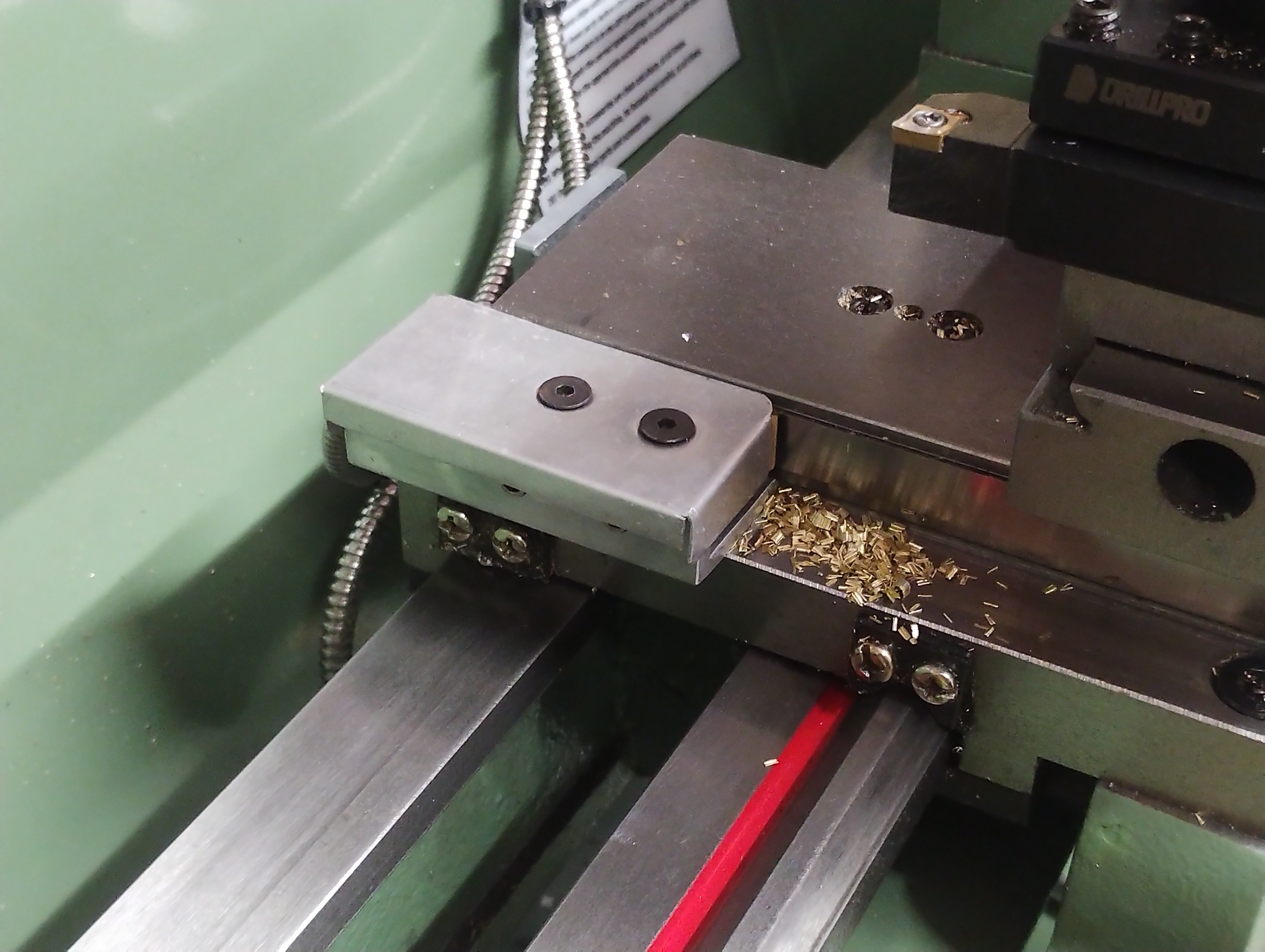

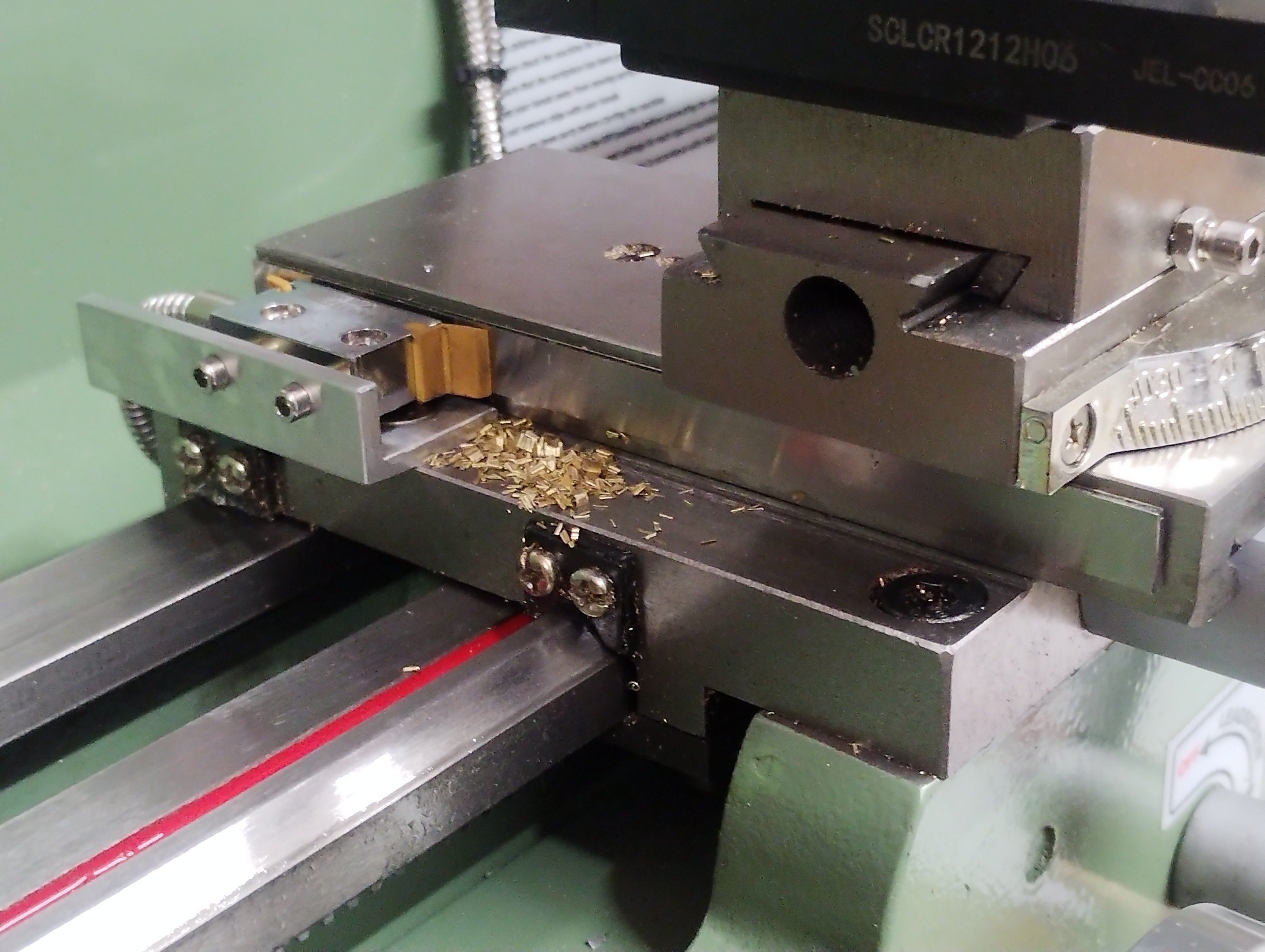

The next photos show the new sensor assembly:
The installed sensor assemblyThe sensor assembly with the cover off
A simple cover keeps the majority of the swarf out. It is made from thin aluminium sheet, cut and folded and secured with M4 CSK screws into the existing tapped holes in the sensor.
