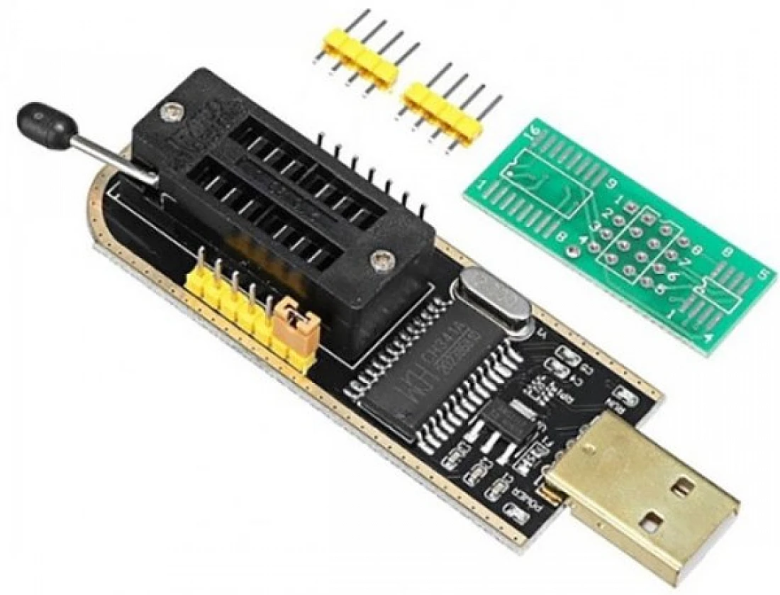

Most of the people aware of CH341 based memory programmer which is exclusively used for BIOS update and copying the BIOS etc.,

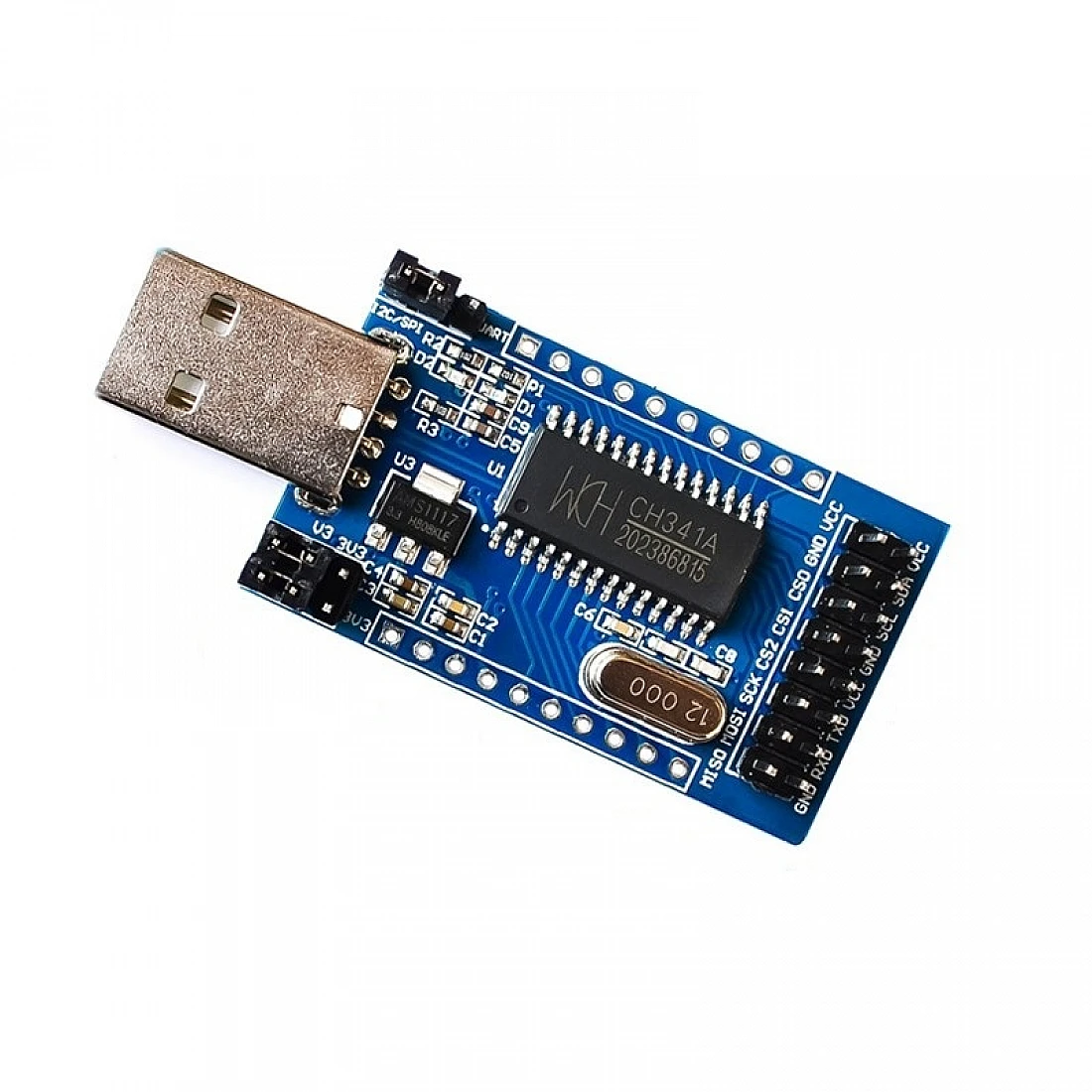

Recently there are many variants available in the market for different applications and available in different form factors.
The above module is available with almost all the pins available to the user. The user can connect as per the requirements.

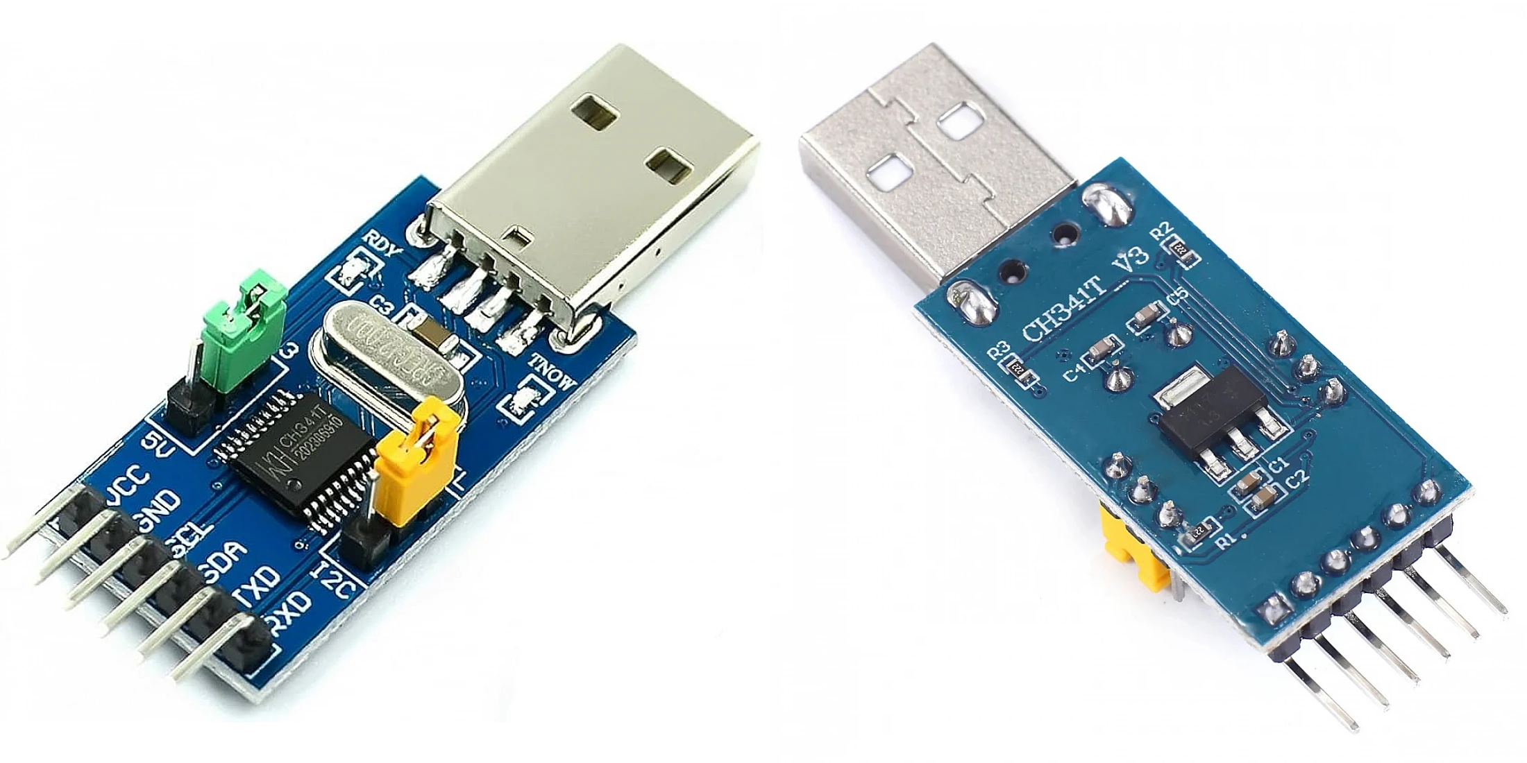

Another variant is dedicated to only UART and I2C. This module can be used as general purpose USB-TTL module. This module comes with voltage selection jumper for 3V3 or 5V0.
