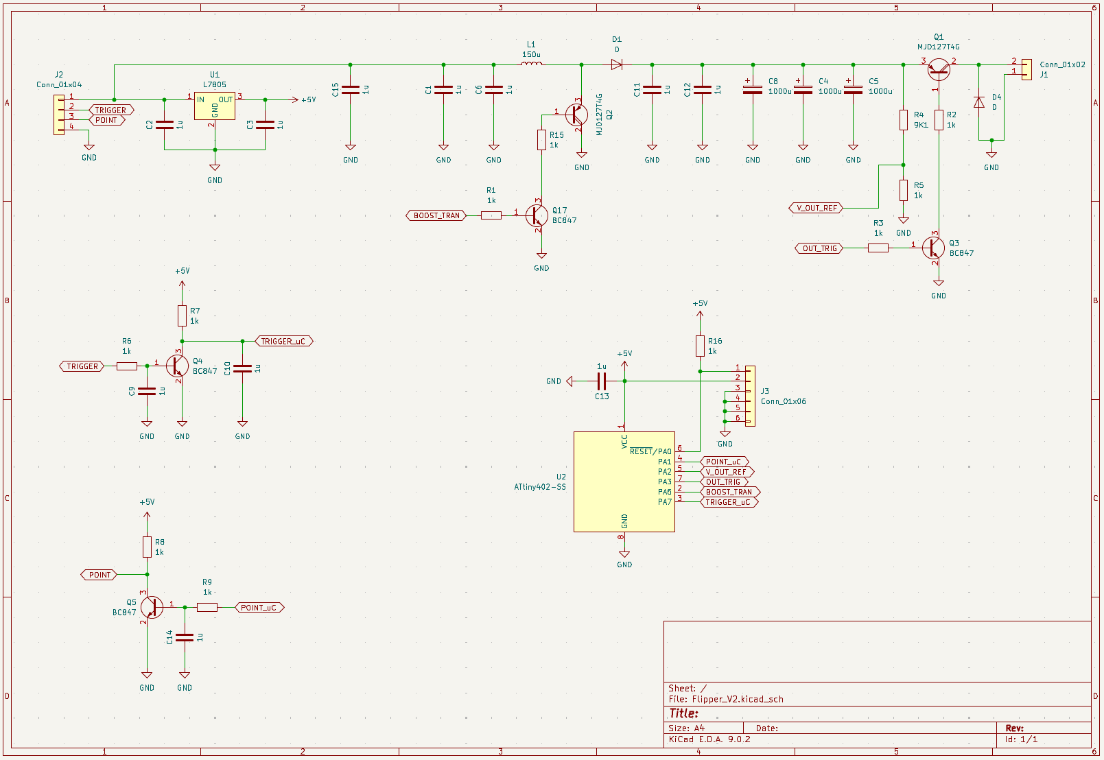

Circuit:
The circuit is a easy onepager. Controlled by an ATTINY402 we use a Darlington-PNP and a inductance in a boost configuration to charge 3 tank capacitors. On a trigger another PNP is activated to output the voltage.
Outputs are protected by PNP-transistors.

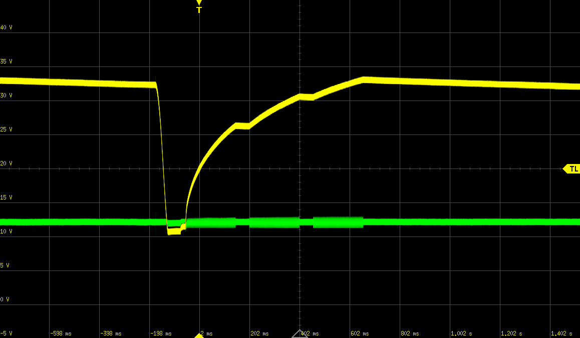

Charge Testing:
On all graphs:
green = input voltage
yellow = capacitor voltage

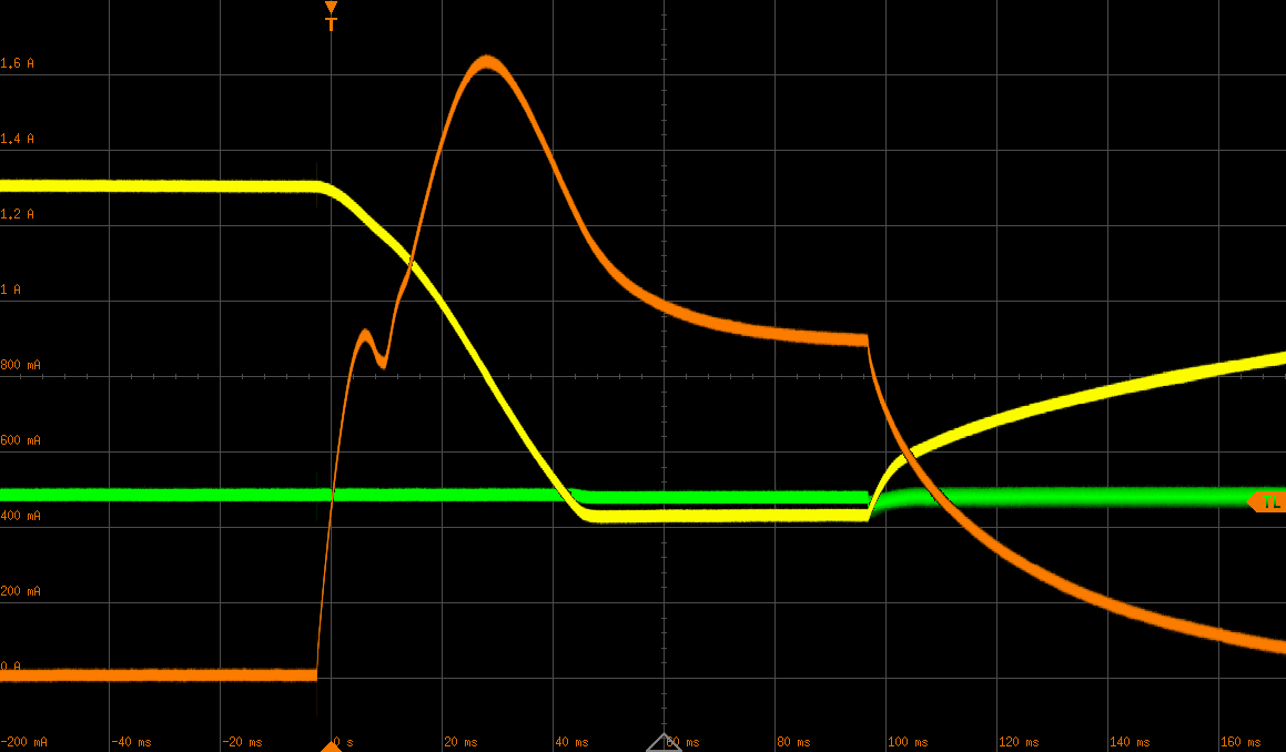

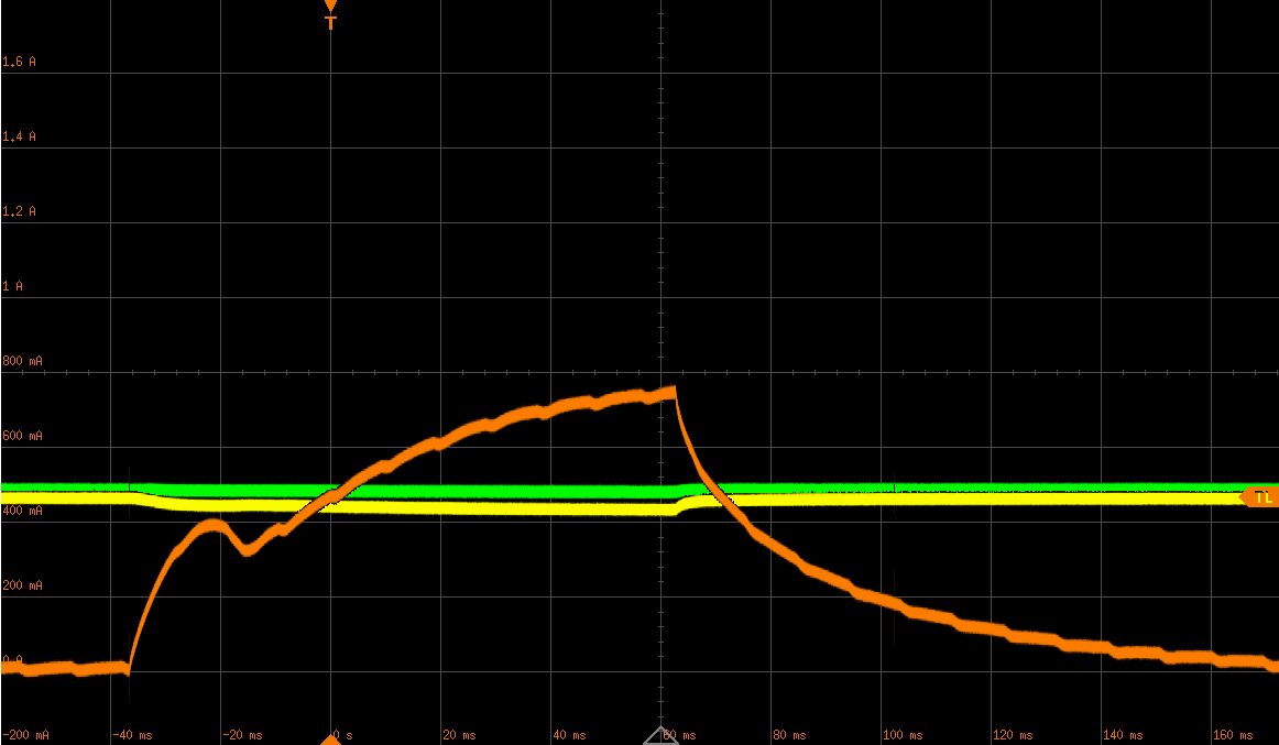

orange = solenoid current
All tests are done with the "PULSE" version. So 100ms solenoid activation on trigger.
On Startup the circuit takes around 500ms to reach 30V, after that it gets recharged and held around the desired 32V.The "slow speed" of the charging is due to the comparably small inductance (value and size) which would reach saturation pretty fast.
On a trigger it also takes around 300-500ms to get back to 32V.
Test with 20 Ohm solenoid:
To test the circuit i got a "standard cheap 12V solenoid" to test.
With standard 12V on trigger we reach a maximum of maybe around 8-9W peak. Not really impressive.
Charged to 32V we get an immense improvement. >30W peak power on pull. Much better.
