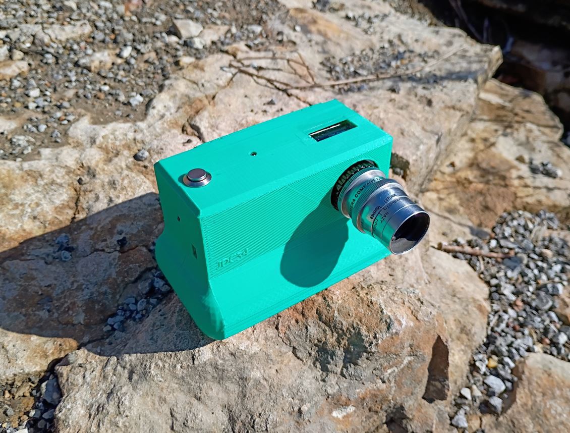

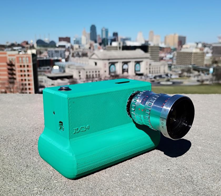

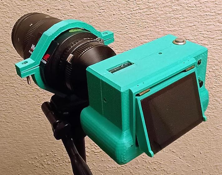

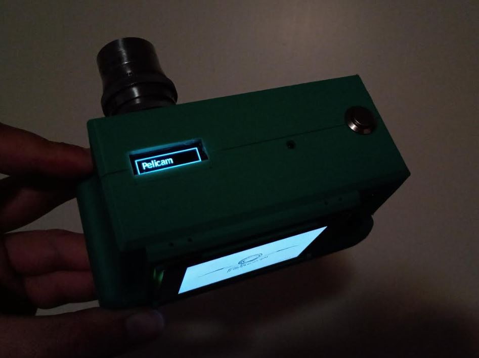

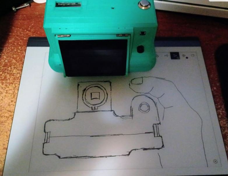

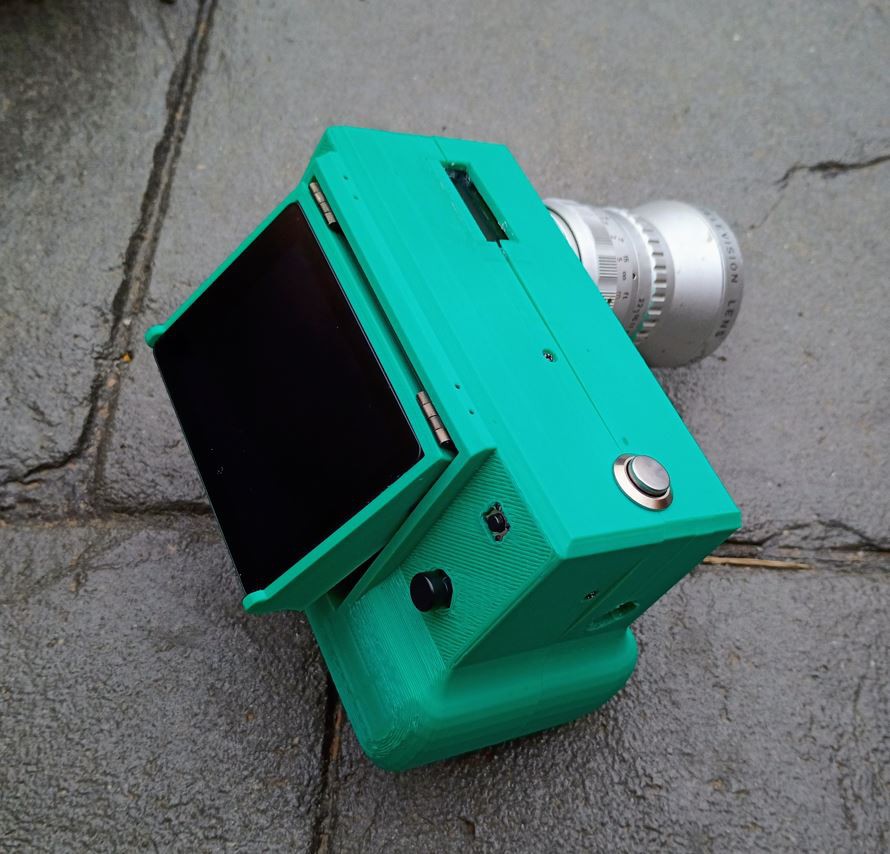

This is another camera body based on Raspberry Pi HQ Cam

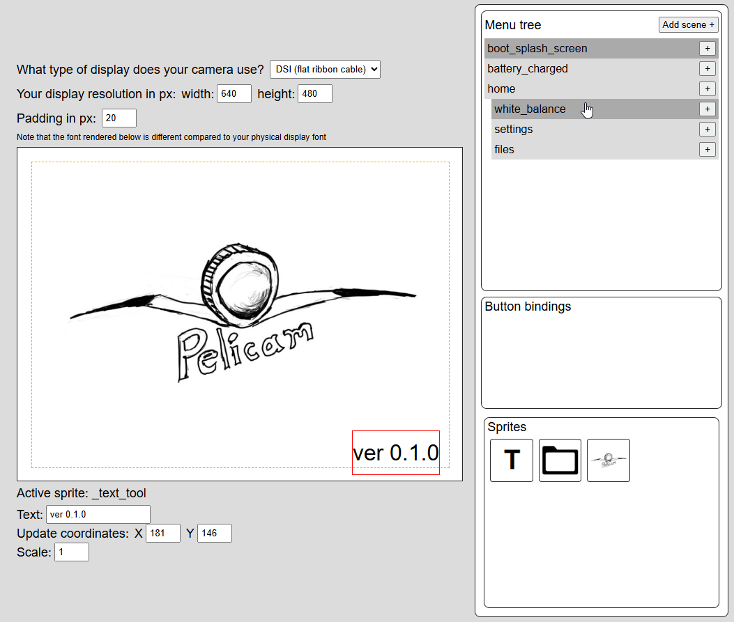

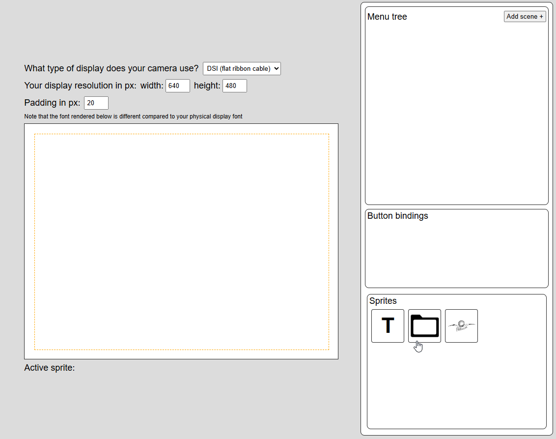

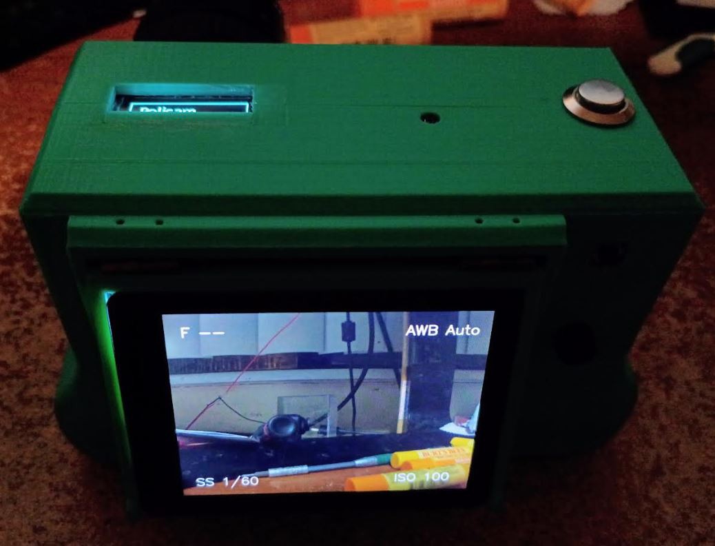

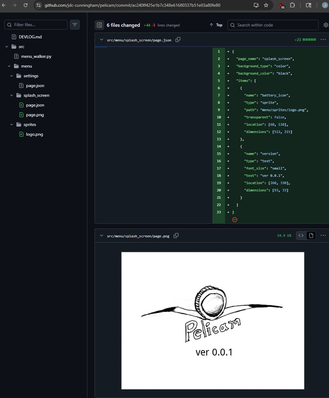

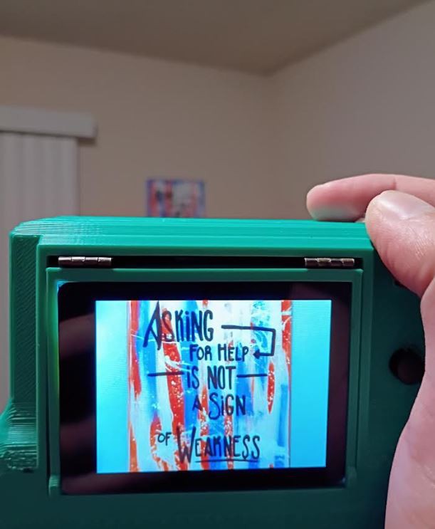

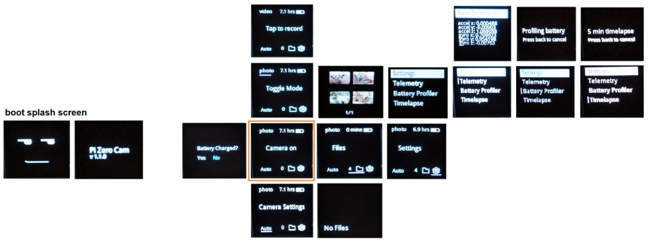

This camera uses a DSI display so it's actually using Openbox to render a GUI for the menu, although the menu is state-image-based not an actual GUI. This project also includes a menu builder called Pelicam and the software that interfaces with the camera hardware through picamera2.
This camera uses the Raspberry Pi HQ camera sensor with a Pi 4B hidden inside.
Hardware
  • 2.8" Waveshare DSI display with a 640x480 resolution touchscreen
  • 0.91" blue OLED on top behind the lens
  • 10 DOF GY-91 IMU inside
  • Physical 5D joystick, back and shutter buttons
  • Powered by a single 18650 cell boosted to 5V
  • 1A 5V USB charger
  • 1/4"-20 hex nut for tripod mount
Software (Pelicam)
Depending on your display eg. DSI/SPI
  • Openbox layer (DSI)
  • OpenCV layer
  • State-image based nested JSON menu system
  • Hardware interface
Time to print: 26 hrs
Unit cost: $231
  • The list is complete... (for now)

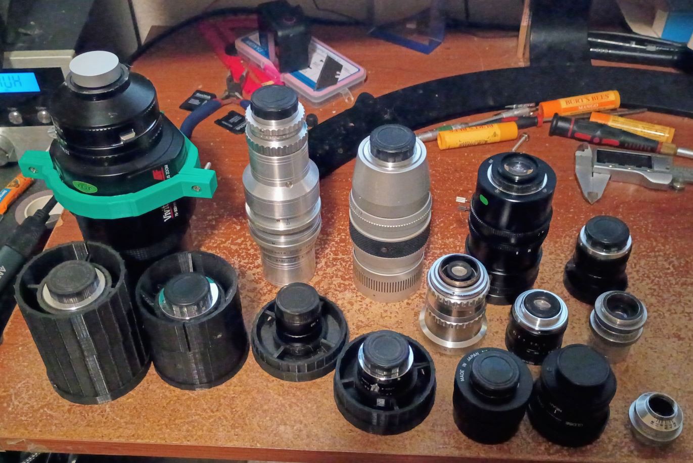

    So I did kind of go overboard and start buying a lot of lenses. I actually have more (of the CCTV ones) but a lot of these below are vintage/cine c-mount lenses. One is a full-sized lens with an adapter. I accidentally bought an 8mm wide angle Canon lens but it was for an SLR so I could not get it to focus unfortunately.

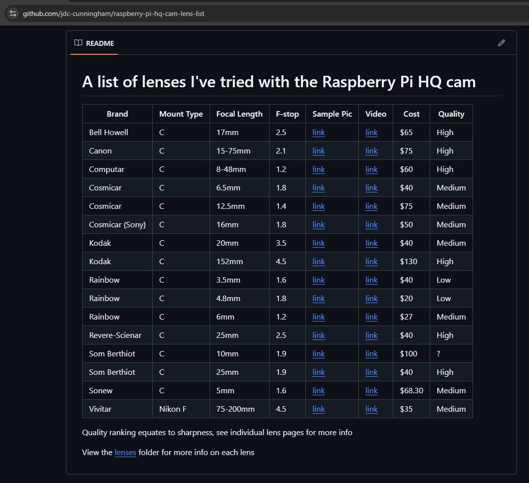

    So... I keep buying lenses... I have this rule they should be under $100 each.
    I just keep seeing more... I just ordered 2 more: a 16mm Sony and 17mm Bell Howell
    I'm building up a list with photo/video on each one. I'll start a series soon "One lens..."

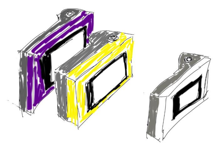

    I have 5 other cameras partially designed, although one is closer to be built (ordered most parts waiting for DSI display).
     It will be grey on the front and yellow in the back with a swivel sensor mount so the display doesn't have to flip. Already have the PLA

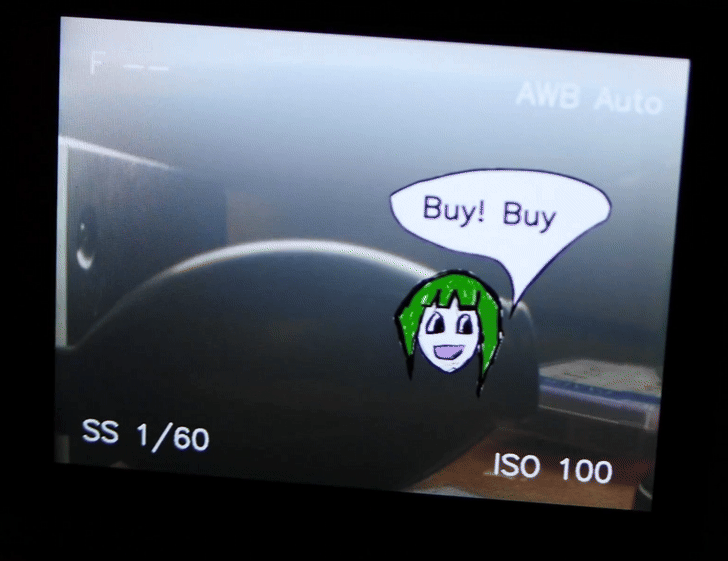

    I did realize these Pi 4B's had 4G of RAM in them. The next ones I'll buy 1GB versions... anyway made me think I should put an LLM in there. But also what else could you do? Well this camera has an IMU in it. Another camera I'll design/build in the future has a mic and speaker... would have even more components than this one. Throw in basic object recognition (really slow FPS), could come up with something.
    I was thinking as the camera detects objects you'd see words floating across the screen like "tree".
    But also I was thinking why not just an overlay of a character on the camera pass through.
    So I'm not much of an artist but here is my legally distinct green anime girl
    Ugh man hackaday still having problems hosting images
    Wait a minute... this gif upload went through

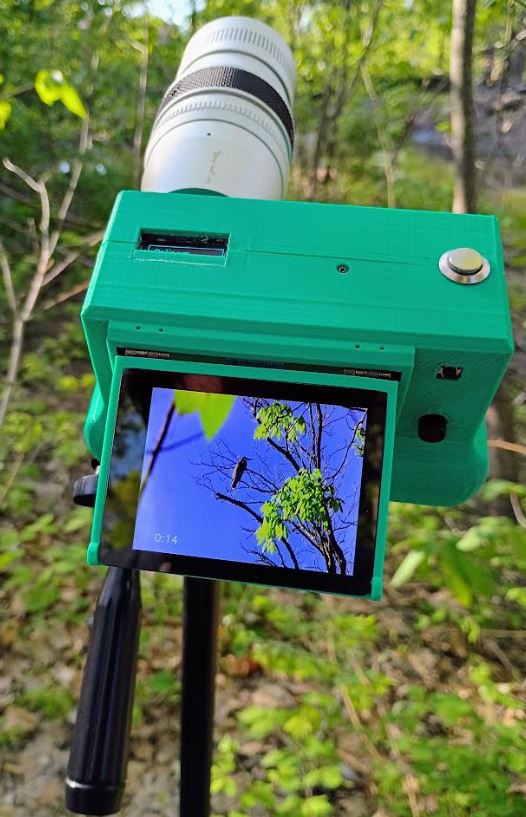

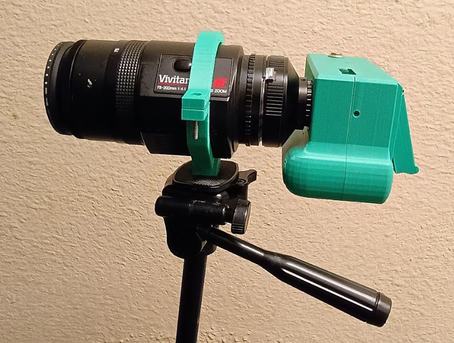

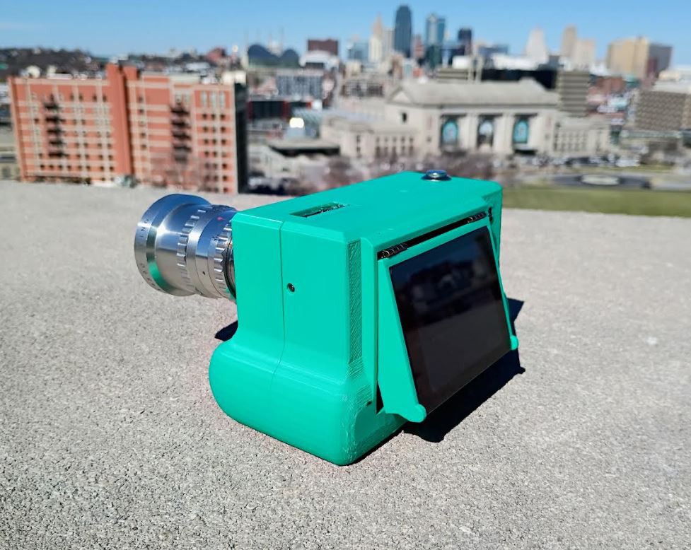

    I'm working on a lens hood right now.

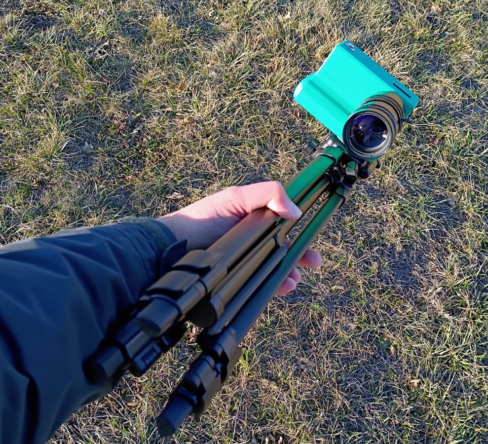

    This is a cool zoom lens I bought it was $35, it's supposed to use 3 AAA batteries and have electronic auto focus but I just use it manually.
    With the 5.5x crop factor this lens is the equivalent of 1100mm zoom so yeah, it needs a tripod without the ibis. Going to do some bird photography this weekend.
    This was a very lazy tripod mount but it works.
    The STL files for above are here. I am working on this list of random lenses I try with the RPi HQ cam including photos/videos. This is my camera/sensor for maybe ever... I've had Sony Alpha cameras and what not but I like designing my own camera bodies/software and I think 12MP is enough if you know how to use it.
  • Manual camera settings
    Jacob David C Cunningham02/23/2026 at 00:41 0 comments
    I did implement this on the basic-software branch (/pelicam/src/camera)
    I have to watch more videos/learn to see if it's actually working right
    For example in picamer2 ISO isn't a thing apparently, the equivalent is analogue gain

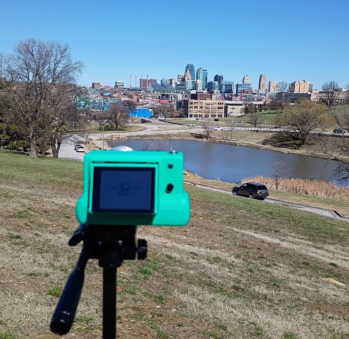

    I did go out and do some photography. I initially went to this park but it was pretty boring/flat, middle of winter here so everything's brown/dead. This was the best pic I got. I'll have a video out tomorrow.

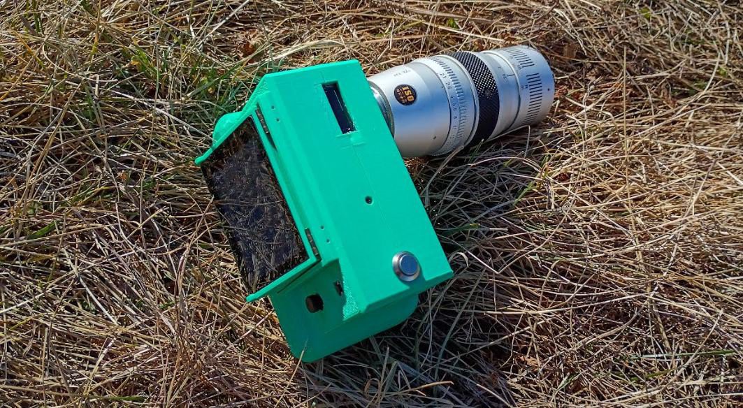

    Also got a new tiny camera so I can do POV videos
    I'm already designing a new camera since this one has a flaw where the sensor flange is not adjustable since it's glued to the body. Most of the lenses I use have to be unscrewed (flange distance increased) to focus.
    Also want a simple/easier to hold camera, it'll use the same display as this one the 2.8" Waveshare DSI display.
