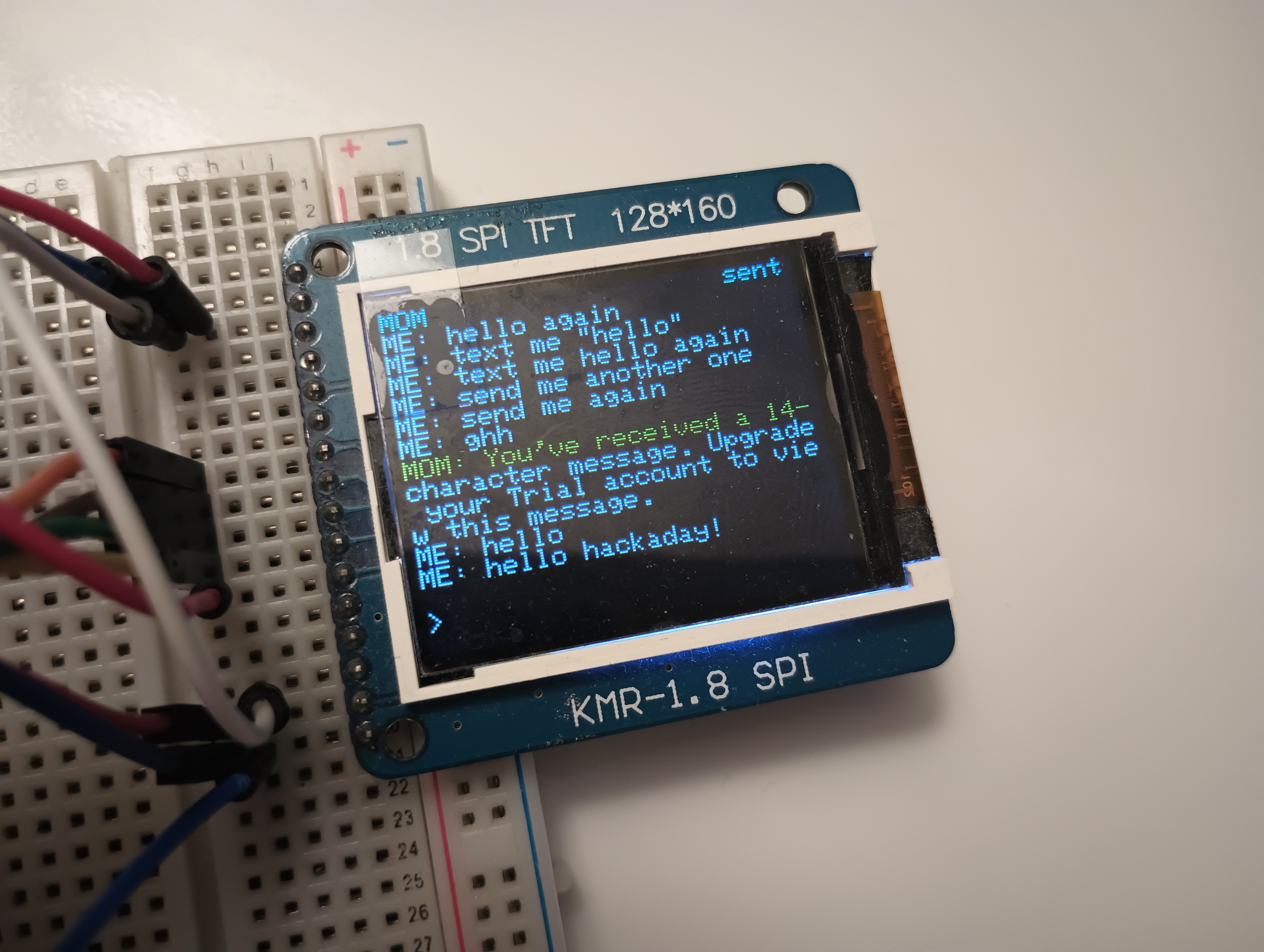

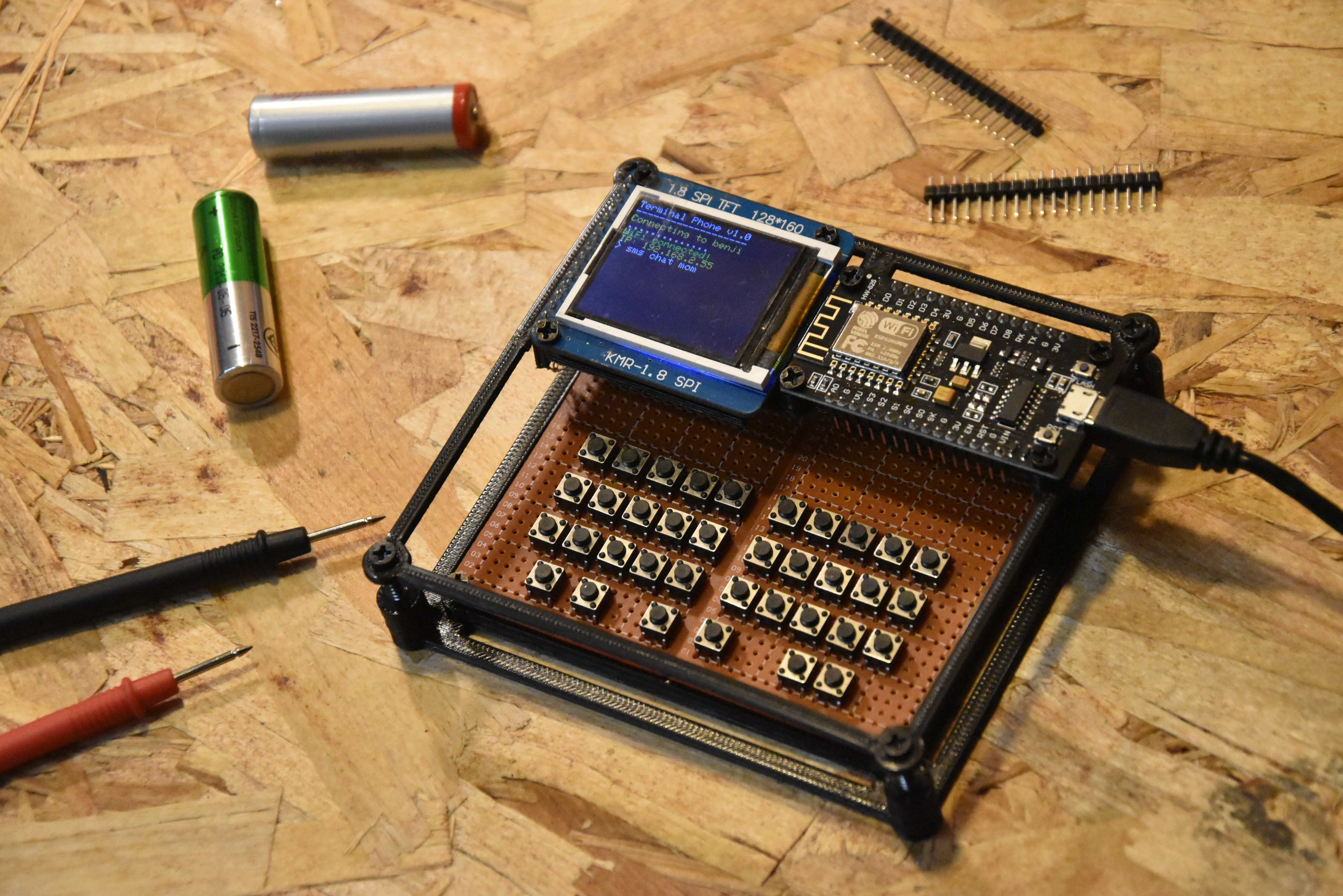

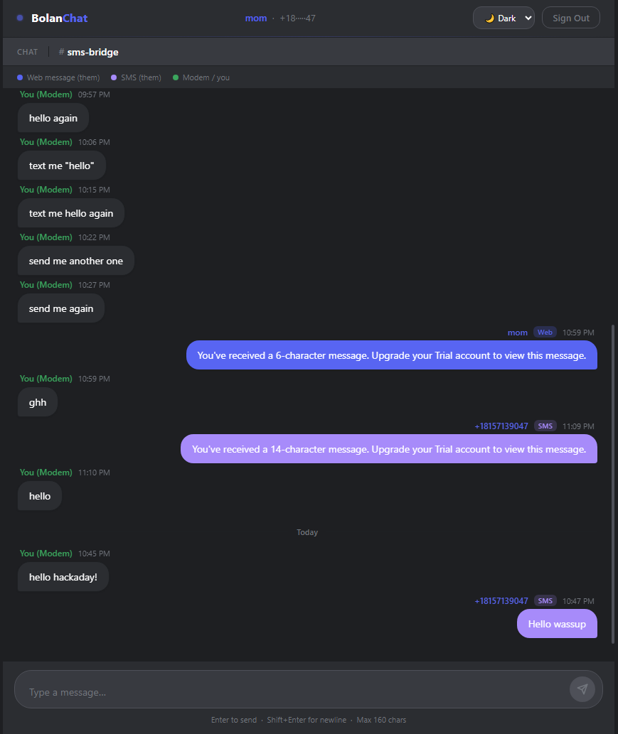

The Hardware is built around an ESP8266 microcontroller with a small 1.8 inch TFT display. A separate microcontroller handles the keyboard matrix and sends keypresses to the ESP8266 over UART. Everything is mounted in a 3D printed frame.

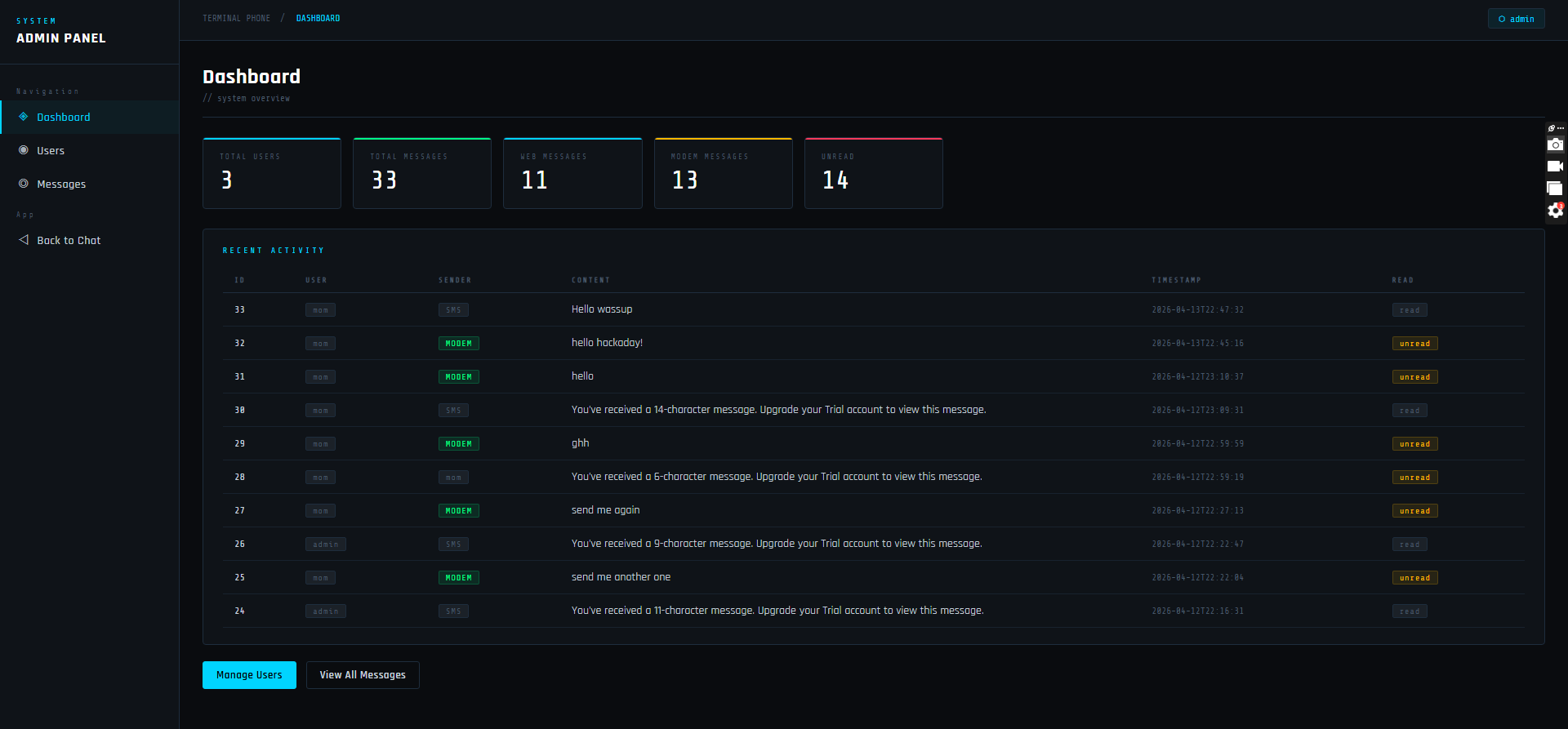

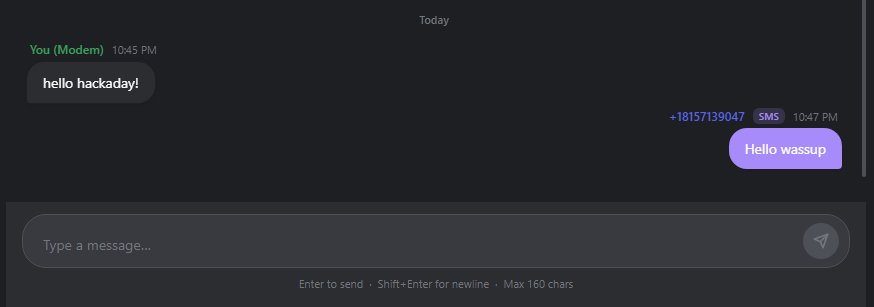

The Web Server is a Flask app hosted on PythonAnywhere. It acts as the bridge between the hardware and the outside world. The ESP8266 communicates with the server over WiFi using HTTP requests.

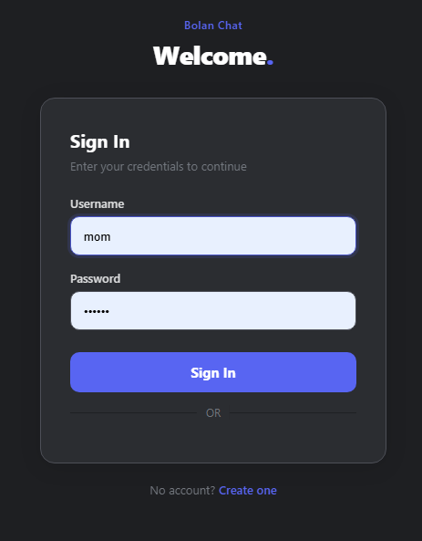

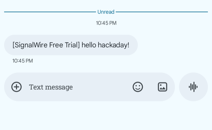

The Messaging Layer (IN PROGRESS) lives entirely on the server side. The server uses SignalWire to send and receive real text messages to and from normal phone numbers. So the device itself never touches any of that directly, it just talks to my server and my server handles the rest.
