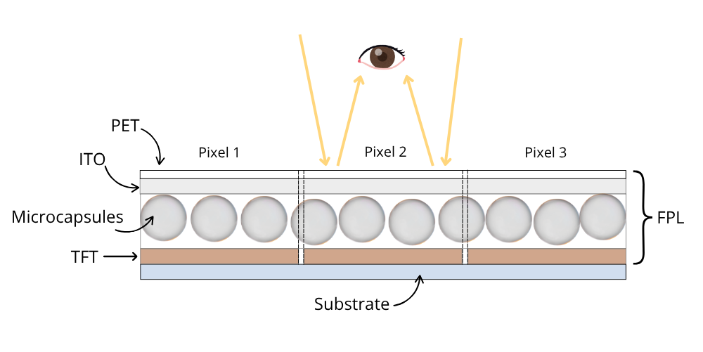

Electrophoretic Panel
The electrophoretic panel is like a sandwich made up of several very thin layers:
On the front of the EPD panel, there is a protective layer of transparent plastic (PET - Polyethylene Terephthalate), followed by a transparent conductive oxide electrode (ITO - Indium Tin Oxide).
Beneath this lies the film with the microcapsules and the pixel electrode matrix (TFT). Together, these layers form the FPL (Front Plane Laminate), which is laminated onto a rigid or flexible substrate during manufacturing.

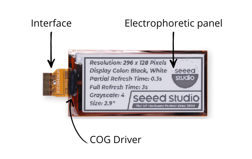

Driver
The EPD panel itself doesn’t include the electronics needed to generate images, so a driver chip is integrated to act as the “brain” of the system, generating the electrical signals that move the pigments.
This driver is usually mounted directly onto the panel using COG (Chip On Glass) technology, which is why it’s also known as a COG driver. Some of the most commonly used drivers are the SSD1680, UC8179, and JD79661.
Back side of an EPD showing the TFT matrix, the COG driver, and the FPC connector

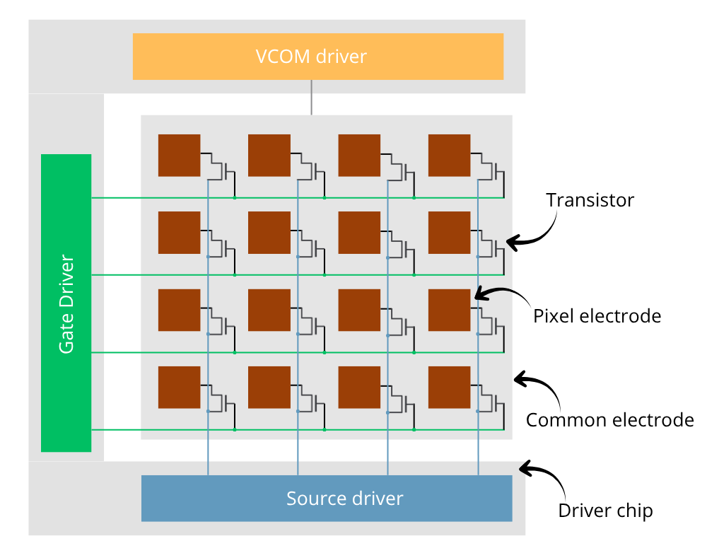

TFT Matrix
The TFT matrix organizes the pixel electrodes in rows and columns, with each electrode controlled by a thin-film transistor.
The transistors share the GATE line across each row and the SOURCE line across each column, while the drain is connected to each pixel. Inside the driver chip, the Gate Driver circuit controls the rows, the Source Driver controls the columns, and a third block manages the upper common electrode called VCOM.

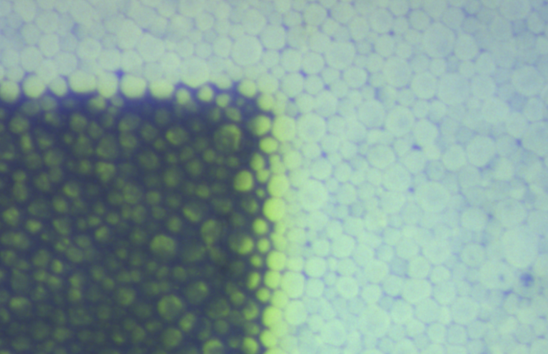

This arrangement allows each pixel to be individually addressed and the necessary voltages to be applied to achieve the desired color. Each electrode defines a pixel, which is actually made up of multiple smaller microcapsules — responsible for the granular appearance of the panel when viewed under magnification.
Granular pixel detail in an EPD

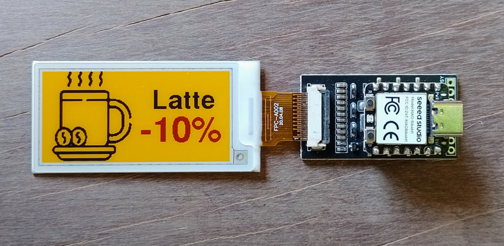

ePaper Breakout Board: This board features a 24-pin FPC connector for attaching the EPD panel, and a socket specifically designed for inserting a XIAO module, which acts as the main controller. It’s compatible with different XIAO models and allows you to control both monochrome and color EPDs of various sizes.
ePaper breakout board with a XIAO RA4M1 controlling a 4-color display
