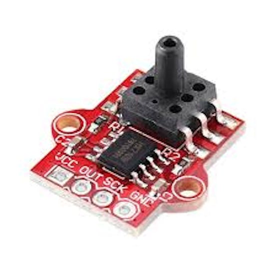

The MPS20N0040D-D Sensor
The heart of the measurement is the MPS20N0040D-D sensor, which uses piezoresistive technology in a Wheatstone Bridge configuration.
,See the MPS20N0040D-D in figure below.
The major challenge here is its sensitivity: the output is a differential signal of very low amplitude (only a few millivolts). Without proper processing, any electrical noise would make the reading unstable, preventing accurate monitoring of industrial processes.

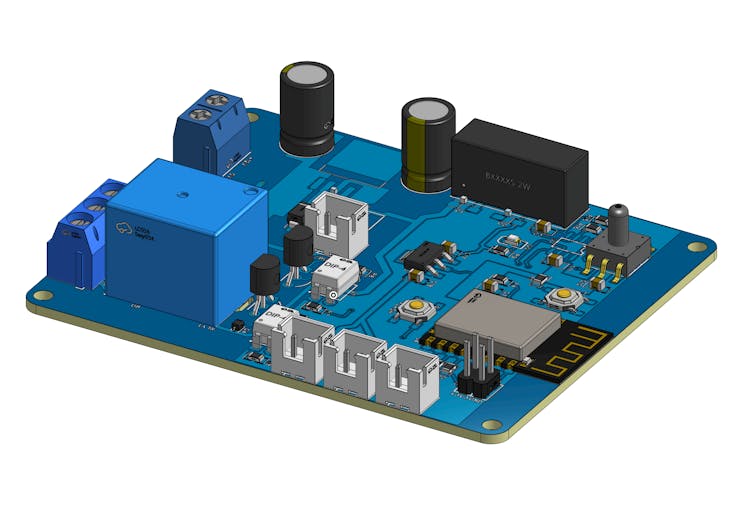

The ESP32 Microcontroller
We chose the ESP32 not only for its low cost, but also for its ecosystem. With two processing cores, it can read the sensor on one core while managing the Wi-Fi connection and data transmission to the web on the other. This prevents the network process from freezing or delaying pressure readings, ensuring true real-time monitoring.
Output Peripherals and Interface
The board was designed to be self-sufficient in the field:
Actuation Relay: Allows the board to interrupt or start a process (such as shutting down a compressor) as soon as a pressure limit is reached, acting as a local safety system.
Audiovisual Signaling: The buzzer and LED provide instant feedback to the operator. In IoT systems, local feedback is as important as remote feedback; the operator needs to know the system status even if the Wi-Fi network goes down.
Control Buttons: Allow interactions such as "tare" (resetting) the sensor or switching between manual and automatic operating modes.

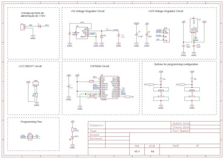

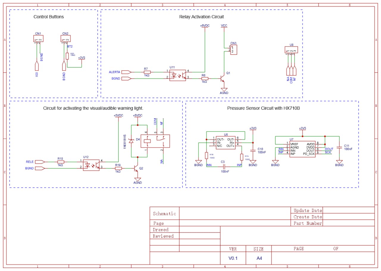

Next, we will present the electronic schematic of the printed circuit board design.
Electronic Schematic
Below, we present all the blocks of the electronic circuit diagram.
One of the cornerstones of reliable hardware is its power management system. For this board, we designed a 12V VDC ~ 24 VDC input, a common voltage in industrial and automotive environments, which facilitates the integration of the project into real-world scenarios. However, to power the microcontroller and...
