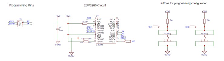

The ESP8266 and the Programming Interface
The heart of the board is the ESP8266. It is responsible for receiving the conditioned signal from the pressure sensor and deciding whether the relay should be activated or whether an alert should be sent to the web.
Programming and Communication Circuit
Unlike commercial development boards (such as the NodeMCU), which already have an integrated USB-Serial converter, we designed this board focusing on efficiency and reducing unnecessary components in the final version. To this end, we implemented a dedicated communication bus:
- Interface Pins (ICSP/Serial Header): We exposed the TX, RX, +3.3V, and GND pins. This interface allows connecting an external USB-Serial adapter (such as the FTDI) only when it is necessary to update the firmware, saving space and power in the final hardware.
- Programming Mode (Bootloader): To allow the chip to accept new code, we included strategic buttons on the board. The Flash button (connected to GPIO0) and the Reset button allow you to manually put the ESP8266 into programming mode, a robust standard for developers seeking total control over the hardware.
System Stability
To ensure that the ESP8266 does not suffer unwanted restarts (the famous Brownout), the circuit has decoupling capacitors near the chip's power supply pins. This is vital because the ESP8266's Wi-Fi radio has current consumption spikes during data transmission to the cloud. With this architecture, we ensure that the pressure reading remains stable even during telemetry transmission.

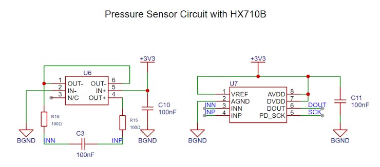

The Heart of Measurement: MPS20N0040D-D Sensor and HX710B ADC
The accuracy of a pressure monitoring system depends entirely on the quality of the analog signal conversion. For this project, we used the combination of the MPS20N0040D-D sensor with the HX710B conditioning chip. Below we have the electronic schematic circuit with these two electronic components.
The Piezoresistive Sensor
The MPS20N0040D-D is a sensor based on a Wheatstone bridge. When air exerts pressure on the sensor membrane, the resistance of the internal elements varies, generating a potential difference at the output.
However, this variation is on the microvolt (µV) scale, an extremely fragile signal that cannot be read directly by the standard analog pins of the ESP8266 without a massive loss of resolution and accuracy.
The Precision of the HX710B
This is where the HX710B comes in, a 24-bit Analog-to-Digital Converter (ADC) designed specifically for precision scales and pressure sensors. It solves two critical problems at once:
Low-Noise Amplification (PGA): It has an internal high-gain amplifier that "boosts" the sensor signal to a processable level without adding significant thermal noise.
High Resolution: While the ESP8266's internal ADC only has 10 bits (1024 levels), the HX710B offers 24 bits. This allows it to detect extremely subtle pressure variations, ensuring that web monitoring is faithful to what occurs in the physical process.
Integration and Stability
The HX710B communicates with the ESP8266 through a two-wire interface (Clock and Data), which simplifies the PCB layout. Furthermore, by using the isolated power supply from our B0505S module, the HX710B operates in a "silent" electrical environment, which is crucial to prevent the 24-bit signal from fluctuating due to the Wi-Fi radio's current consumption.

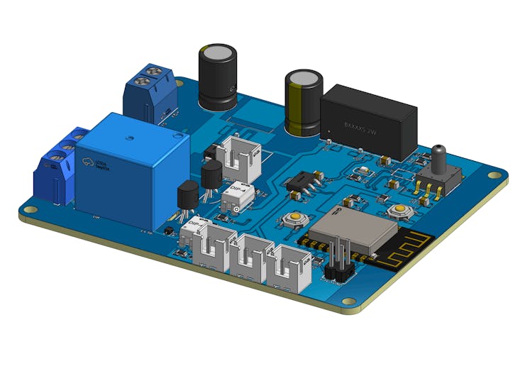

Final Result and Hardware in Action
After the entire design and technical validation process, the result is a compact, robust, and field-ready electronic board. The integration between the high-resolution reading of the HX710B and the processing of the ESP8266 allowed for extremely stable pressure control, with immediate response times both in the activation of the local relay and in updating data via the cloud.
Below, you can see the final PCB assembly, highlighting the organization of the power (GND A) and sensitive signal (GND B) sectors, ensuring the thermal efficiency and noise immunity discussed earlier.
