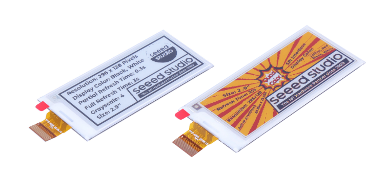

In the next image, you can compare the speed characteristics of two displays of the same size—2.9", which is pretty convenient.
One is capable of showing 4 grayscale levels, and the other can display 4 colors. The full refresh on the monochrome display takes about 3 seconds, while the color version takes 25 seconds. That’s almost 10 times longer!
As you can see, there’s a huge difference in speed. But think about it for a moment: do we really need a fast screen? Are we going to display data that changes frequently?
If your badge is going to show a fixed image—the same one for days, without any changes—a slow initial refresh isn’t a big deal, since it only happens once and then you don’t notice it anymore. So, in this case, refresh time isn’t a limiting factor.
Considering all the benefits of using color, we’ll go with the display on the right: a 2.9-inch, four-color (white, black, red, and yellow) EPD with a resolution of 128 x 296 pixels.

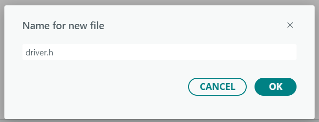

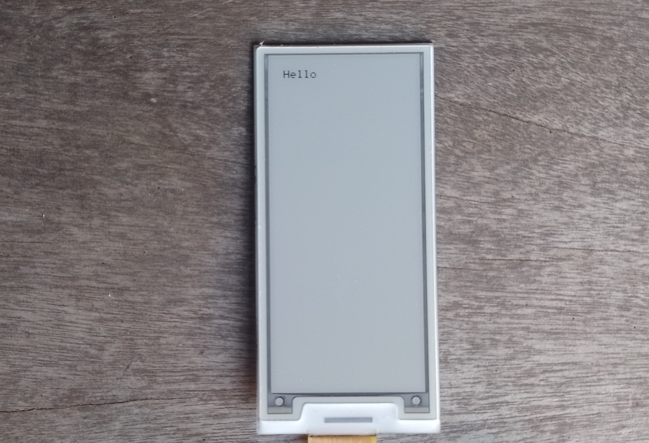

If you run this code, you might get an error message or just not see any changes on the EPD. That’s because something’s missing: you need to tell the library which combination of display and driver board you’re using.

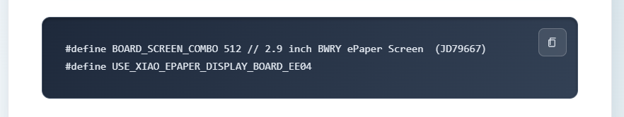

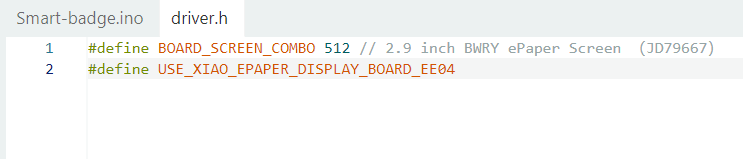

To do that, you have to create an extra file called driver.h. In the IDE, you can press Ctrl+Shift+N to open a new tab.
Inside this driver.h file, you’ll need to add a couple of definitions. Don’t worry about memorizing these or digging through the docs—Seeed Studio has made an online tool to make this step super easy.

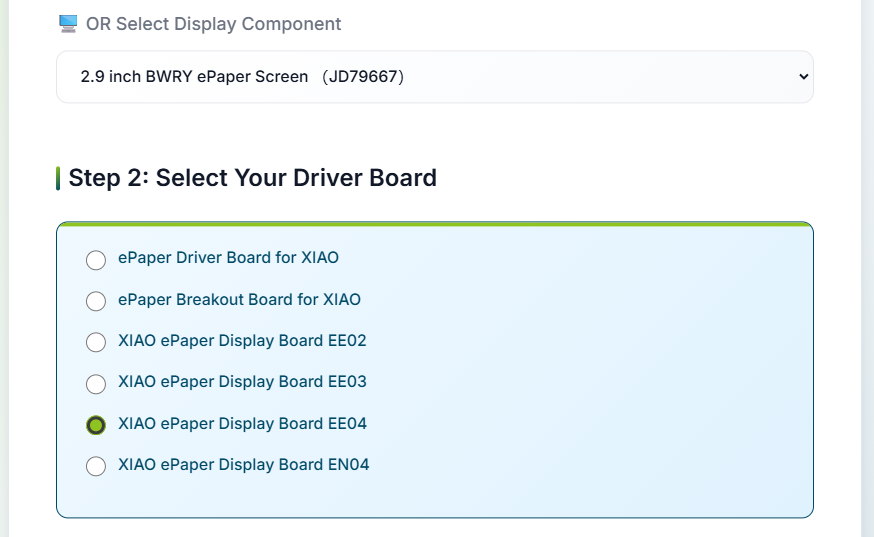

You can find it here: https://seeed-studio.github.io/Seeed_GFX/
On this page, just select your display panel and driver board. For this project, it should look like this:
When you make this selection, the text box below will automatically update with the definitions you need.
Just copy that content into your driver.h file.
Now, if you compile and upload the program, it should work without errors. After a few seconds of blinking and color changes, you’ll see something like this:
Wow! Okay, I know—it’s not exactly mind-blowing, but it’s definitely exciting.
This is the very first thing you’re showing on an EPD screen.

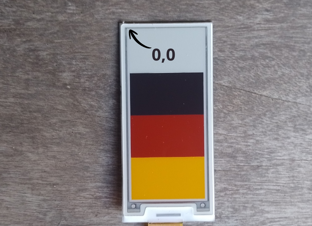

The display we’re using in this project supports four colors, which in the library are defined as TFT_WHITE, TFT_BLACK, TFT_RED, and TFT_YELLOW.
To place any element on the screen, an x, y coordinate system is used. The origin of this system can be changed (we’ll see that later), but by default, the 0,0 point is located at the top-left corner, on the side opposite the FPC ribbon cable.
The x coordinate increases to the right, and the y coordinate increases downward.

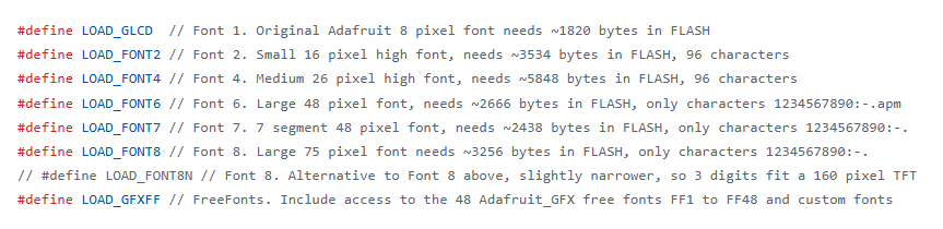

The available fonts might vary depending on your display, so here’s a quick tip to check which fonts you can use in each case.
The library includes several configuration files in the User_Setups folder. These serve different purposes—like setting the display size, driver chip, and connection pins, among other things.
Each config file has a numeric code assigned to it. For the 2.9" color display and the EE04 board, the code is 512 (you can see this in your driver.h file). If you look in the User_Setups folder, you’ll find a file named Setup512_Seeed_XIAO_EPaper_2inch9_BWRY.h which includes these definitions:
What these definitions mean is that you have 6 fonts available: 1, 2, 4, 6, 7, and 8. Each one has a different text size—some include all letters and characters, while others might only have numbers and a few symbols (the comments explain which is which).
It also means that FreeFonts are enabled—a collection of open-source fonts inherited from a library originally created by Adafruit. We’ll talk more about those soon.
To select one of these 6 fonts, use the setTextFont method and specify the corresponding number. For example:

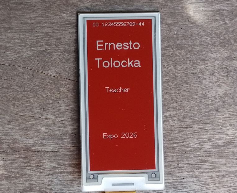

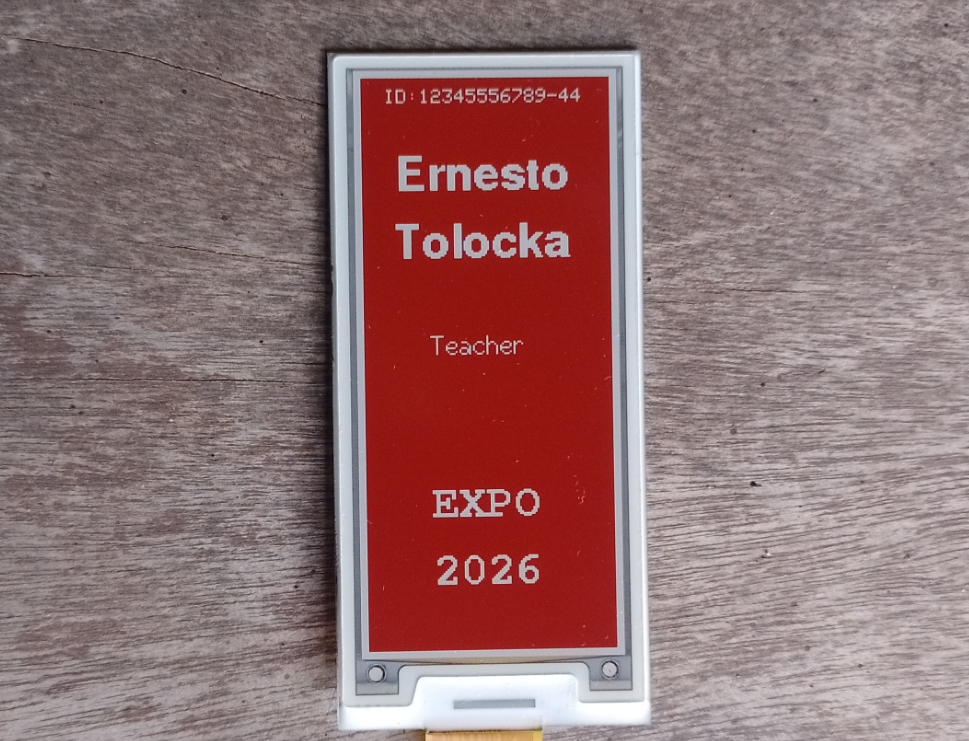

Let’s use this knowledge to display the user’s info on the badge.
Just as an example, you might want to include an ID number, the person’s name, their title, and maybe some event info—but feel free to add whatever information you think is appropriate.
Here’s how the code would look:

The result is shown in the image below.
As demonstrated, fonts 2 and 4 look great for this purpose. Try experimenting with the others to check out their appearance.

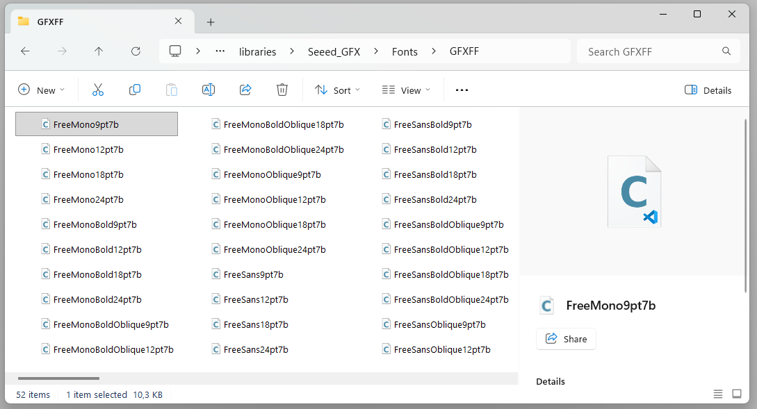

FreeFonts
As we saw in the Setup512_Seeed_XIAO_EPaper_2inch9_BWRY.h file, the use of so-called FreeFonts is enabled.
There are lots of them, and each one is defined in a header file (.h) inside the library’s Fonts/GFXFF folder.
The name of each font tells you its style and size. For example, the font FreeSans9pt7b can be broken down like this:
Using FreeFonts
Now that we know what FreeFonts are, let’s check out how we can use them to improve our badge.
To select one of these fonts, you’ll use the setFreeFont method and a pointer to the font definition. Here’s how your code would look with FreeFonts applied:

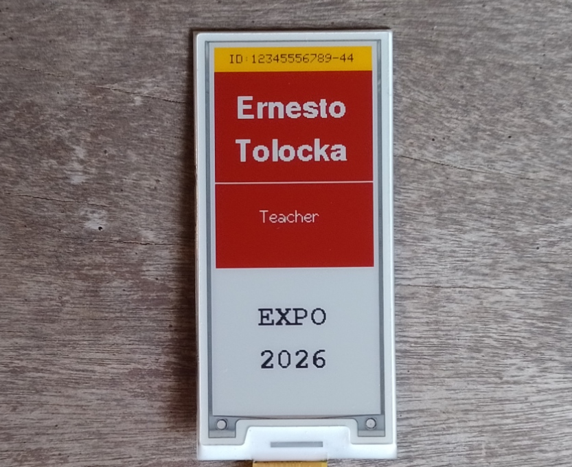

To finish up the badge design, let’s add some simple graphics like lines and rectangles. The library includes a rich set of graphics functions that make it easy to draw circles, rectangles, ellipses, and more. We’ll cover those in detail in another project.
Lines can be drawn in different ways:  Use drawFastHLine and drawFastVLine for optimized horizontal and vertical lines, or use drawLine for a general case—this lets you draw a line between any two points.
Rectangles can be empty with drawRect, filled with color using fillRect, or drawn with rounded corners using drawRoundRect.
By adding a few separator lines and filled rectangles to change the background color, our badge now takes its final shape:

There’s something cool to notice here: instead of specifying the width of the rectangles and separator line in pixels, I used the width method, which returns the width of the display. I also used the height method to get the total pixel height, making it easier to set the height for the white rectangle.

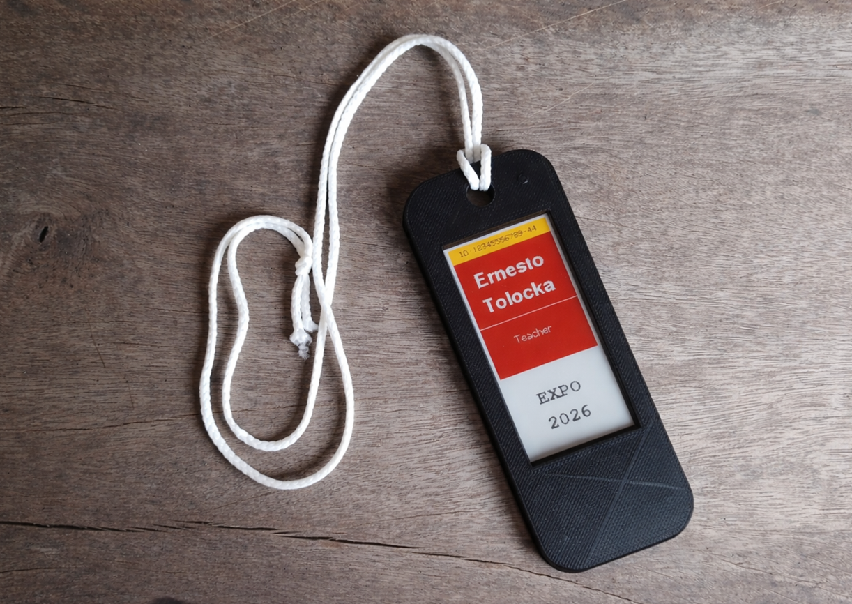

To wrap things up and finish the process with a functional prototype, I added a 3D-printed case for the display.
This is how the finished badge looks!
