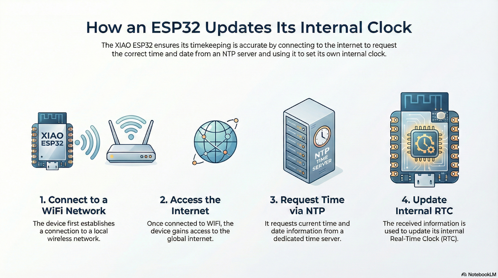

But for this project, let’s take a different approach. Instead of relying on a backup battery to keep the clock running, we’ll use an Internet connection to sync with an NTP server.
That way, even if the device loses track of time when it’s powered off, every time it turns on it will automatically fetch the correct date and time, update the ESP32’s internal RTC, and display the information on the EPD screen.
NTP
What makes it possible for a device like the ESP32 to get the exact current date and time is the Network Time Protocol (NTP)
NTP is a communication protocol that lets you access NTP servers—machines distributed all around the world that can provide the exact time with millisecond precision.
To get the time from an NTP server, the ESP32 first needs to connect to the Internet, typically over Wi-Fi.
Once it’s online, the ESP32 communicates with the server using the NTP protocol, which defines how to exchange date and time information accurately and reliably.
After receiving the data, the ESP32 updates its internal RTC, so it can keep track of time locally without needing to reconnect to the server each time.
