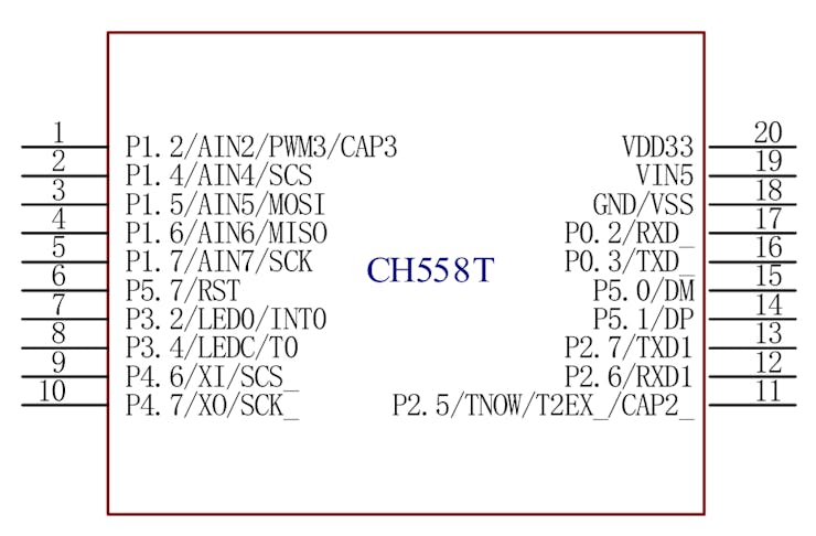

CH558T - SSOP20
If we notice carefully on the above pinout, we can notice PORT3, PORT4 and PORT5 pins are used. We can not directly access any of the PORTs except PORT1 using BASIC-52. So it is easy to go with 20 pin SSOP20 package than 48 pin QFP48 package.
If we have either CH558 or CH559 in any of the package should work.

The other change is CH558 uses 4kB internal xRAM compared to CH559 which uses 6kB of xRAM. The range of the internal xRAM is different for CH558 from CH559. The xRAM range for CH558 ranges from 0000H to 0FFFH. So the ERAMEND EQU 0FFFH. This is also corrected to report the proper available memory.

CONNECTION:
We need just two wires to the Single Chip Computer namely VCC(+5V) and GND. For this purpose small micro USB breakout board is used for easy connection. We can use any of the available connector or directly connect two wires with correct polarity.
CH558 requires just 4 connections. VCC, GND, Tx and Rx
Bluetooth module requires 4 connections. VCC, GND, Tx and Rx
Some of the Bluetooth modules may support only 3.3V logic level signals. In that case we need to reduce the Tx signal from CH558 to 3.3V for safe and reliable operation.
I2C, SPI and other legacy functions may share the same pin. Please check the pin for any conflict with other functions. We can re-assign the pins and assemble the source code to avoid any conflict.
