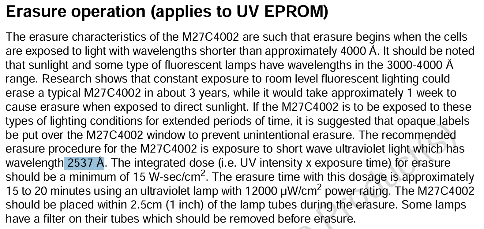

UV DOSE and wavelength requirement
If you refer to any EPROM datasheet, it will be all the same original Intel datasheet with Cut and Paste.

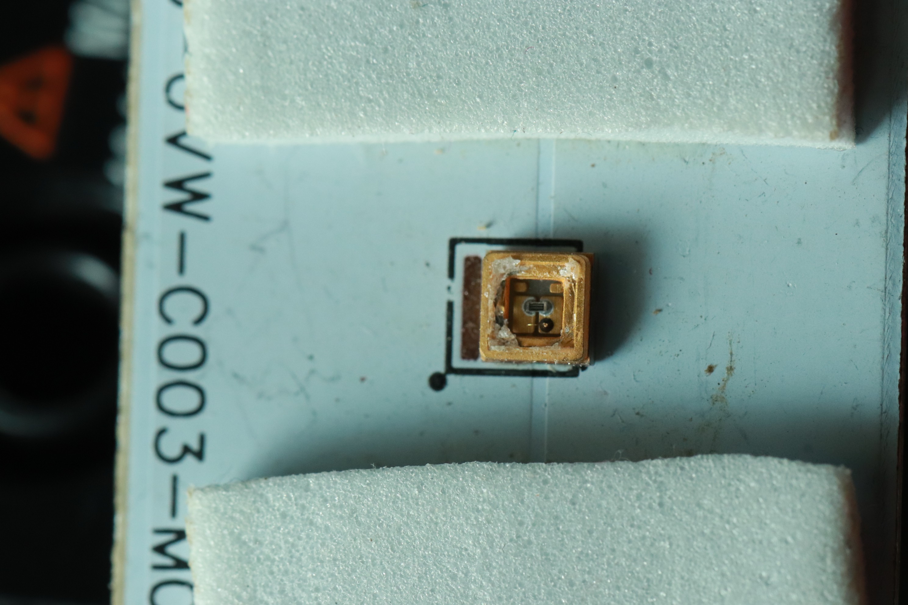

I am not able to procure the 253.7nm UV-C LED. But I am very easily able to get 3535 size SMD275nm/1W UV-C LED for $1. The UV-C comes in diode or diode mounted on a Al base plate along with polarity marking and soldering pads. This one is much easier to handle the LED in our application.
UV-C LED
275nm UV-C LED with Al sheet with double sided tape

Just connect the UV-C LED along with a series current limiting resistor so that we are operating with in the UV-C LED power rating and there is no excess or thermal issue due to large current flowing through the LED.
For 12V DC source with a 150 Ohm resistance is good enough and working. In this case the Diode drop measured is 6.17V DC for the Supply voltage of 12.11 V DC.
The current through the UV-C LED is 0.0396666666666667A
The power dissipated by UV-C LED is 0.2447433333333333W
We are well below the power rating of the UV-C LED and does not require any additional cooling.
Just place the UV-C LED above the quartz window of the EPROM. Do not look at the LED without anh proper eye protection. I have used the Double sided tape to hold the LED above the EPROM window.
