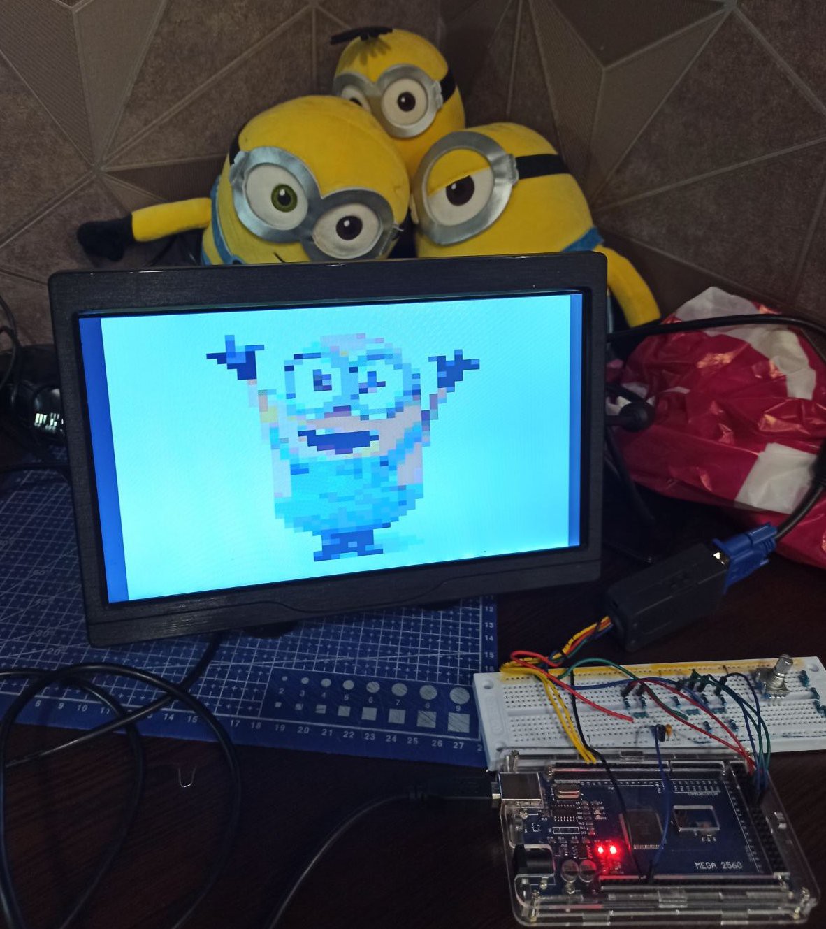

  • Adding more colors
    Pavel02/09/2026 at 17:13 0 comments
    I slightly updated the circuit, adding 3 simple 2-bit resistor ladder DACs, so that now I can output images in 64 colors (RGB 222).
    The images are measly 36(or less) by 25 pixels, so are quite blocky. They are taking 900 bytes, thus I can hold only one in 1kB memory of atmega168 chip.
    Blockiness is also comes from the fact, that each pixel takes some time to output; in my implementation the for loop is used to retrieve each pixel value from array, and each loop takes 11 cpu cycles, so at 16 MHz, I can output a pixel every 688 nanoseconds, thus effective pixel clock is at 1.4545 MHz, far less than 25.175MHz for standard VGA 640*480@60Hz.
    Next is a couple of examples of images produced:
    An airport radar tower
    N
    Not
    A picture of a Minion:
    Not too much to look at, the pictures look better the further away from screen one sees them.
